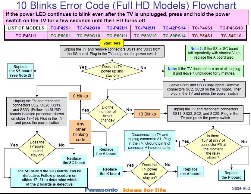

    Hey guys, new here... I have a TC-P46S1 and have become yet another victim of the 10 blinks. Anyhow, I've done a little searching and trouble shooting already. So here is where I'm at:
    1. Watching TV and the it goes black the other day with 10 blinks.
    2. Tried the reset by holding the button for 10-20 secs, light stays solid for a little while but goes back to blinking. TV didn't come back on at all.
    3. Unplugged SC2 and SC20 and now have 6 blinks.
    4. Also checked the fuses on the P-Board F352, F501, F601, F602 and F603 and were fine but couldn't find F201.
    I'm not sure where to go now.
    Any help would be appreciated!
    Thanks,
    Brian

    Re: Panasonic TC-P46S1 10 Blinks
    I'd suspect bad SC board but this is from the 2009 troubleshooting guide. Could be almost any board but disconnecting the Sc and getting 6 seems like it may be Sc but i'd follow this flowchart.
    Finding an Sc could be difficult.

                  I think I'm going to do that after I confirm a bad SC board. If it is a bad SC board, does that mean something in the P board is causing a bad SC board?

                    You'd have to follow the flowchart first to determine . Sc board failure is a fairly common fault. there's been plenty who have replaced the PSU for no reason but 2 & 10 blink on the generation before yours had PSU issues with a couple of modules.
                    Always good practice to check the buffer boards too before installing a replacement SC board just in case. If you can find that guide, should be some tests in there.
                    If the 10 blink was coming from the PSu it would be still there with the Sc disconnected, so i expect the PSu would be fine but you can always check the voltages from it.

                            I followed that flowchart and looks like the SC board and not the SS or A so I did the swap thing on ebay and shipped it out today.

                                Didn't realize you posted something else! Hope you had a great Christmas! SC board came in today and fixing to install it. I didn't see any physical anomalies on the buffer chips... The cheap multimeter I have doesn't beep so testing the continuity cam be tedious. So I'm hoping that the buffers are fine. If I still have a problem after I install the SC board then I'll have to go get a better multimeter.
                                I didn't pull the heatsinks off but looked on the backside and no burnt spots or anything out of the ordinary...
