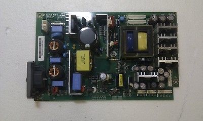

lcd tv DAEWOO DLP-3212 power supply DEP32-200B

    I need a diagram of this source, equipped with: STR-T2268, VIPer22A, FA5501AP (PFC). Besides voltage 5V, not "remove" anything St.By LED, flashing red -green.Thanks anticipated . 051bye

    Re: lcd tv DAEWOO DLP-3212 power supply DEP32-200B
    The correct word you are looking for 'scoate' is 'outputs'. If it's only putting out 5v standby, that means main PSU is not working. Does the primary capacitor read 380-400v, or lower?
