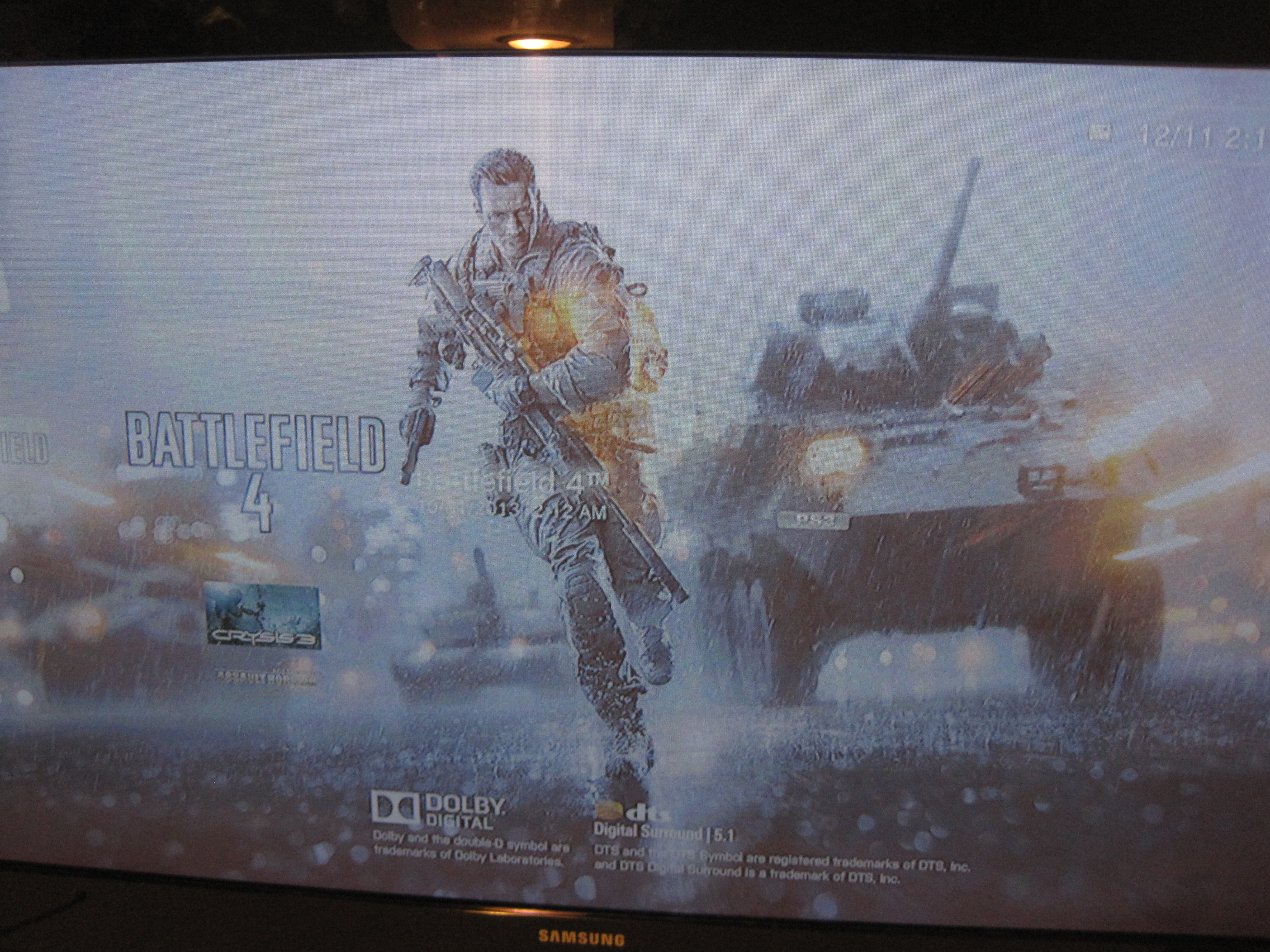

    I've got an HP-T5064 with a grainy, dim & washed out picture (see below). The Vs, Va, Vsc & Ve voltages are correct. Adjusting the Vsetup & Vsetdn improved the picture quality a little but it's still very bad.
    My first inclination was that the XSUS is having trouble. Has anyone experienced this before?

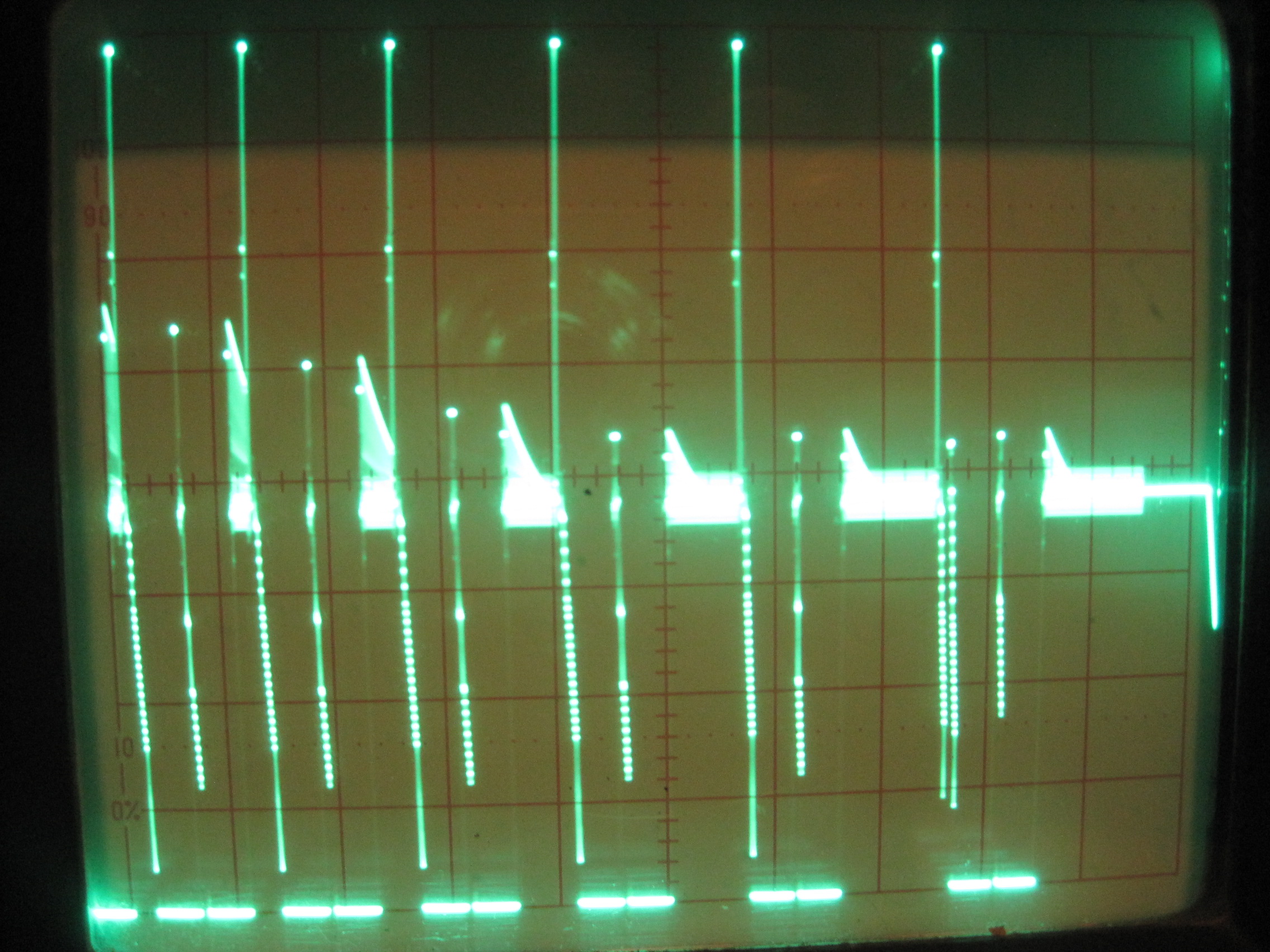

        Re: Samsung HP-T5064 picture grainy, dim & washed out

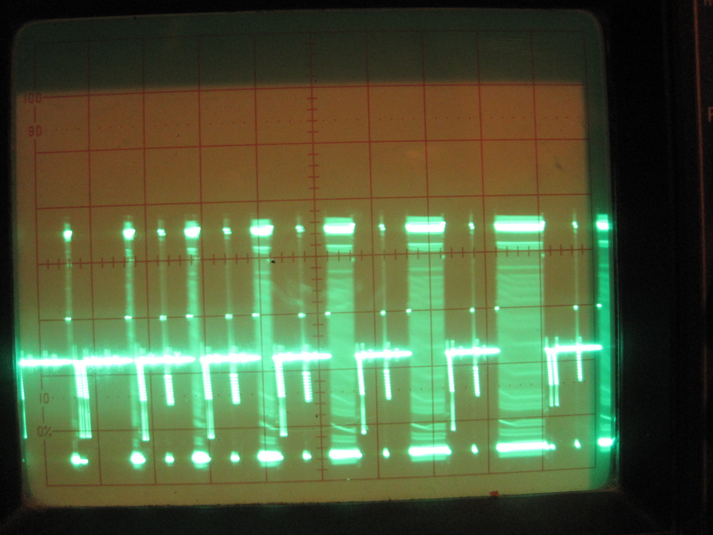

        With oscope settings of 5V/div & 1mS/div with 10X probe I got the readings below. Left pic - YSUS, Right pic - XSUS

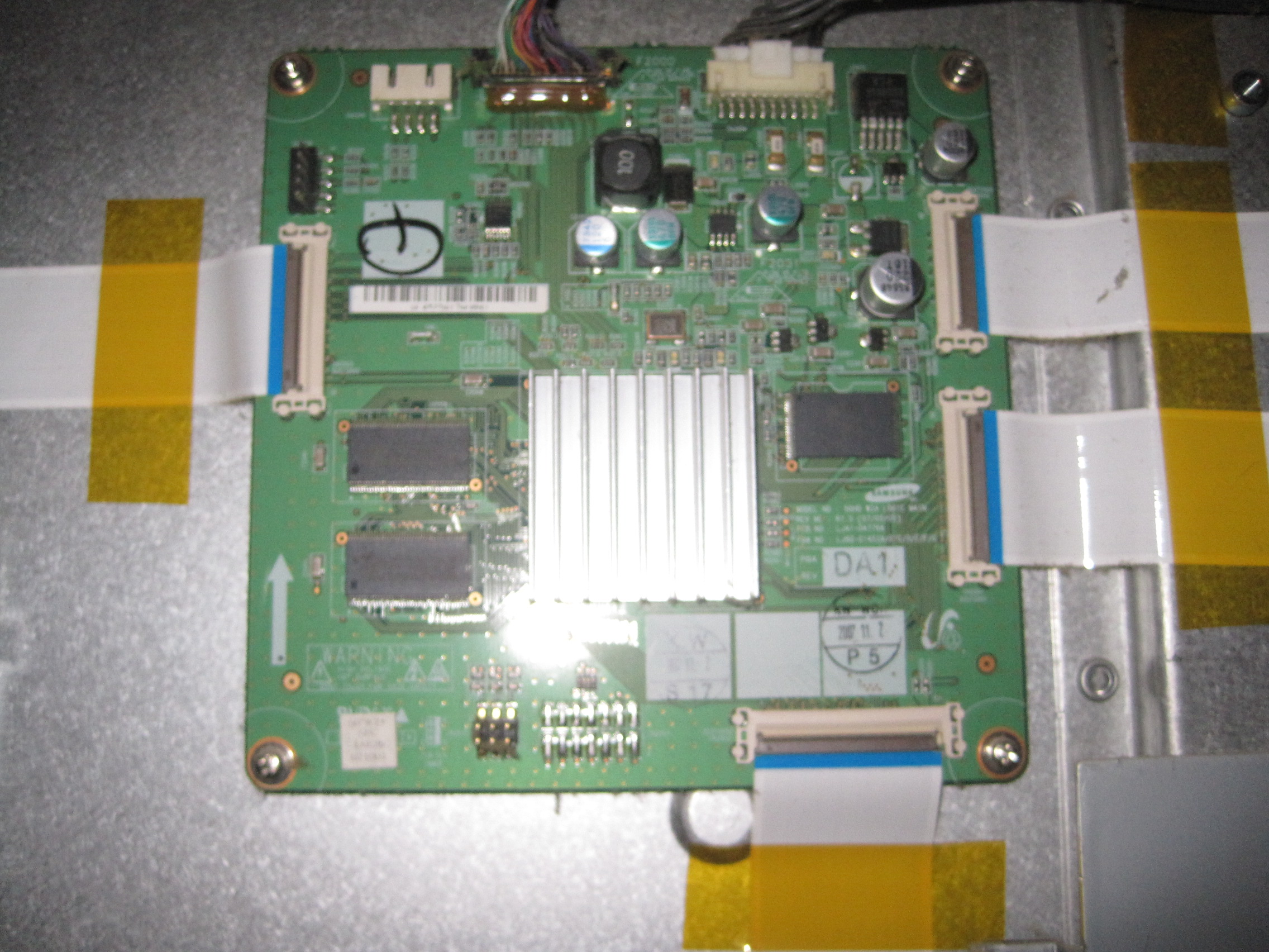

            Post a picture of the control board and the test jumper can be highlighted.

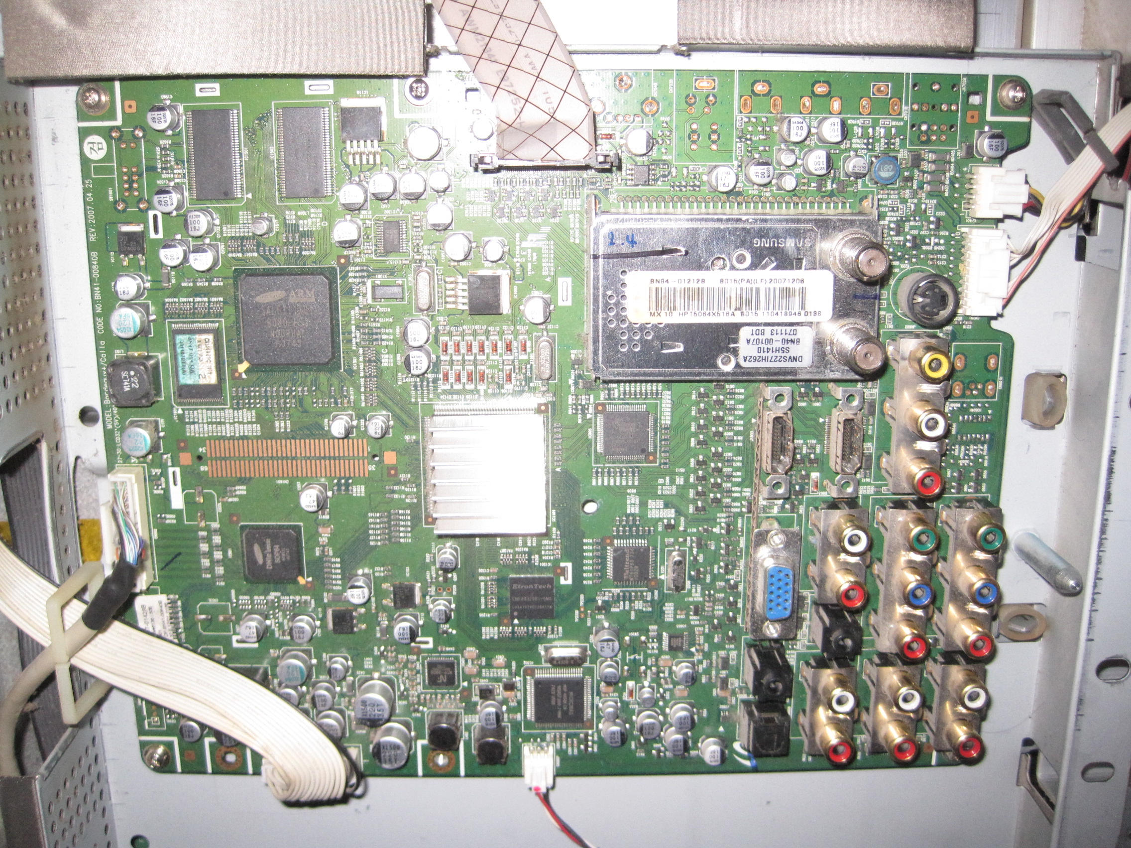

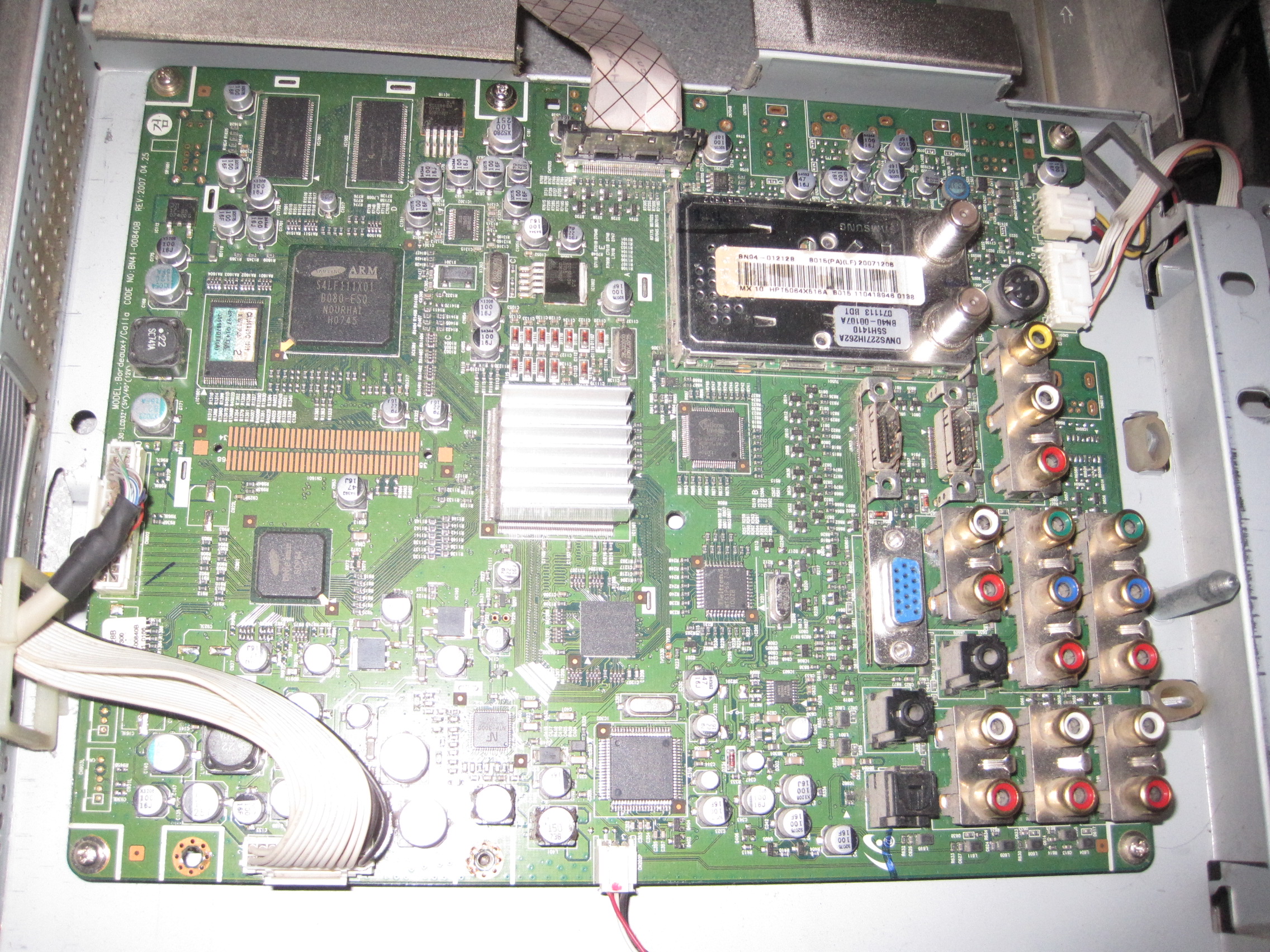

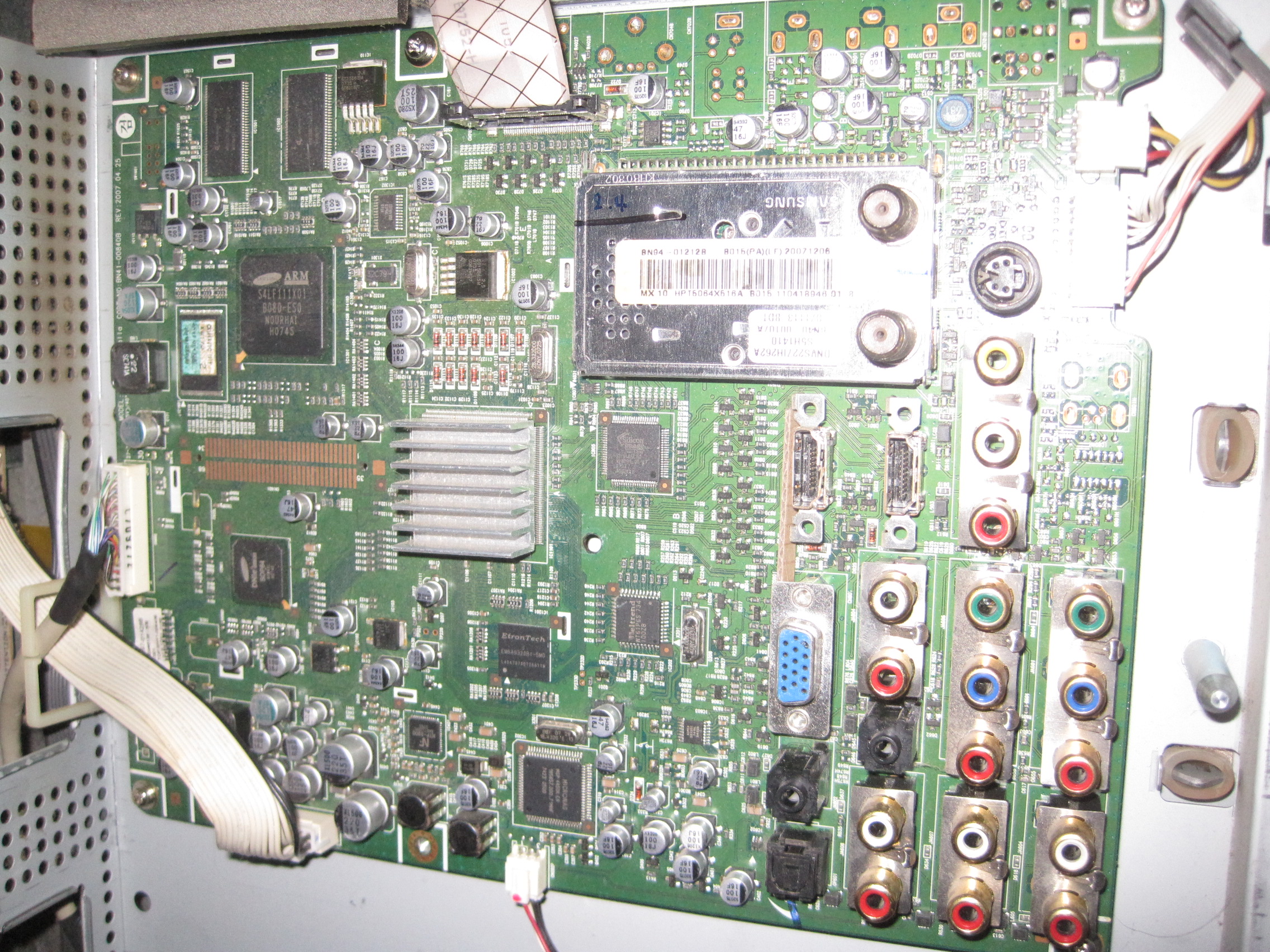

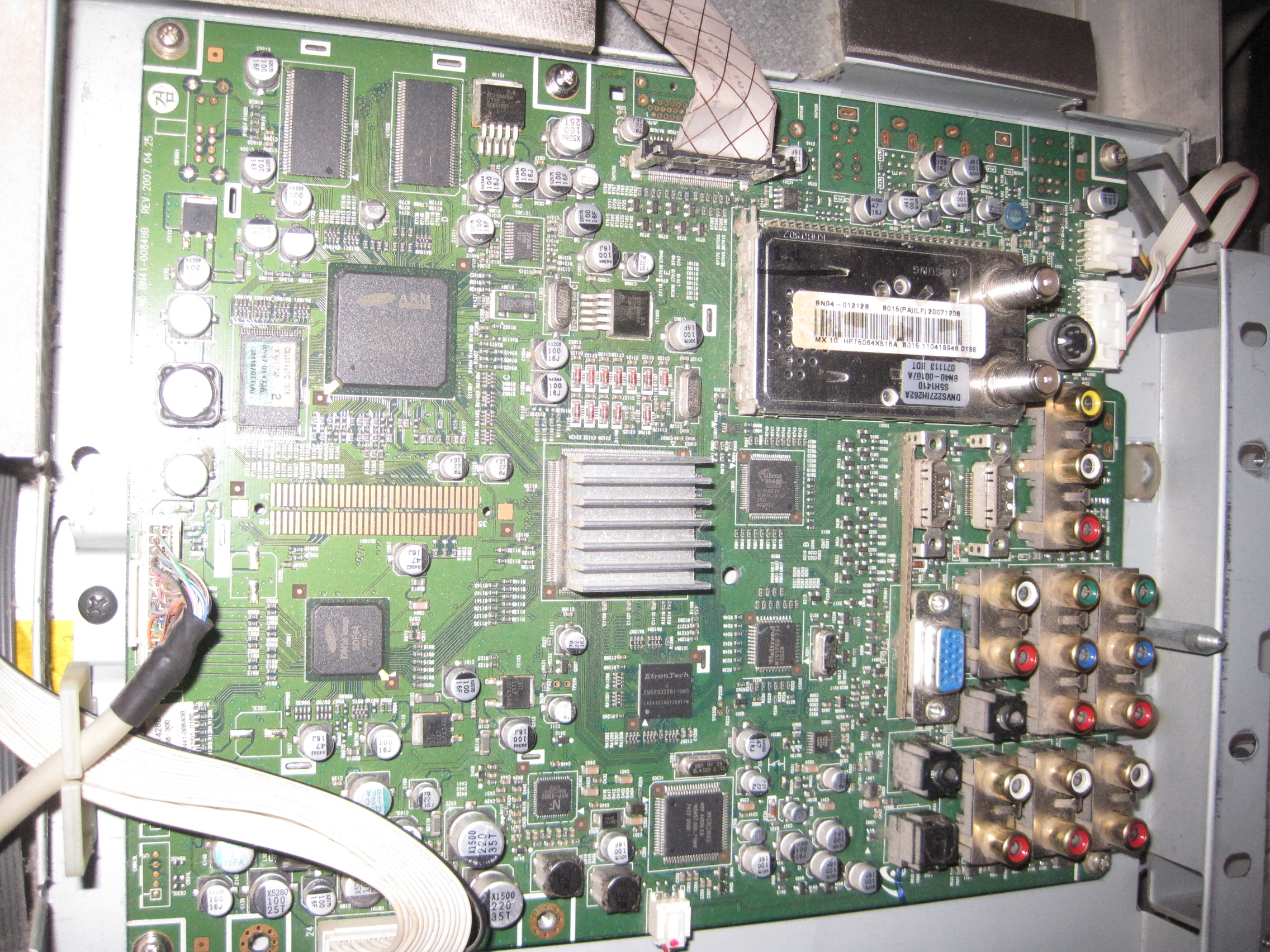

              Adjusting the picture settings didn't change much. I took a few pics since the flash seemed to get in the way and thanks for the speedy replies.
                  My apologies. The pics above are of my main board. The logic board is under it. I now see the 6 pins and should be able to figure out how to run the test from other posts.

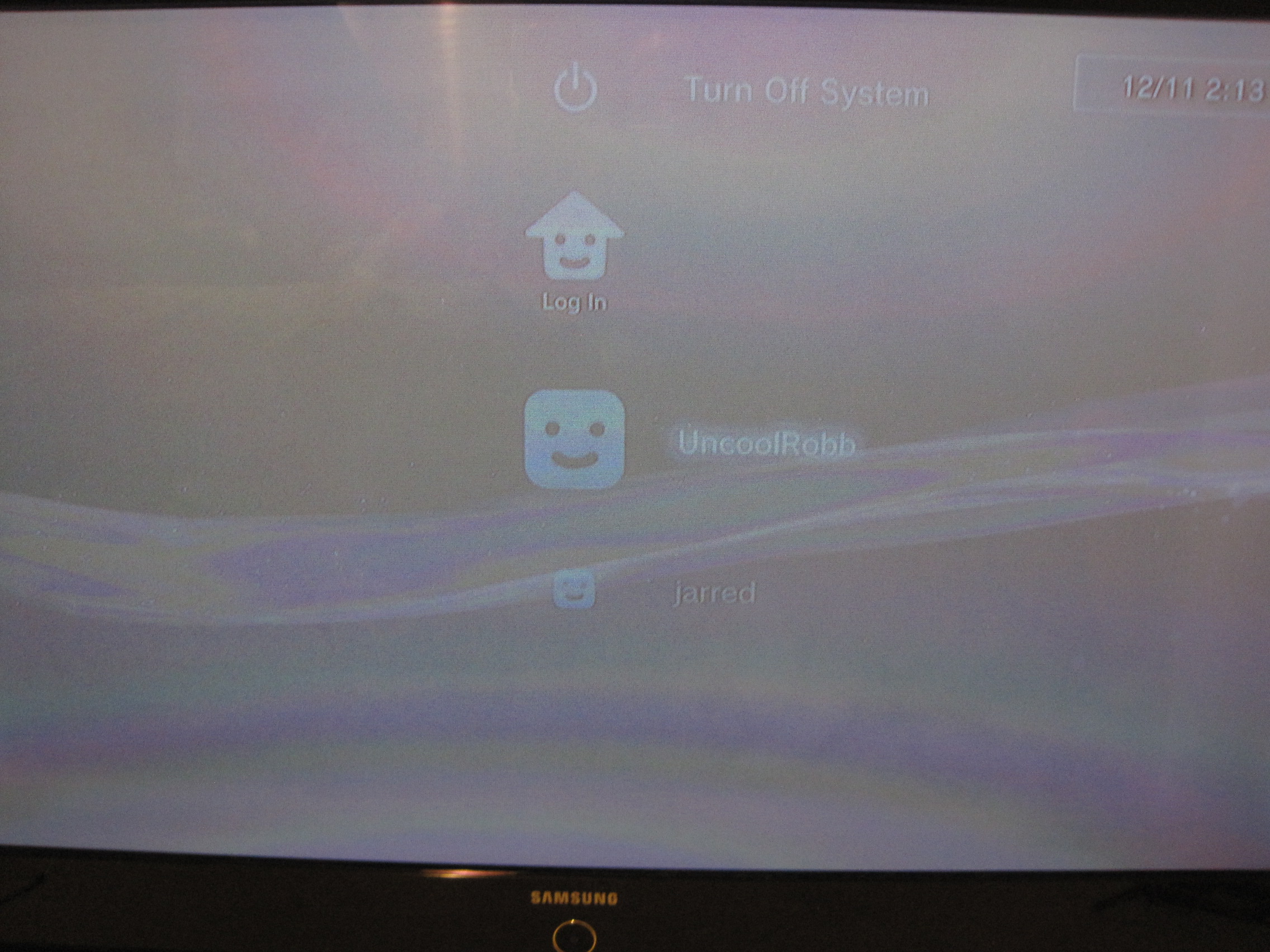

                    I used a HDD jumper to jump pins 5 & 6, disconnected the logic board's LVDS cable going to the main board & powered it on. The display patterns looked like eprogramming's Plasma Break In DVD. Accordingly, it appears I have a bad main board, right?

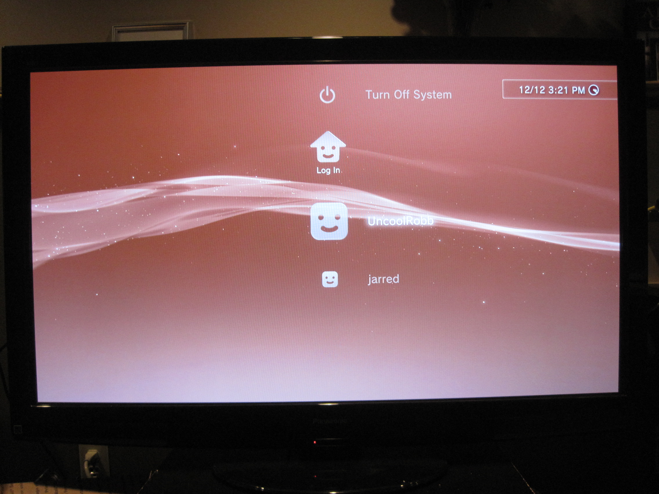

                      For reference, I posted a comparison of screenshots
                                      when you disconnected the LVDS cable and you jumper the control board and got the test pattern generator up on the screen did it still look lack of contrast and dim and washed out?
                                      • Robb
                                        • Sep 2013
                                        • 159
                                        Yeah, I got the usual lackluster image during the logic board test sequence.
