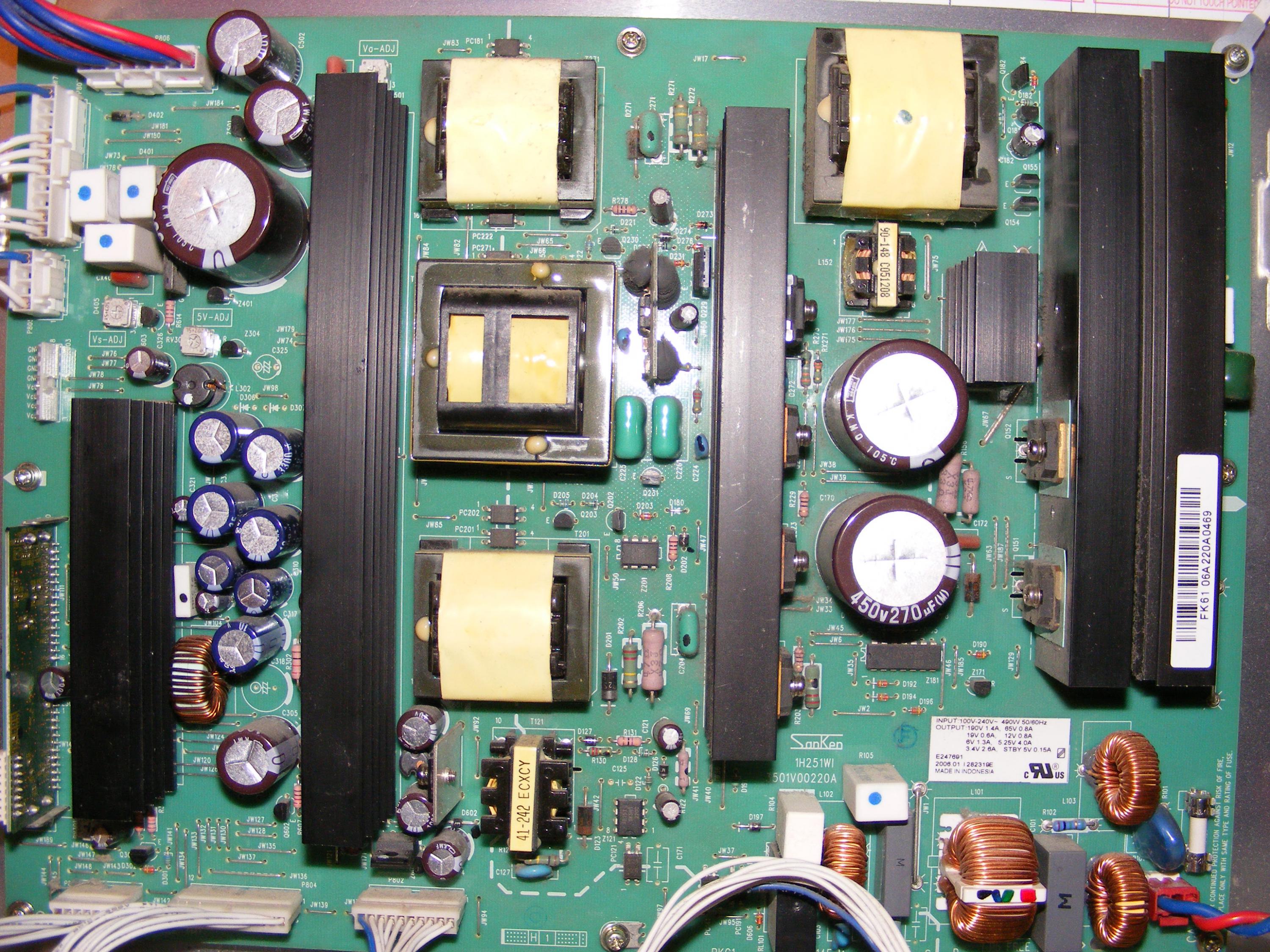

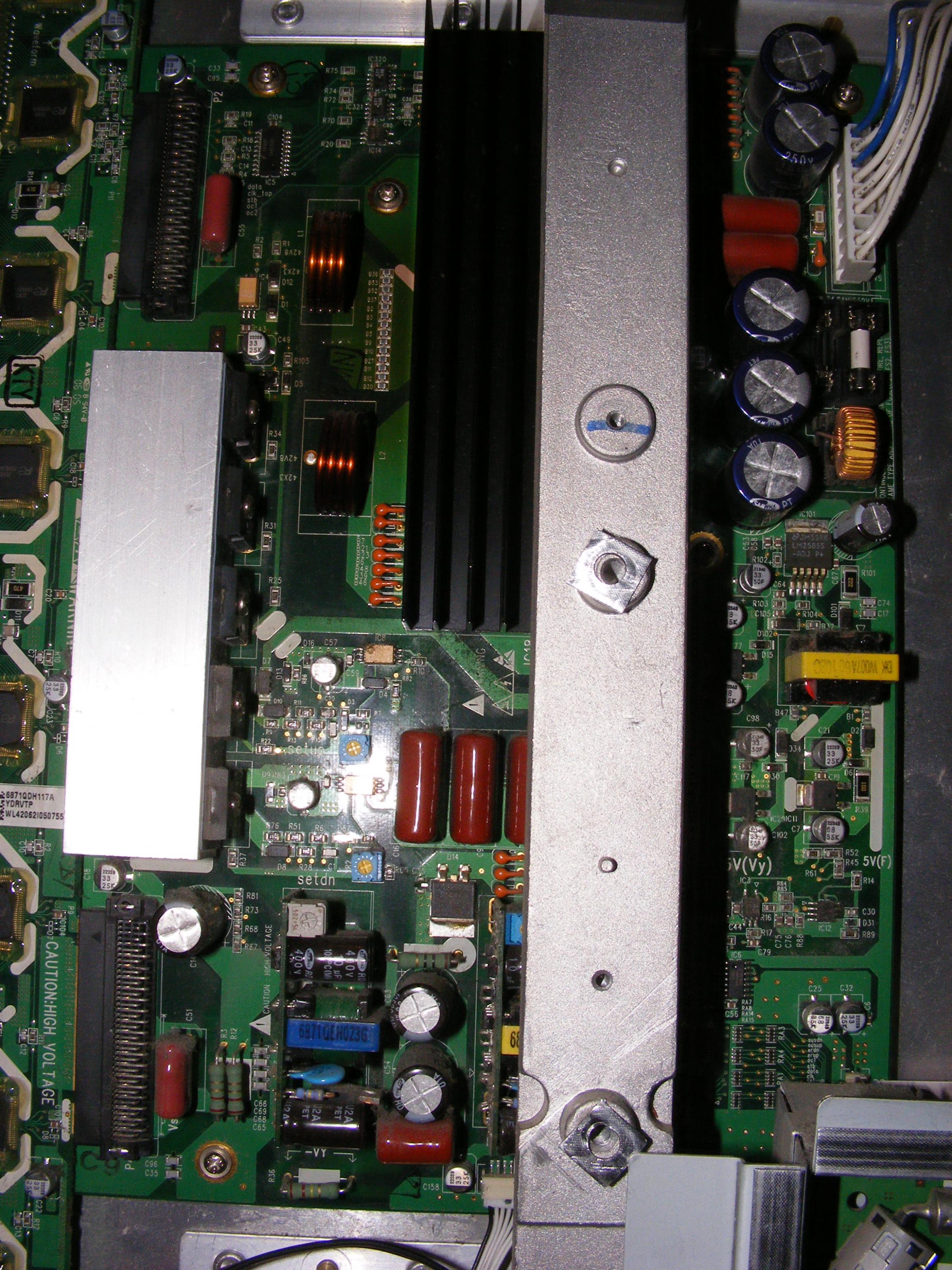

            There is one more issue with this TV I might need help with.
            When in standby there's a high pitched squeal coming from the power board. It goes away when the TV is on. I've attached pics. The second pic shows the rough area where I think the sound is coming from. The caps seem fine visually. What might be causing the noise?

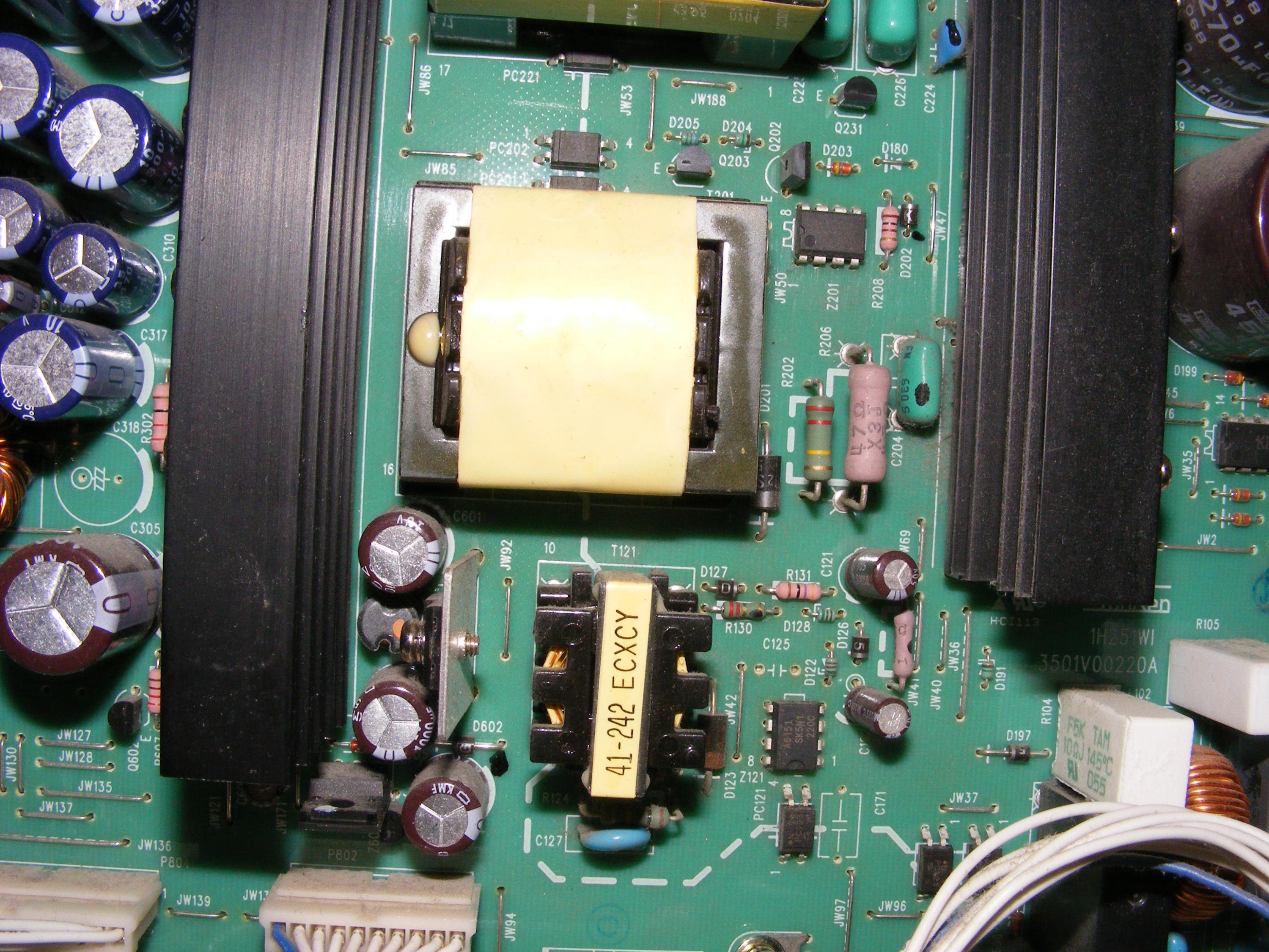

              Re: LG 42PX5D - no picture, replaced IPM
              Update: After hunting around with a pen casing stuck in my ear, I *think* the squealing is coming from the smaller transformer at the bottom of the second pic. It's really hard to tell exactly though. Any ideas what might be making it sing? Would love to get this one wrapped up. It's working really nicely except for the annoying noise when it's off.
                Sometimes this noise is normal, with the case on, you should not hear it from viewing distance. But if it is abnormal, I would try applying varnish to that transformer.
                  I can hear it from upstairs! But maybe I have sensitive ears. I had heard that bad caps or diodes around the area could cause the frequency to lower into the audible range. I may try the varnish on the transformer though. Thanks for the suggestion.
