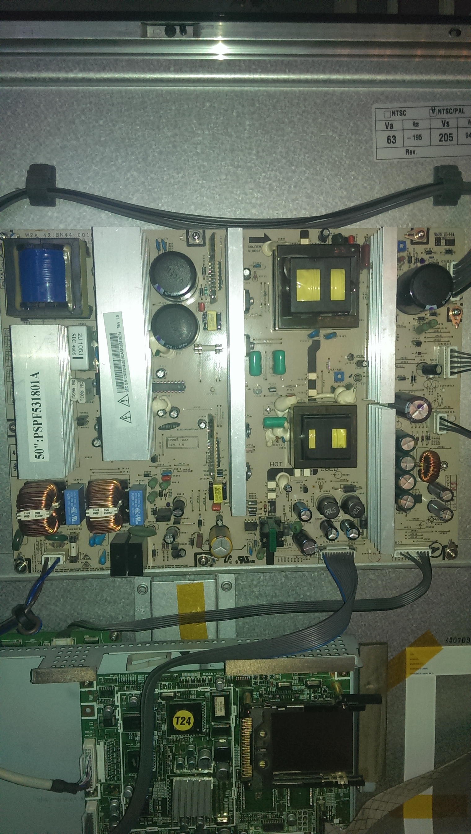

    Before I ditch my TV which has Sound with no Picture problem I thought I would put a post out and see if there is any rescuing it. I have tried all the tests on the forum and also followed every link through to the help videos and still no joy
    I had 4 capacitors on the PSU bulged so I replaced all 4 with higher voltage caps
    Green light on Y sus board so ordered and swapped this, Buffer board top IC blown so swapped both Y buffer boards
    I have tested every possible voltage and everything is testing as it should, i cannot find any cracks on the screen with the lights off using a torch and there is no flashes when first switched on it just does nothing except crystal clear sound. The only thing i can see but don't know if this is a problem is the LED on the logic board flashes a little more than once per second maybe around 30 flashes in 25 seconds
    Any ideas before i through away would be appreciated

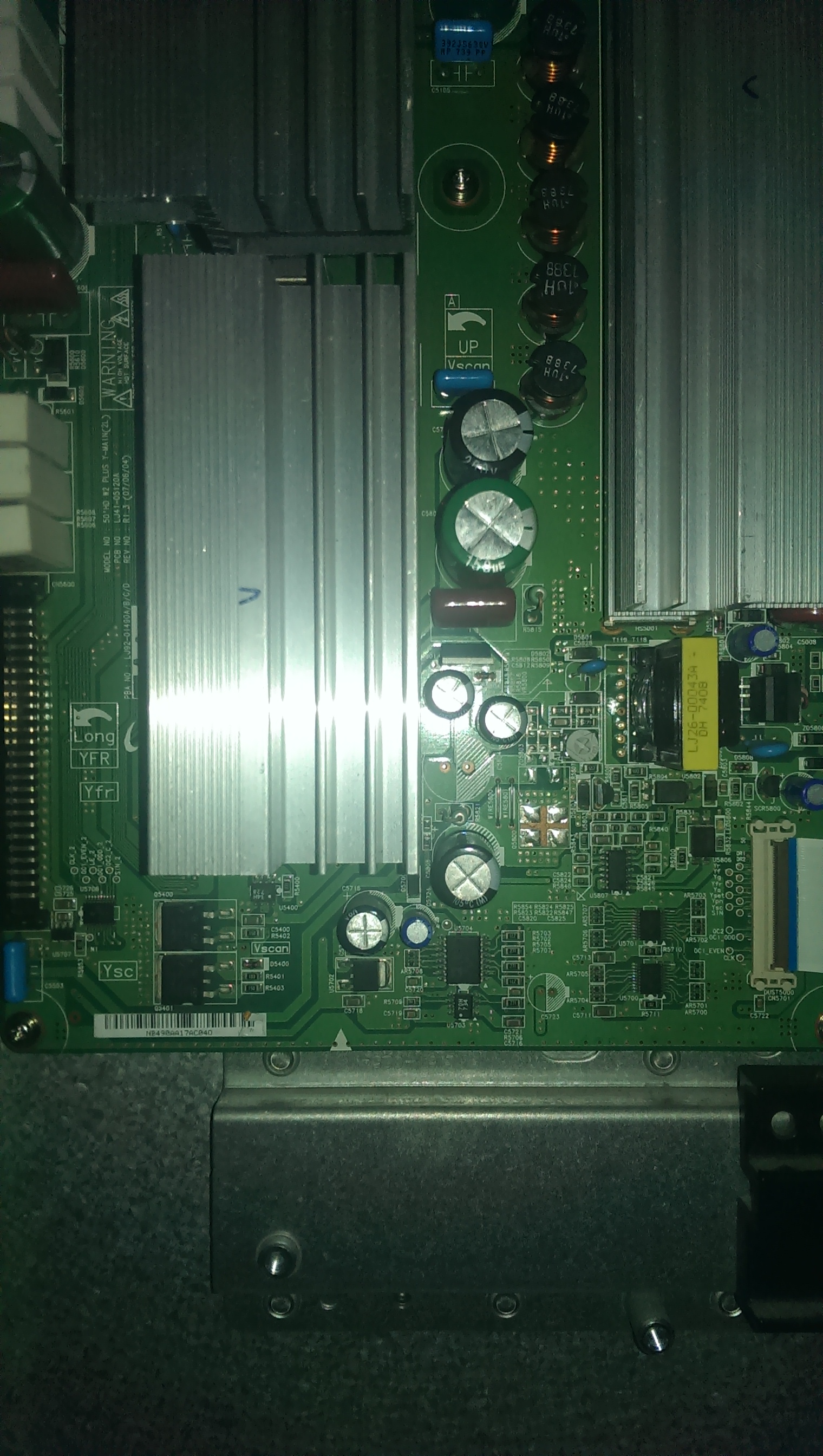

    Look carefully at the Y-main board. Down by the connector which hooks onto the logic board there should be a little LED light. Does this glow?
    Also, look in a dark room. Can you see any screen glow?
      Re: Samsung Plasma 50 inch picture problem
      Hi Tom
      No LED lights on Y main board and no glow from the screen
      Put all lights out and watched with TV turned on and no glow at all

              Can you see places to test the Vsc and Vset voltages on the Y-main board?

                  Sorry, my error. I meant Y-main, post edited.
                    Sorry Tom, can see a test point for Ysc near bottom left hand corner of Y main which is testing as it should
                    On Y main top right (at power board connection) I have Vs and Vcc which are all testing as they should also

                      Any sign of Vscan?
                        No I don't see any Vscan test point on Y main
                        there is a box in the middle of the Y board which says UP with Vscan written below it and an arrow pointing down to the left but don't see a test point

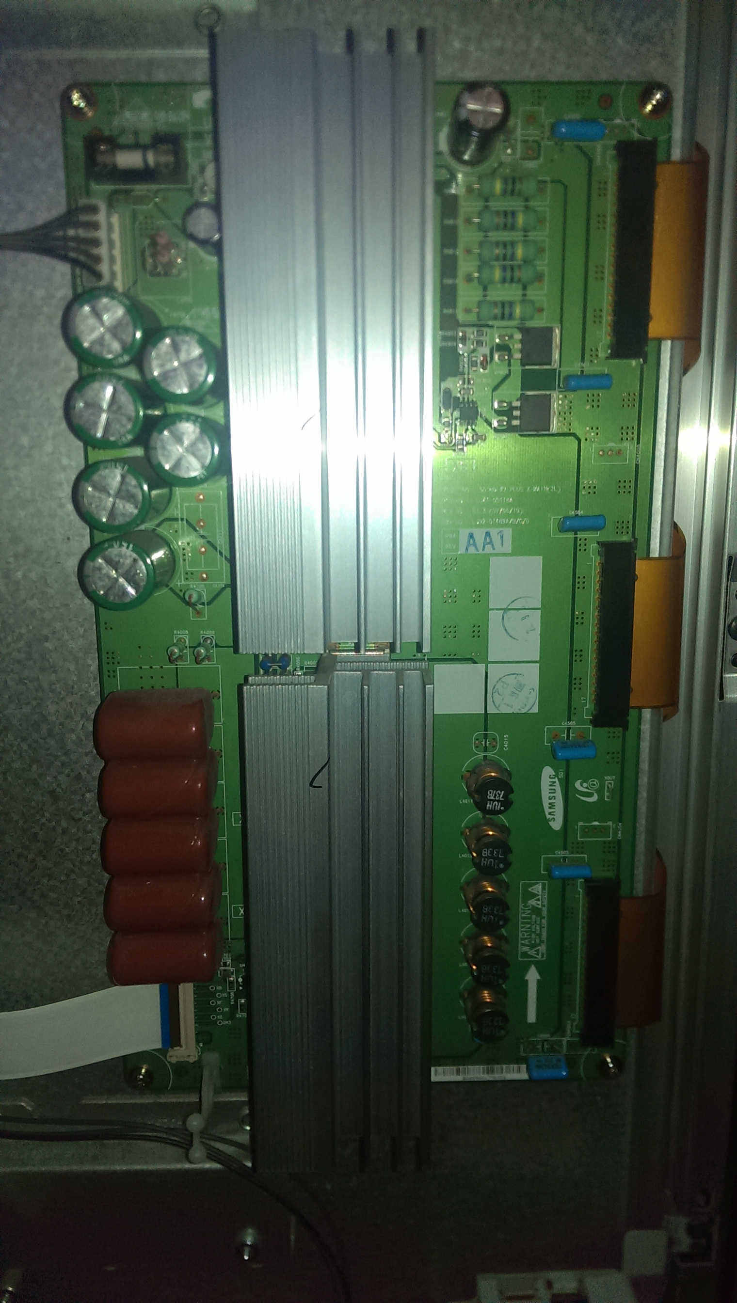

                        The only other test points are Vs and Ve on the X main

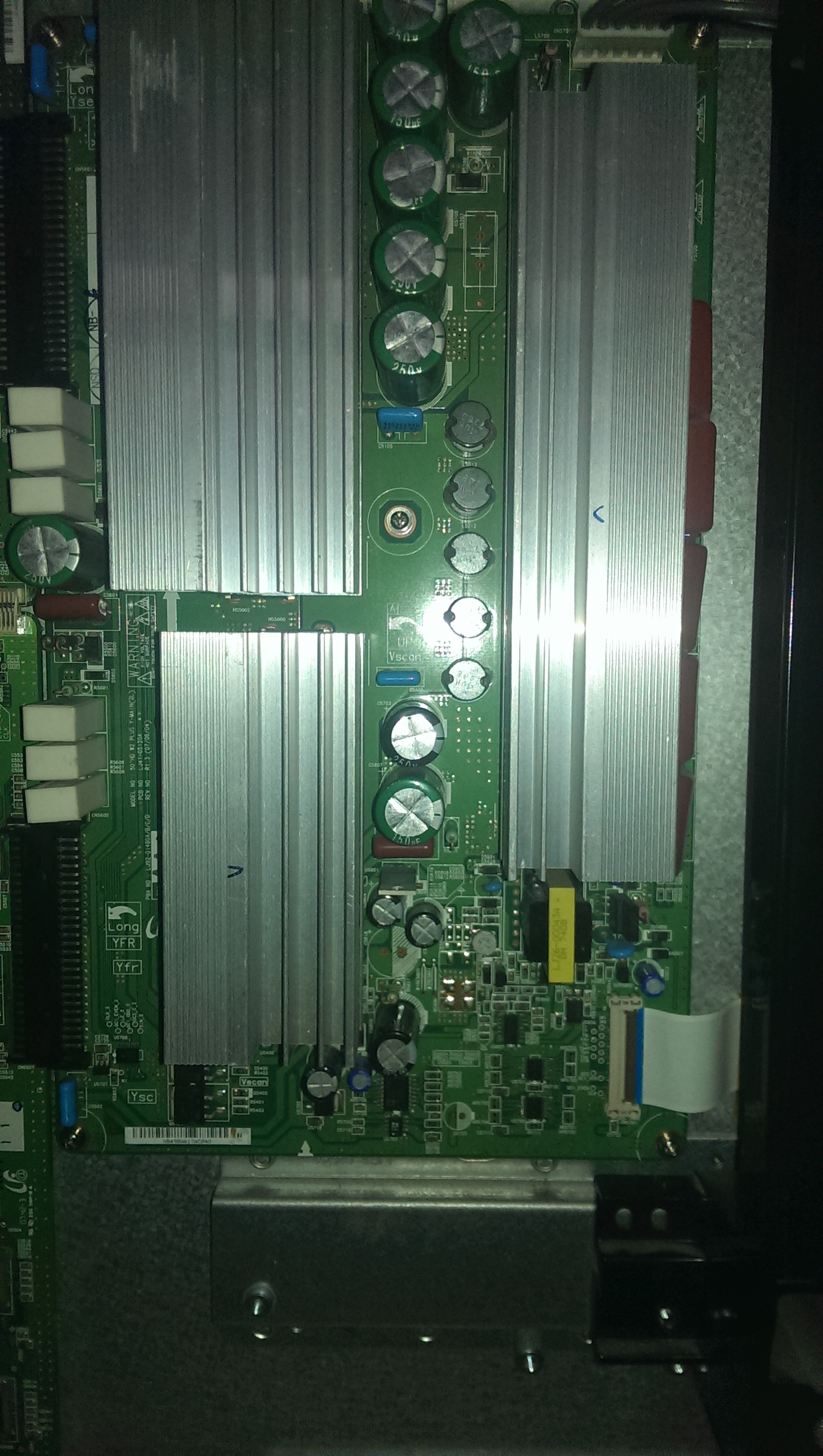

                          Can you post a clear photo of the Y-main board. I could swear there are test points on it, but now I'm not certain.
                            will do Tom, will need to be tomorrow
                              Found Vscan test point Tom whilst taking pictures, it is testing -194
                              If Vsc is the same thing then panel on back of TV says it should be -195
                                Hi Tom Vscan testing at -194 on Y main board
