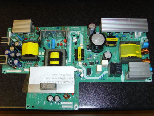

toshiba 42wlt66 clicking no light
    toshiba 42wlt66 clicking no light
    i recently replaced ic chips on the psu board
    i read a post about this problem
    but i still get clicking noise
    click turn on and nothing
    no picture or sound
    no red light for standby
    nothing
    does anyone have a clue
    ic chips replaced
    ic str-z4479
    ic str-w6765
    ic srx-2039
    i changed these but nothing different
    Re: toshiba 42wlt66 clicking no light
    Pictures of the boards and layout?
    Have you taken any voltage measurements to confirm if the PSU is working?
      Re: toshiba 42wlt66 clicking no light
      not sure where to start
      pictures of the psu board
        Re: toshiba 42wlt66 clicking no light
        i switch it on and dont get any standby light
        will any of the caps need replacing on main psu board or is there any other common faults
        that would narrow it down
          Re: toshiba 42wlt66 clicking no light
          Have you got any 5V standby output? Before even considering the main board as being at fault, make sure that it gives a solid standby output.
            Re: toshiba 42wlt66 clicking no light
            where is the 5v standby output located on the main board and do i check at the ir sensor board to see if there is 5v to the board for the light
              Re: toshiba 42wlt66 clicking no light
              I don't know but I do remember that these Toshiba power supplies have labelled outputs. I would check at the power board for now.
                Re: toshiba 42wlt66 clicking no light
                do you know of any schematics
                  Re: toshiba 42wlt66 clicking no light
                  thanks for your help i will have a look and get back to you
                    Re: toshiba 42wlt66 clicking no light
                    Yeah there are full schematics for the power board but you need to install Toshiba ZEUS. It is freely available on Elektrotanya but a right pain in the arse to get working.
                      Re: toshiba 42wlt66 clicking no light
                      Your board looks like the one I fixed here:
                      http://s807.photobucket.com/user/bud...?sort=3&page=1
                      https://www.badcaps.net/forum/showth...OSHIBA+42HL196
                        Re: toshiba 42wlt66 clicking no light
                        ive had a look and have found that the SMPS IC Q880 mabe the problem
                        i can see from the photos where it says (q880) but can seem to work out if it the ic chip on the other sider or a mosfet
                          Re: toshiba 42wlt66 clicking no light
                          i have found that its the ic strw6765(q880) that i replaced first and have re-soldered and fergot to ad paste/i have pasted and soldered 3 pins together as from your photo i will try it again now
                            Re: toshiba 42wlt66 clicking no light
                            still the same unless the ic strw6765(q880) is faulty or needs a different one
                              Re: toshiba 42wlt66 clicking no light
                              As you can see in my pictures and my link, I test the power supply board by itself using resistors, when I power it, the 12V was clicking due to IC Q880. I would power up the board by itself and find out if the the voltages are OK, verify the PFC voltage is also OK or not.
                                Re: toshiba 42wlt66 clicking no light
                                just re-solders ic chip and its works thanks mate
                                  Re: toshiba 42wlt66 clicking no light
                                  So you did not have to replace it, luckily it was not damaged due to solder bridge. Glad to hear it is working.
                                    Re: toshiba 42wlt66 clicking no light
                                    one of the pins that was soldered was broken so i re soldered it lower for the contact to work on the board
                                    fully working now
                                      Re: toshiba 42wlt66 clicking no light
                                      Hi Futurespec,
                                      Please advise. I have a 42wlt66 and just this week it started to making clicking sound for a long time. Eventually after 5 mins it does stop and turn on.
                                      What did you replace on yours?
                                      Which IC chips me and where did you buy them from.
                                      Many thanks in advance
                                      Usman786
                                        Re: toshiba 42wlt66 clicking no light
                                        Hi All,
                                        I bought the IC chip you mentioned above and replaced it. TV is working fine now.
                                        Thanks.
                                        Usman786
