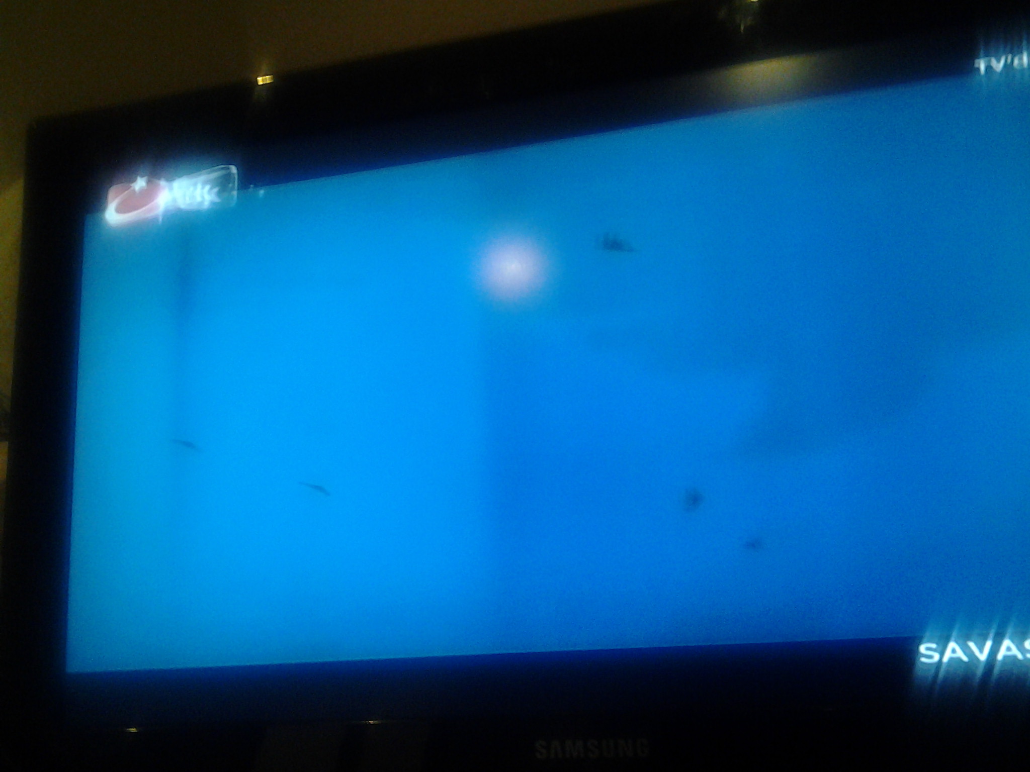

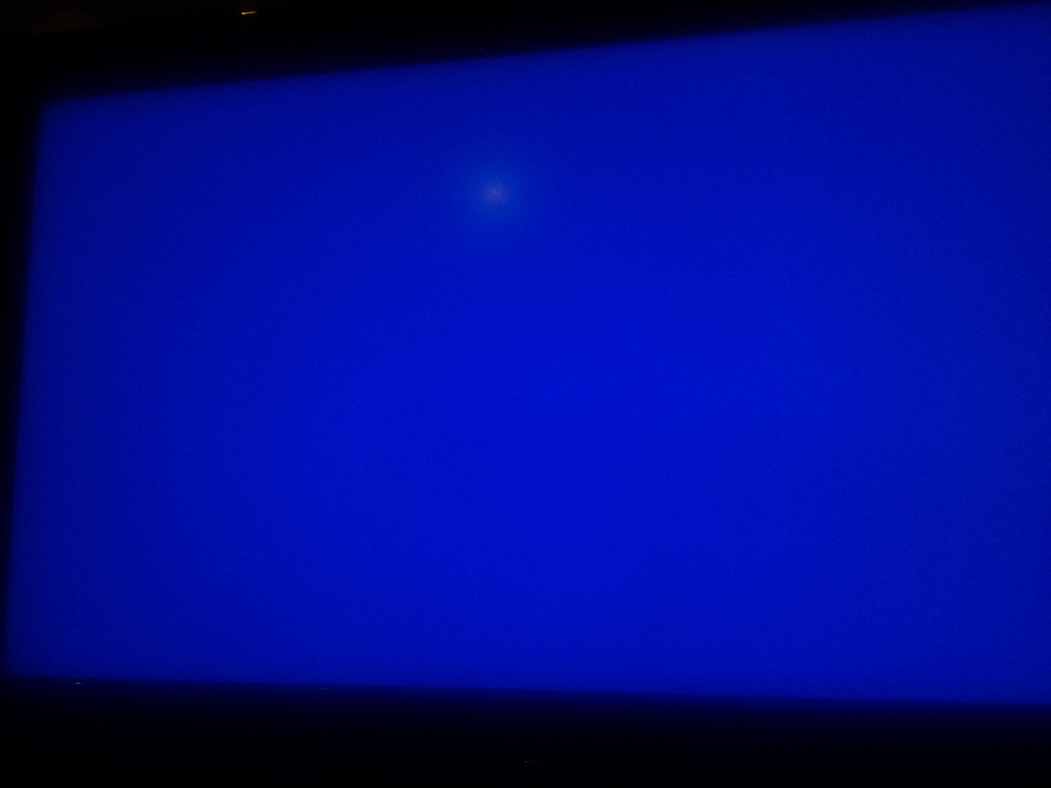

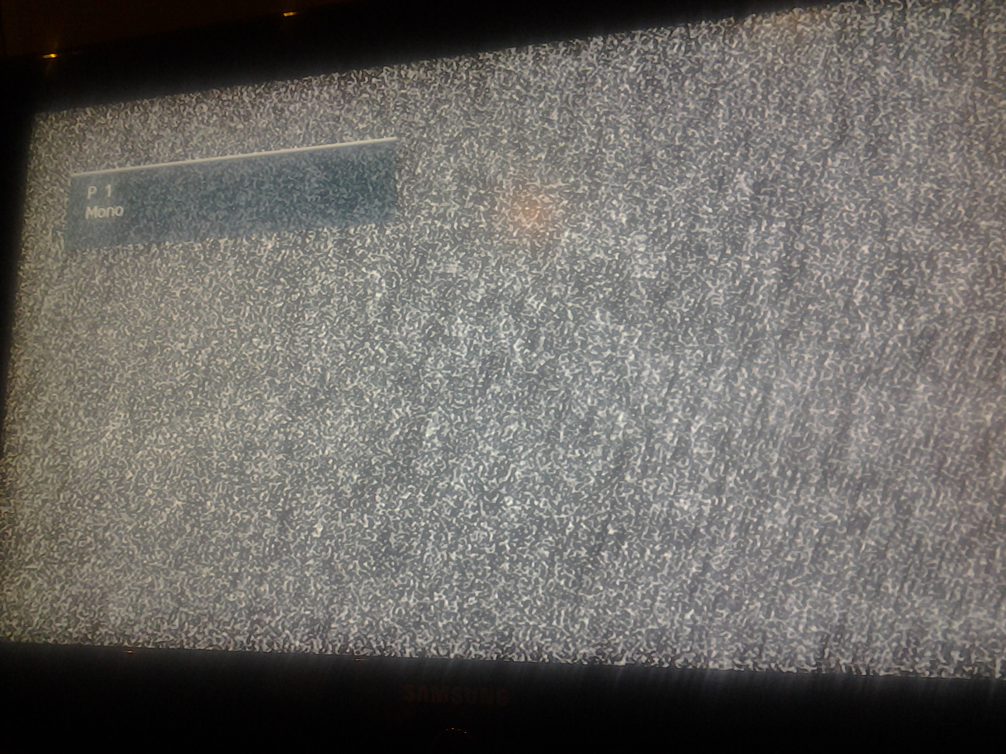

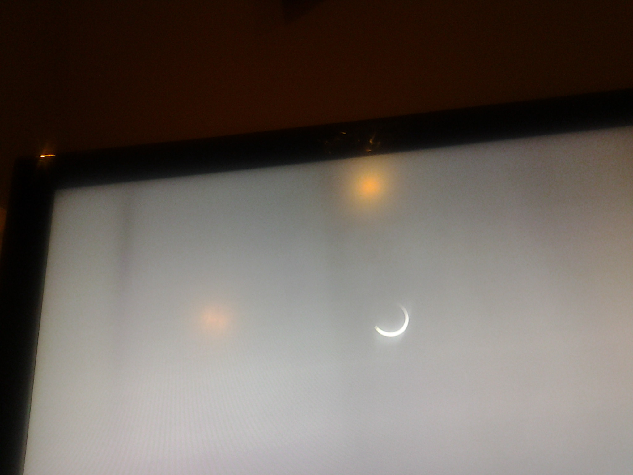

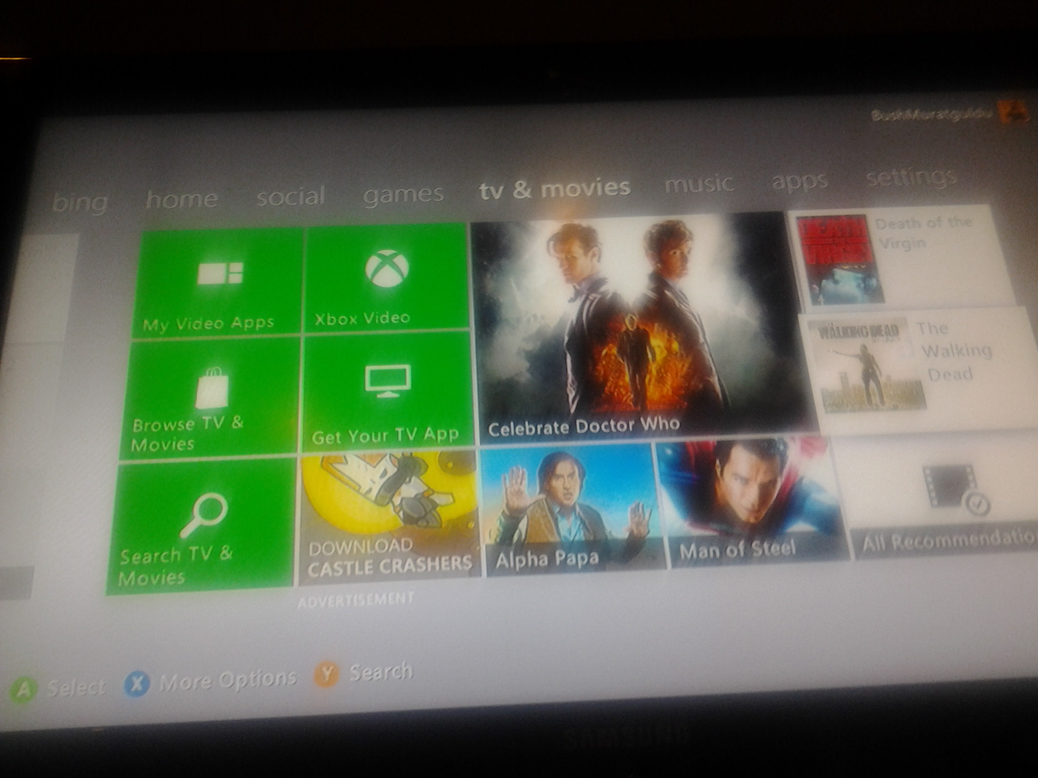

      Re: help pls samsung la327r1b
      there is some pic with hdmi pluged (xbox)right top corner and av tv box pluged in and when its blue screen (nothing pluged ) andwhen its snowing
          Looks like mura - defective LCD panel. But did it have this issue before?
            i havent aswell mate im just thinking its a faulty tcon coz faulty is not there when it on blue screen or snowing display as soon as something pluged in fault comes i really dont know i hope its a tcon board i just dont wanna put more money on this tv
              tom i thought lcd panel first but lcd panel issue should be there allthe time this issue not there when tv on snowing or blue screen it just come on as soon as something plugs in i dontget it mate i dont mate i got of customers he had inverter issue sound on no pic
                It's odd, but some types of mura are only visible under the right conditions. In the service menu you can access test patterns, what do these look like?
