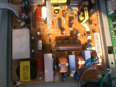

    Hi all,i have the above samsung,the power going to the inverter seems fine,iv checked for open cuircuit on inverter,cant fine any bad bits,could this be bad bulbs?how do i test? the inverter board is a inv32s12s,just some help,would a new invertor help?picyure is fine for 3 secs then out.i have a basic cuircuit tester and a capacitance tester,no esr though.iv tried heating the psu caps with hairdrier to see if helped but still same,but im getting good 24v to inverter,the transformers are all clean no burns smell or marks on the underside,can somebody help on how to test these properly?thanks for reading.
  • lookimback
    • Aug 2013
    • 1489

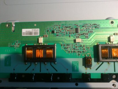

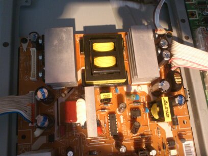

    Re: samsung le32r87bd loses backlight after 3 secs

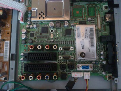

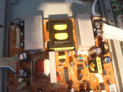

    Could you post some good clear pictures of the component side of your board?
    Take 3 pics.
    Left 3rd of the board.
    Middle 3rd of the board.
    Right 3rd of the board.
    That way we should be able to read the markings on the board.
        hope this helps?thanks for your reply
            Ok. For starters, test the fuse. I circled it on the pic. With the power off. Check for continuity through the fuse.
              was 1st thing i done mate,power getting to the transformers,and power going out,can measure whats going to the backlight as its too high for my meter

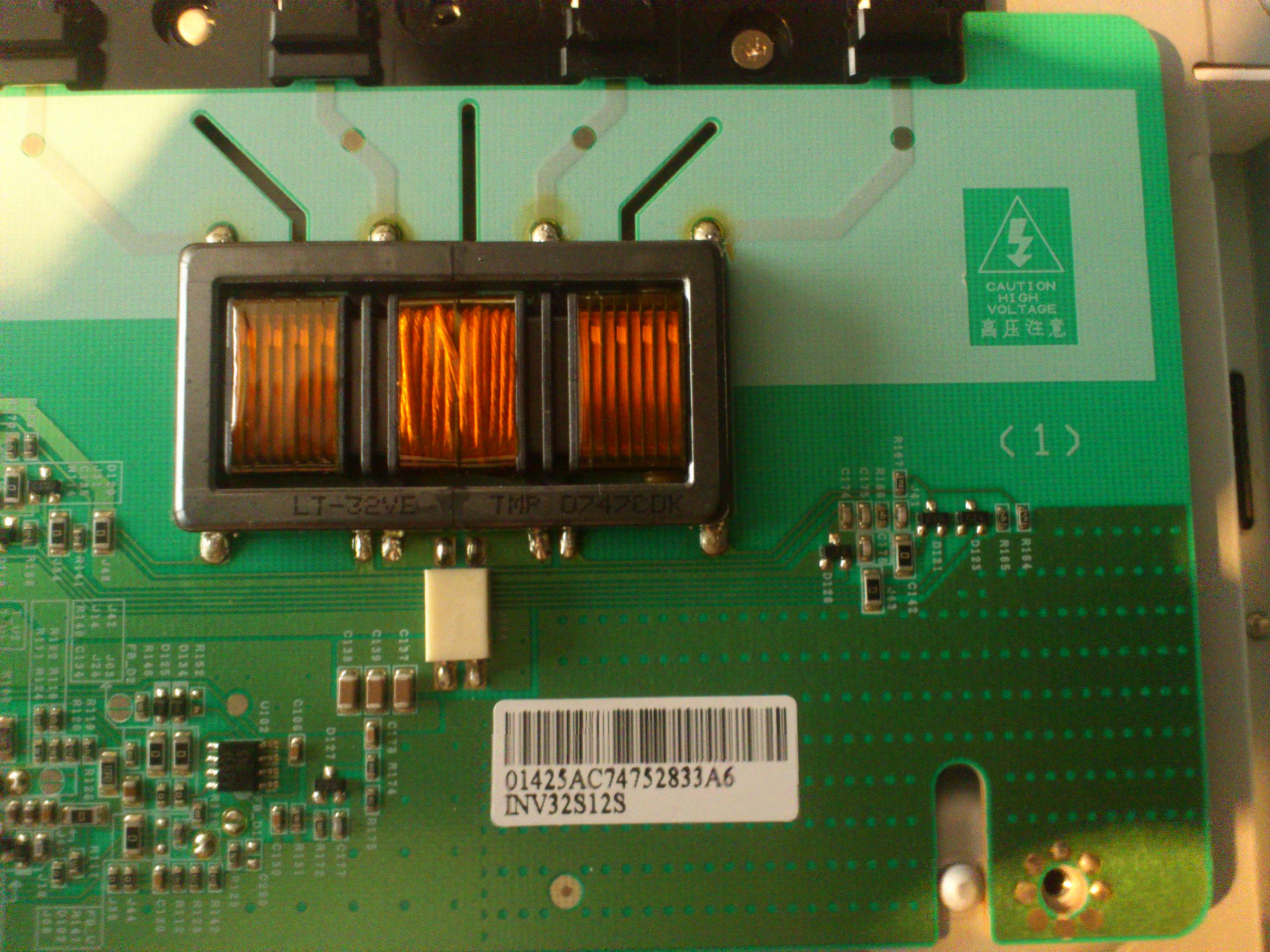

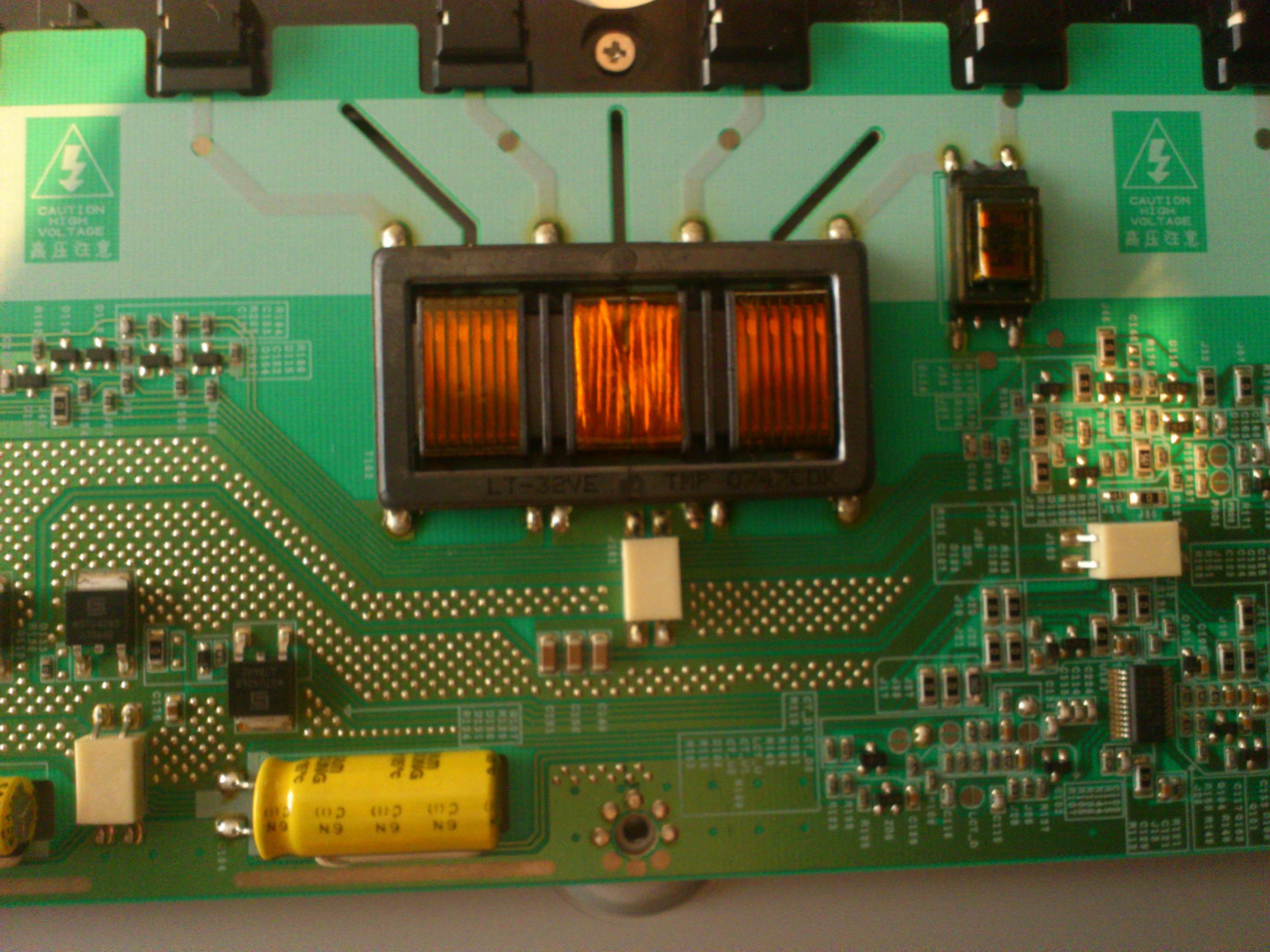

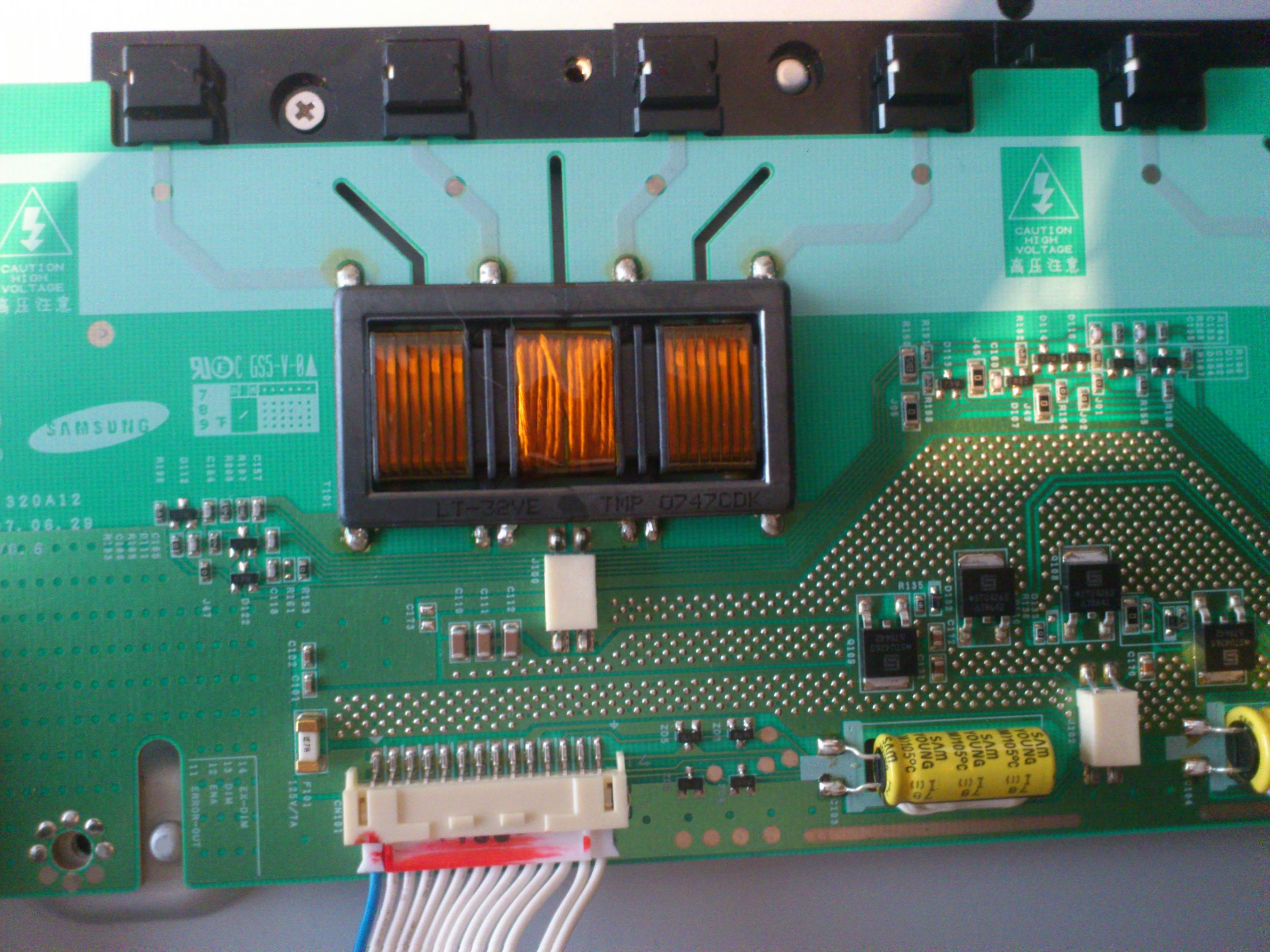

                    Check resistance of inverter transformers. With power OFF.
                    https://www.badcaps.net/forum/attach...1&d=1385298441
                    Between the two top left outputs, then the two top right outputs, of each transformer. Use 20kohm range. Report reading for each pair of connections.
                      hi tom,the readings i have are
                      1st transformer L=1.18 R=no reading
                      2nd L=1.18 R= no reading
                      3rd L=1.16 r=no reading
                      am i reading like you asked?
                      the top 2 on the left the the top 2 opposite on the right of the transformer?
                      excuse my ignorance!
                      • charlierfc
                        • Mar 2013
                        • 93
                        • scotland
                        sorry i take it you ment as it faces me!duhh!
                        ok again!
                        1st transformer L=1.19 r=1.19
                        2nd L=1.19 R=1.19
                        3rd L=1.19 R=1.17
                        silly me!

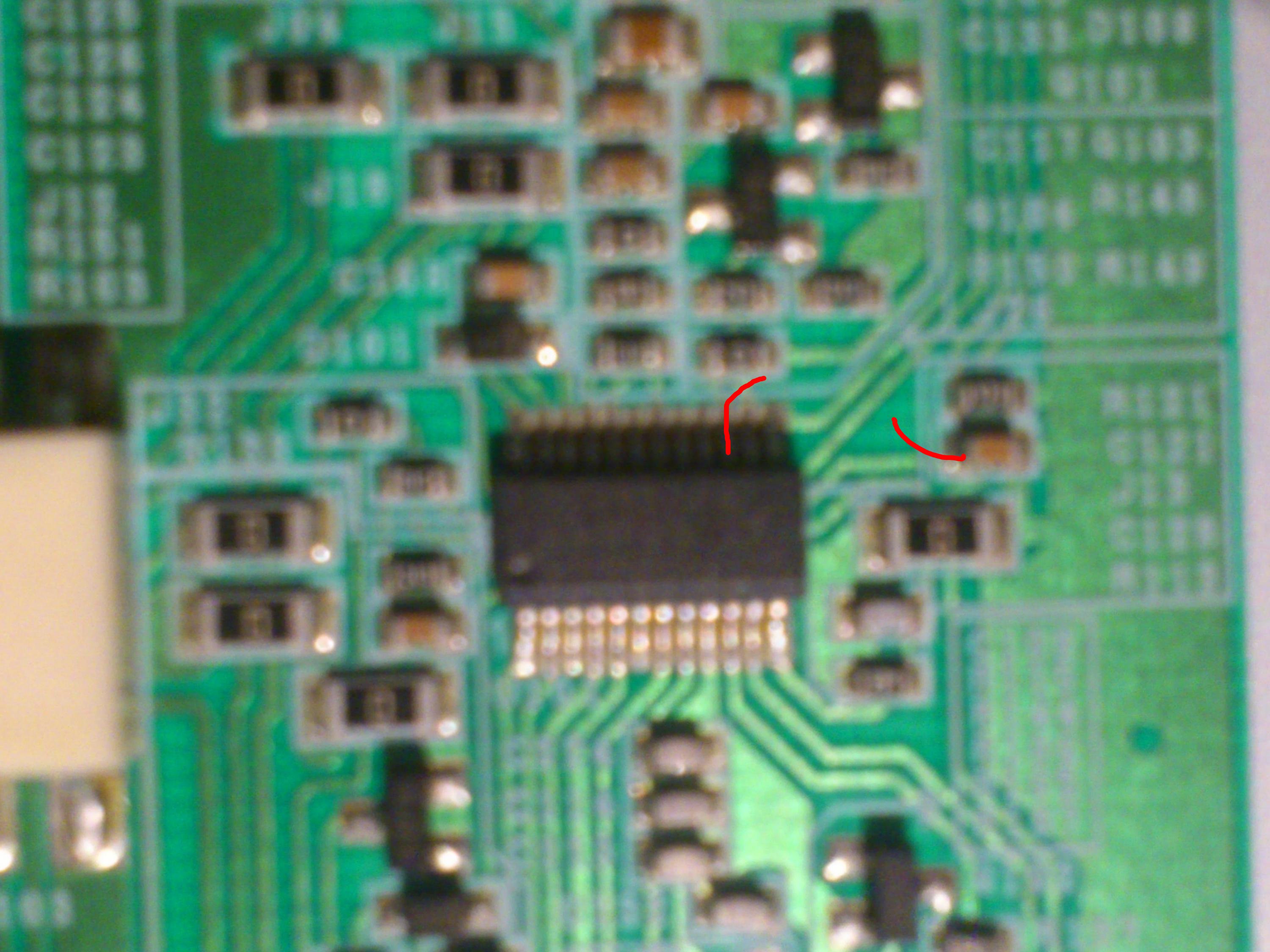

                            All your transformers seem OK, so most likely you have a bad bulb in the LCD panel.
                            In the top centre of this picture
                            https://www.badcaps.net/forum/attach...7&d=1385297274
                            there is a chip for controlling the backlight, can you read its part #?
                              a99f 745 the 8 legged one?
                              • charlierfc
                                • Mar 2013
                                • 93
                                • scotland
                                0z9966sn
                                ma9834.1t
                                0735b1
                                is whats written on the larger one with countless legs

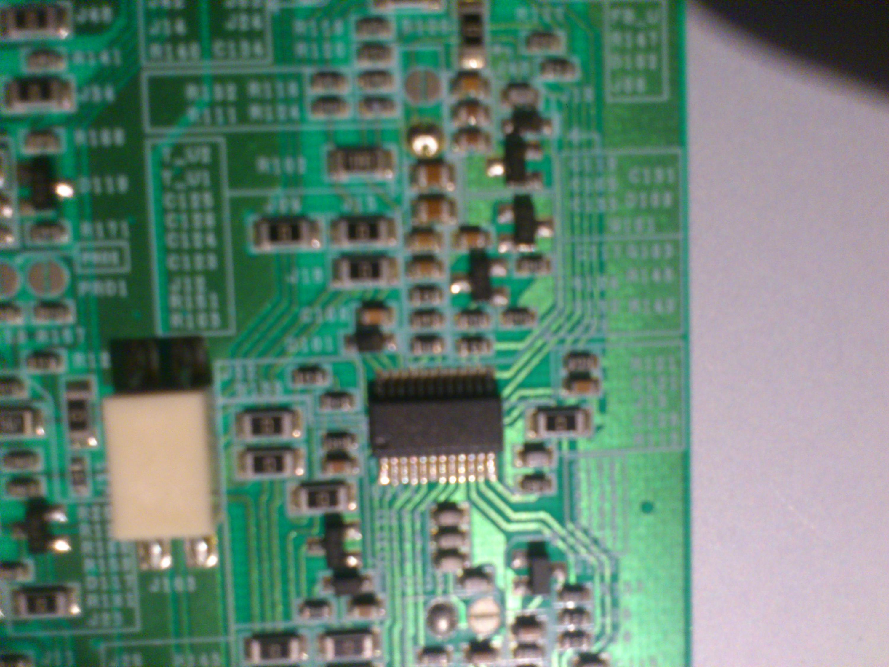

                                  OZ9966 is the one of interest. Need a closer pic of it. You can place a solder jumper, which will disable error detect, enabling you to see which bulb in the panel has gone bad.
                                    • charlierfc
                                      • Mar 2013
                                      • 93
                                      • scotland
                                      sorry for lack of quality,my camera refuses to focus up close,ill try again if you need it,thanks tom
                                        Please check and see if there is continuity between pin #15 of the IC and the end of the capacitor I have marked.
