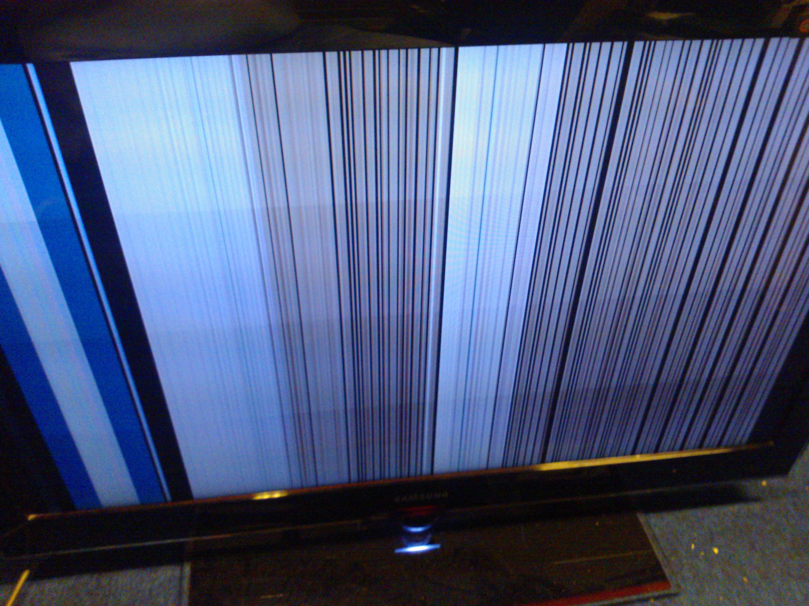

    Samsung LE40A866 vertical lines
    Hey all
    Samsung LE40A866 vertical lines. Give me your best shot.
    It appears the top line of graphics is fed to all lines from top to bottom.
    Mainboard, T-con, or a panel issue?
    Re: Samsung LE40A866 vertical lines
    I would vote panel, then t-con possibly but unlikely. Main board I would say NO. Rare possibility of power supply faulty, but I assume you've ruled that out first?
