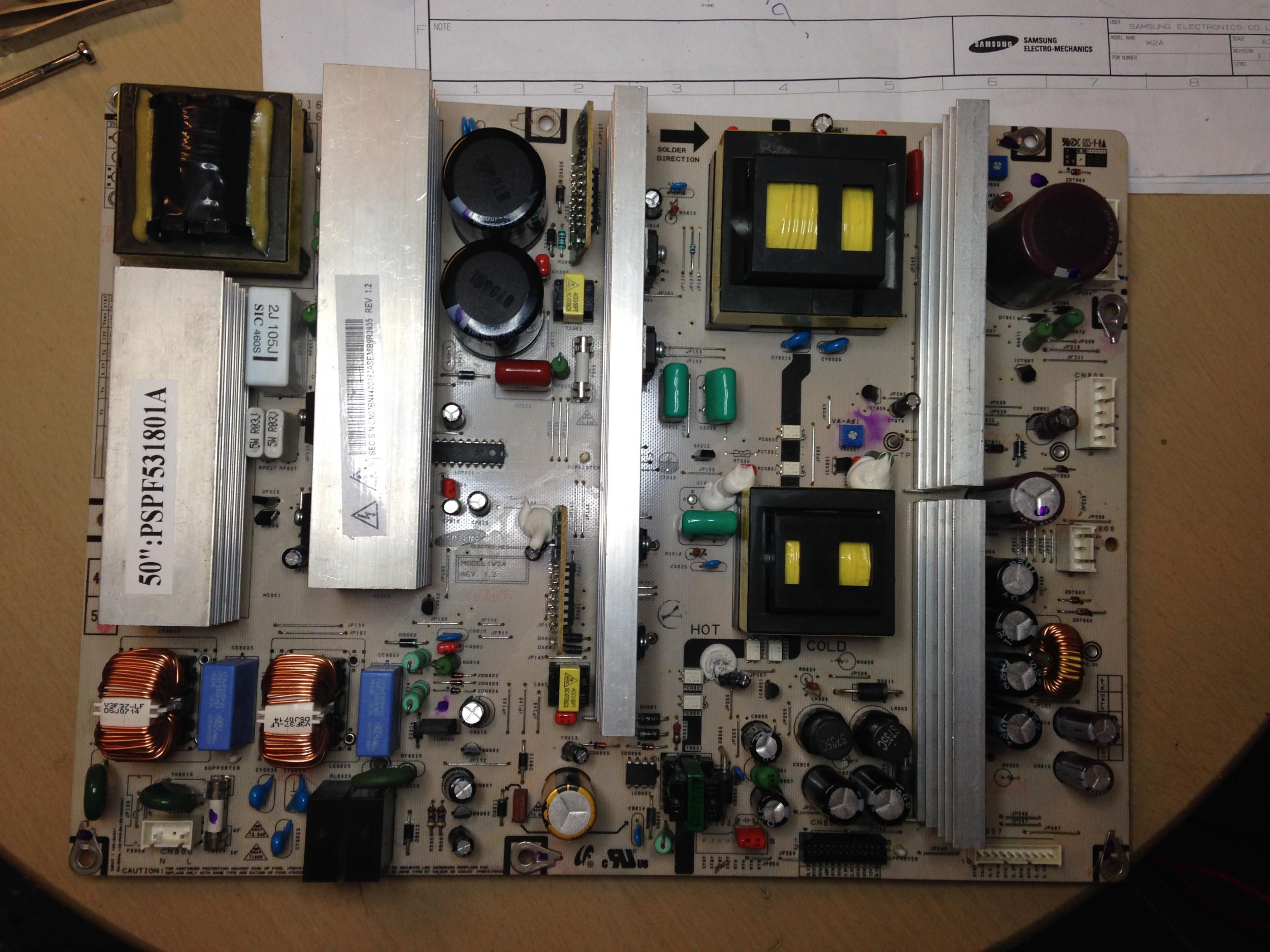

              Hello gents
              Could you please tell me what the problem is if I haven't got 5V on stby ? I only have 3,2V or something like that and I don't know why? I have measured everything from that area and they seems to be ok.
              Could you please give me some advice for a beginner? I'm not stupid and I've fixed the ex PSU but this one is doing my heading. The PSU came from USA and I'm wondering if its any problem as they are using different voltages?
              I'm looking forward to hear from you guys.
              Thank you

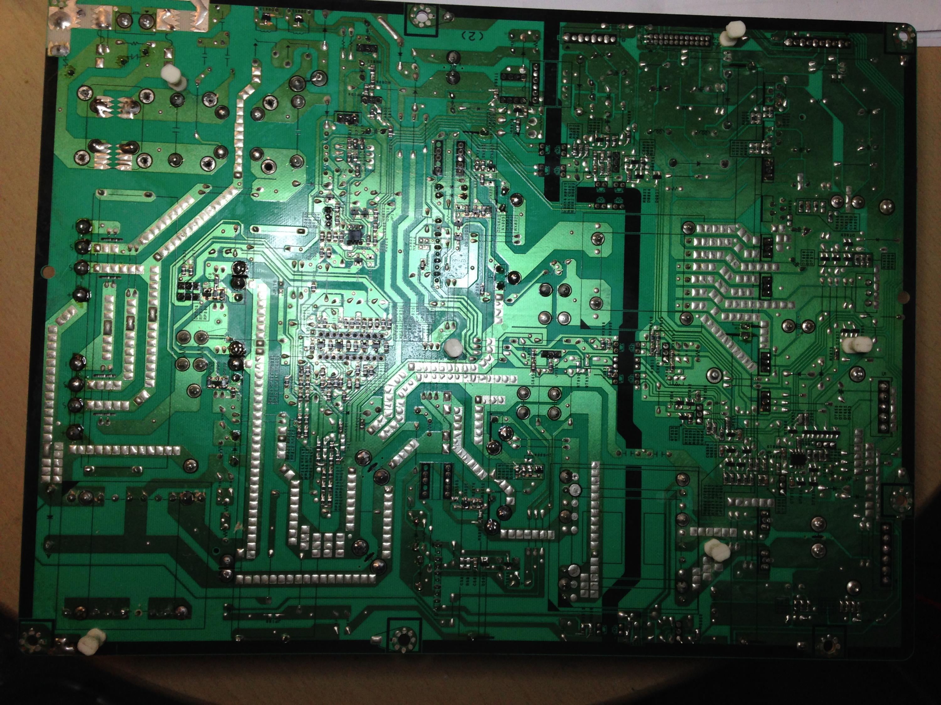

                Pictures of your board?

                  Re: Samsung HPT4254X BN44-00161A P.S.Dead
                  Hello
                  I have attached 2 pictures. I have replaced the mosfets, smd resistors, diodes, capacitors but still no click. Its something on st by I think but I haven't got too much experience to find the problem. That's why I need your help.
                  Cris
                        Hello
                        I had a PSU which I've managed to fix it but then I've done a short and I burn it and it was dead. Few weeks ago I bought a PSU from UK as was cheap and now I'm trying to fix it.
                        The voltages I've got just 3.4V at CN807 and nothing else. I've checked the mosfets, bridge rectifiers, caps, controllers etc and still dead. I took the chip ICB802 viper from the old board and I've change it, I changed a new ICP801, I've changed the SUB1 and SUB2 chips, transistors smds. Still no click. Its doing my heading but I'm never give up.

                            Hi you need 5v standby on the board when you have this then PS-on needs to go low and the relay will click then you need he VS-on to go high that will bring the rest of the board to life, I have found in the past that the main fault with this board will be the lead free solder used and cracking on components you need to have a good look on the back of the board and just reflow were you see any bad joints Flocko

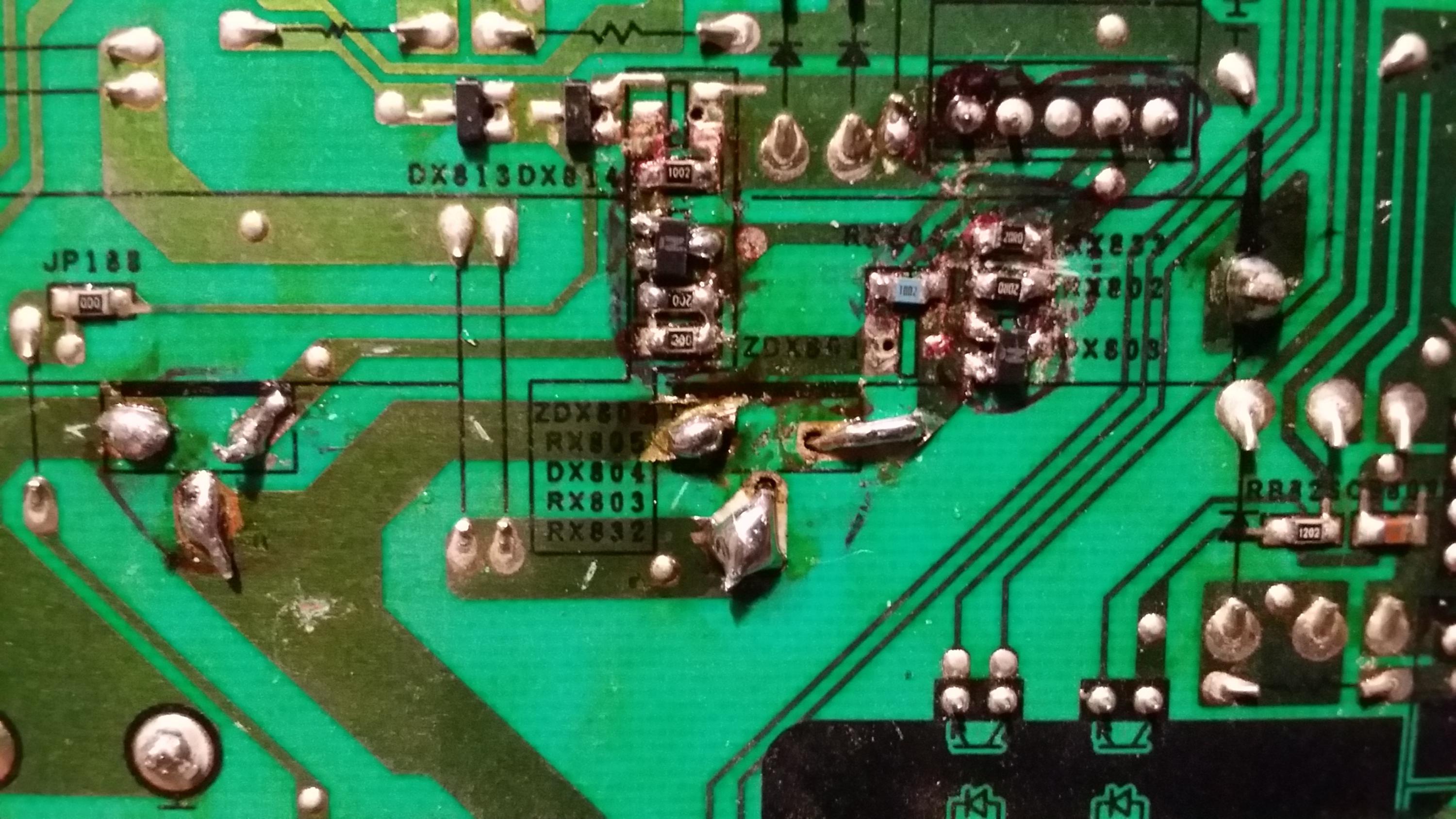

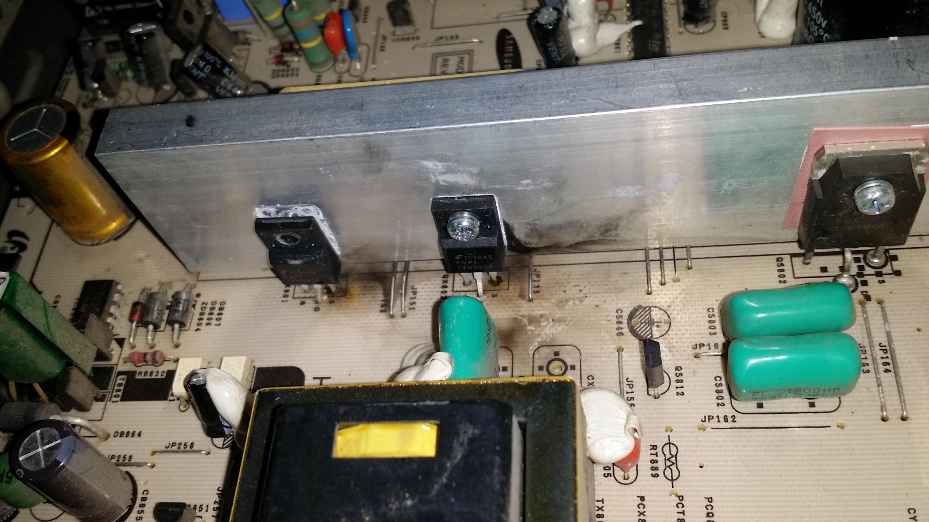

                                  I have the same board with the the HPT4254X set. Ive got a problem with constant clicking and the set never fires up. Upon inspection this board was previously repaired. I dont know if the parts are correct from the information I have gathered here, The supposed replaced components which are questionable are shown in the pictures I have attached.
                                  Does anybody know the correct reading I should be getting from these? Should they be taken out of the circuit when testing the readings?
                                  This is what I am getting with my meter
                                  RX832: 9.95K
                                  RX803: 9.94K
                                  DX804: 9.94K
                                  RX805: 9.94K
                                  RX804: 10.3
                                  RX802: 10.0
                                  RX833: 9.9
                                  DX803: 10.0
                                  Im not sure what kind of reading I should be getting from the IC36AS that are on the heatsink. It looks like there was previous damage here that has been repaired from the old ICs but I cant be for certain if its these ICs that caused the soot left on the heatsink. I removed one and looked it over and didnt see any visual damage, but I could be wrong. When plugged in it just does the repetitive clicking, I do get 5v on my standby though but nothing else.

                                    I would check every power mosfet and transistor for open or shorts. Then check the diodes forward and backward resistance with the diode check on meter. may have to lift one leg of componants when checking. Check ESR on electrolytic caps. Tedious I know. Check reistors for discoloration due to heat. Viisually inspection dont always show a reistor that is burnt open. If you find a open reisistor check the mosfet or transistor associated with it. All fuses OK?

                                        Alright, I checked all the diodes they all seem to be okay. I seem to have something wrong with QX801, Qx802. Are these IC's? Either way one shows a short on all legs so something is up with that but what are the values supposed to be at for these. This is what is printed on them IC36AS, FQPF, 13N50CF. Also the leg these are connected to is where all the other components are that have been replaced. Any suggestions from here would be helpful. Thanks.
                                        To add, I do get 5v on the standby but anywhere else Ive tested either a low reading compared to what it should be, all the while the clicking goes on in the relay.
                                        Didnt mean ICs, meant mosfets
