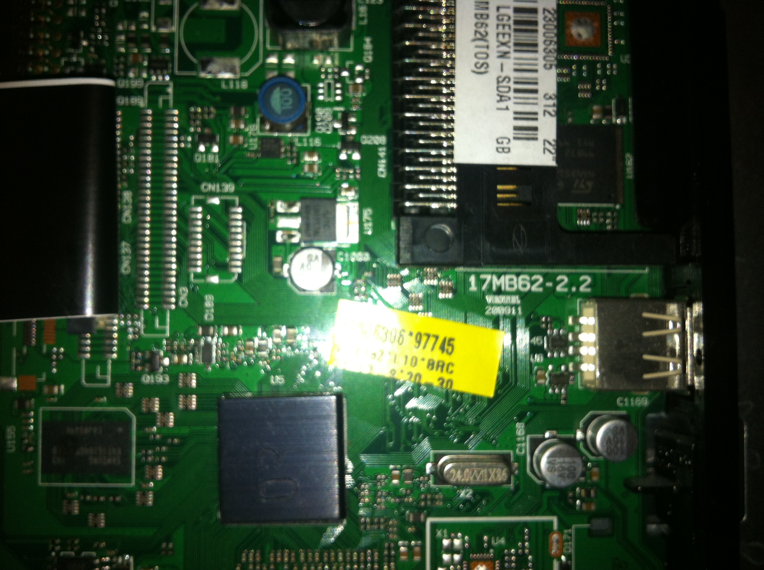

    Does this sound like a firmware problem ? Is it normal for the mainboard to blow alongside power module ? The mainboard is a MB62-2.2 board. I have seen other identical MB62-2.6 boards for sale, I am wondering can I do a straight swap. Do these boards need to be taken from a TV with the same dimensions of screen ?
    I am wondering can I reload the firmware, and if so, which would be compatible ?

    This is a Vestel set, so it's built the same as all the budget brands like Bush, Technika, etc.
    Quite a common fault with newer Vestels is bad firmware but it is possible to reload it, you just need a USB stick with the files on it, hold the MENU key while powering up (I believe) and it should copy the files over even if it does not fully power up. Unfortunately finding the files may be difficult.

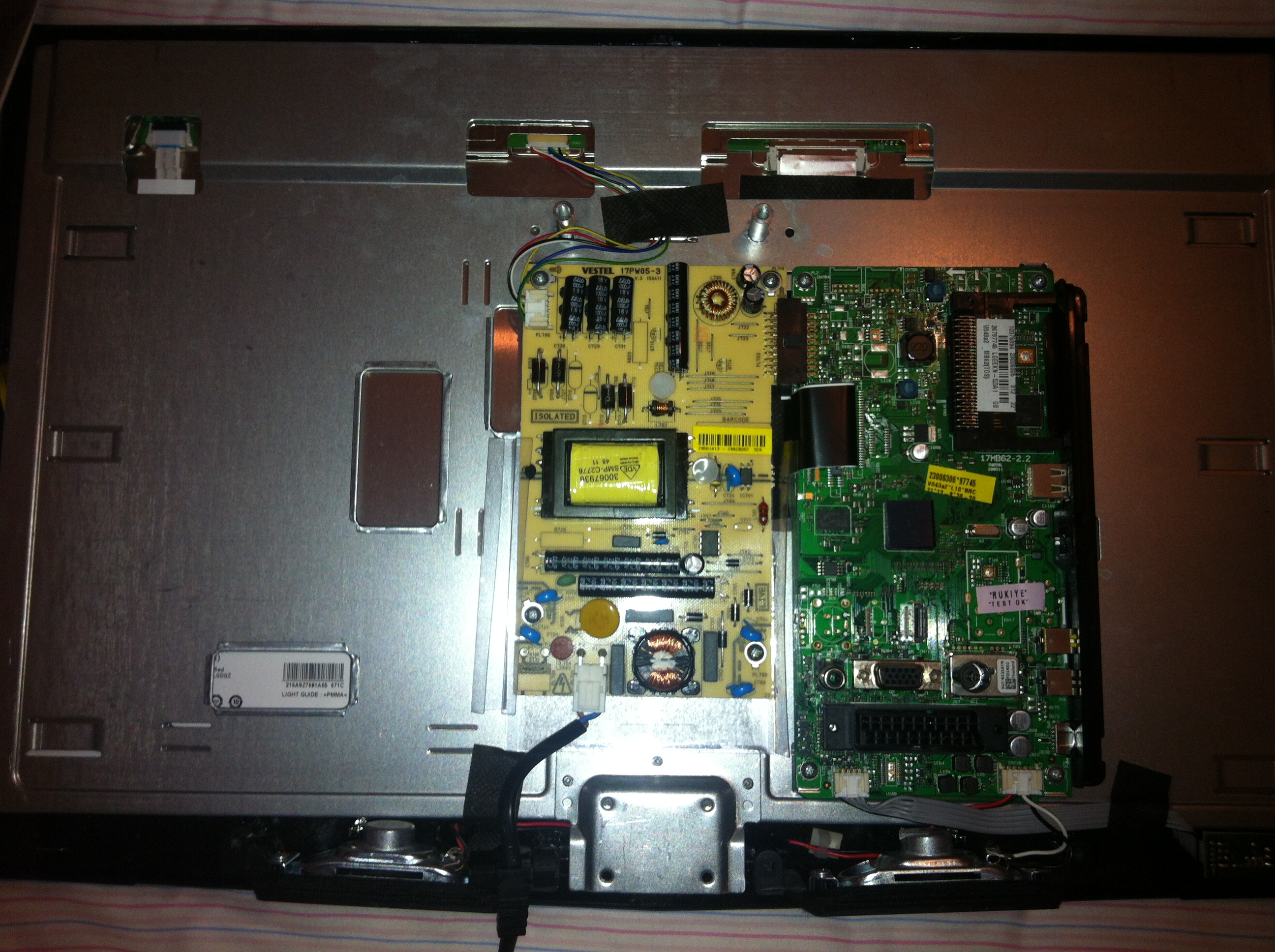

    Can we have some pictures of the chassis layout so we can see what there is inside and what diagnosis can be made?

      I did consider reloading the firmware, but unfortunately this does not seem to be one of the models for which Toshiba provide the firmware on their website. I did manage to find some MB62 files on here but I think they are for use with U-boot ?

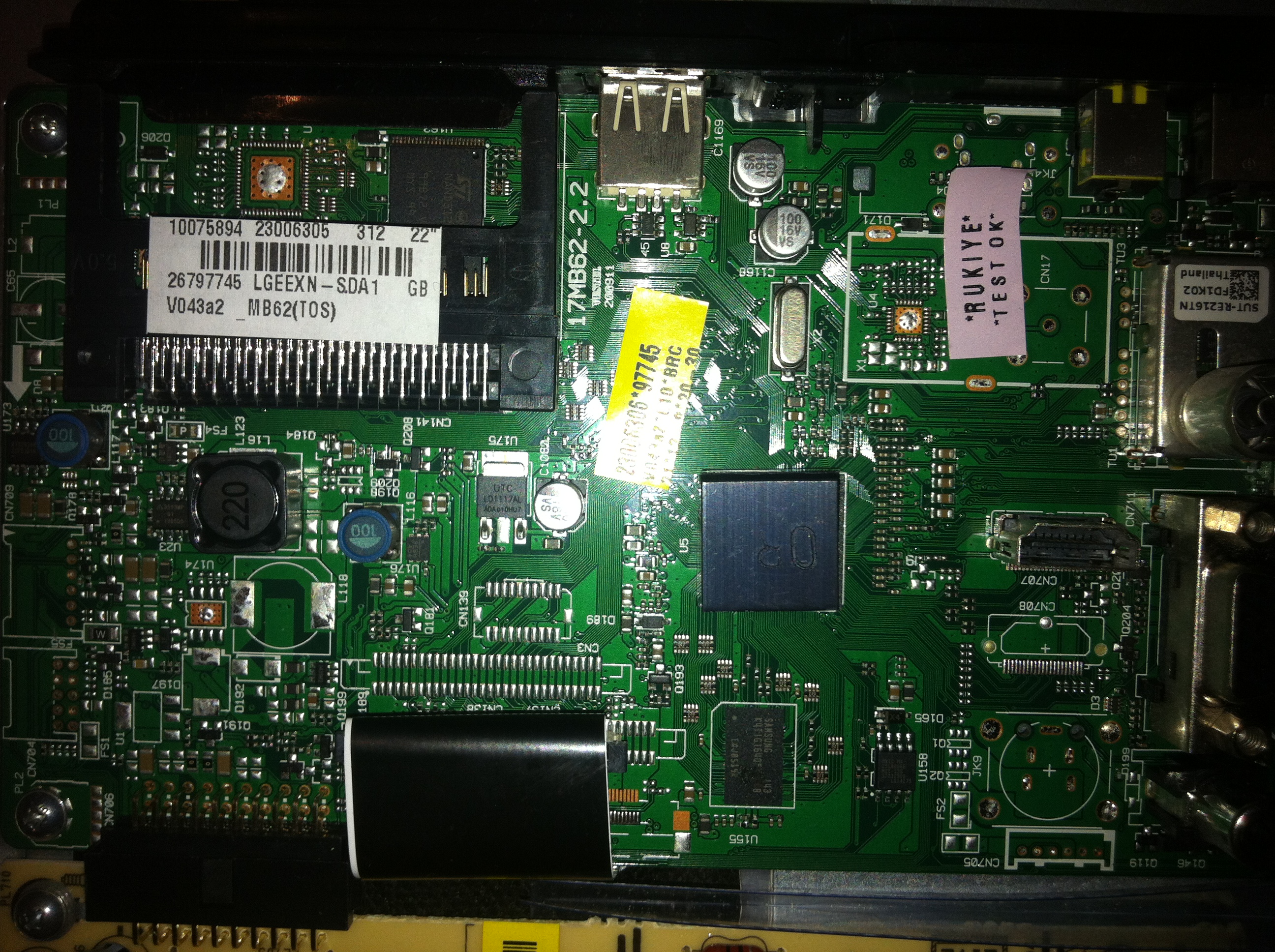

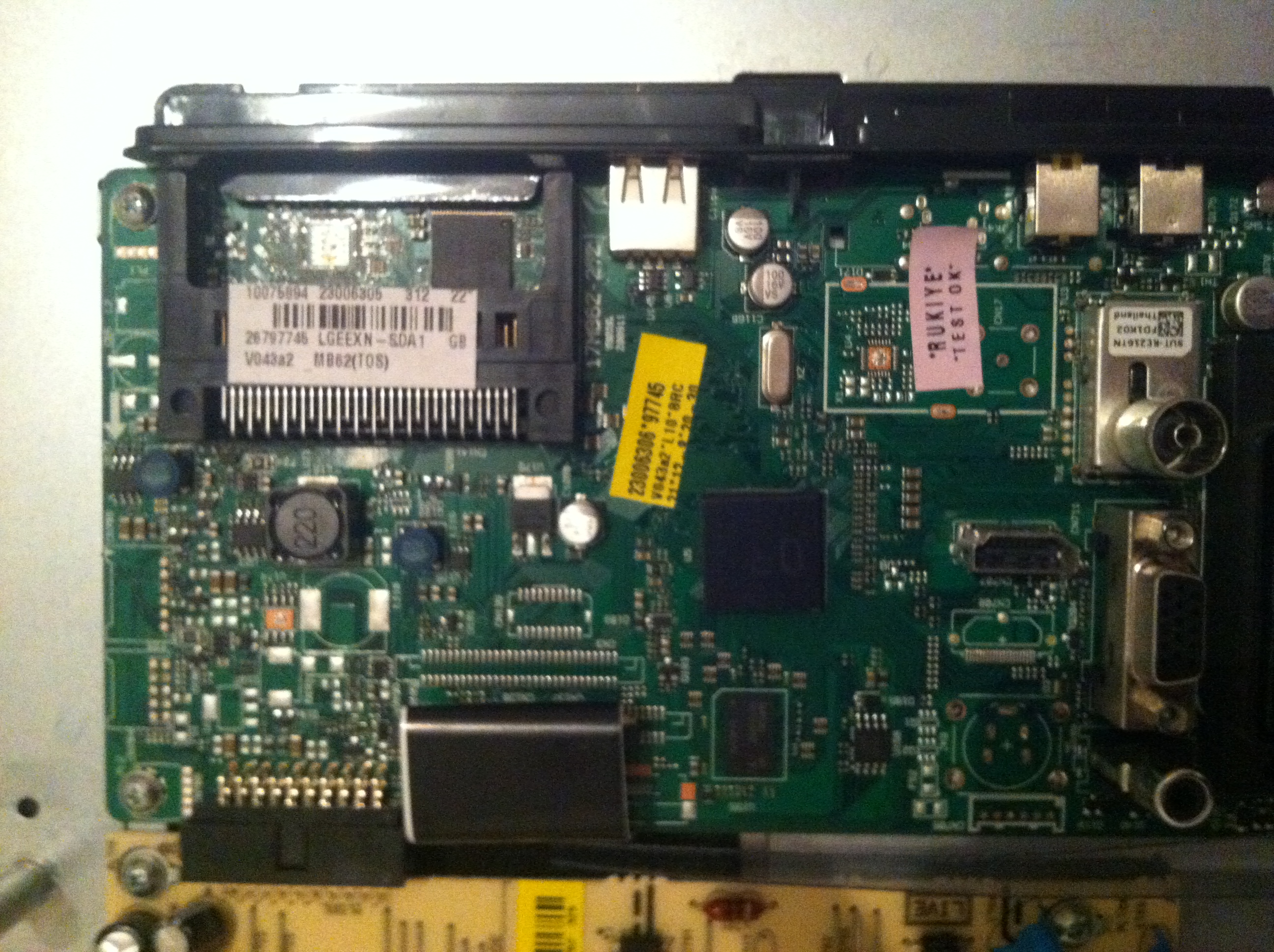

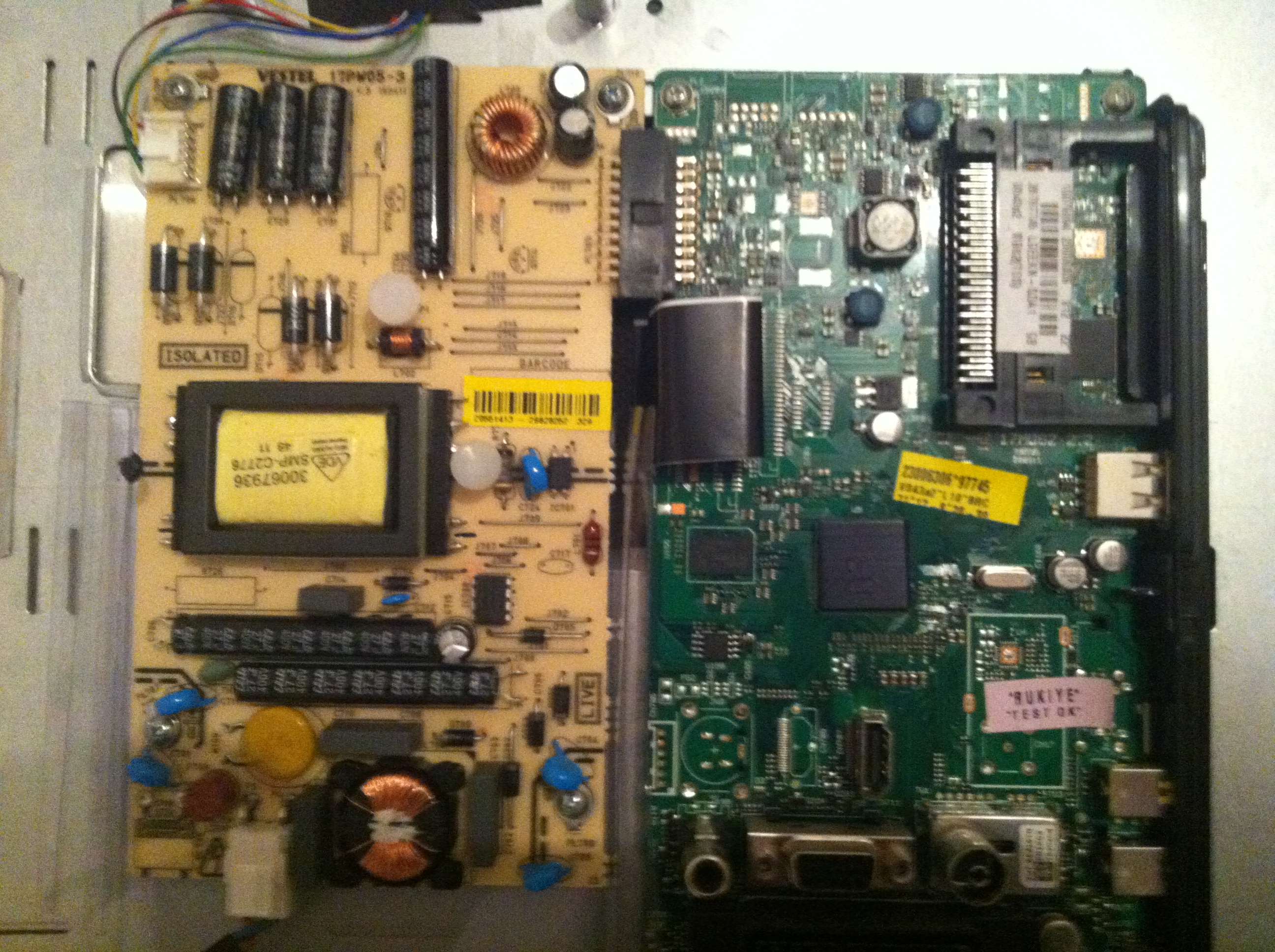

        Re: Toshiba LCD 22BL502B Solid Green Led No Picture
        Photos Attached.
        Thanks.

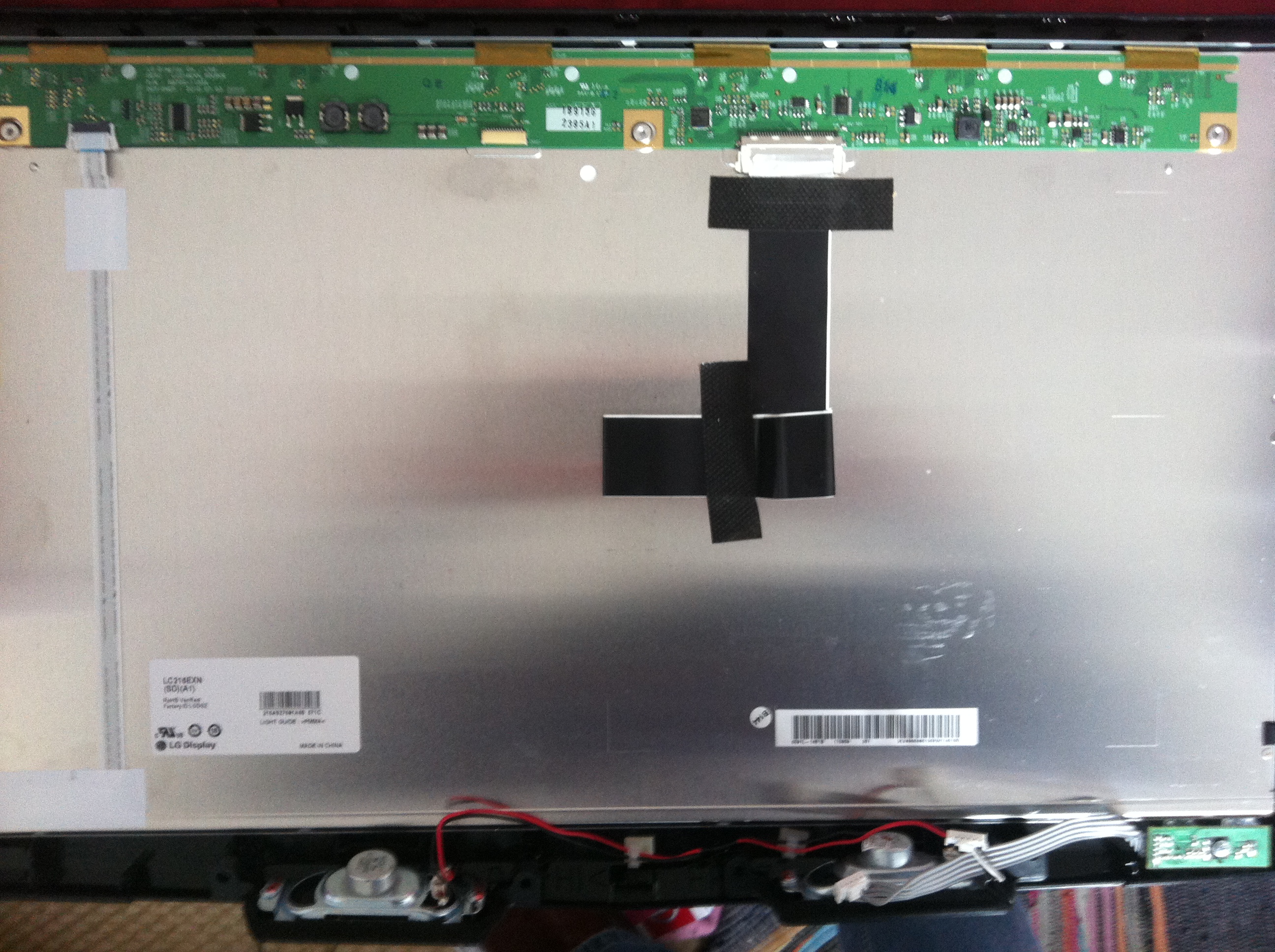

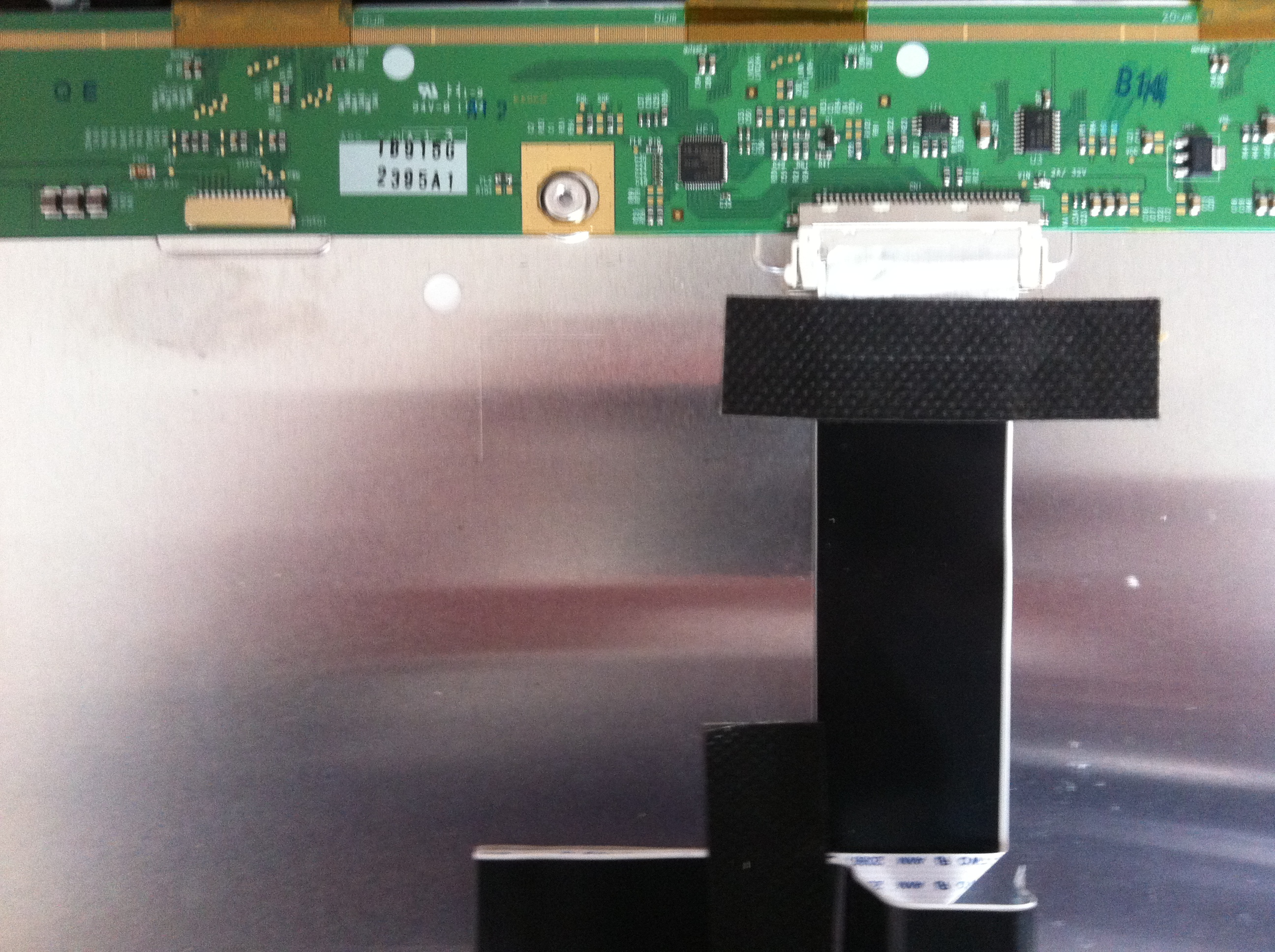

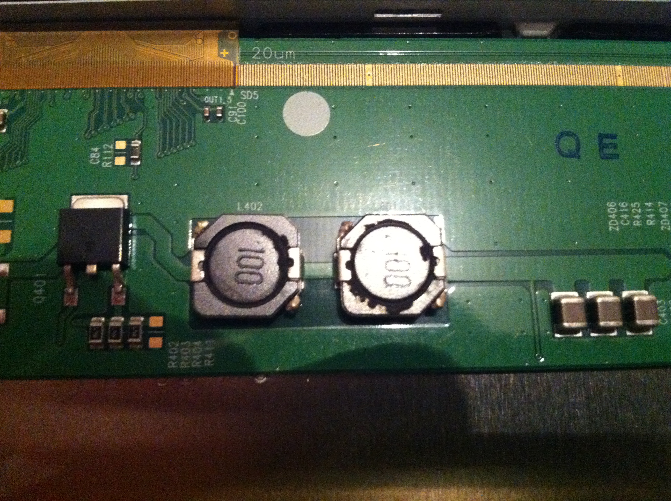

                  So, you need to take that metal shield off the t-con board, which runs along the top of the display, as it looks like the LED driver is under there, and get a picture of it.
                    Hi, photos attached. I don't see anything alarmingly obvious like scorch marks or blackened areas. No burning smell or anything. Seems like an LG LC216EXN display. Driver board has P/N 6870S-1155A. Does the fact that the backlight is off indicate it is a problem with this board.
                    Michael.

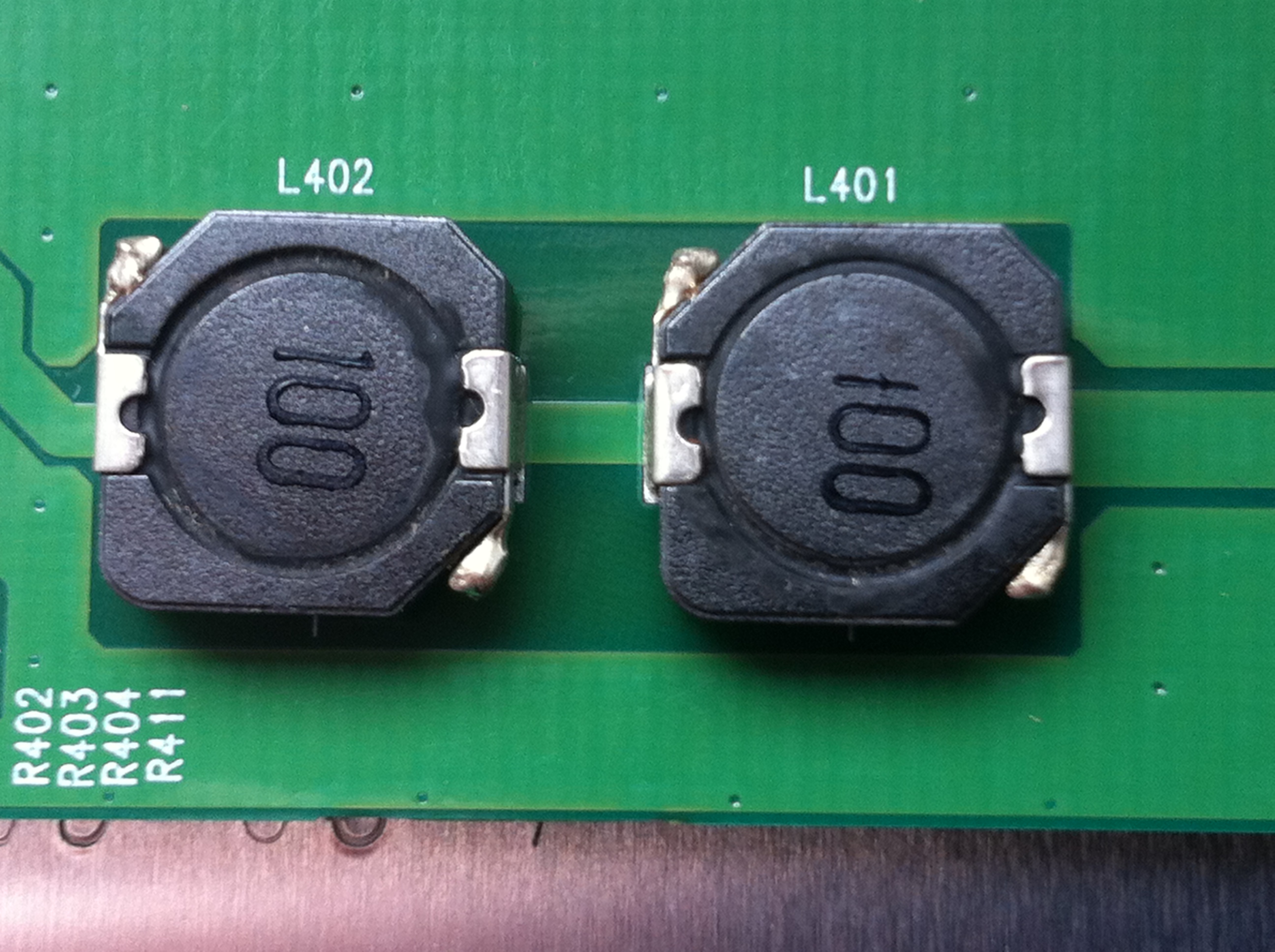

                      Thought it may be worth mentioning : Two circular flat objects, possibly caps, marked L401 and L402, looks like some mild charring on them, although could just be from manufacturing process.
                      Thanks.
                        On 2nd thought, looks like inductors. Does this melting around the top indicate the inductors have had it ?
                        Thanks.
                          They are inductors, they look OK. You can check to see if the winding is open, you can see the two contacts points on the it.

                            There's a small gold fuse on the board, too.
                              Ah, replaceable, or needs to be desoldered. Is it visible in the pictures ?
                              Thanks.
                                It's this one. Desolderable.

                                  My biggest concern is still these inductors. I've taken a shot from another angle, there's some definite sweating on the top, possibly from over current ? Although I suspect this would have blown the fuse.
                                  I've also tested the resistance across the two inductors, they are both initially around 3k, and then drops to 0 ? I'm not sure the resistance should drop this low, might this indicate a short ? Attached another view of the inductors from a slightly better angle showing marking on top.
                                  Thanks.
                                    The inductors should measure 0 ohms.
                                      Should they measure 0 instantaneously though ?
                                        If I am correct, those inductors are 100uH, so they will have low DCR. Are they on T-CON board?
                                        Inductor sample: about 0.125 Ohm
