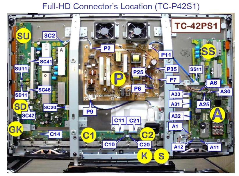

    On the fans, you have a red, yellow and black wire. The jumper will be between either red and yellow, or yellow and black. Where do the fans connect? Can we get some pictures?

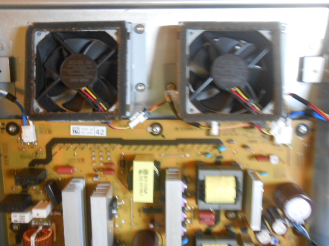

        Re: TC-P42S1 11 red blinking led help!!
        ok about this jumper . just any old wire? all my stores are closed at moment but it looks like any skinny wire might do?

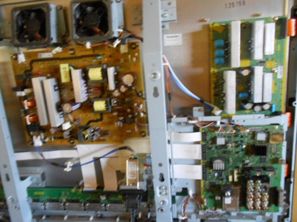

          You NEED to post a higher resolution picture so we can help you. Try tracing the wires to the A board, this is the board which has the HDMI, component video, etc on it. It's possible they could go to the power supply board (which is the one which takes the AC input) but it varies depending on design.

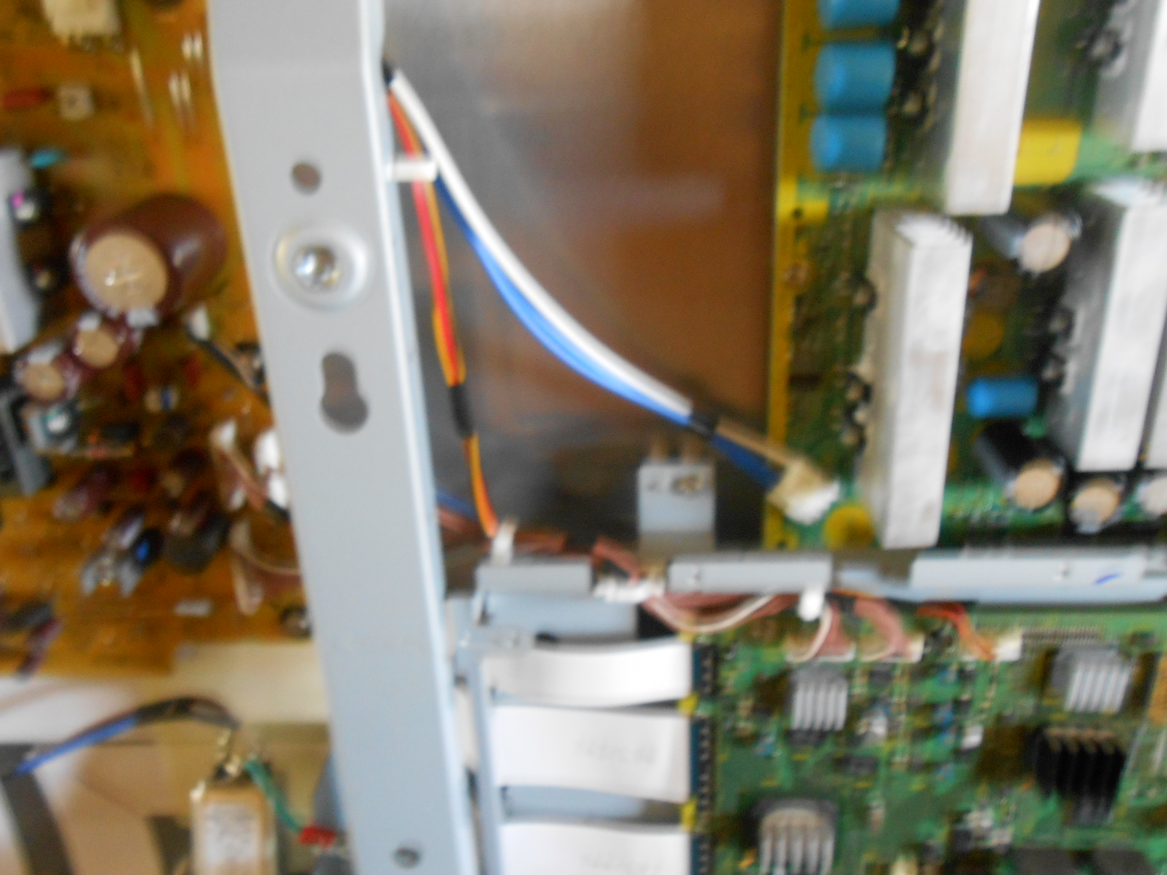

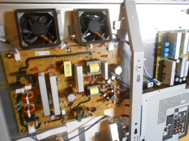

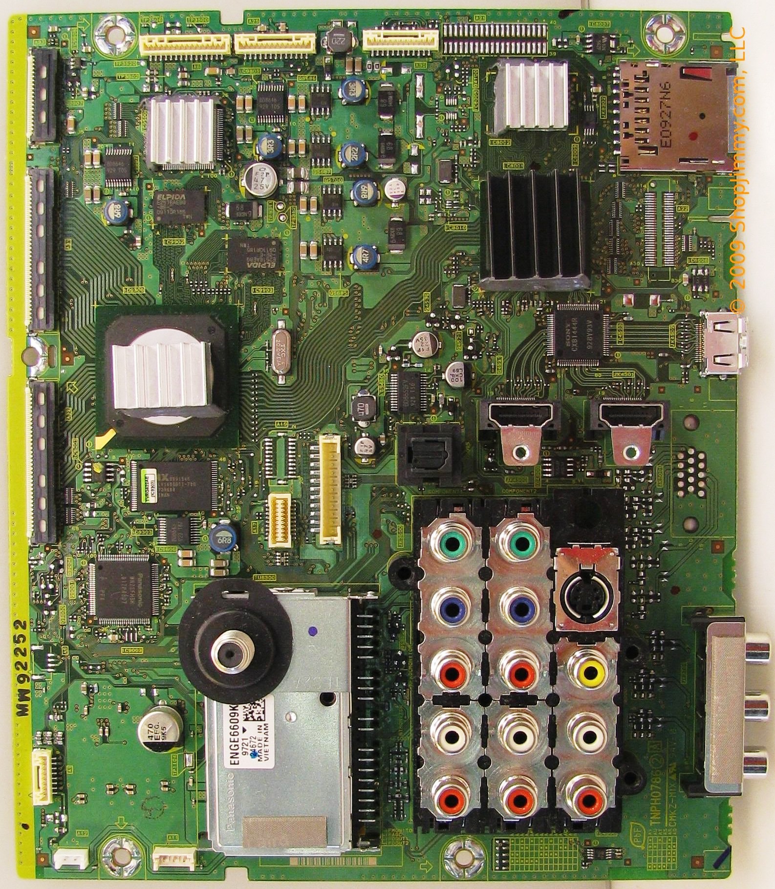

            Better? I am guessing the green board in lower right is the A board. Agin no burns of any kind. I'm kind of dead in the water till i get a jumper wire. Is that what i ask for at the harrdware store? went to one and no luck. Sorry to be so dense I hope u don't get anyone more challenged than myself.
              Try to use flash to improve focus, but it looks to me like the fan connections hook into the bottom right board, please trace them back and tell me if I am right or wrong? Yes bottom right is A board, i.e. HDMI/component etc.
              Jumper wire: you can use standard 0.5mm hookup wire or metal cable tie with ends stripped off.

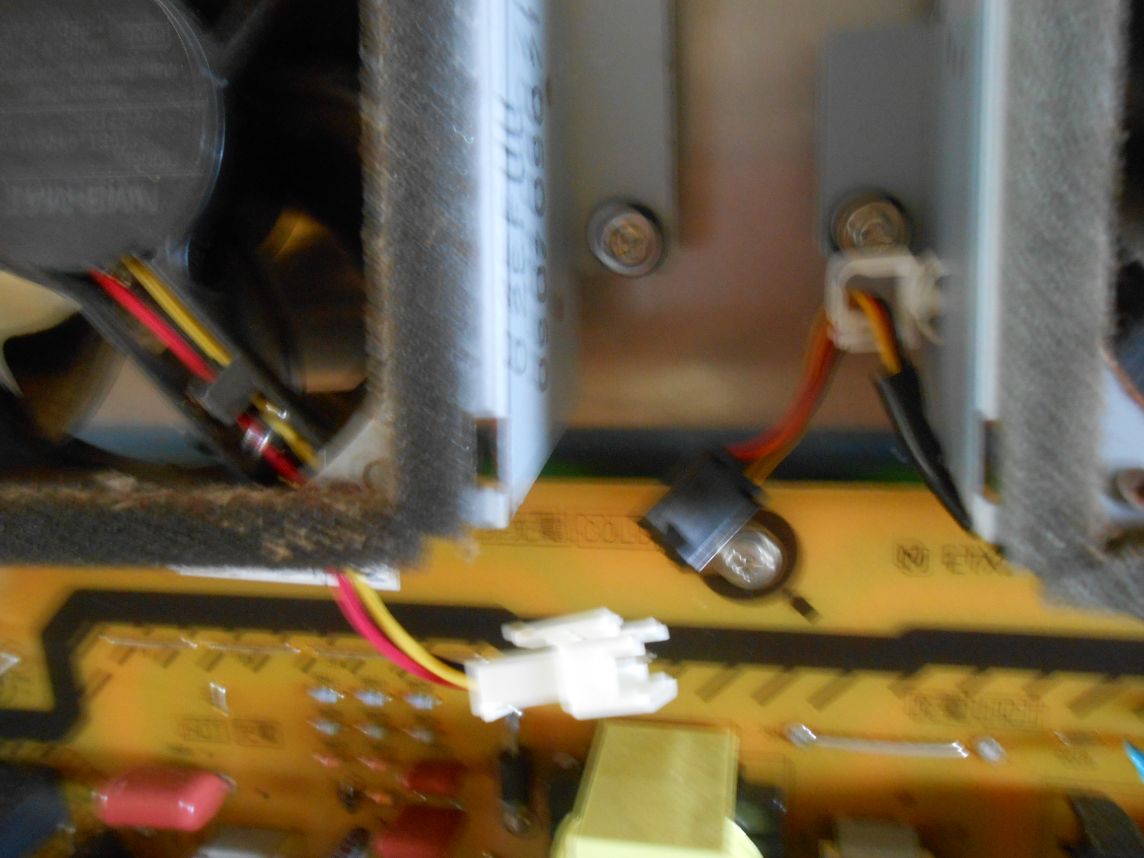

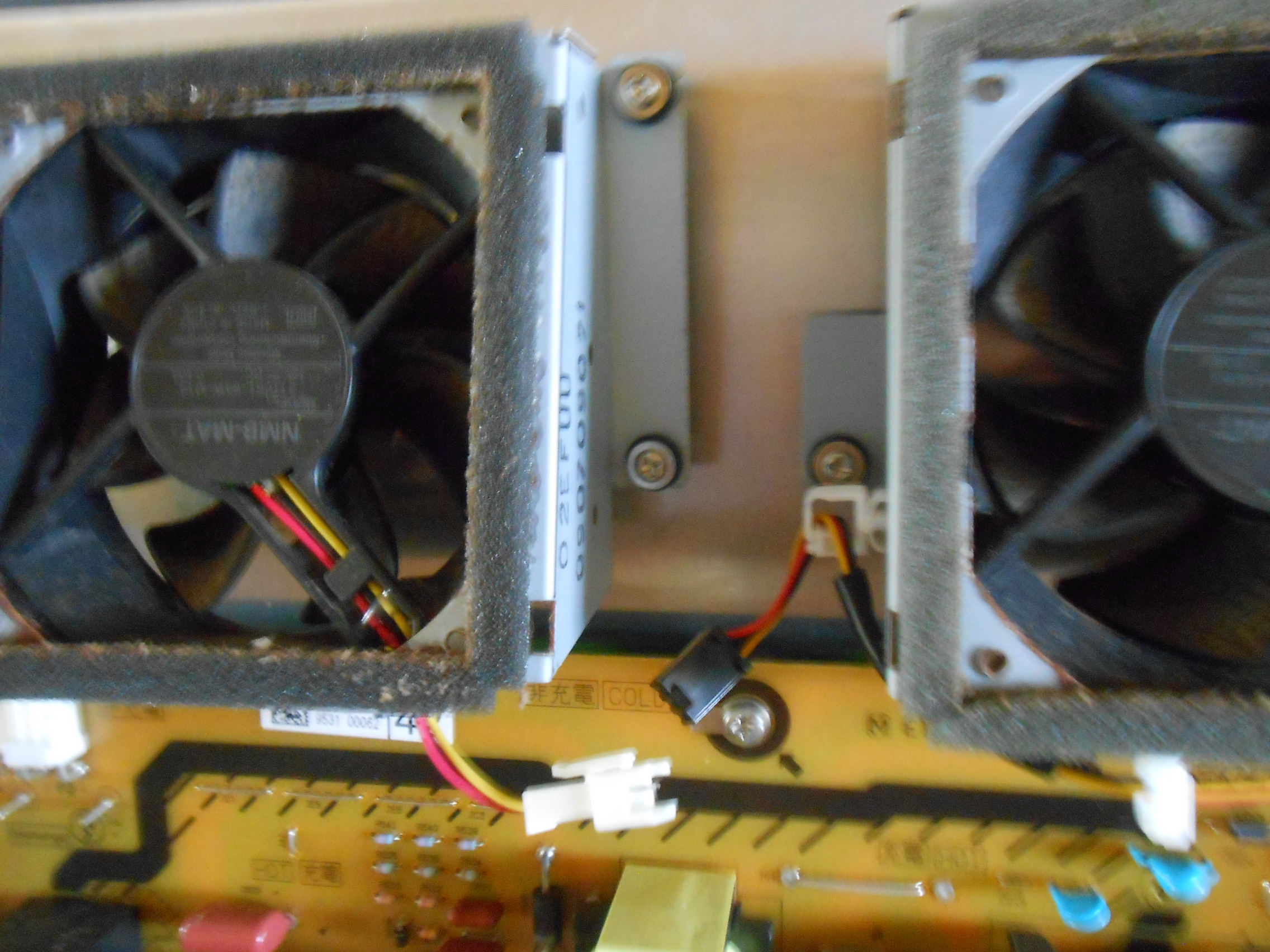

                more. i have disconnected one fan as shown and then the black red and yellow wires run to green board. checked out service manual - now i can go to it when u say something i don't understand. like different boards, saw the schem on removing fan. just need a wire for jumping. hope these pics are ok yes , the lines run into the A board.
                  Do you have any paperclips? Maybe they could jumper this for you

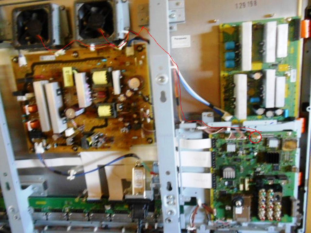

                    A30 should be for the fan connection. Yes a bit blurry, I've marked what I believe should be it Tom. Sorry, no good with crayons.

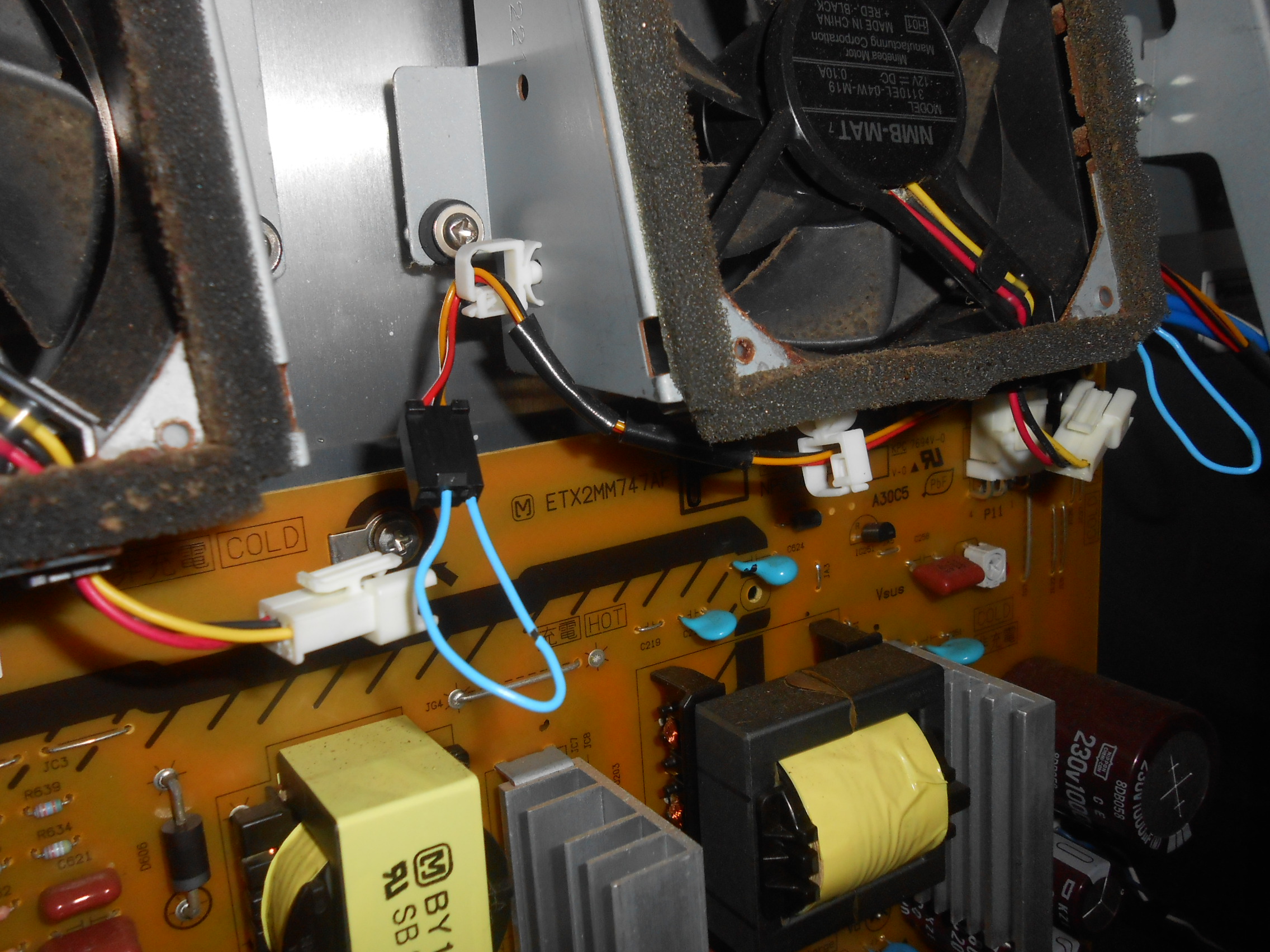

                        Decided to use paper clip. Did as instructed and tested one fan with a no result then the second fan ,B, then on remebering neither fan was going when i opened it up i paperclipped both fans and the tv works!!! pic enclosed with blue paper clip showing and one on B. Question. Is this just a work around? no kids so leaving back off till i find out what is next. I am assuming I need to replace both fans? The purpose of the fan is keeping inside air cooled? The tv is in breezy spot (no AC). Can i keep these paper clipped for a while or what? Somewhere I saw posted a part number for the fans L6FAYYH0094 How do i find this out? What is my shock likelihood with an exposed to the back wall TV?

                          Well , that was easier than i expected. No you'll be fine, I'm sure you're smart enough to realise that if it's on not to stick your hand aimlessly in the back.
                          Page 88, item #3, 42S1 service manual which I uploaded in the post above.
                          I don't see a major issue as an interim so long as the clips are in firm enough not to fall out and short something and I'd tape them up just for a bit of safety and security.
                          I'm thinking the likelyhood of both fans being dead would be slim so the fault may be in the fan cct itself on the A-board? You'd need a multimeter to check if the board is sending power to the fans.
                          Or remove the fans and if you have a 9-12v battery maybe power them up and see if they function?
