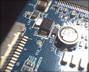

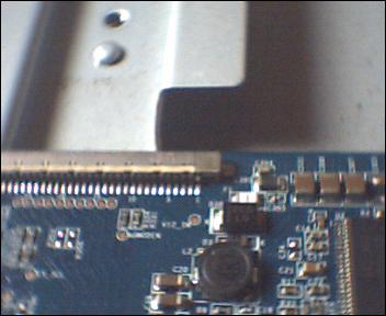

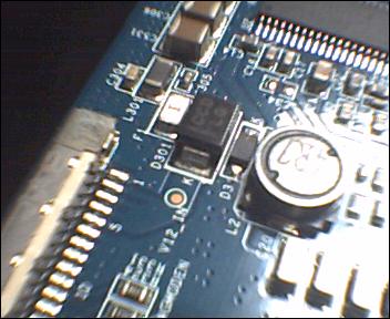

    Good day, I need a service manual for this model sony lcd kdl-32m4000, The tv as backlight, but no picture on screen,all voltage on the power supply are o.k .
    Re: sony lcd tv model kdl-32m4000
    Check fuse on t-con, very common issue with these.

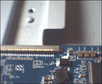

      tom66, on the t-con board there is a fuse F1 deside d301 and L301 , colour of fuse is white with a (I) on top of it,is that the one , if so test good.
        Can you supply any pictures of the t-con so tests can be indicated?

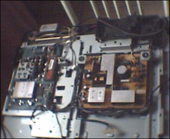

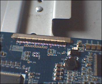

              These are the images of the T-con Board.
                Well it's hard to see but F1 looks like a fuse, are those the best pictures you can get?
