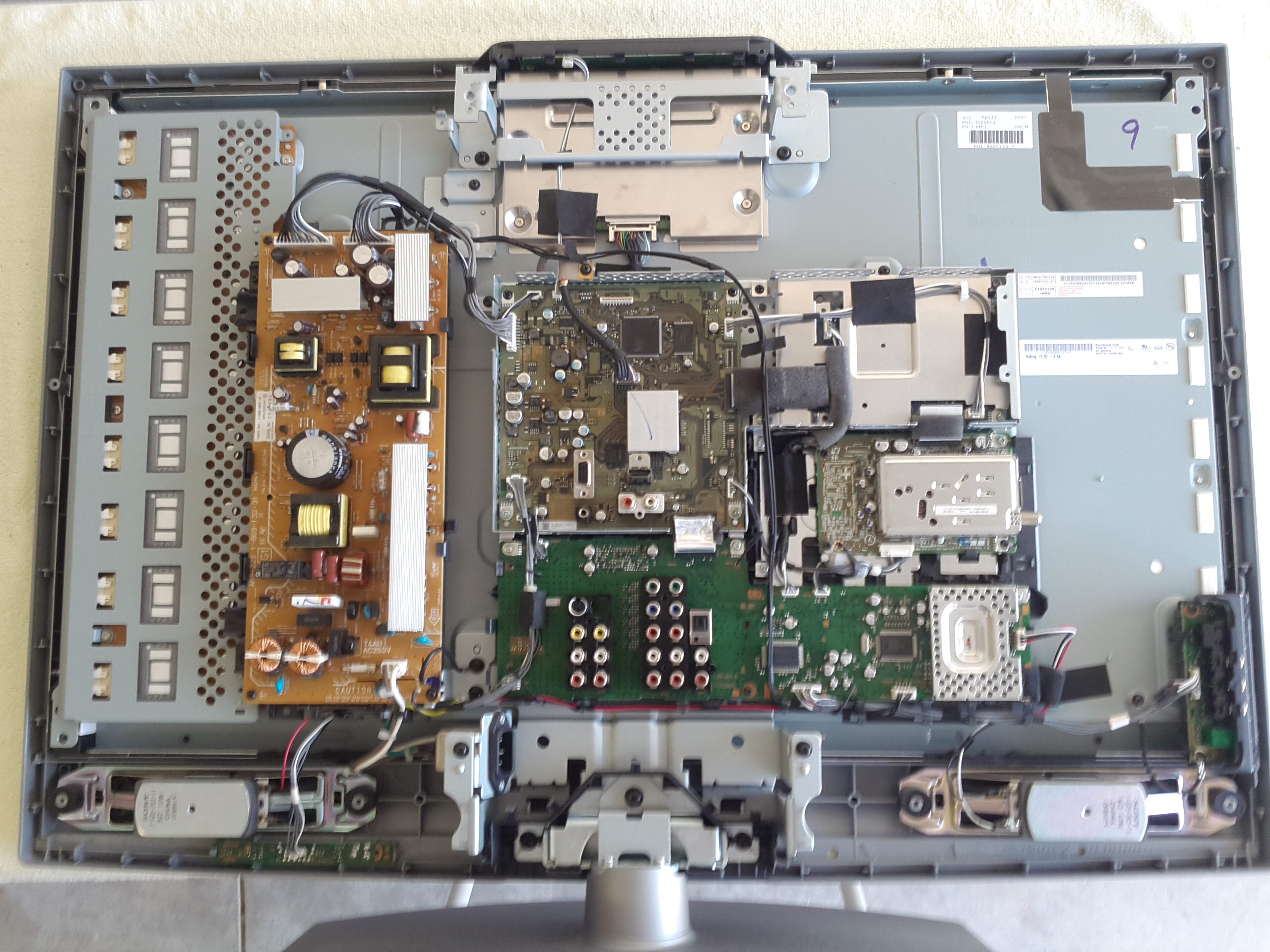

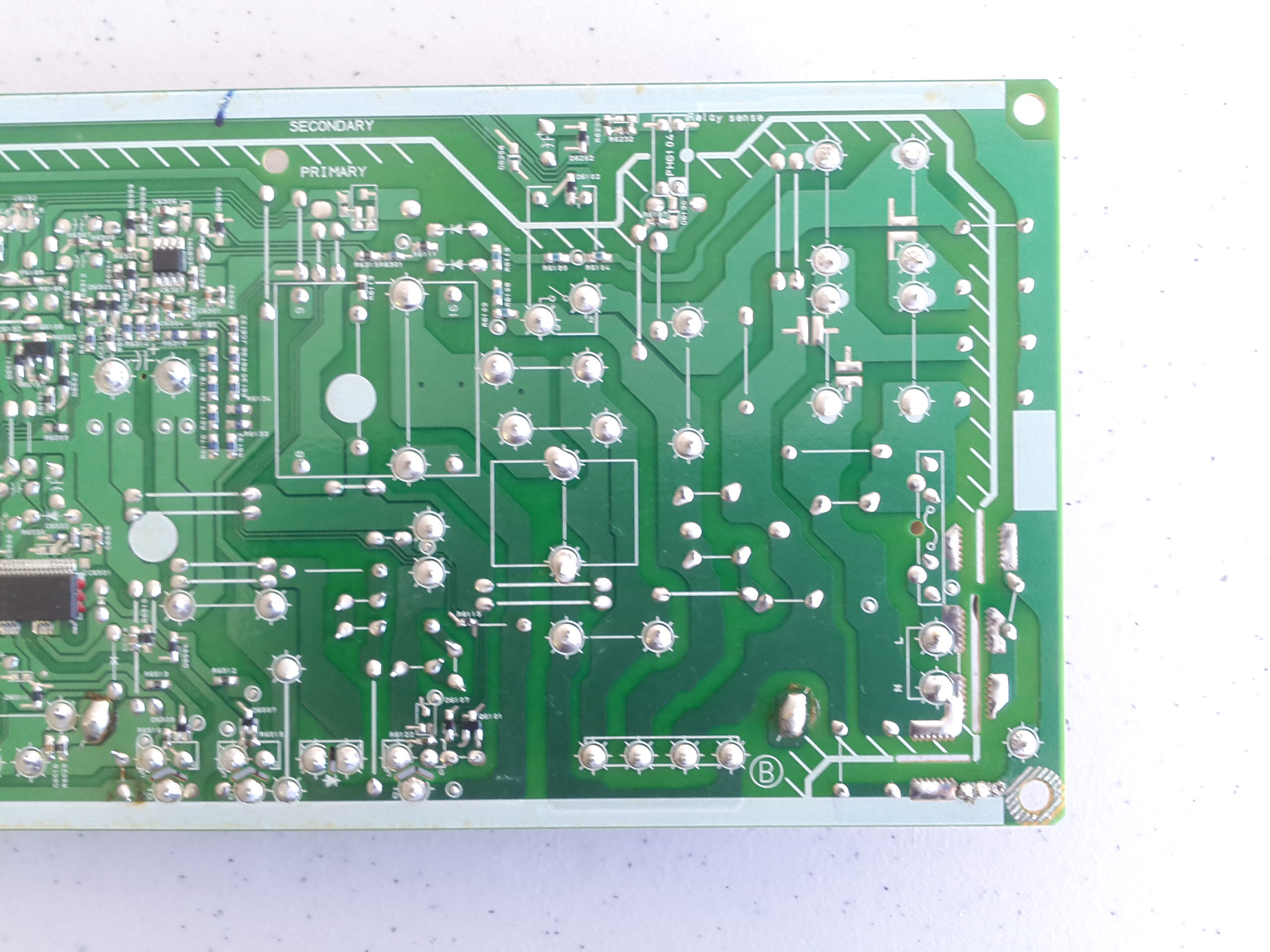

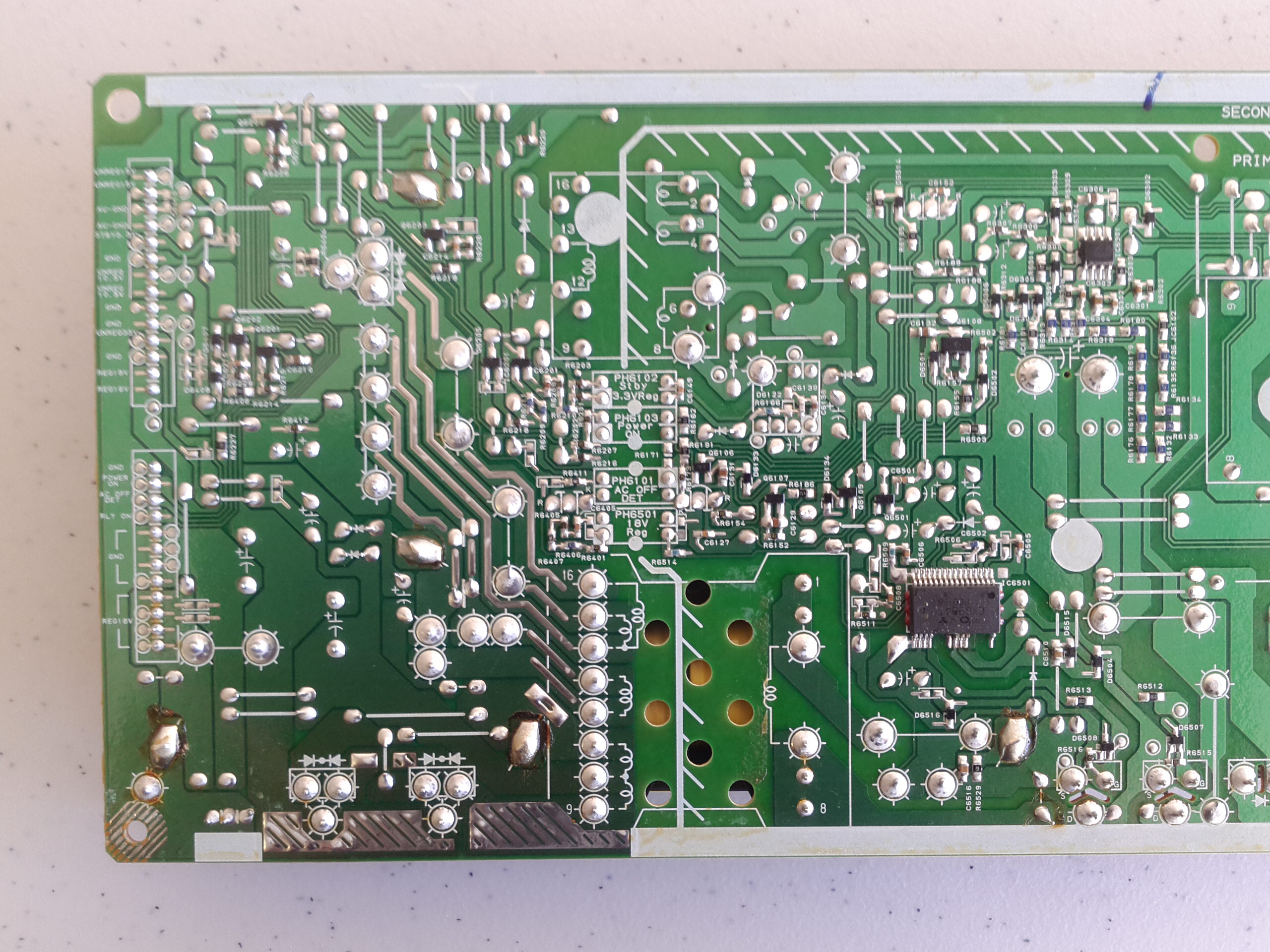

    Sony KDL-32s20L1 no picture
    When I got this TV a few weeks ago, it had a 3 flashing standby light. So after lots of testing I put a BU board in. Voila, problem solved works great.
    The next day I turn on the TV and I get "The black screen".
    No picture, or menu or even any kind of display (clock/chan.) - nothing.
    Audio is working fine - and backlight is on. So I figured I would just take a quick look at the settings, before moving on.
    Now here is where it gets weird:
    - I turned off the set,
    - Power up through the "Settings Adjustments" screen
    (display, chan.5, vol.+, power)
    - Immediately, everything works perfectly again (video, audio, etc..)
    When I repeat this process - it seems that I have no video on normal power-on , but works perfectly as long as I go through the "Settings Adjustment" procedure.
    This one has me completely stumped. I'm not even sure where to "start" looking.
    Any thoughts or ideas would be greatly appreciated, Thanks
  • kenny1070
    • Oct 2013
    • 65

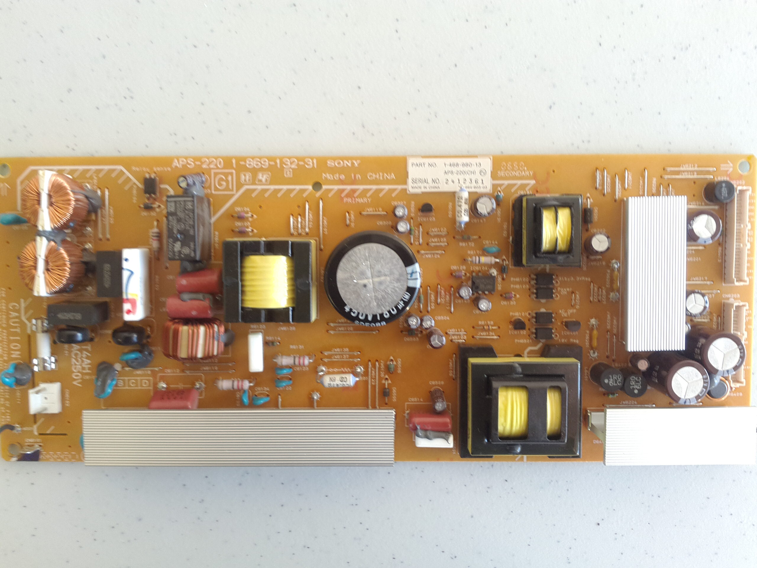

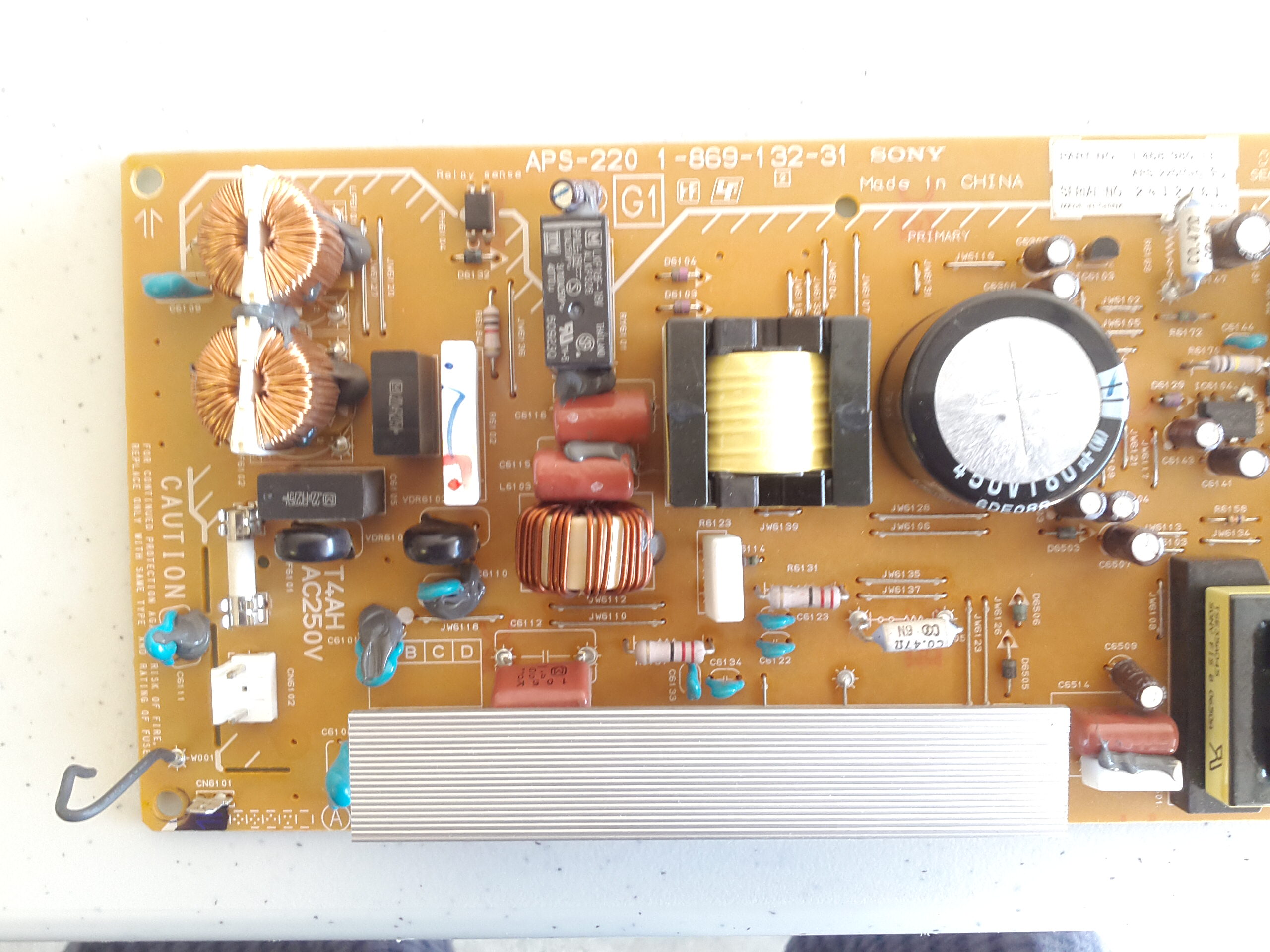

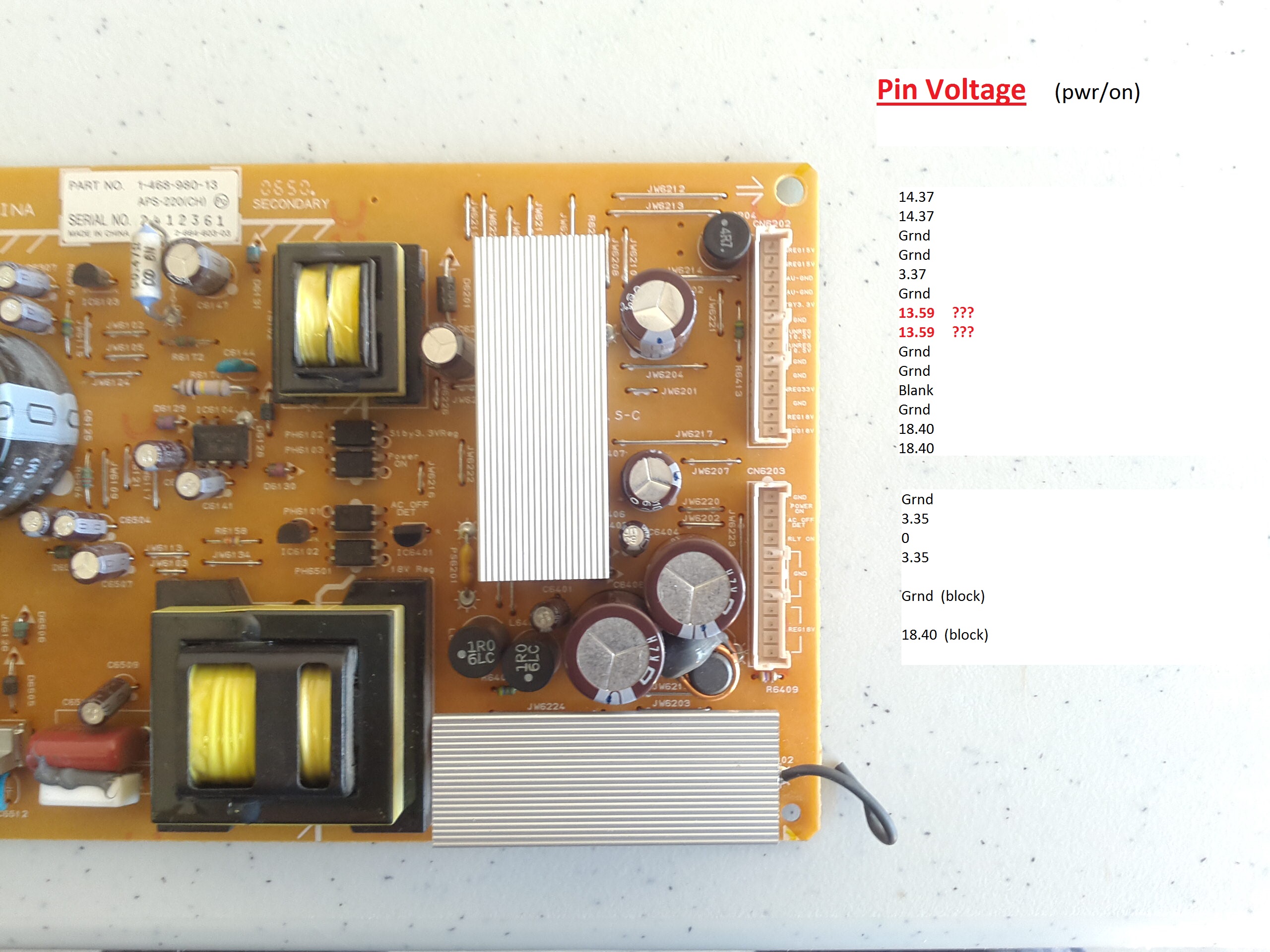

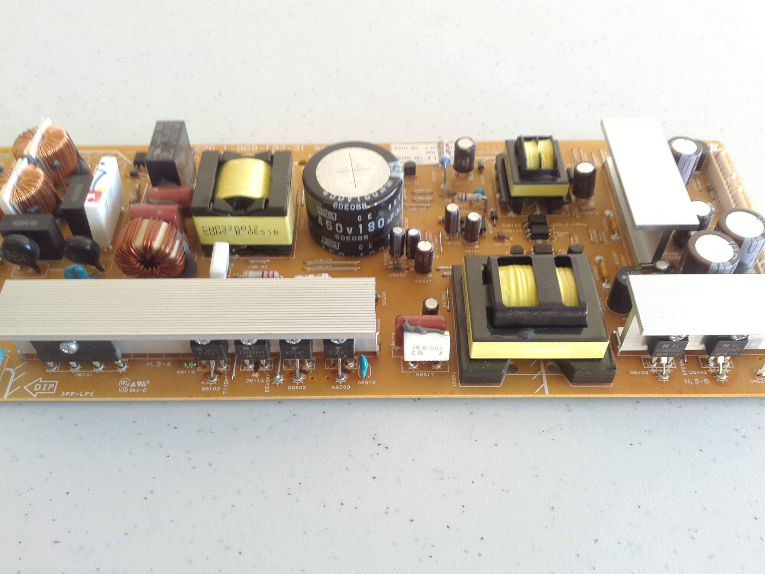

    Re: Sony KDL-32s20L1 no picture
    Well, it's been a while but guess it's time to revisit this one.
    After playing around for a while --
    It seems that the Unregulated 10.5 vdc from the power supply (to B/U)
    isn't stabilizing until about 13.59 volts.
    Now the problem doesn't seem to happen all the time ( about 75-80%)
    What I have noticed though, is that if the voltage on this line (CN6202 pin 7/8) doesn't cross the 13.00 volt threshold on initial start-up - the set powers up fine and everything works perfectly.
    If it goes over 13 vdc = no picture/video.
    I could probably just buy a board; but I rather try and source it (if I can), and
    any and all help is appreciated
    Anyone have any thoughts or ideas ?????
