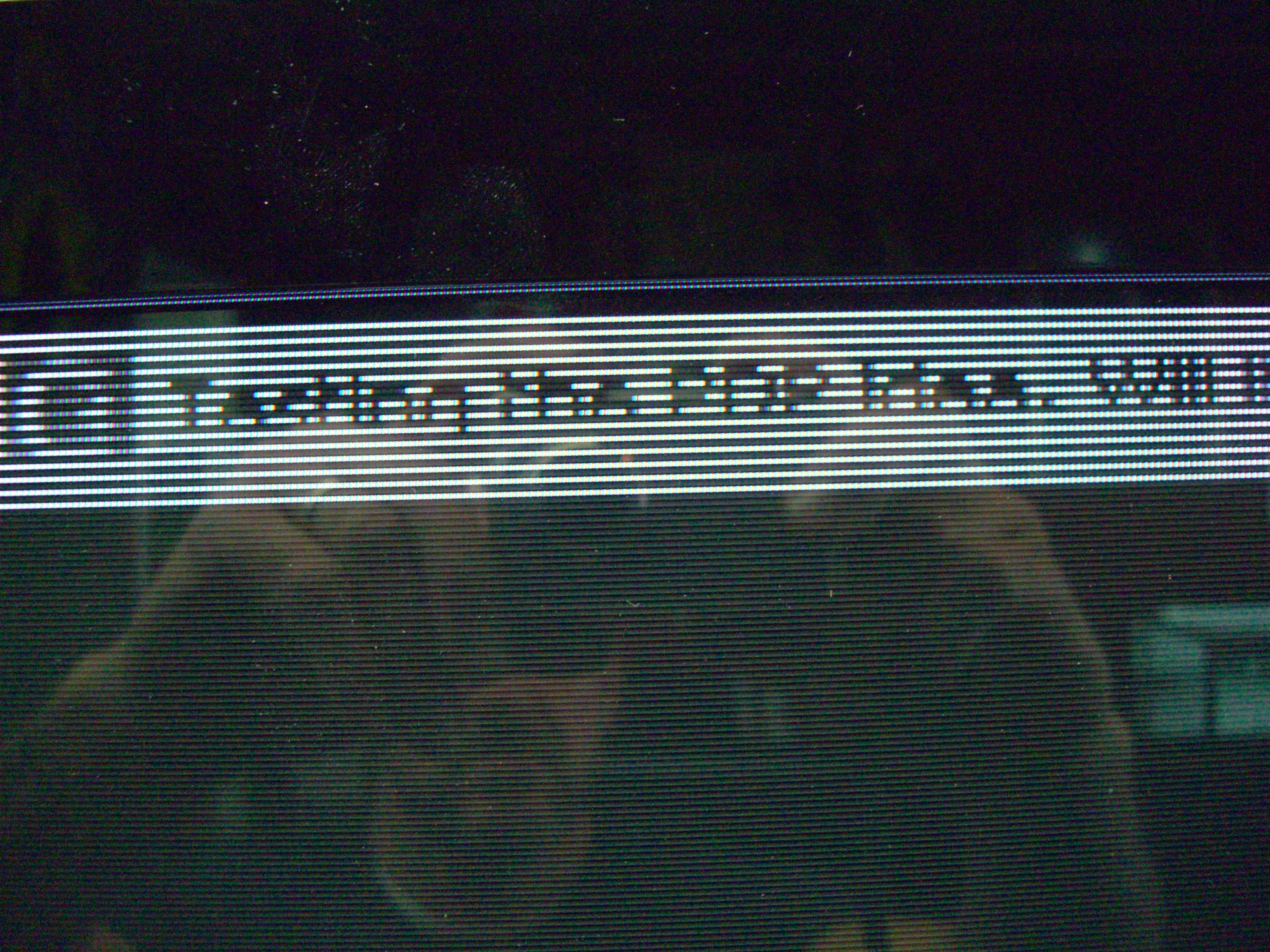

      I guess it's possible that the new buffer board has the same bad chips as the one I replaced, but it isn't likely. The new Y main and buffer boards are factory fresh from ShopJimmy, and the exact same symptoms remain. I replaced them as a pair and verified that the voltages are in spec.
      I have the bottom 1/6th of the screen working normally, and about 2" of the top of the screen working on every other line. The edges of the black area are clean and square. I've tried different inputs on the main board to no avail. The logic board is blinking once per second. All voltages are correct and the set turns on and remains on as it should.

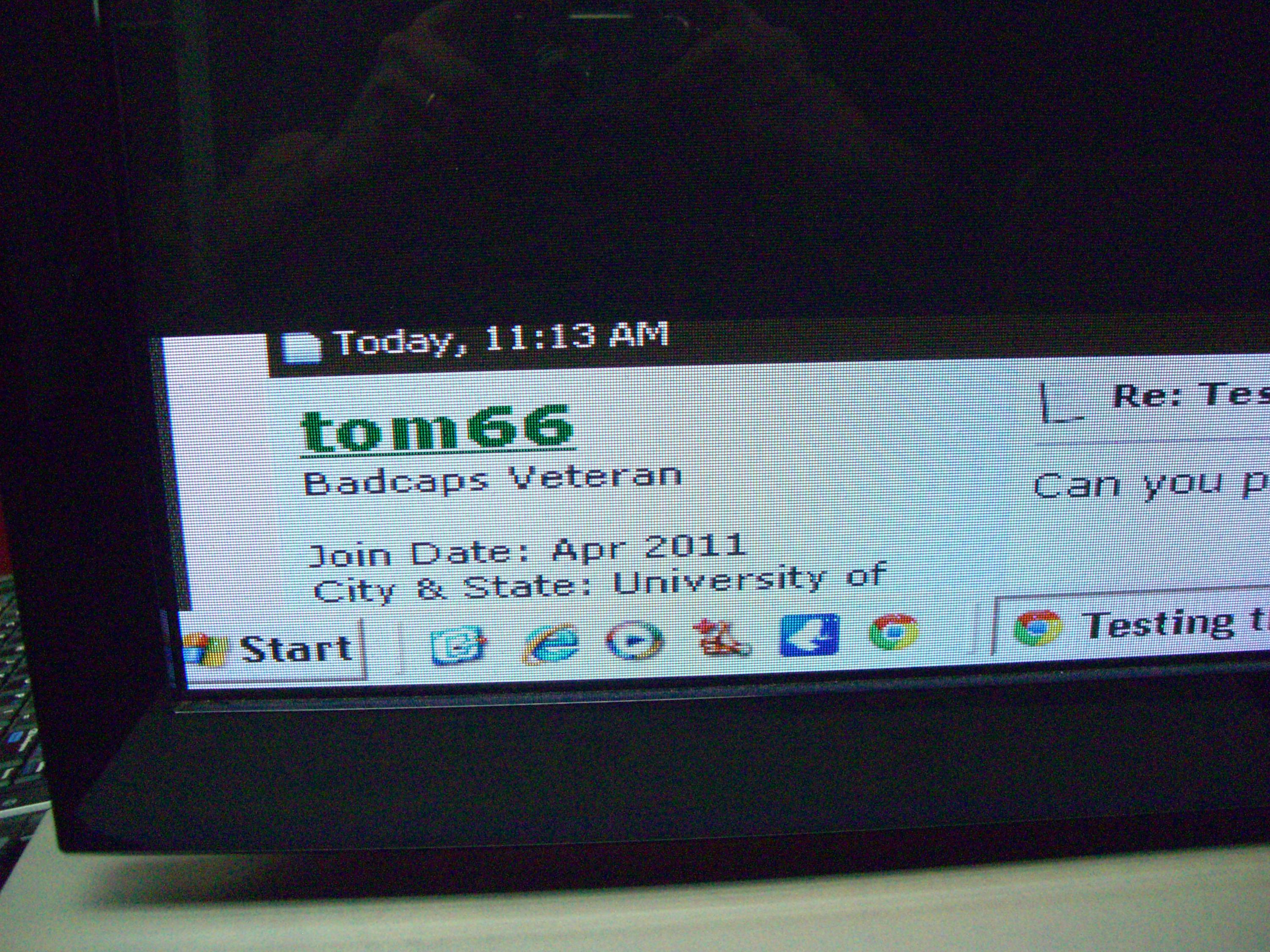

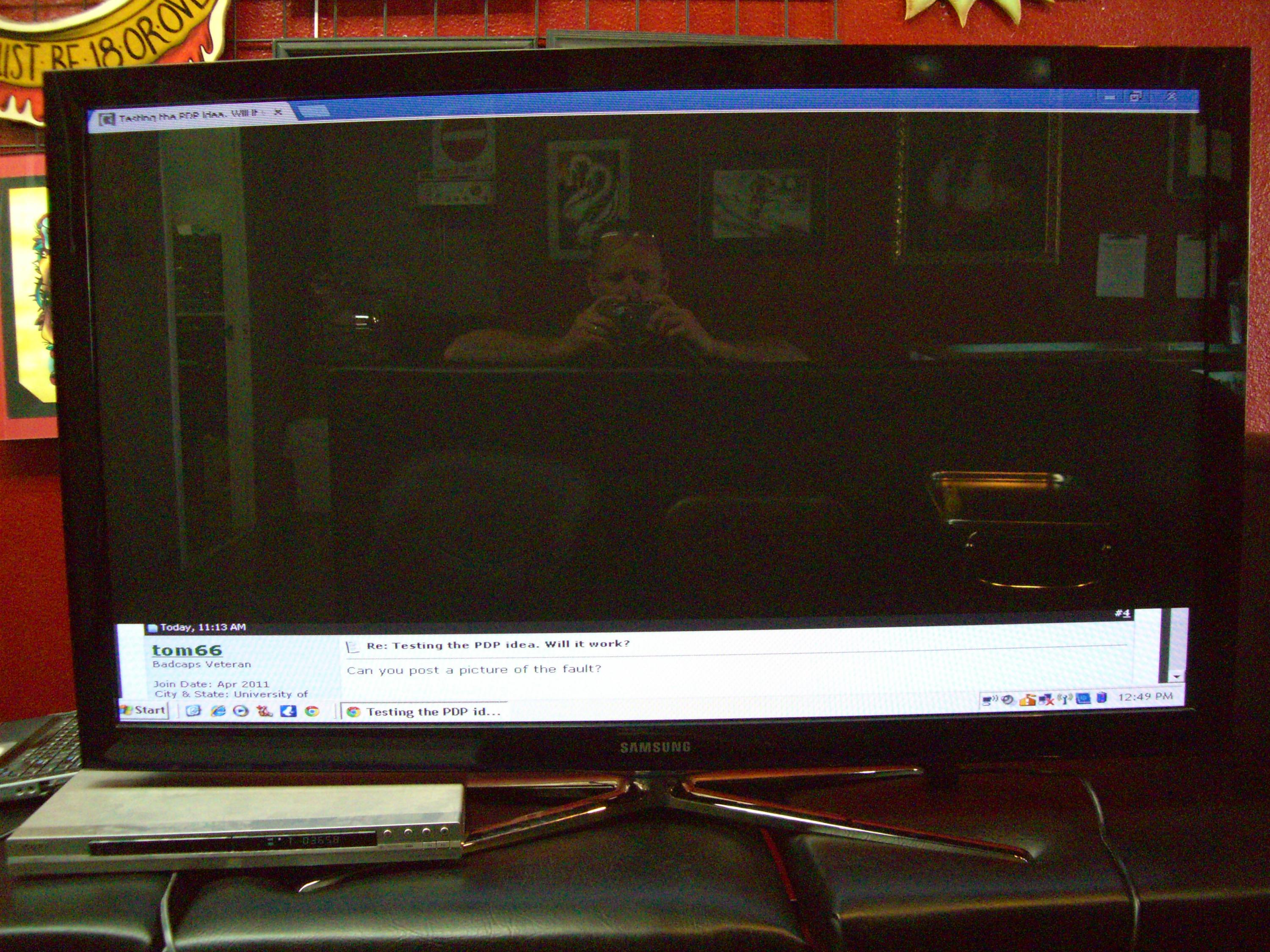

        Can you post a picture of the fault?

          Re: Testing the PDP idea. Will it work?
          The bottom of the screen is clear and normal. The top the screen is displaying on every other line. Everything else is dark.

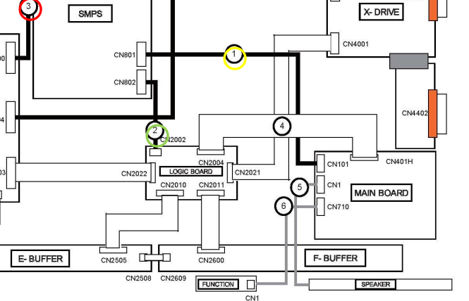

                                    The LVDS cable should be a twisted pair cable, right? I don't remember seeing one but I'll take a look when I get back to the set. Regardless, it should connect the power supply and main board?
                                    The Samsung Fast Track guide for the PN50C490B3DXZA says that I also have to jumper the PS-On pin to its circuit ground. I'm thinking that it must be a 15Vamp circuit.
                                      LVDS runs from control board to main board. If you post a pic of your control board we can highlight which cable is LVDS.
