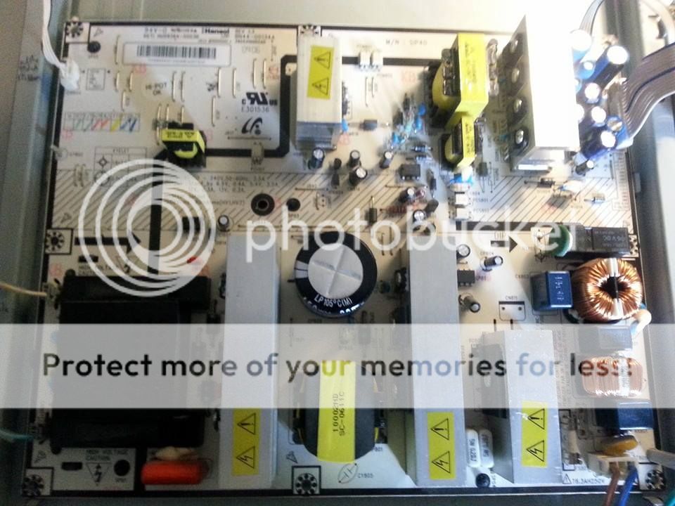

    I inspected the power supply board and found no obvious failed capacitors but I still replaced the usual culprits anyways. I did use cheap Radio Shack caps (I already had them in the drawer) with the intention of replacing them with better caps if the repair worked. There was no difference in the screen after the cap replacement.
    I checked all voltages coming off the board with the unit on and plugged in. Every output voltage specified on the circuit board was dead on correct.

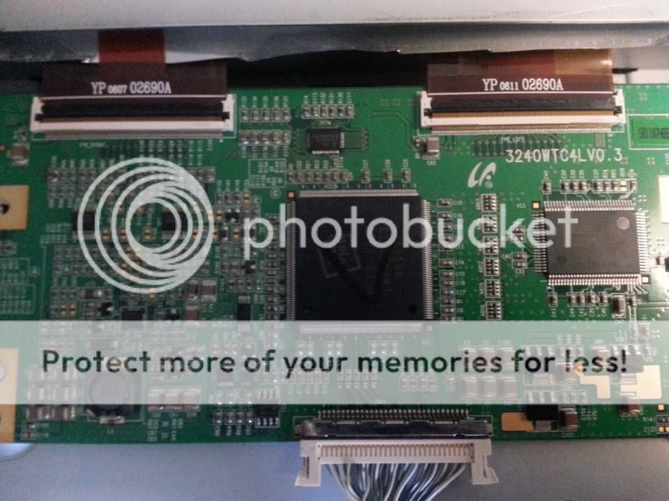

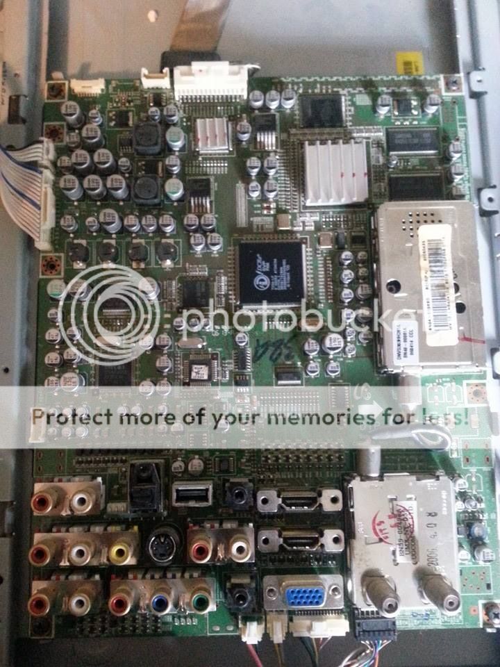

    I then removed the"tcon" board near the top of the screen to give it a good inspection. I checked the small SMD fuse near the input ribbon connector and it was showing a good circuit and allowing 5 volts to pass through to the rest of the circuitry. Just for fun, I disconnected the TCon board from the video board and fired up the Tv. It booted up just like normal except the lines were gone from the screen. This leads me to believe it could be the TCon board that is causing the ultimate issue.
    I am looking for more information on these Tcon boards. Info about repairing the board itself and/or replacement information would be very welcome!

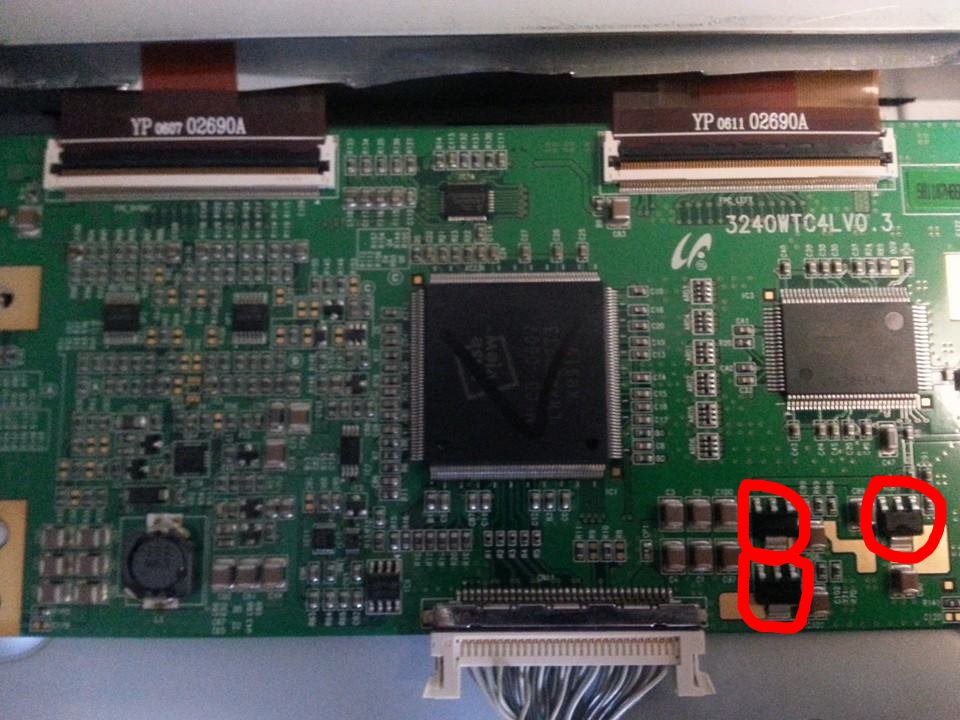

    I've done this one (UK variant of it.) One of the three voltage regulators on the t-con is failed if you get vertical lines. They all output 2.5V IIRC, but one had failed on mine outputting about 1.3V.

      Can you please point me in the right direction? I'm not sure where the voltage regulators are at on this board.
        Re: Samsung LN-S4041D vertical RBG lines- ongoing repair
        Each highlighted device is a regulator.
        To test: TV powered on with fault. Multimeter set to 20 volt DC or autoranging volts DC. Black probe on chassis, red probe on each pin of the device. Note down voltages on each pin. You can skip the fat "tab" pin as that is electrically the same as the middle pin. Report results back, with the "refdes" e.g. U35 printed on the board. and part number e.g. "UMC1117-33" which is printed on the device. Pin order doesn't matter, number them mentally, but be consistent between regulators.
        For example:
        regulator U11 part "UMC1117-ADJ"
        3.29 0.58 2.53

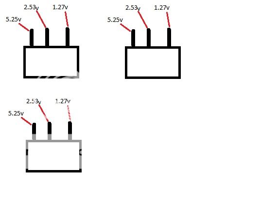

          Checked all 3 and the voltage readings are consistent.
