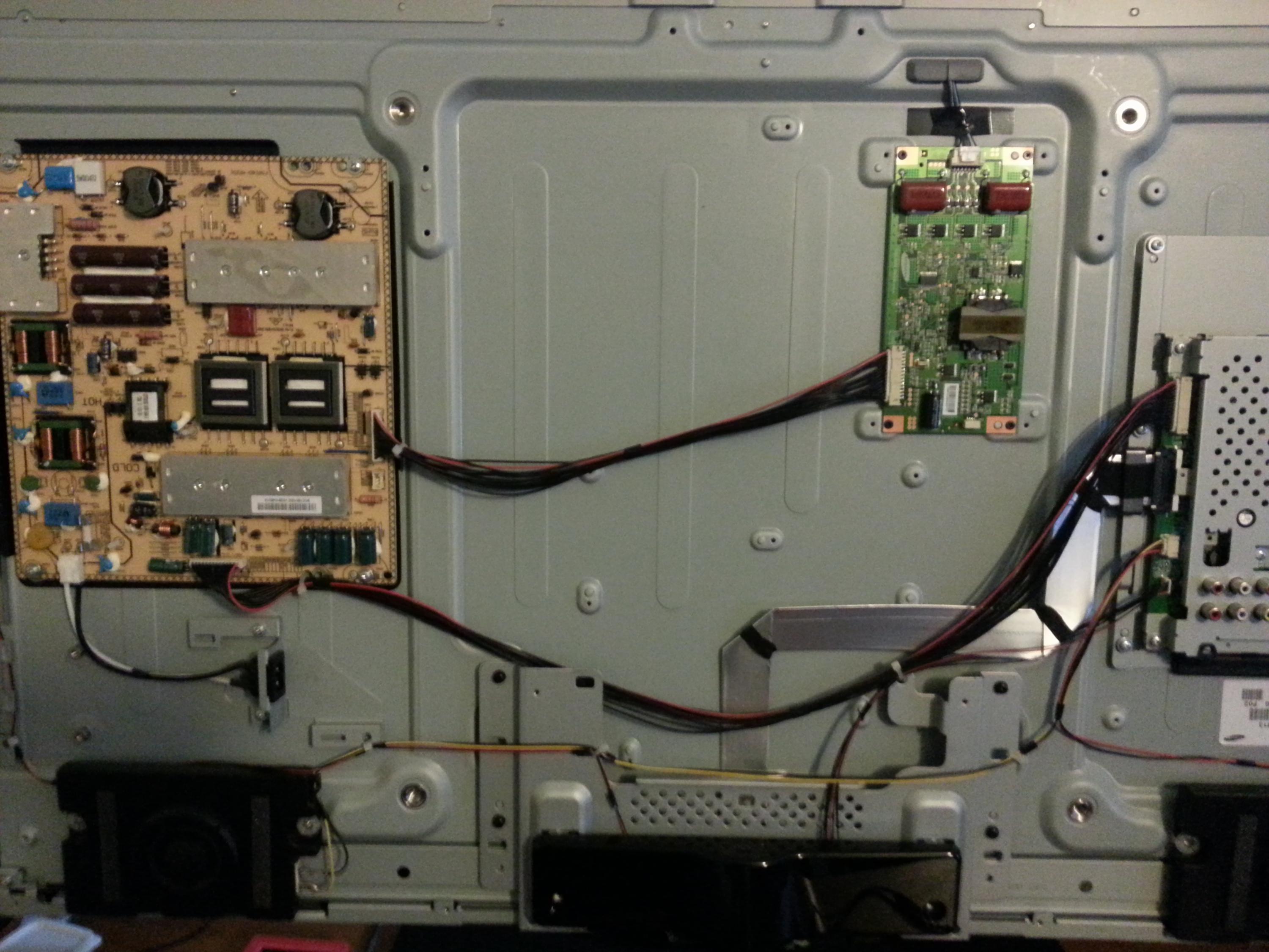

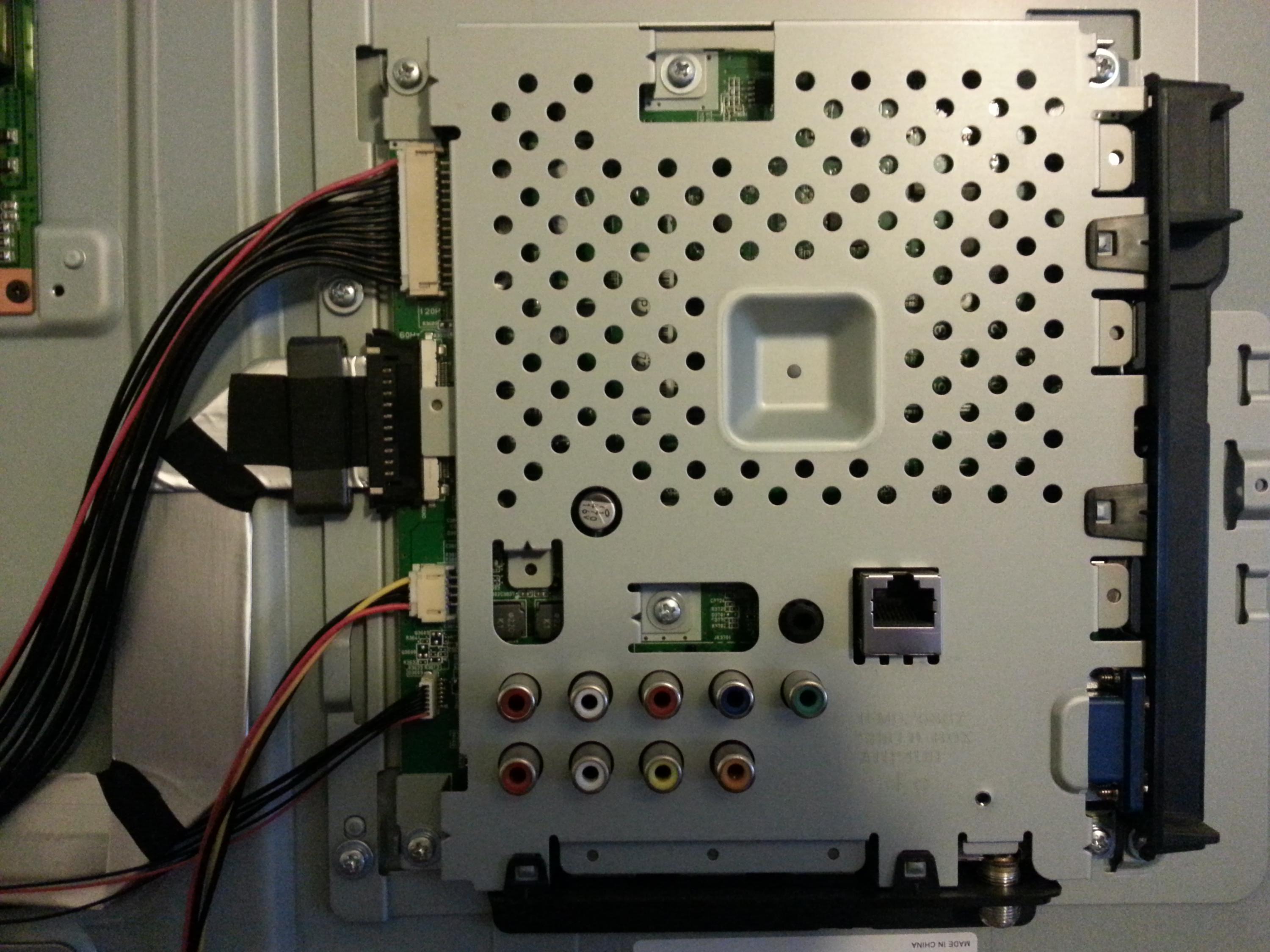

    I have an LED TV that died suddenly. It lost power completely. I tried the Remote Control and the power switch, getting no LED light or any response. The service center diagnosed it as a bad mother board and wanted to charge me $350. I think I can do this job by myself and save some money, but I am not sure which board is defective. It might be the power board or the mother board i guess. Any help is greatly appreciated.
    Re: 40" Philips 40pfl4706/f7 No Power
    Do you have a digital camera to take pictures of the boards, and a digital multimeter to take measurements of various items?

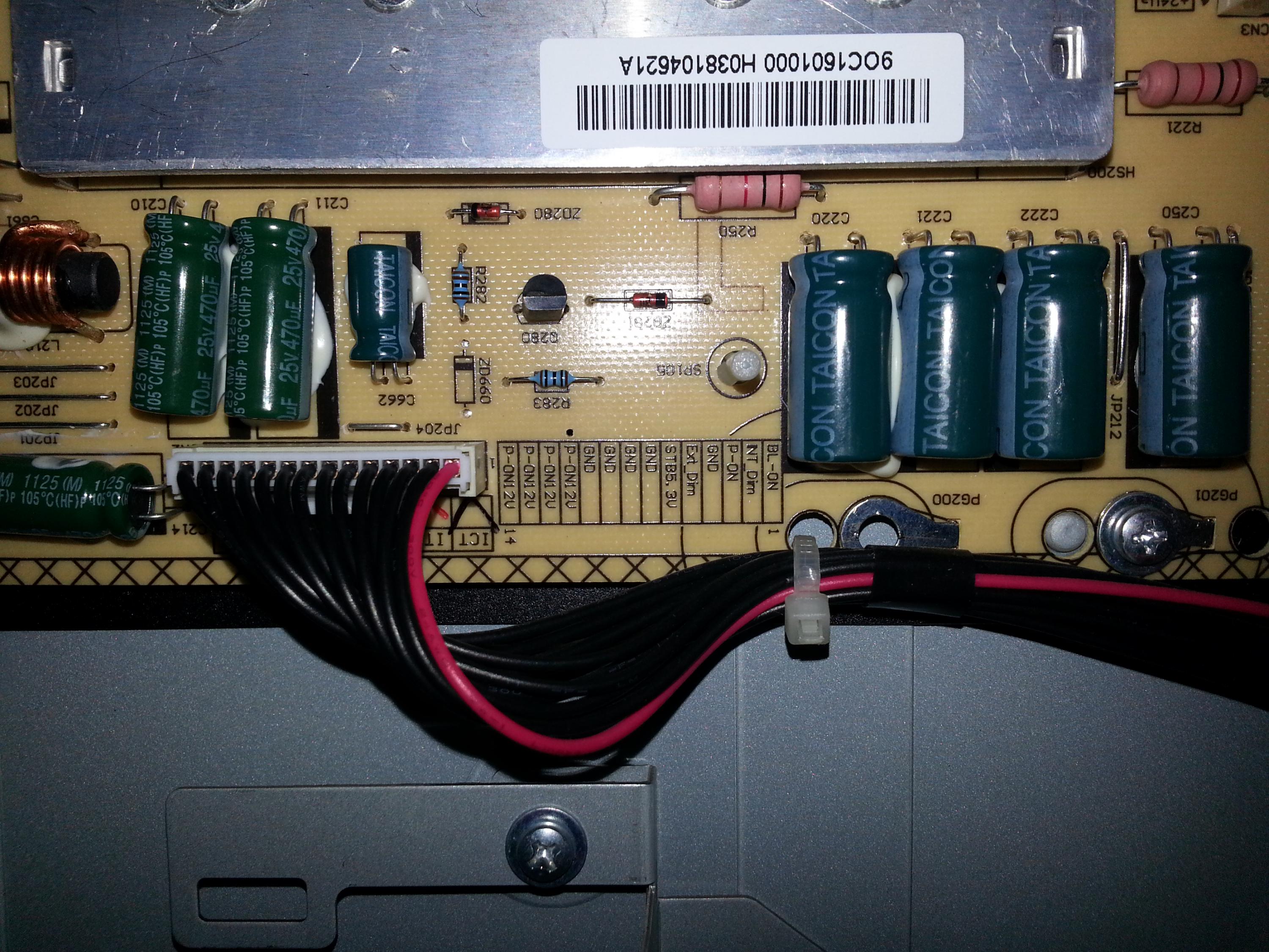

        OK, there's a pin legend next to the connector going to the main board (the main board is the one with the video inputs on it.) Can you either get a picture of this legend or tell us what the labels are?
        • samehms
          • Oct 2013
          • 15
            OK, check in standby voltage on P-ON pin, same as done with 5.3V.
            Then press power button while checking it, does it change? Does it go to 2V or more?
            • samehms
              • Oct 2013
              • 15
              I didn't get any voltage on standby or even when I pressed the power button.
                OK, this indicates the diagnosis of the TV repair shop is correct. Main board (=motherboard) is bad.
                To rule out the power board completely you can try jumpering the P-ON signal, you will need a resistor of value from 100 to 470 ohms. Do you have one, can you get one easily? Wire it between the 5.3V and P-ON, with the connector disconnected from the main board, 12V should then be made available on the P-ON12V pins.

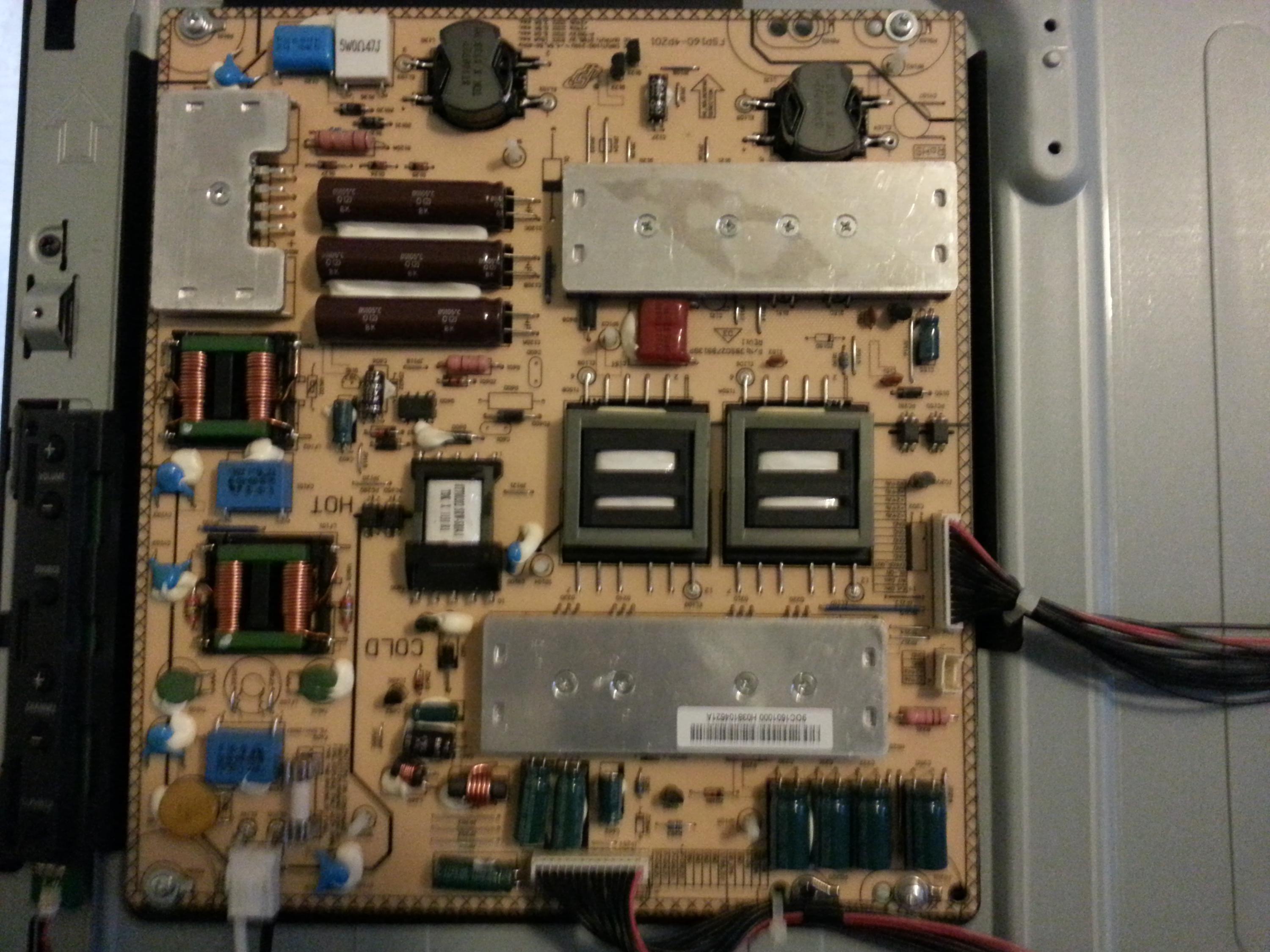

                              I just got the resistors today. I did the test, I shorted P-ON with the 5.3V (Pin #3 and Pin# 6 starting from the red wire) with 300 ohm resistor. I unplugged the cable from the main board and plugged the power cable, but I got NO voltage on the 12 volt pins!!
                                OK, this is interesting, it might NOT be a main board fault.
                                Was that with the connector disconnected from the main board end?
                                • samehms
                                  • Oct 2013
                                  • 15
                                  Yes. it was disconnected. I used that cable end to connect the resistor and check the voltage. i still get 5.2 voltage at P-ON and 5.3V while connecting the resistor.
                                    OK, do you want to try repairing the power supply (you will need component testing experience, good soldering skills) or just replace it?
                                    It is quite possible both the main board and power board are bad, because the main board should still try to make P-ON go high. Could be a victim of power surge damage.
