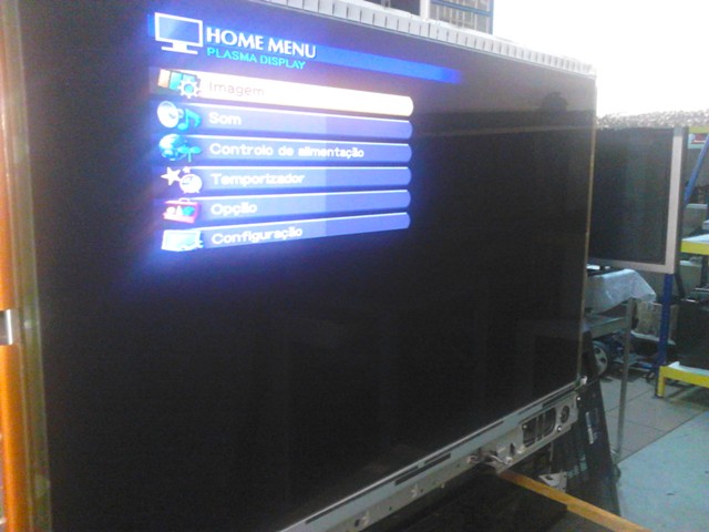

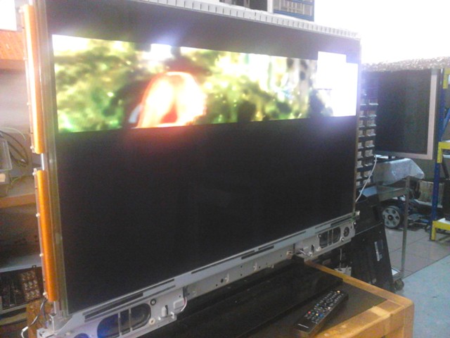

    I have a plasma Pioneer with only less than half screen working.
    I´ve checked:

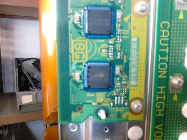

    Scan IC´s all ok not shorted.
    All voltages Y and X boards ok.
    Recheck Cables to Digital board.
    At first customer claims no image 3 times blinking red.
    After rechecking flat cables the TV power on but half image.
    you can see very near an horizontal line black with 1 inche lower image, and the rest of the panel off.
    I´ve attached some pictures. One with dvd image and one with menu.

    Check for bad solder connections on some smd capacitors on y sustain board near buffer output connections I've had thus happen before.
    Get a wooden dowel and lightly press on those smd components while tv is on and see if the screen comes back

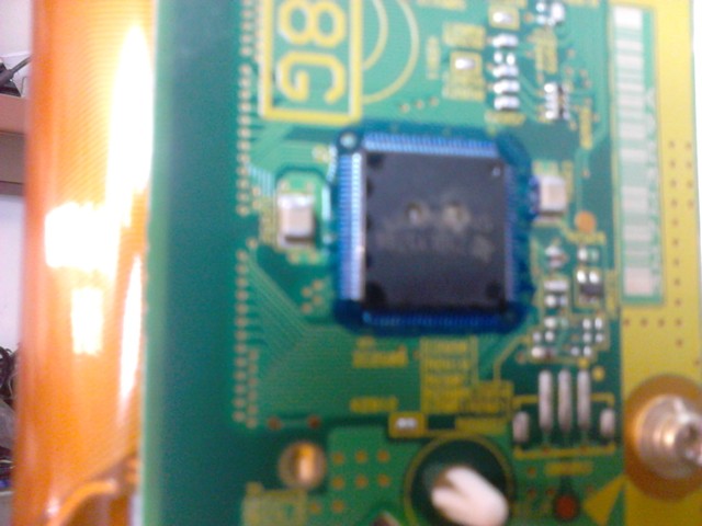

        Found the problem, it´s on Scan IC board, there is no short-circuit but one of the IC´s is damage.
        Will order one Ic and post results.

            With your help off course, looking more closelly with the lent i could see the damage IC.
            Already ordered and will post again, to tell you the result.
