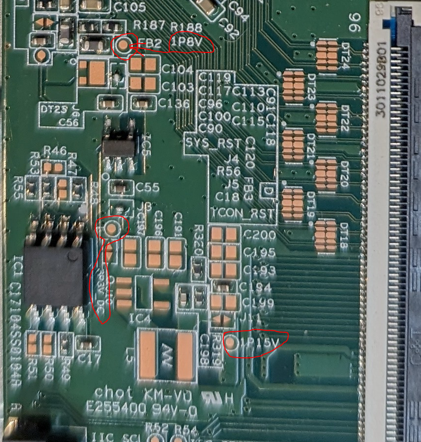

    I get backlights that stay on not there is no image. The tv does not automatically power on when plugged in either which I generally see happen when there is a fault. It responds as it should to the power button.

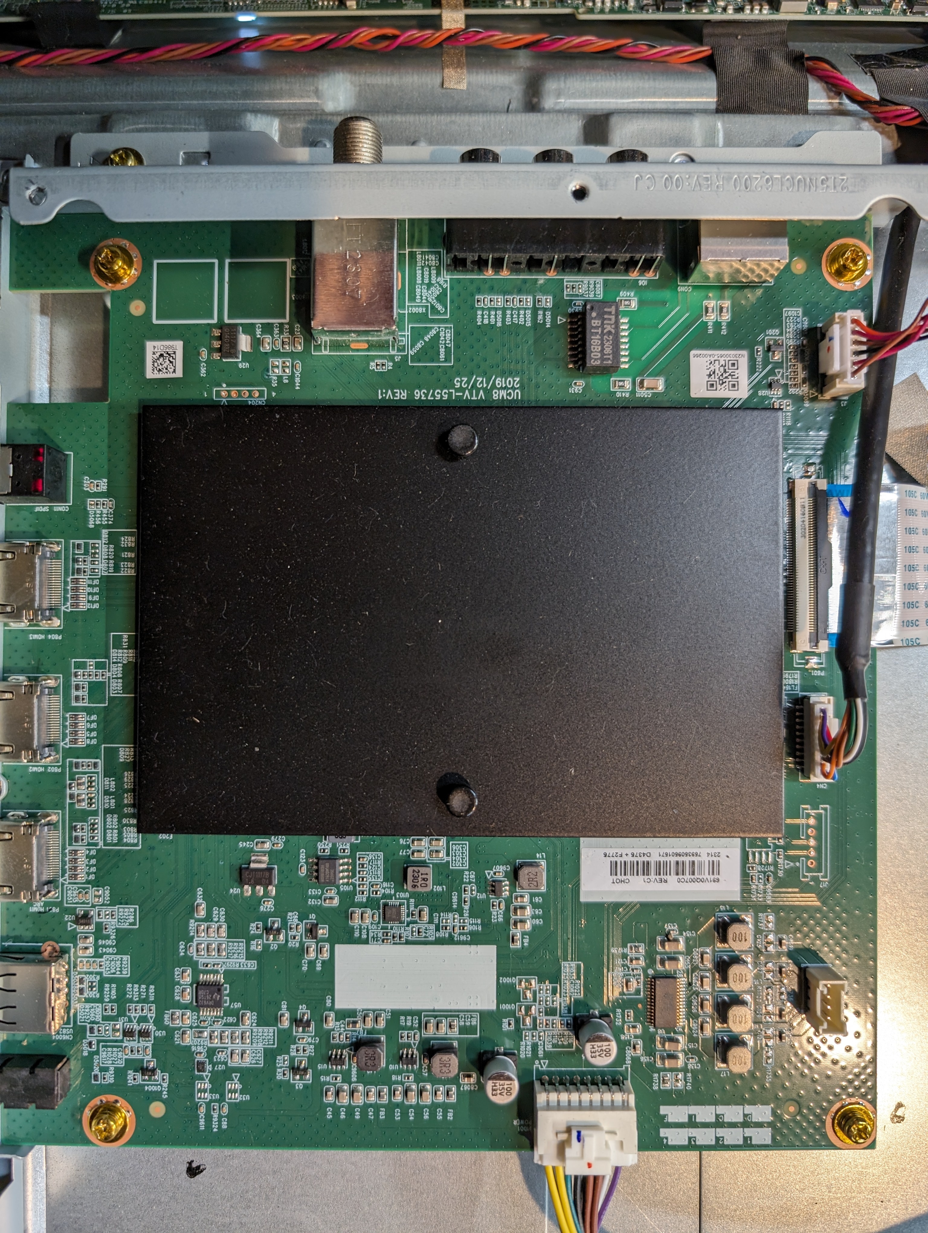

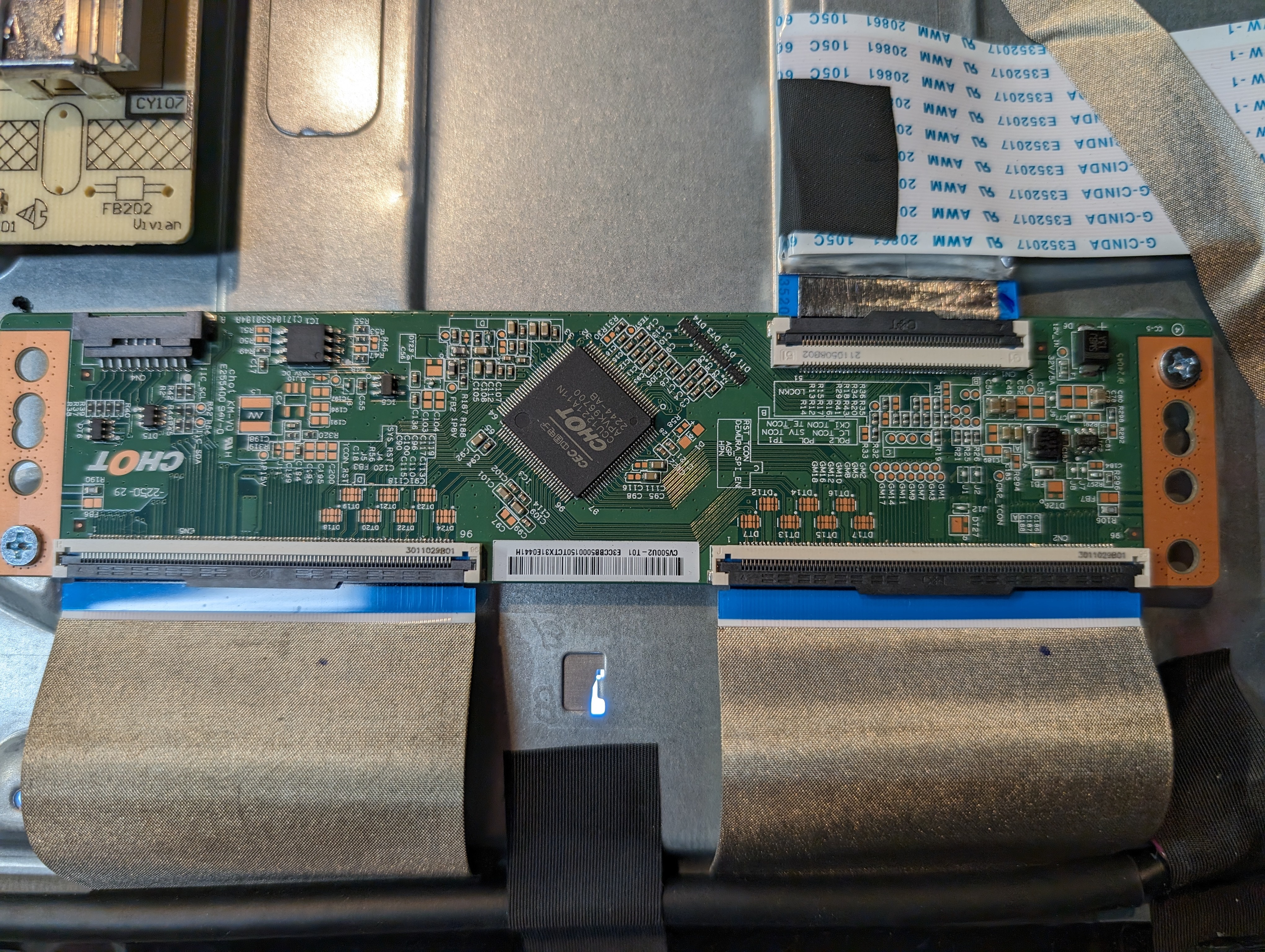

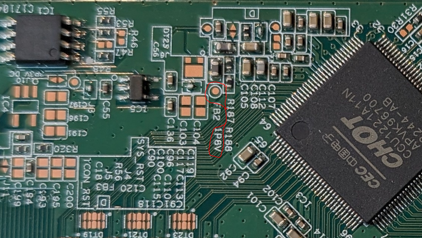

    I checked the test points on the TCON and I have proper voltages except for at 1P15V. I don't know if that is supposed to be 15V or 5V, but either way I only get 1.134V on that point. I have 12V, 8V, VCC, and a small amount on the CKV point.
    I tried heating up the SoC on the main board but that made no difference. Disconnecting either ribbon from the TCON also makes no difference.

    Disconnect one ribbon from tcon to panel at a time and see if you get half image
    • x_orange90_x
      • May 2015
      • 702
      That was the last thing I said in my post. No difference. I reseated the lvds ribbon too.

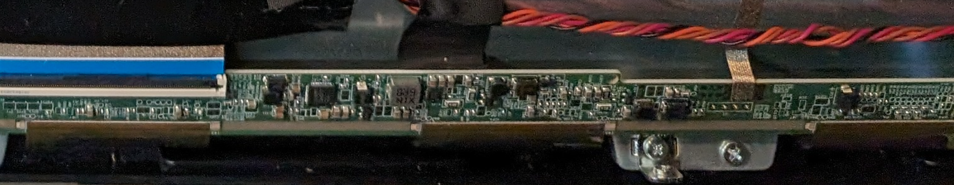

        I wonder where the supply voltages VGH, VGL, VCOM, AVDD are...
        • lotas
          • Jan 2016
          • 4522
          • Russia
          At this test point there is 1.8v?
          1P15V - 1.15V
            1P15V - 1.15V
            1P15V - 1.123v
            ​​​12V - 12v
            VCC - 10.32v
            SCL -3.28v
            SDA - 3.27v
            CK2-TCON - 1.356v
            Those are the only labeled points I see besides TEST and that starts out negative mV and slowly rises into the positive mV.

              1P8V -- 1.8V ?
              • x_orange90_x
                • May 2015
                • 702
                Originally posted by lotas
                1P8V -- 1.8V ?
                Oh sorry. In my first post when I said 8v was 8v that was the point I meant. So 1P8V - 8v
                • lotas
                  • Jan 2016
                  • 4522
                  • Russia
                  Why 8v and not 1.8v.
                  3P3V - 3.3V
                  1P8V - 1.8V
                  1P15V - 1.15V​
                    3P3V - 3.3V
                    1P8V - 1.8V
                    1P15V - 1.15V​
                    I will recheck it.
                        3P3V - 3.3V
                        1P8V - 1.8V
                        1P15V - 1.15V​
                        3P3V - 3.25v
                        1P8V - 1.78v
                        1P15V - 1.14v
                        • lotas
                          • Jan 2016
                          • 4522
                          • Russia
                          Originally posted by x_orange90_x
                          3P3V - 3.25v
                          1P8V - 1.78v
                          1P15V - 1.14v
                          Well, everything matches, now we need to get to the buffer strips and see what is soldered on them...

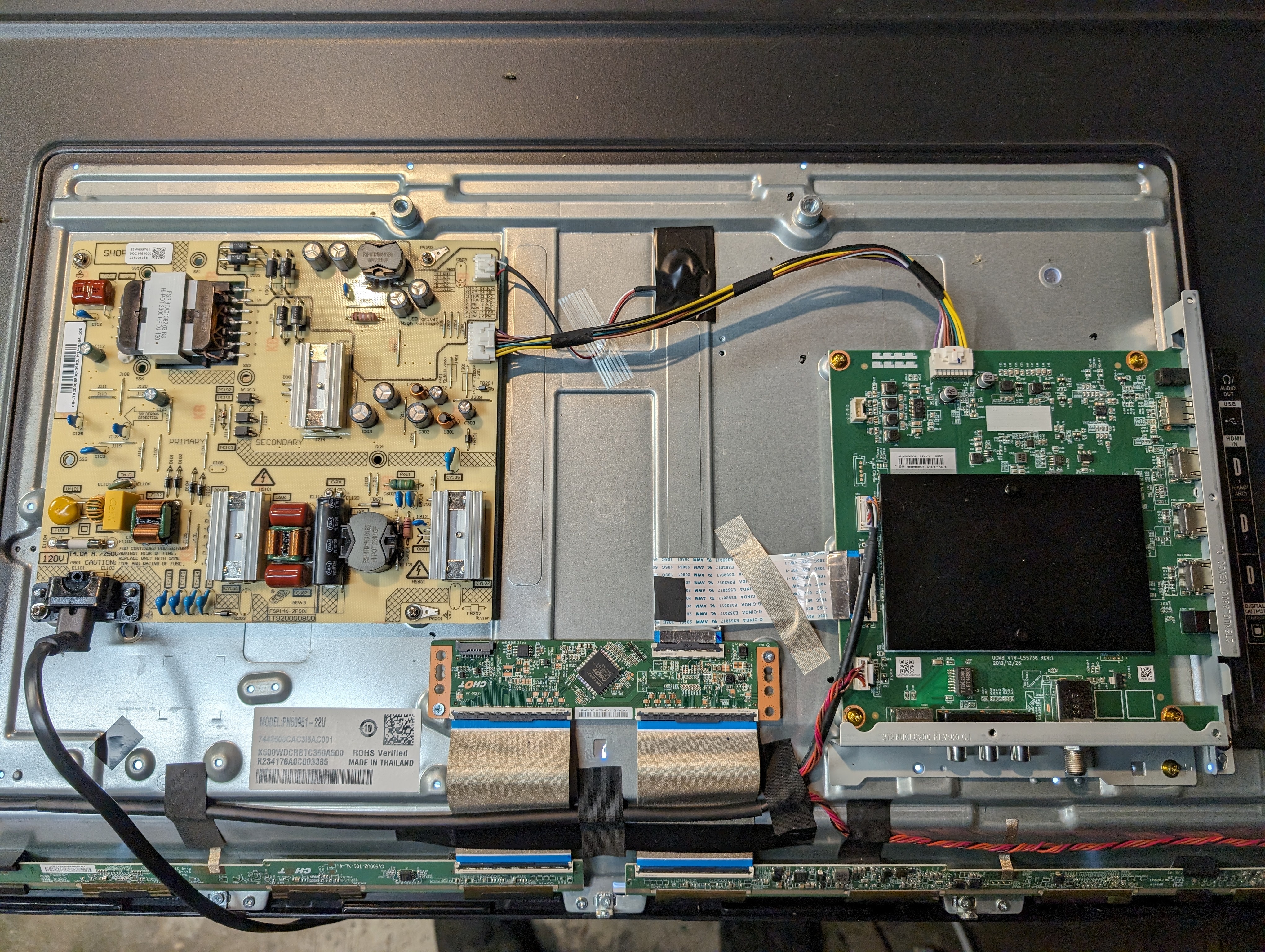

                            I noticed there's a buzzing that comes from the main board when the power is off but plugged in, and it turns into a lower hum when power is on. It comes from the lower part of the main.
                            • x_orange90_x
                              • May 2015
                              • 702
                              What would the chances be that something is wrong on ONE of them that causes both sides not to work, or something being wrong on BOTH sides? I get zero image on either side with TCON ribbons removed, alternately.
                              • lotas
                                • Jan 2016
                                • 4522
                                • Russia
                                Your second part of the t-con is soldered to the strip, where all the main voltages for powering the panel are formed.

                                      I reviewed that thread before making my own post. I have backlights though so my issue is somewhat different I think. Nonetheless I'm still suspecting the main board. Is there anything I can/should check on the main?
                                      • x_orange90_x
                                        • May 2015
                                        • 702
                                        I looked at the strips and see several more test points, but didn't see VGH, VGL, etc. I did see VCC however. I will recheck later today when I am home.
