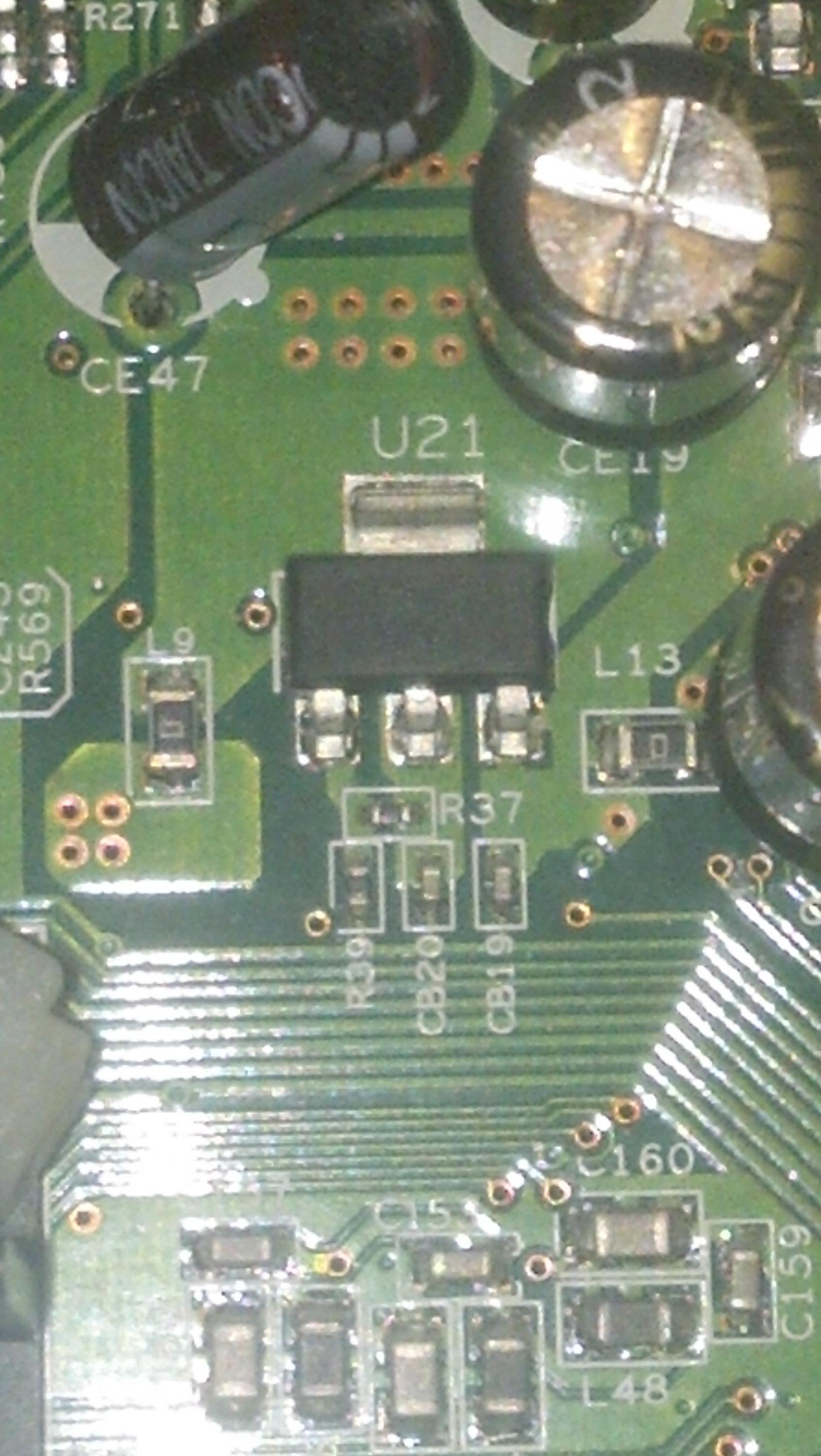

On the main board, on U21 ldr, the output and input are .619volts. pretty sure its the problem, but what should i check next and values am i looking for? These vizios usually have a ldr issue, never had to explore beyond them. thanks

yes i checked them all. the only one that wasnt reading normal was the u21. amc1117, leg 1=0volts, 2=.619volts, 3=2.5volts. so maybe the cap is bad not suppling the right volts?Comment

What is written on the body of the U21, just 1117 and no other number, any pictures of the board that shows the closed up pictures of this U21? If it just has 1117, then it is an adjustable Vreg, the voltage between pin 1 and pin 2 will always be the Vref of 1.25V +/- 2%. It has 2.5V Vin, so the output should be 1.25V out. It can have very heavy load that is pulling down the out put or bad input/output filter caps. The 1117 drop out voltage is around 1.2V (the diff voltage between the input and output), so it is running real close to the drop off point.Last edited by budm; 10-11-2013, 02:43 PM.Never stop learning

OK, the output of U17 is fed into the input pin of U21. Please verify by checking the resistance between pin 3 of u21 and pin 2 of u17. If U17 is not the one, we need to find out what the input pin of U21 is connected to which one of the regulator output pin.
We need the voltage readings of all the regulators.Last edited by budm; 10-11-2013, 03:57 PM.Never stop learning

Look like you do have bad U21. Its input may be fed by the output of U19.Last edited by budm; 10-11-2013, 04:25 PM.Never stop learning

Correct budm, u19 V.out to pin 3 of U21 is .8ohms. U19 output is 2.5volts, U21 input is 2.5volts but the output is .619volts. so that lil guy is bad for sureComment

when ordering the new amc117, not finding the original anywhere. so as long as its a 2.5v amc1117 would be good?Comment

You need to get 1117 adjustable regulator. See post7 for listing from digikey.
https://www.badcaps.net/forum/showth...999#post300999
You need 1.25V output not 2.5V. The output will be 1.25V when ADJ pin is grounded.

its ordered. thanks budm. am working on tv's atleast this one is on its way to being up and running again.Comment
Re: VIZIO VW32LHDTV20A Video issue
Working great again. thanks budm, order extra to have on hand. this place rocks! now on to the 42 inche one, allways got something to fix around here. thanks again all.Comment
