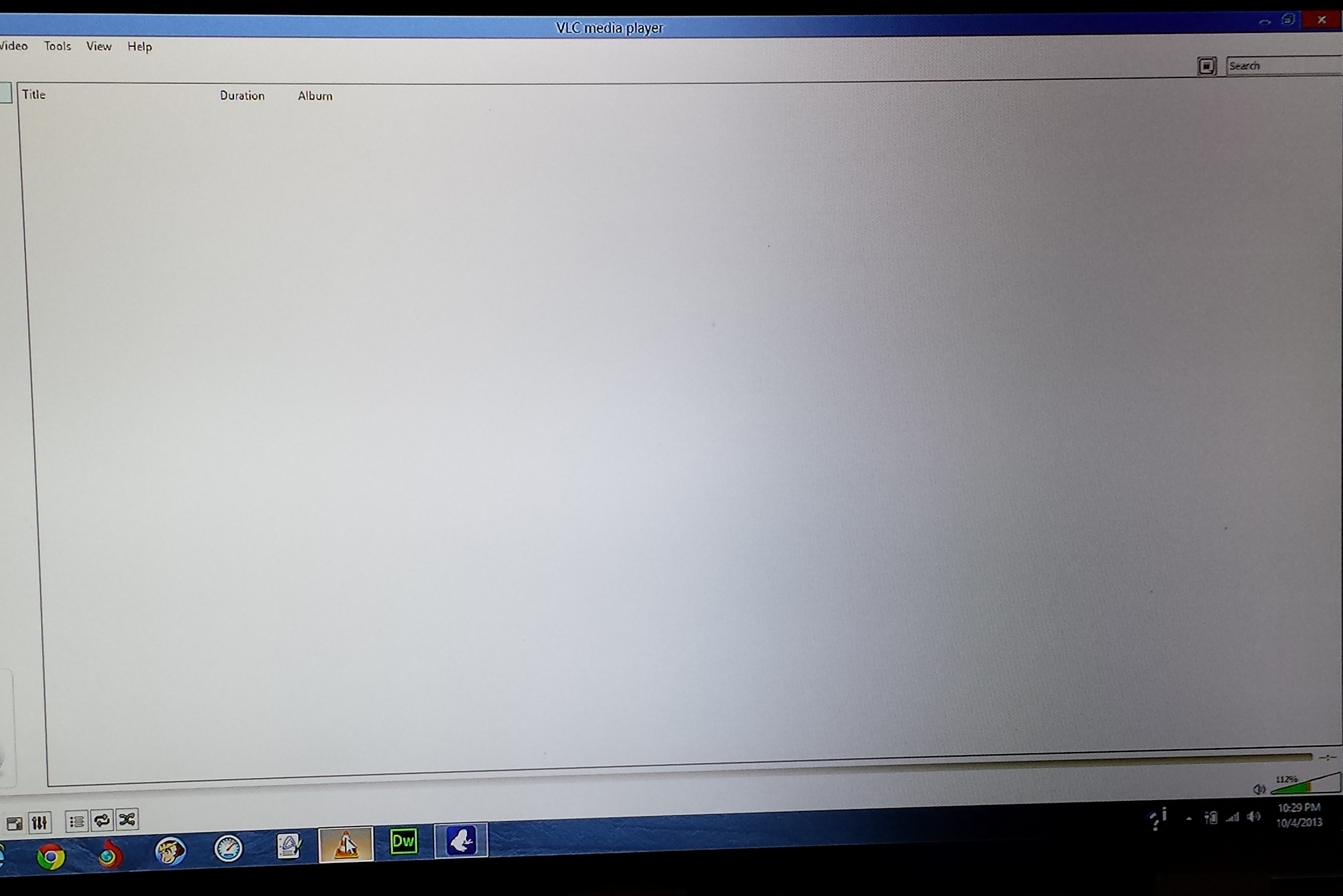

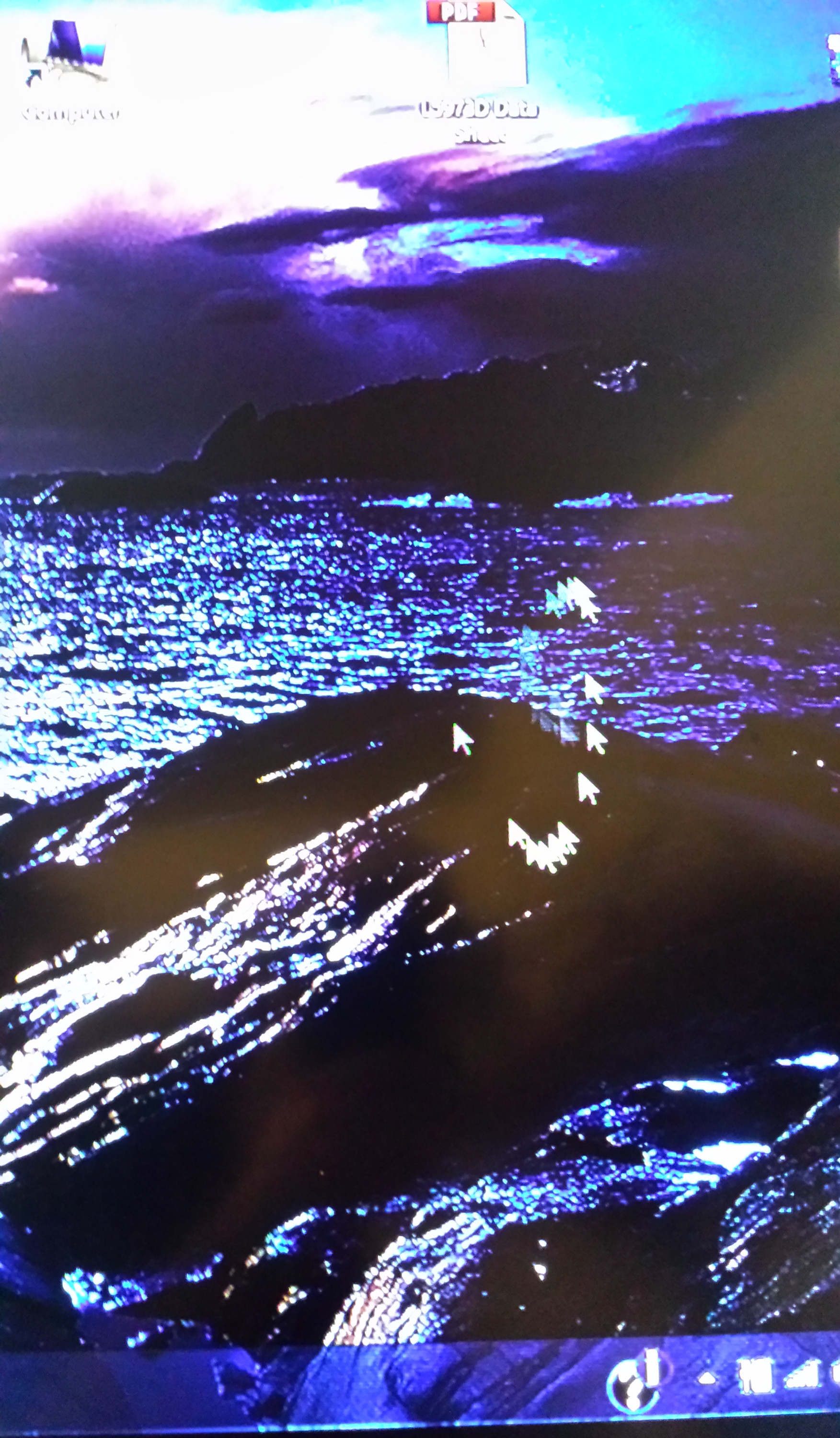

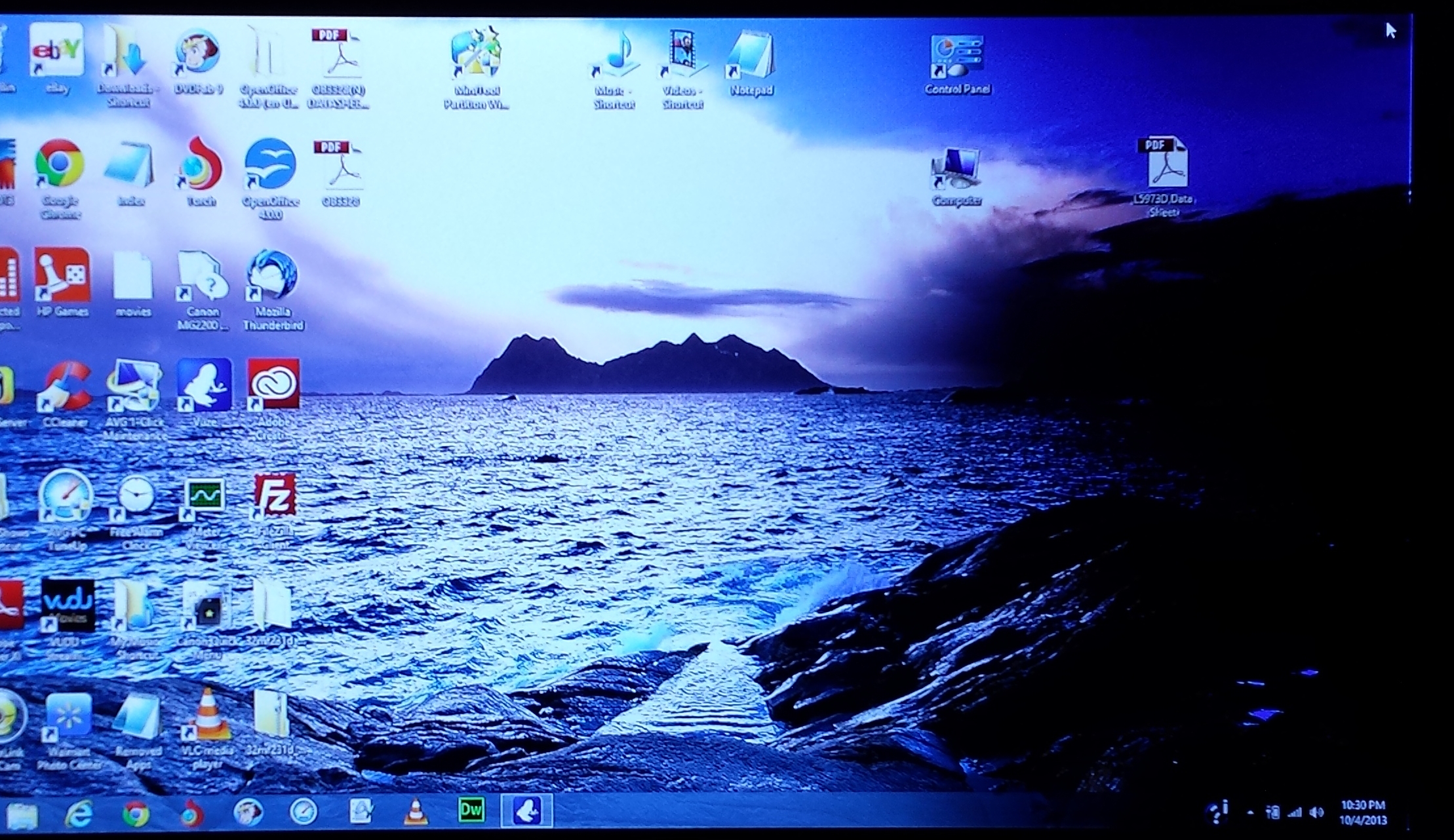

                Here's a couple pics. I also noticed that on the right side it flickers sometimes and i can see scanlines.

                        I'm beginning to think its not the panel. I've been doing a lot of reading and most of the TVs with bad panels will clear up a little if you flex the panel a little. Also, its to even. Its as if there is an invisible line right down the middle of the screen. Every thing to the right of that line is darker. From what I've seen of bad panels, its usually areas of dead pixels but not one was exactly one half of the screen. I'm leaning toward a bad IC, or some other component, on the panel board. I'm going to try to find all the data sheets for the ICs and see what they are and try to narrow it down. Hopefully, if it is an IC, I will be able to find a replacement. Would be great if someone had a cracked panel and could just tear the board off and sell it to me. I could then just use my rework station and swap the ICs one at a time.

                          It looks like the right hand LED strip is dark, it's possible for the main board to go bad causing this.

                                I was hoping that wouldn't be it. Here's the pic of the mouse pointer.
                                Edit: still though, wouldn't a bad tab leave me with lines or something? Would it affect exactly one half of the screen?

                                  Re: westinghouse LD-4255VX right side dark
                                  Bad tabs can affect halves of panel and also affect motion blur without any other problems.
                                  Symptoms vary. Sometimes you have vertical lines, poor refresh rate, double images/stretched images, flipped image (very odd one!), wrong colour, blurred image...
