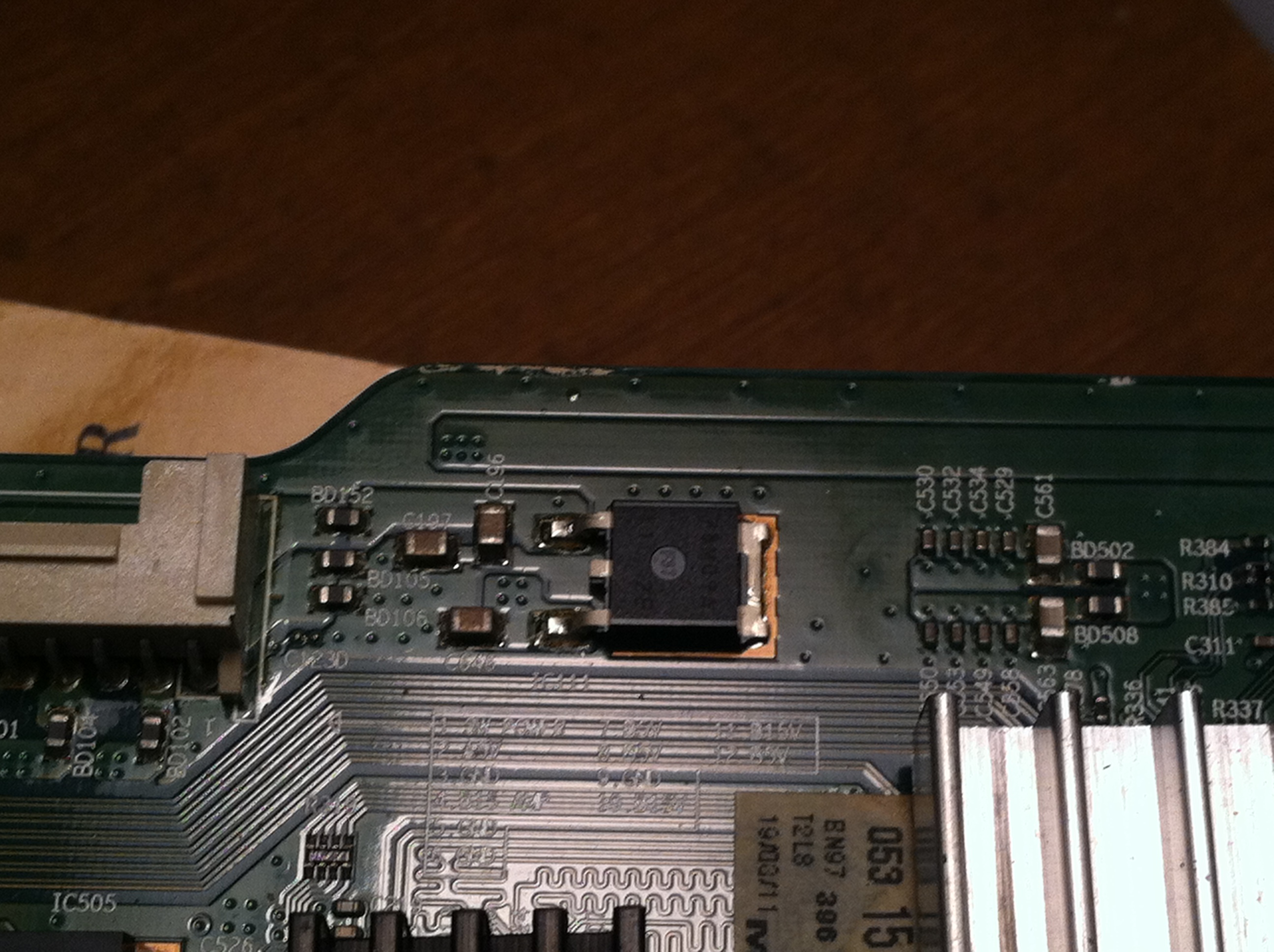

              I have been following this thread closely. Since I have been trying to repair an samsung 43" Plasma with the clicking relay problem. I Found a shorted FET on the Y sustain board so I replaced the board and relay still clicked. With the new Y board the TV would BOOT UP with the X board unplugged so I thought it was the X-Sustain Board. I ordered one off ebay but still same clicking relay with it plugged up. I checked all the fet's off the inital X board and they were shorted. All the Fet's off the board from ebay were shorted also. I ordered another x board off of ebay and checked all of the FET's FIRST and they were not shorted. I installed the board and it booted up but just a flash at first on the screen. The Vs and Va is there for an instant and then drops. I double checked and found out the second board I just ordered is a revision 1.8 instead of a 1.6 that was in the ebay photo. GRRRRR.... Is their anyway to make the 1.8 work? I can't install the new firmware if the TV is not working. Any suggestions???? I think I have a bad x sustain board and I have not gotten a good one yet off of ebay.. What should I do?

                  Still working on this set. Found out if I unplug both ribbon cables going from the X and Y sustain boards to the small microprocessor board in the center of the set that I then have VS and Va voltages on the power supply and the Ve voltage on the X-board.. Don't know if these ribbon cables supply the firing sequence to both boards but suspect they do. I am gonna remove small microprocessor board and inspect it next...

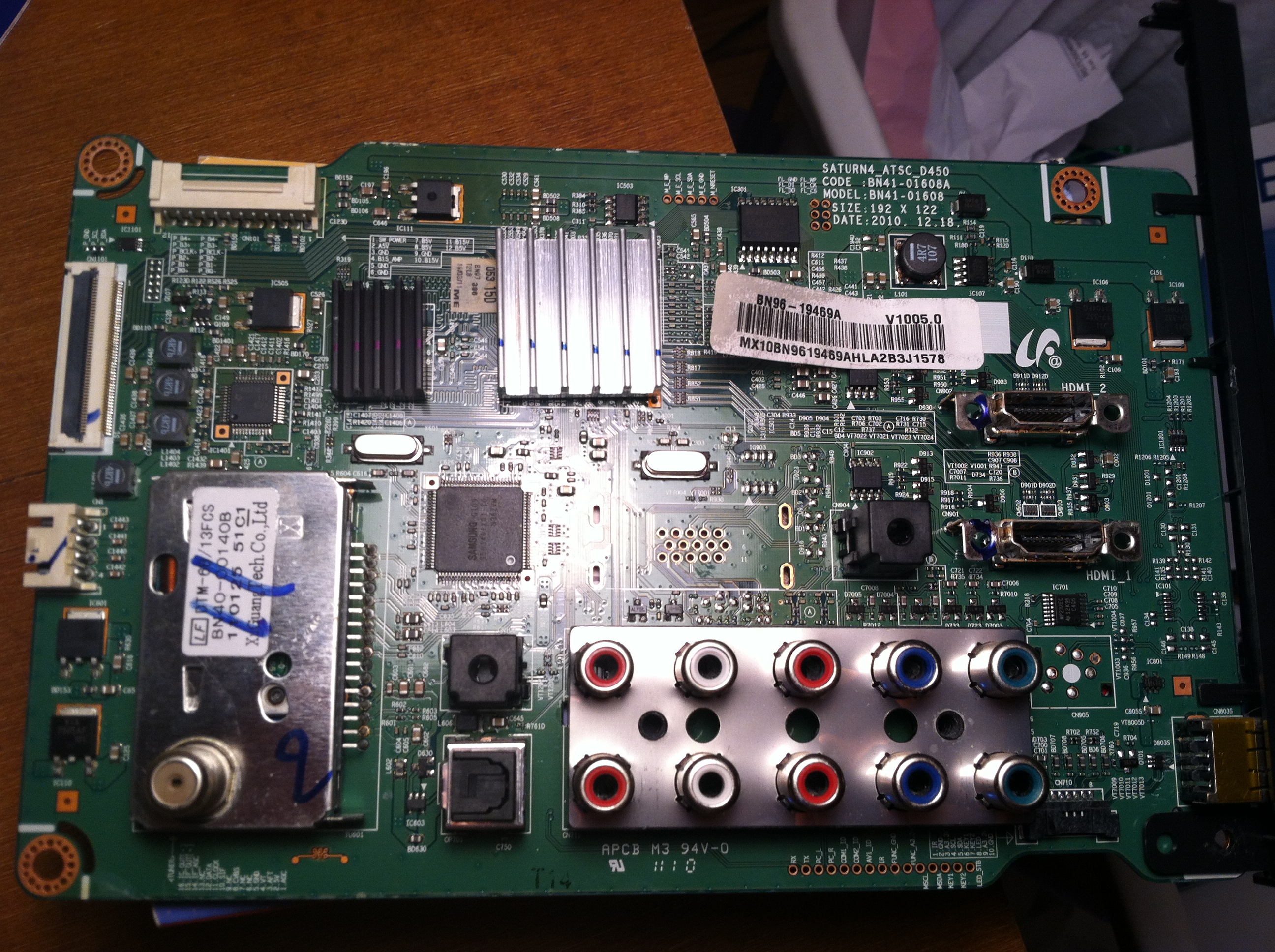

                    Here is what I have done so far.. Replaced both X and Y sustain boards... I am not getting the PS-on signal out of the control board. I removed the control board to take a look and it looked like it had gotten wet at some time. There was alot of thick crud on the back of the board. I cleaned it off but that did not help. I checked the voltage on the regulators on this board and IC 111 voltage looks suspect The tab goes to ground on this one and I have 14.8 volts input and 8.9 output. Is this a 12 volt regulator? I will post a pic of the board and IC111.. Just found a replacement board on e-bay for 13 bucks... gonna see what that does.. Still would like to know about that regulator... It acts like something is shorted on that board because I took a 1k resistor and jumpered from 5V to PS-on. The voltage with the jumper would just read .3 volts .... way too low..

                      Well still no progress. I replaced the video board and same thing. I suspect that I should have replaced the X and Y at the same time instead of replacing separately. Some lessons you learn the hard way. Double checked and have shorted regulators on the Y driver board now. Checked the X board and all the regulators look good. All of the regulators were blown on the original X board so I suspect they took out the new Y-board anyway I have a used Y board on order off of e-bay .. Gonna give that a try. I ordered a set of RJP63K Fet's off of ebay and when I got them they both read open in every direction. I suspect they got zapped coming thru customs. Anyway I am gonna try another Y board when it comes in.

                            Ok.. Still no go after replacing X and Y boards... Twice. I Pulled the IGBT from the second Y board and it reads open in all directions and will not turn on with a DMM in Diode check Mode. I used the method in the video from the link above. I checked some know good IGBT's I had to make sure I had the method down pat. The IGBT that reads open is an 30G124. Guess I will order one and replace it and try that next.

                              Well now I still have the same problem. I found out the IGBT was good after I checked it with a different DMM. I tried jumpering pins 3&4 on the main logic board while removing the cable from the video board. If I unplug the ribbon cables from the X and Y boards then I get the VS voltage (207) volts.... I am suspecting that the buffer board may be bad that connects to the Y-Main. What do you'alll think. I have replaced both the x-main and Y-main boards twice. I do get sound and the remote works fine but just no picture. If the buffer is bad would this also cause it to go into shutdown mode?

                                Just ordered a buffer and a main logic board off of e-bay all for less than twenty bucks so i thought it would be worth a shot. Ok the question I need to resolve is on the X-Main board will Revision Board 1.8 work with this TV? It had a 1.6 which I bought a replacement for off of e-bay. The seller sent me an 1.8 instead and said that this was the replacement That I would just have to upgrade the firmware when I got the tv working. Is this true?? I hate to keep sinking money into this beast.

                                  1.8 will work in place of 1.6, but yes, you do need to update firmware after it's installed.

                                    Success !!! I finallly got this one working. I got the main logic board and buffer board in the mail today. I just went ahead and installed both of them at the same time. I did not want to take a chance at blowing anymore boards. It has a beautiful picture and looks great. I am not going to play it until I get a memory stick tomorrow so I can upgrade the firmware. I had a card reader I transfered the new firmware too but the TV would not recognize that so I guess I need to invest in a memory stick. I can use that for other things also. I am just glad I finally got it to work. I learned the hard way replace X and Y and buffer boards at the same time on this model. Thanks for everyones help.
