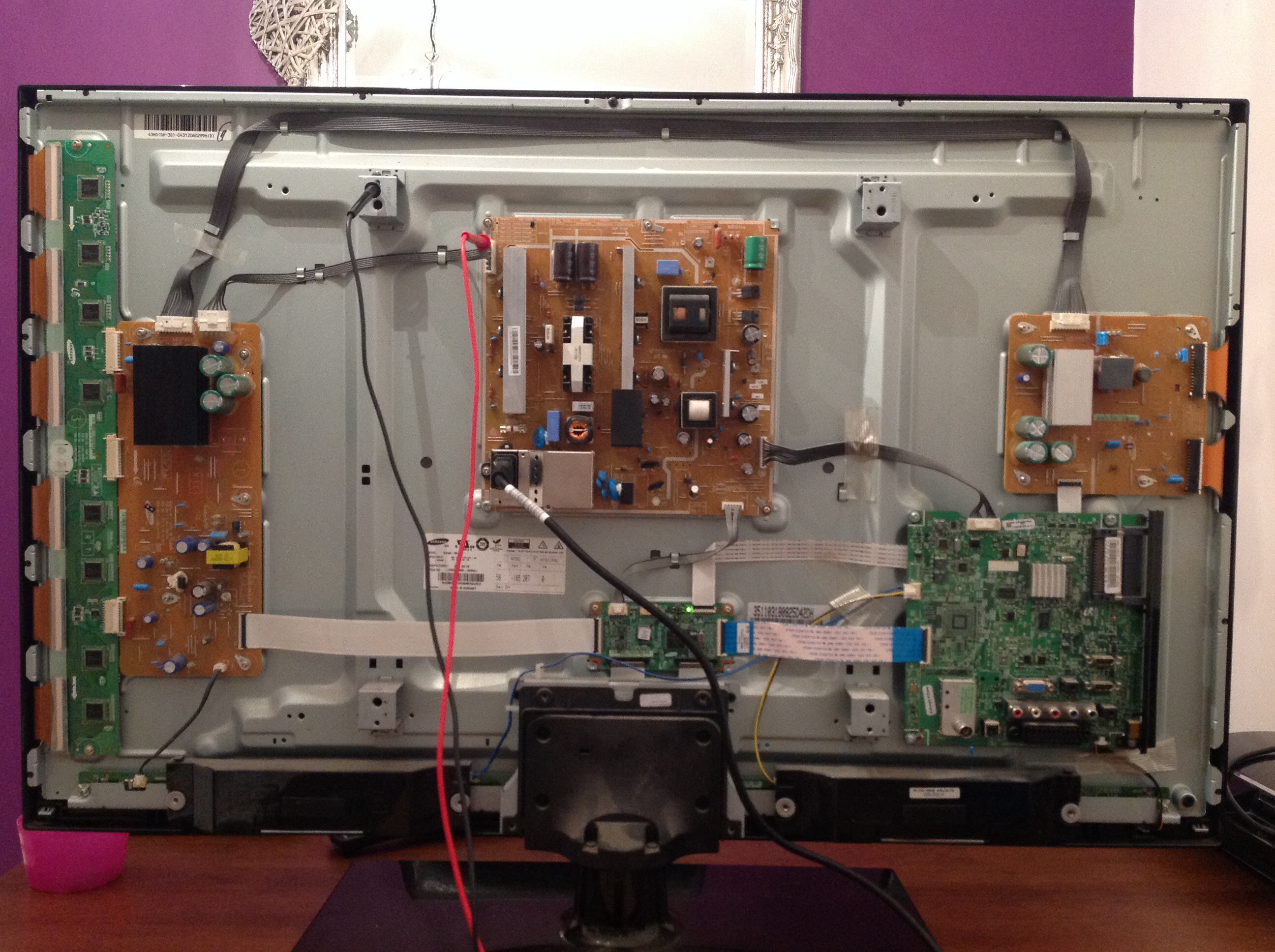

                    #129
                    Re: Problem with Samsung ps43d490 PDP
                    I have just tried to turn it on and the screen won't come on at all now. When I give power from the wall, the standby light is on. When I press the power light on the remote, the red light flashes on and off every second but the screen stays off, no luminance / glow at all from the tv?
                      #130
                      OK, time to take the cover off your TV and get some nice clear pictures of the boards in your set.
                      I ask for the boards in your set because Samsung changed the design of this TV mid way through production so your TV could have one set of boards or another.
                      • guy_hall
                        • Sep 2012
                        • 8
                        • England
                        #131
                        I watched a video on YouTube about this model shutting down, for him it ended up being bad solder joints on the 42dh ym so I took it off, re soldered most of the joints, put it back in ant it is working at the minute. I refined the voltages using the pots, now I'm just waiting to see if it goes off, while having a go on the ps3 hope the picture uploads properly
                        The heatsinks on the transistors get red hot though, don't know if that normal

                          #132
                          Just for info, before I just did this, voltages were round 207 and 58 on standby, as soon at I took it out of standby, the voltages dropped slowly and the screen didn't come on. I have also updated the firmware now the screen is working a bit In case there was an issue there

                                  #136
                                  It seems to have worked, I have given it about 5 hrs of testing and had no issues compared to 10mins max before but time will tell. It's certainly done something and hopefully it helps someone else too.
