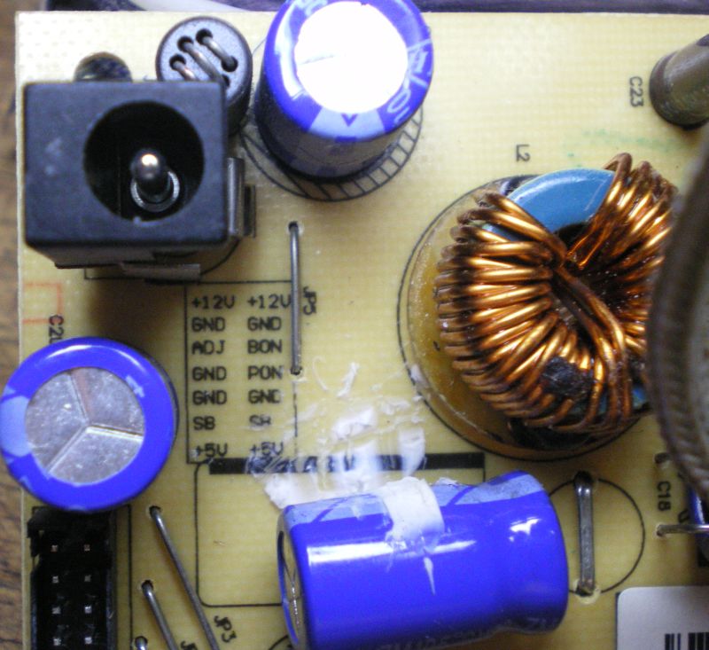

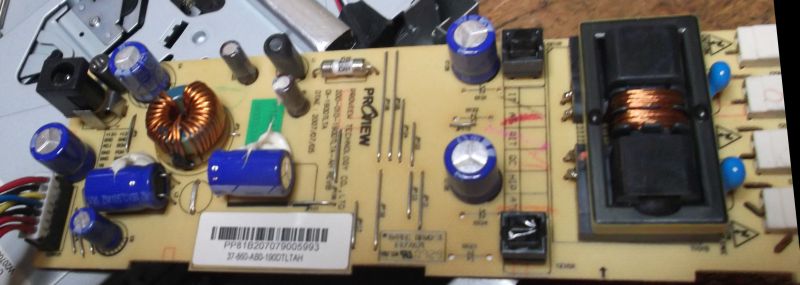

    Dear BadCappers:
    --This Polaroid 1913-TDXB TV, Monitor with DVD, has the typical 3 seconds to black syndrome. I am pretty sure the problem is on the inverter board, but it does not stay on long enough for me to tell if all the lights are coming on. Attached are two pictures of the inverter board. Could some one please tell me how to get it to switch on, with just the board, and the power supply, so I can determine if the problem is lights, transformer, caps or what have you. The caps are HEC, and probably crap, but they look fine and have not yet been checked and will be replaced as a matter of course if the inverter board is otherwise good. If the inverter and the light are good, I will then check the caps for capacity, open, short and ESR. Otherwise I will probably part the unit out. I am not sure I need a schematic, but it would be nice to have one, just in case, if anyone happens to know where to get one.

    Do you see a pin marked BLON, B/L or ON/OFF?
      Re: Polaroid 1913-TDXB 3 Seconds To Black
      Since it has 4 lamps, you can have one lamp plugged in one at a time, turn it on and see if you can see the screen light up, do it in a dark room. the inverter transformer also has two high voltage windings, you can check the resistance of the windings.

        --Tom: The second picture I posted shows the following labels for the plug:
        +12V +12V
        GND GND
        ADJ BON
        GND PON
        GND GND
        SB SB
        +5V +5V
        --I assume that BON would likely be the pin you are talking about. Do I short that to the +5V or what? Thanks?
        --Budm: I have power supplies for testing the CCFLs and will do so when it gets dark. In the meanwhile I have ordered another one of those universal 4 lamp inverters from Hong Kong, I am not sure if it has enough connections, but I wanted one on hand anyway. I also have spare bulbs to test the inverter with. I sure hope it is not the bulbs. The last one I had fixed a Star Logic M17ANA Monitor, which I am about to flog on eBay, funds getting short.
          BON - connect to 5V but best to use a 100 to 470 ohm resistor in series.
            Dear Tom:
            --Perfect, thanks. I will report back soon.
              Greetings Badcappers:
              --I found that one of the lamps had gone red. I took the display apart and replaced the bulb with one out of a junker, and now it works. Hooked up to HDMI the screen is stretched out beyond the edges of the monitor. It that probably due to caps on main board, or are there other probable causes.
