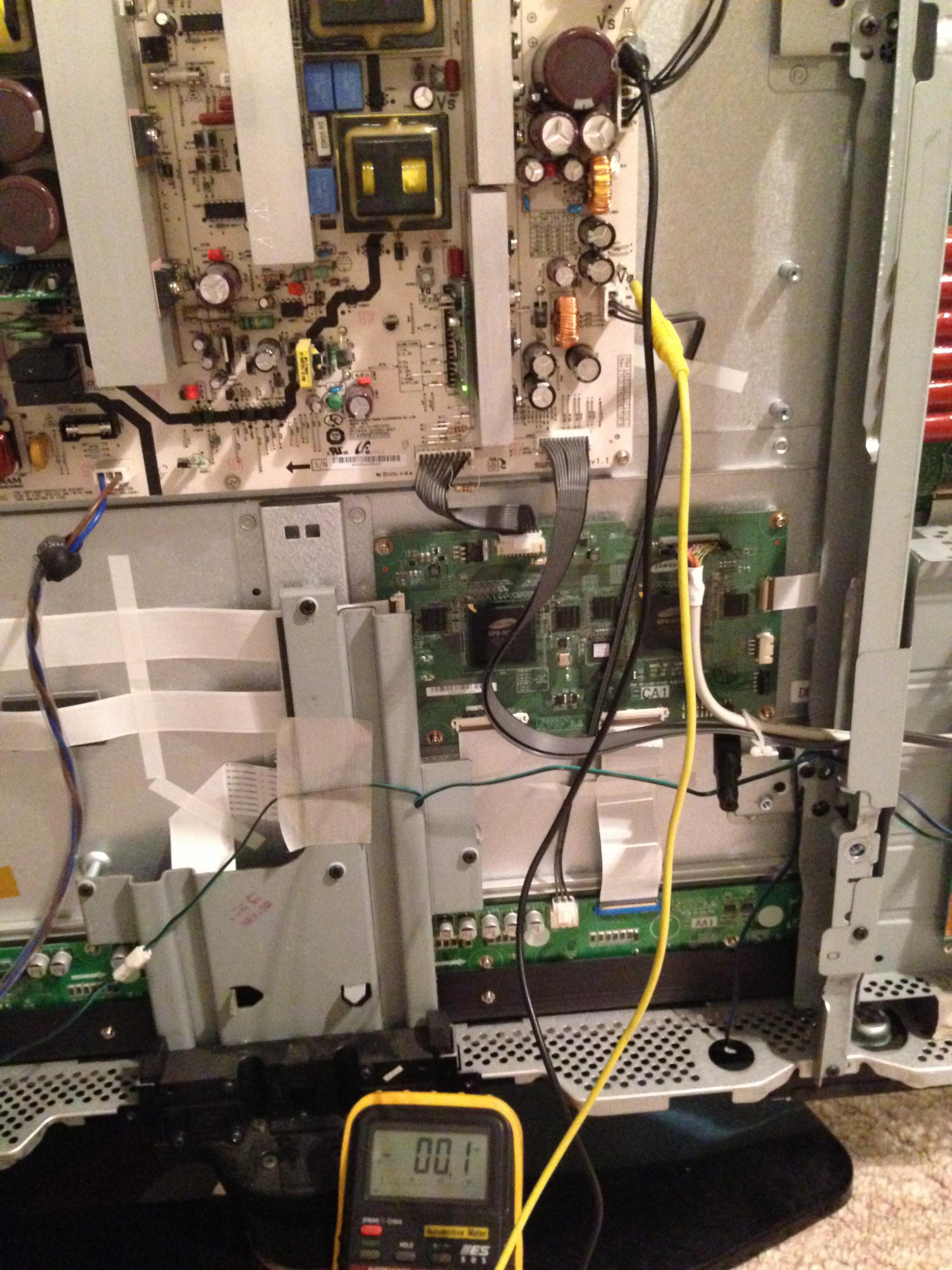

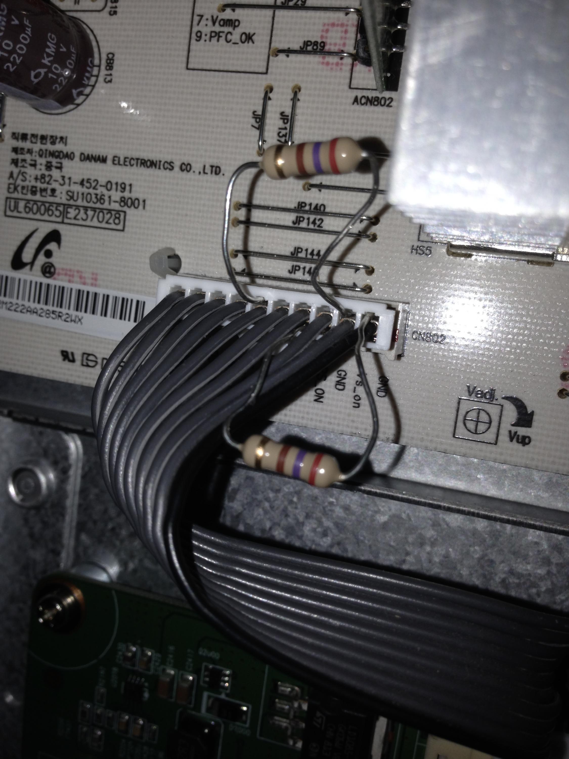

      Installed 270 ohm 1/2 watt resistors between the PS-ON and Gnd and the Vs-on and 5.3 v on the Power board end of the cable from the Logic board to the Power Board (cable connected).

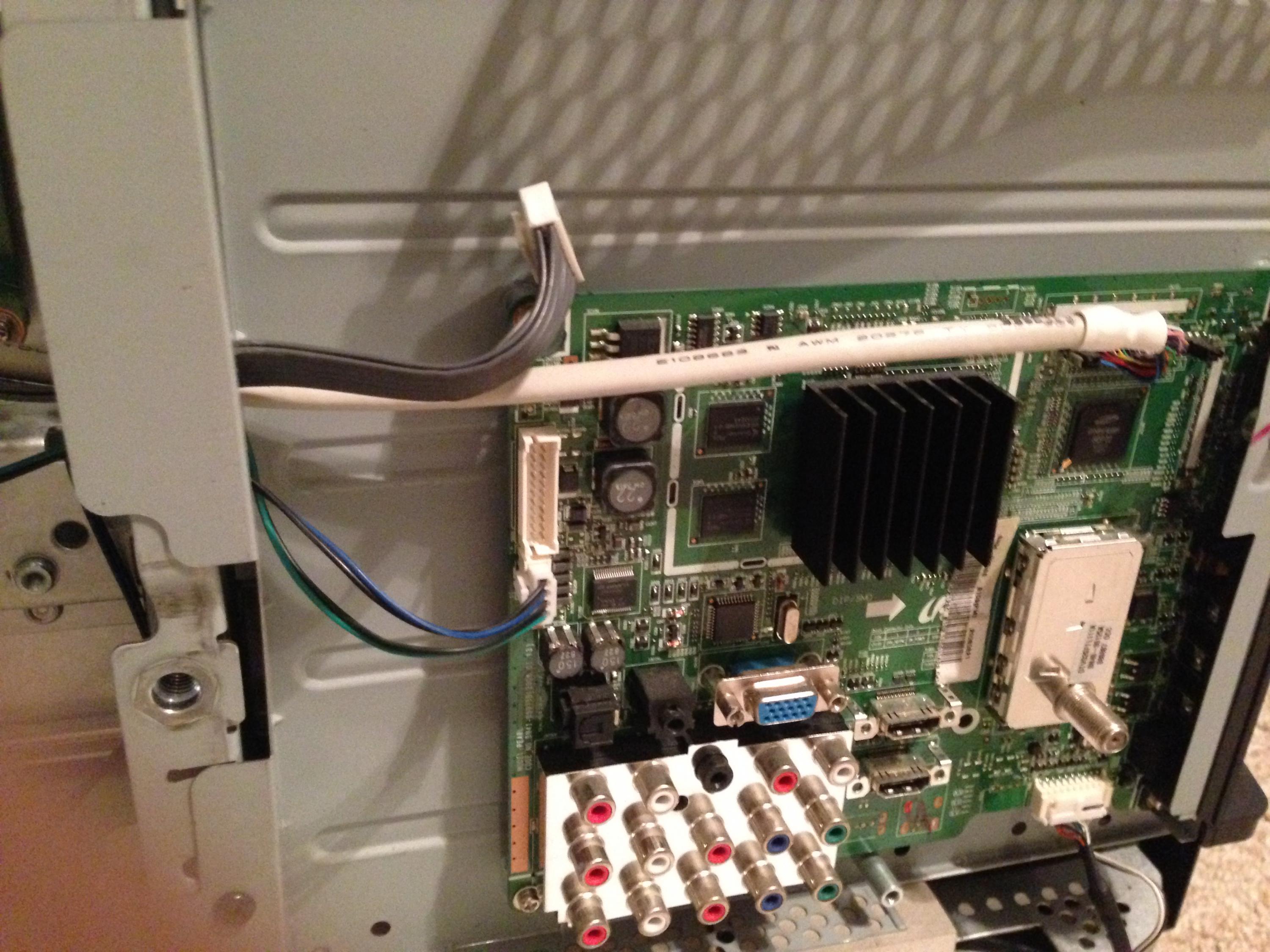

      I unplugged the cable from the Power Board to the Main Board at the Main.

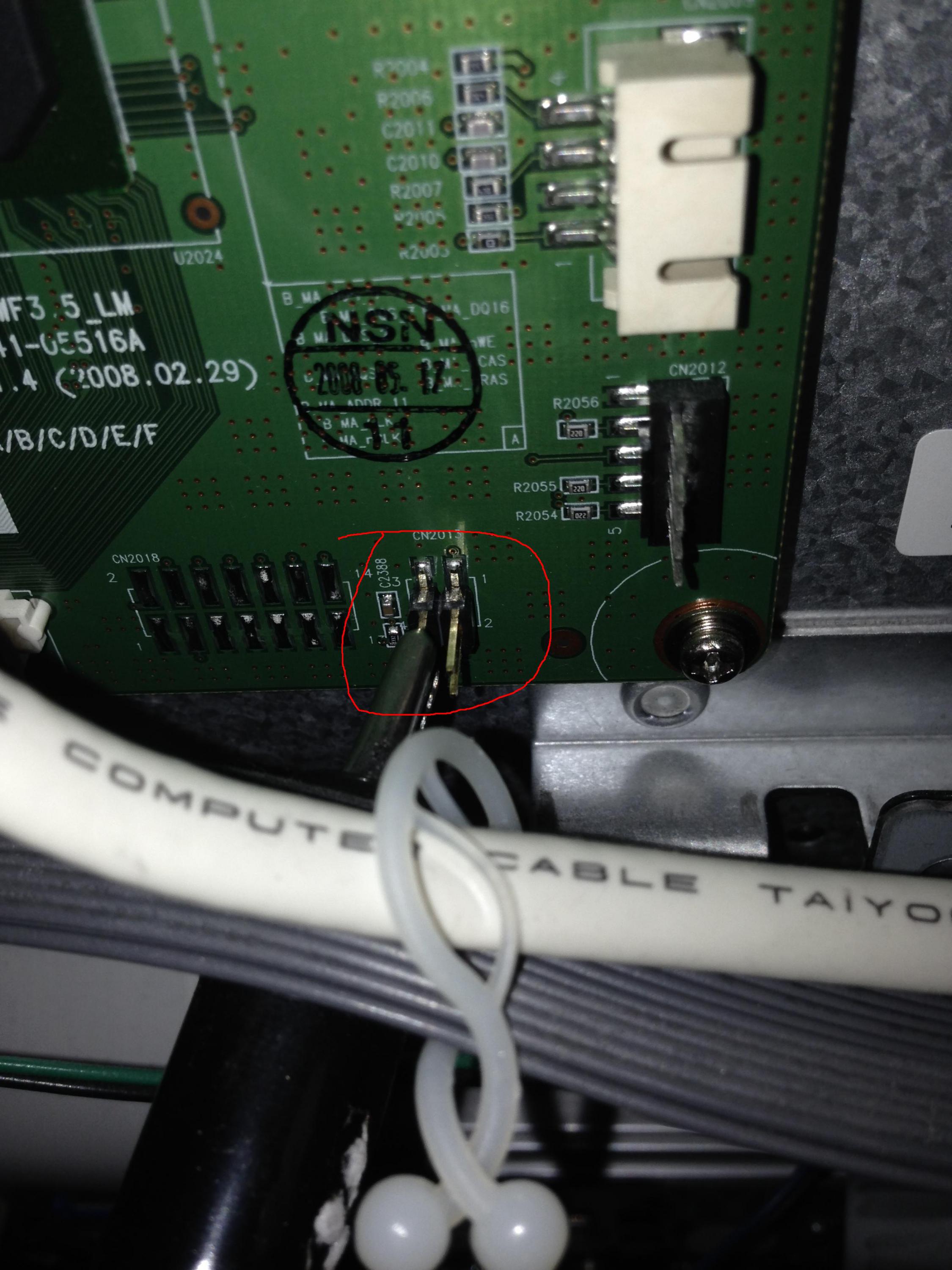

      I jumped the #3 and 4 pins on the test point on the Logic Board.

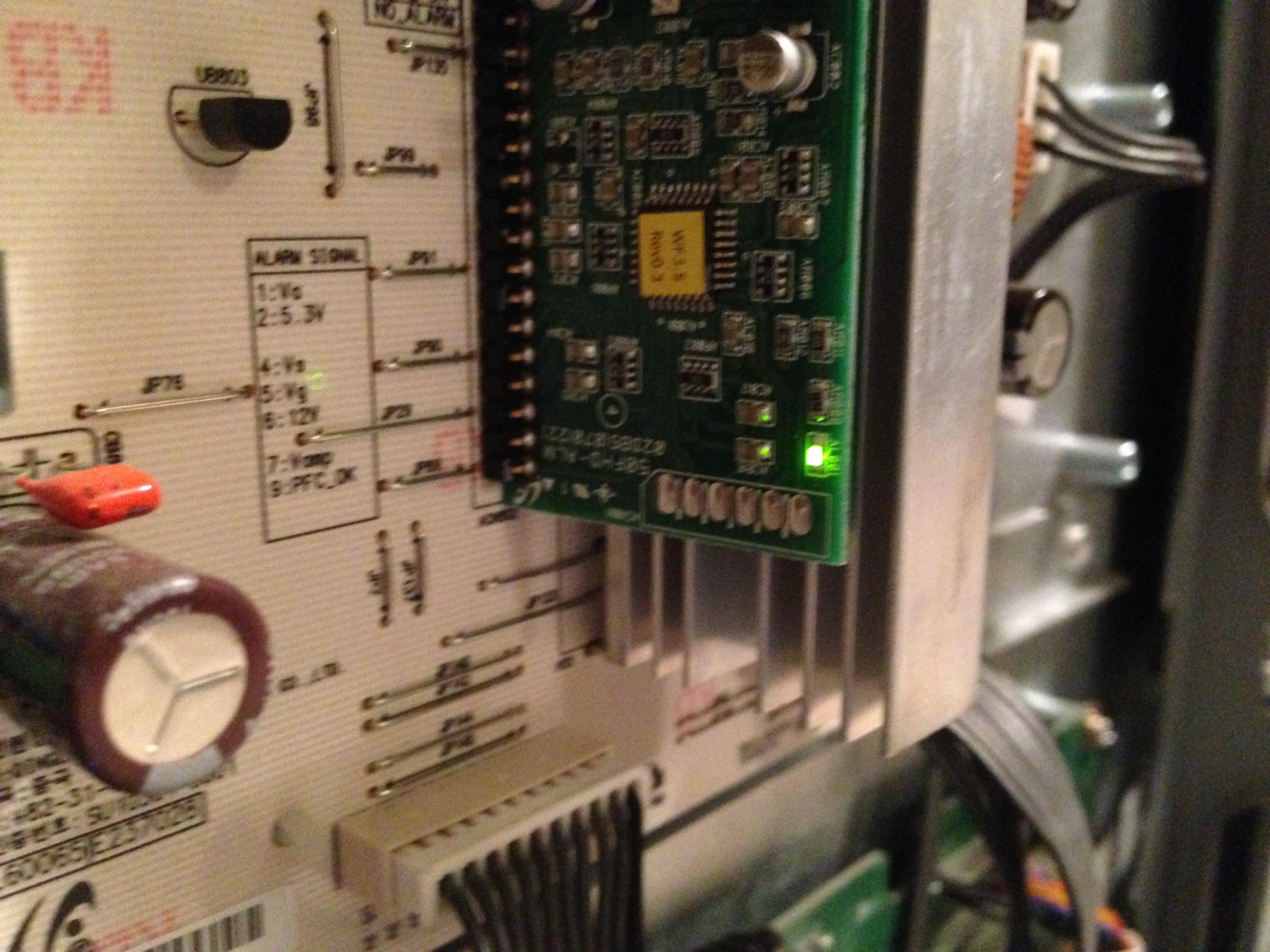

      Plugged in the power cord. Green LED on Power Board lights up. No relay click, no stand-by light. Press On...use remote On...nothing. No test pattern, no relay click on power supply...
      Undo all jumps and plug in Main Board. Connect power and back to relay clicking, Green LED on, stand-by light on for about 10 seconds ( several attempts by the relay to "catch" if you will), then stand-by light out, relay stops clicking and green LED on power Board blinking in series of 7.

        Do you have a digital multimeter? With those jumpers in place, check the Vs and Va test points on the power supply.

          I got zero

            I have double and triple checked my connections. With jumpers in place and Main board unplugged there is no voltage on the Vs or Va test points. There is no voltage at the 5.3 v connections to the main board. The relay on the power board does not click, there is no standby light. I have checked all the fuses and I have voltage at fuses on the Hot side of the power board. The single LED on the power board is lit.
            Plug the Main board back in and original symptoms return with blinking stand-by on front panel and LED on power board after relay stops clicking.

              With power board cable to main board unplugged at main, resistor jumps and test pin jump in place, the relay does not click when AC power is attached. The stand-by light does not come on. The LED on power board comes on steady.
              There is NO voltage at Va or Vs test points, nor is there 5.3 volts at the cable where the resistor jumps are installed.
              Screen is blank.
              Remove jumps, plug in main board and apply AC power and symptoms return. Relay clicks for a bit and stops. Stand-by light comes on blinking and LED on power board is blinking.
              I'm thinking Power Supply, but maybe Main is bad...or both? Or Logic board?

                      OK when the relay clicks with the main board attached does the Vs/Va come up?
                      What value resistors did you use?

                        No voltage measured.
                        None on the 5.3 pins on the plug to the logic board either.
                        270 ohm 1/2 watt.

                          OK, repeat the test, but this time with X- and Y-main disconnected, do Vs/Va rise?
                          It is looking like the power board is bad but I do not know why you get no relay clicks with the test jig.

                            Same results with X and Y Mains disconnected. No relay click with Main board unplugged and no voltage measured, relay clicks with Main connected and still no voltage.

                              OK, I would not have immediately considered this but it does seem like your power board is bad. Check any visible fuses on it, including ones away from the mains power input.
