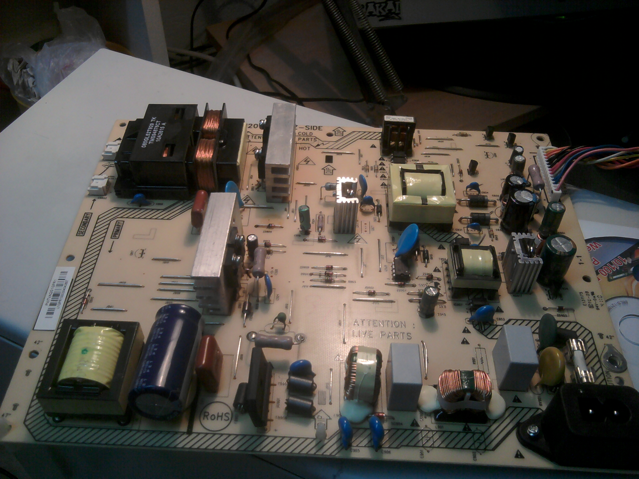

    when i turn it on led are not blinking and i can see the backghlight turn on and i can hear sound but i got no picture.also i can hear the reley switching in power suply
    i open it and there is no visible damage on power supply (bad capacitors) and no damage on SSB.

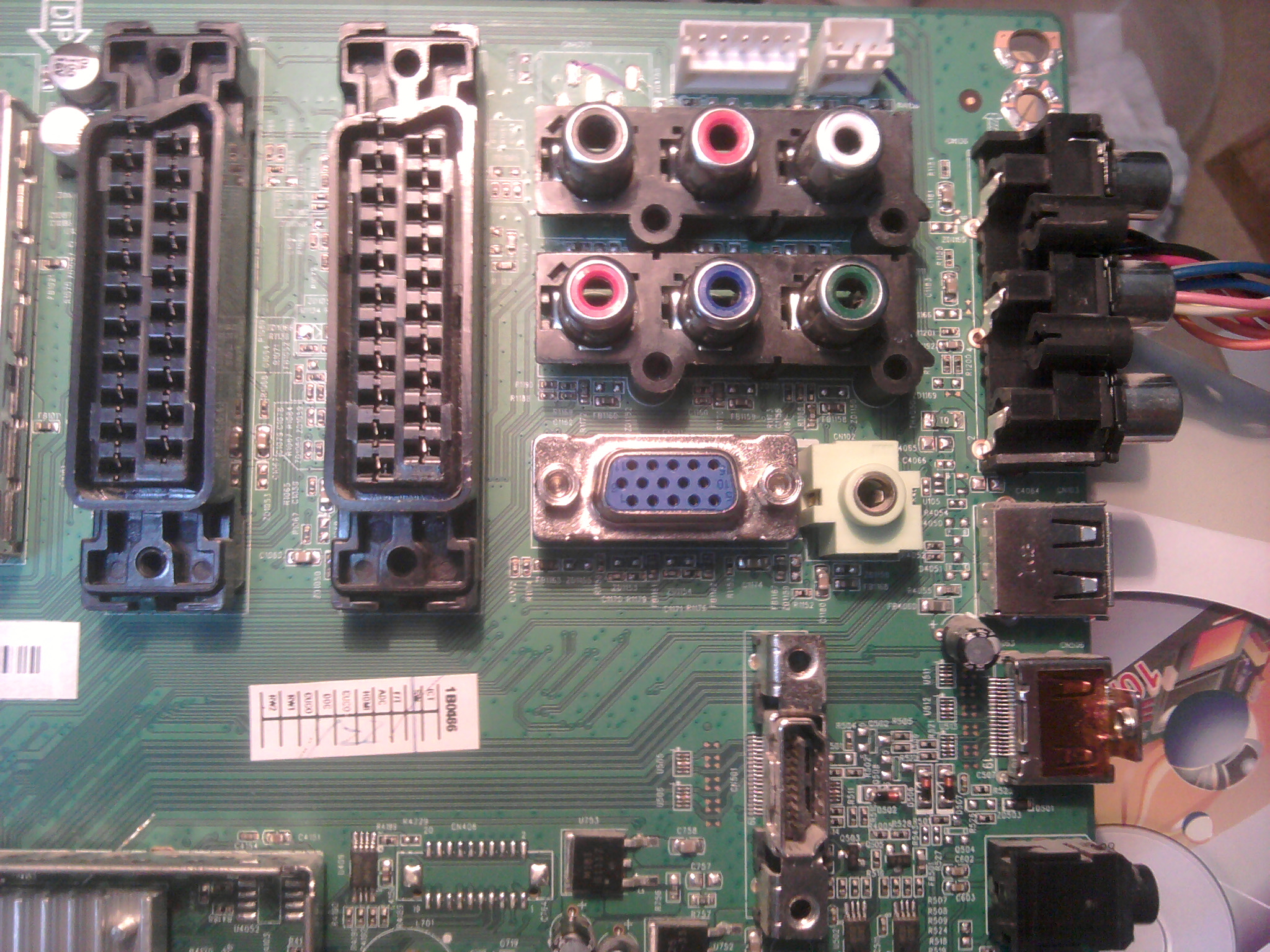

                Re: philips tv 3000 model 42pfl3605h/12
                up

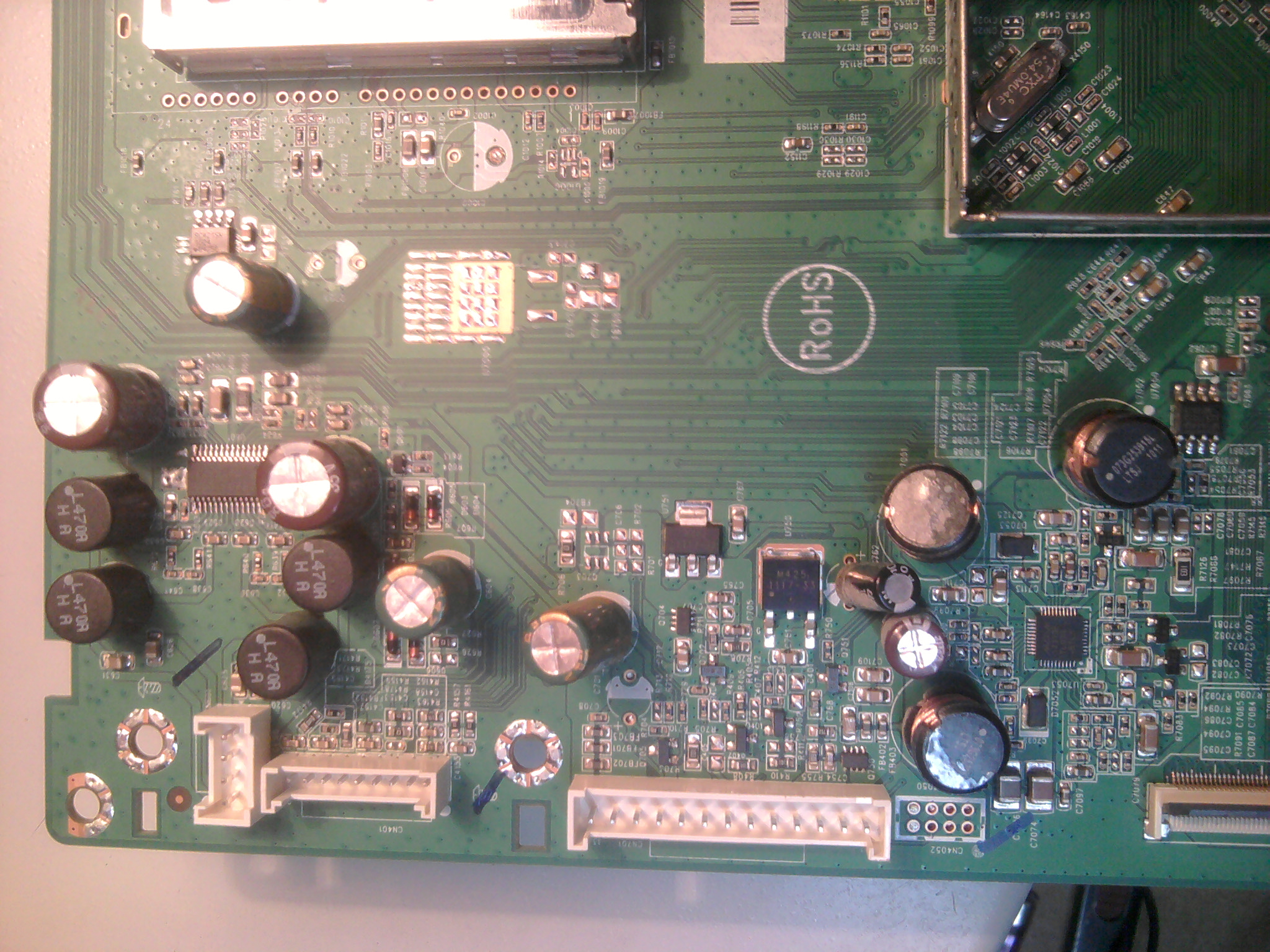

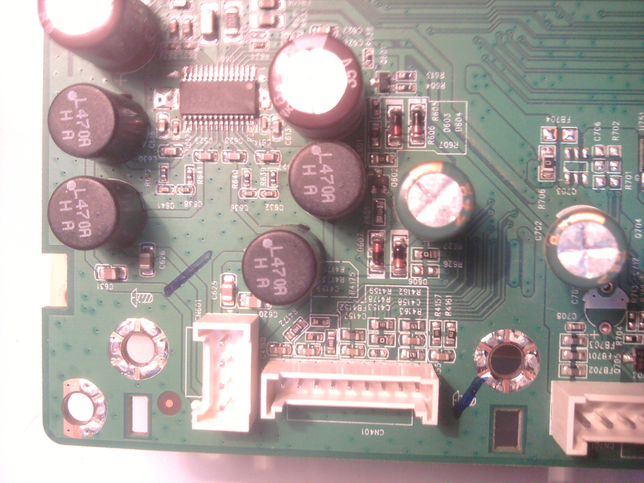

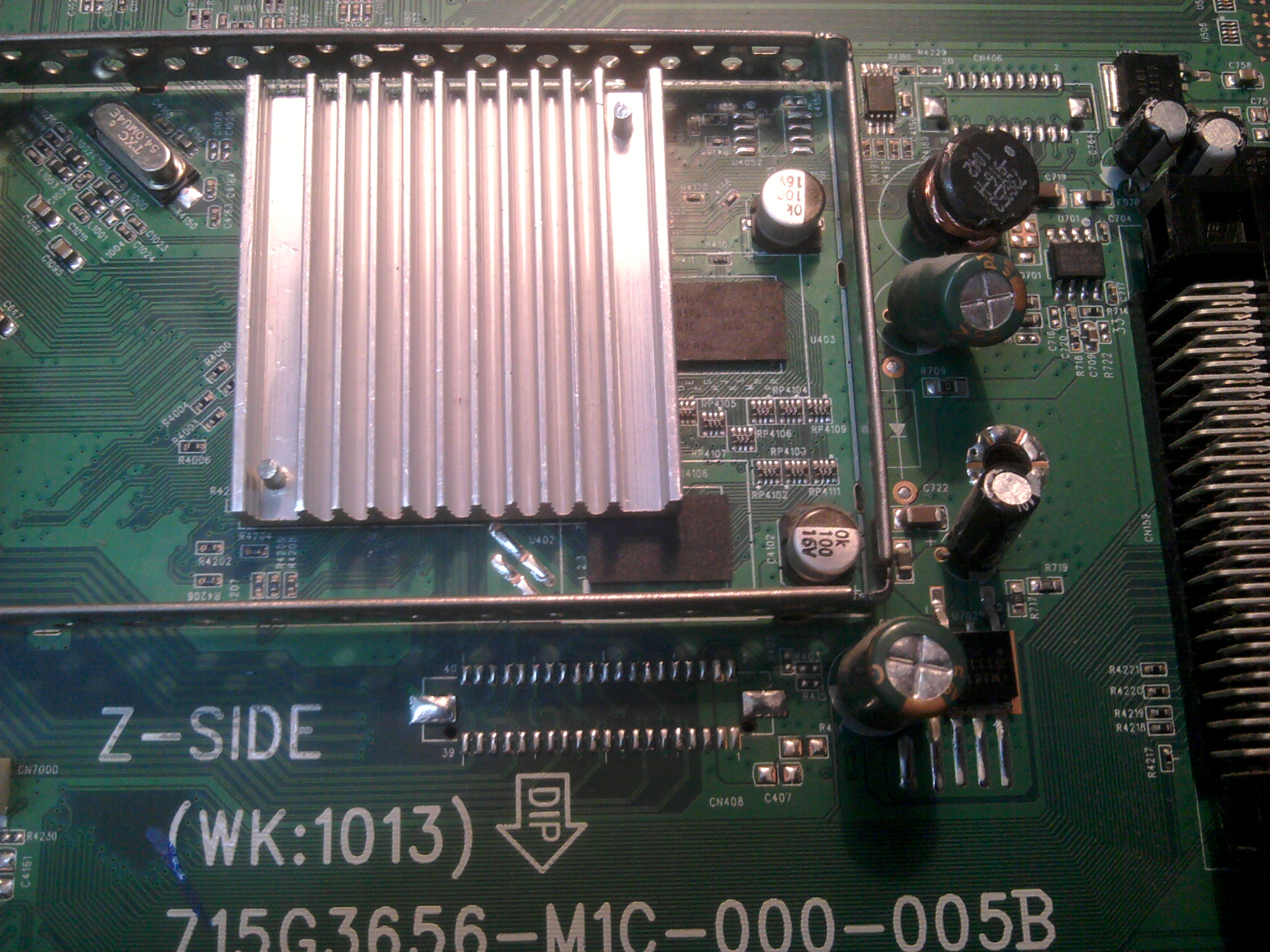

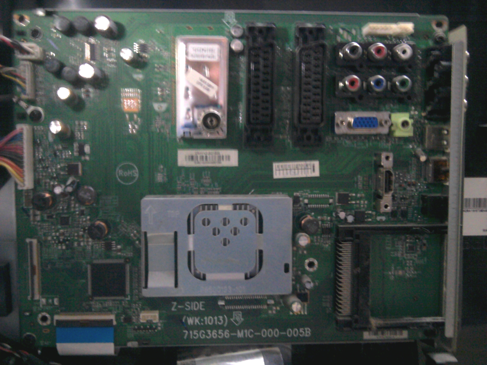

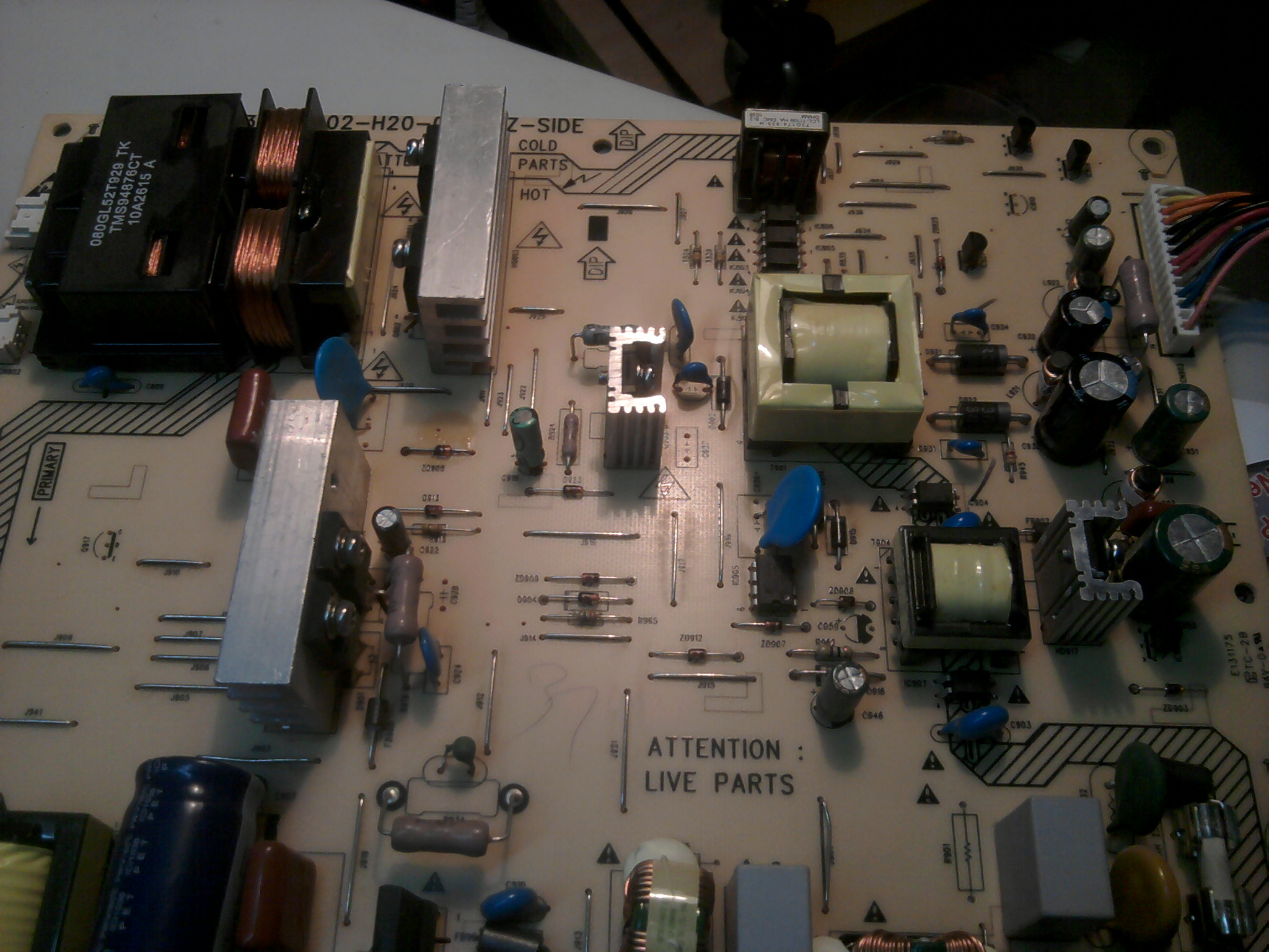

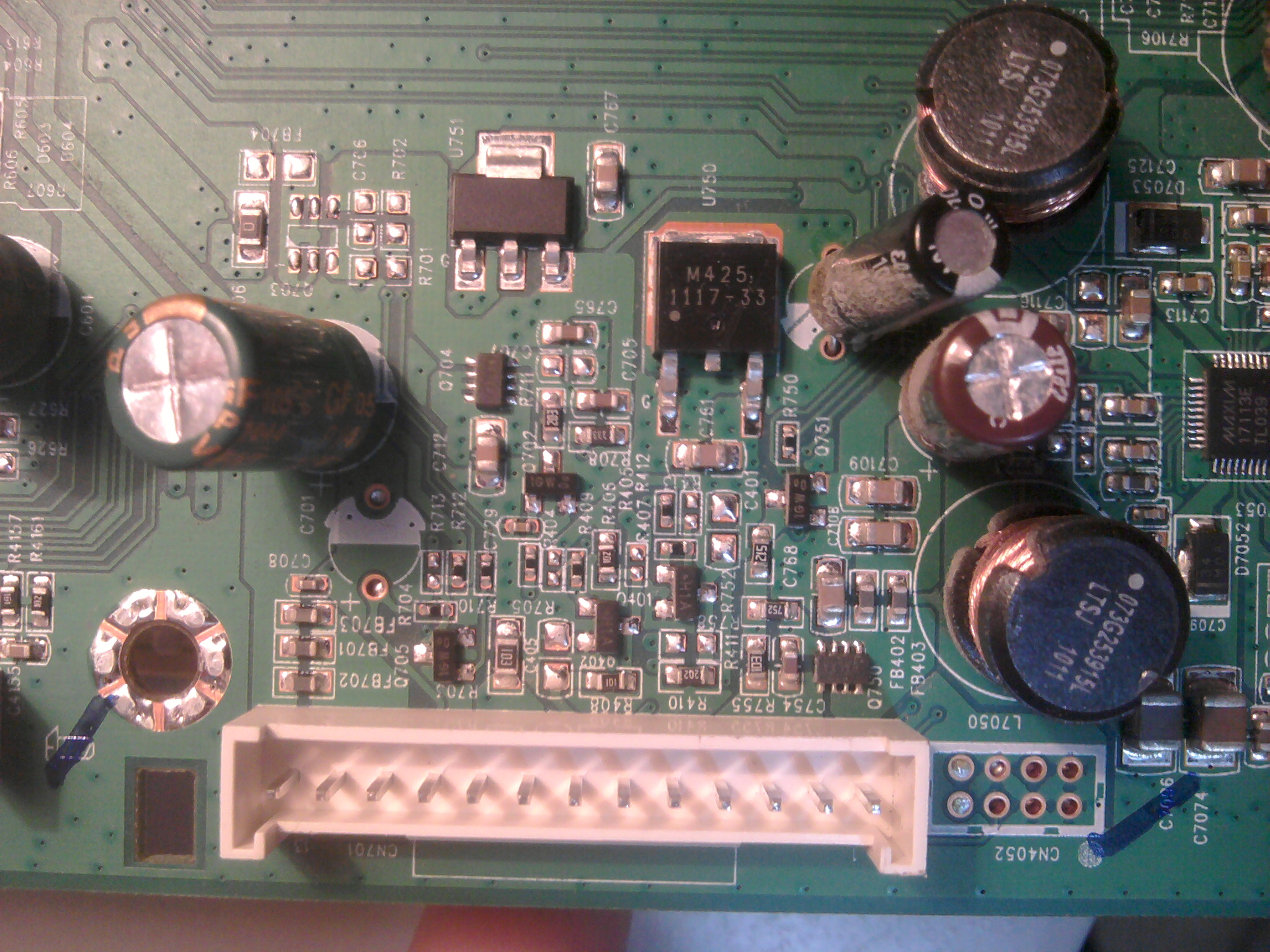

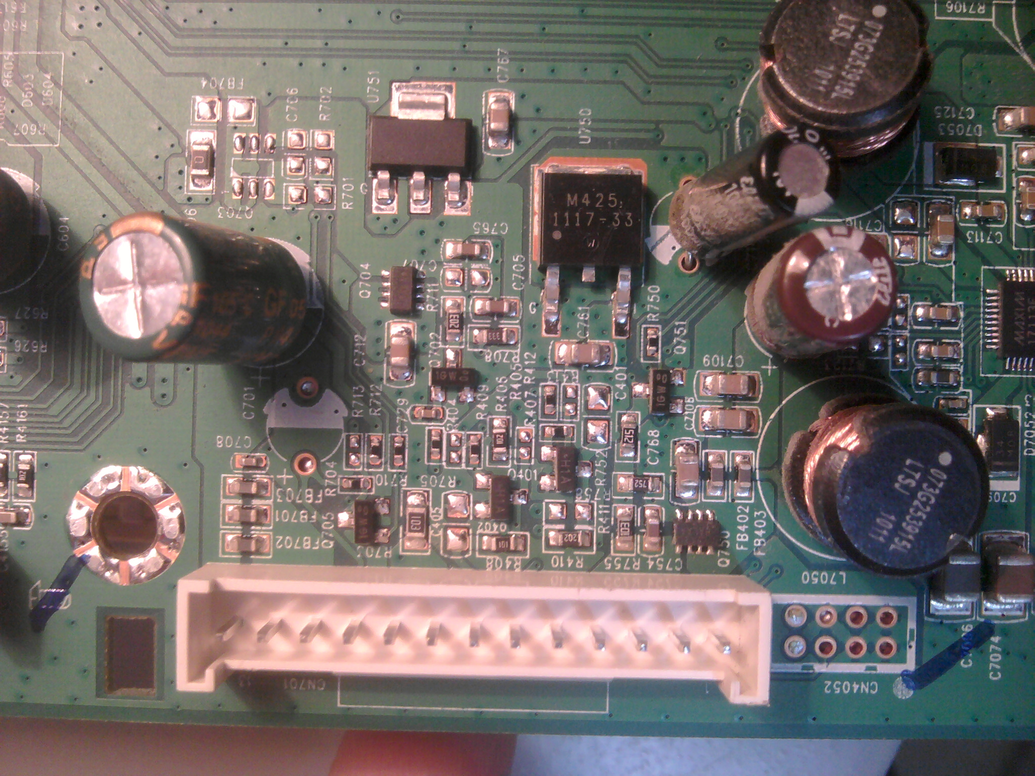

                here are new pictures of ssb
                i also turn on tv and checked voltages going from PSU to SSb and they are ok
                so we are looking for some fuse or some idea or is my screen dead for real

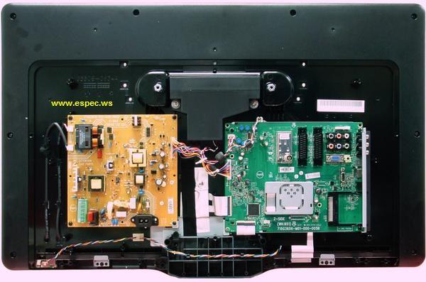

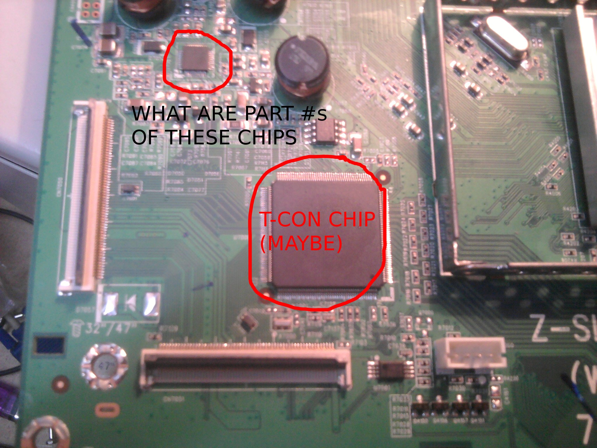

                  Can you provide one large image of the layout of the circuit boards in this set? I am trying to see if this set has a T-con board.
                  • nickovic111
                    • Sep 2013
                    • 15
                    • croatia
                    these two boards are only boards on tv set i believe because the flat cables are going straight underneath the tv to connect screen i belive
                    isnt t-con underneath this aluminium cooler ( i removed the protecting top)
                    i found this image on web
                    it is exactly like mine tv
                    on this link http://monitor.espec.ws/section31/topic200017.html
                    if you check this link my tv is what Borek posted
                    i translate it just now in English so i can start reading because "Borek "wrote some links about fault threads in that forum about my tv...

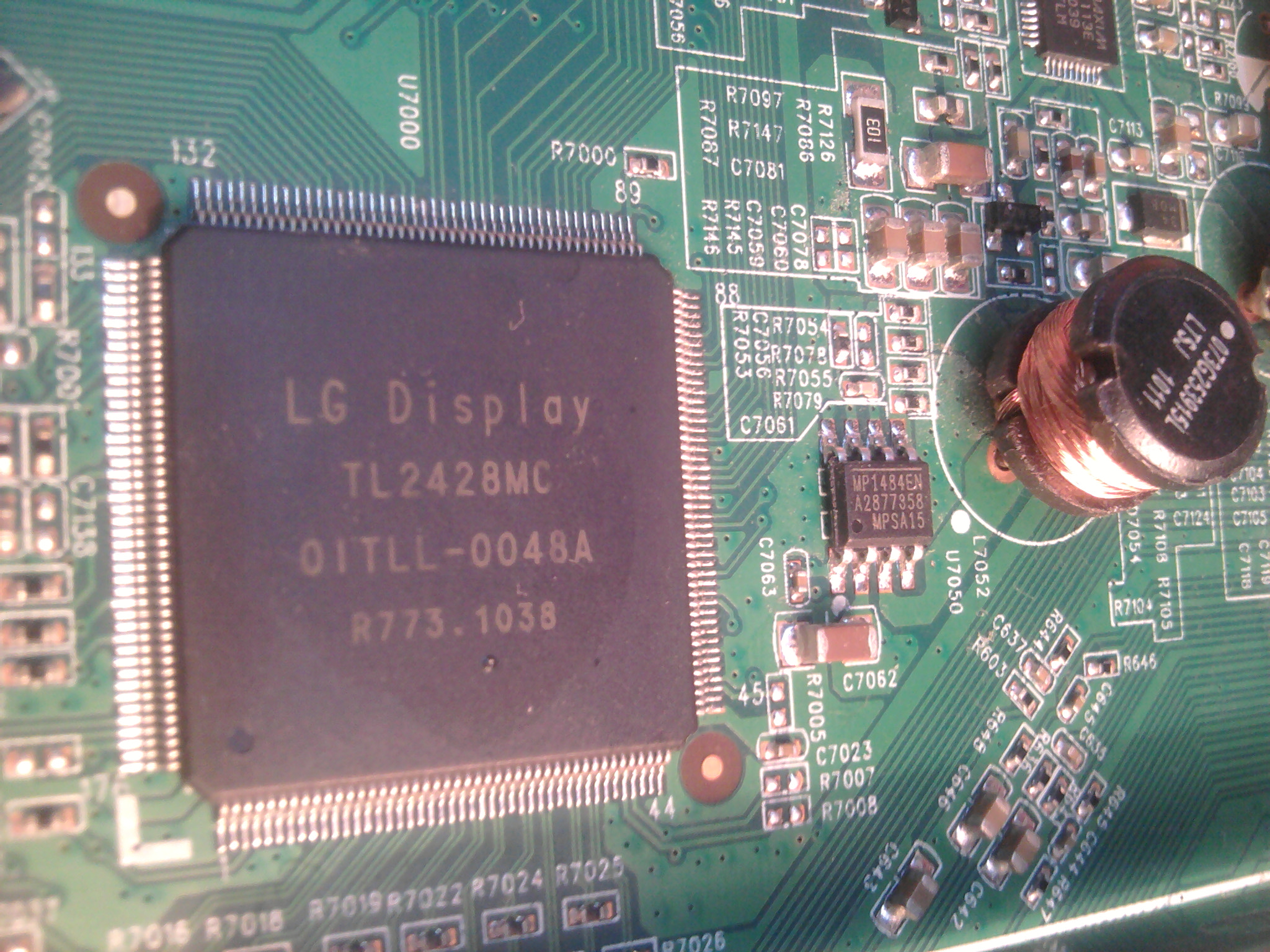

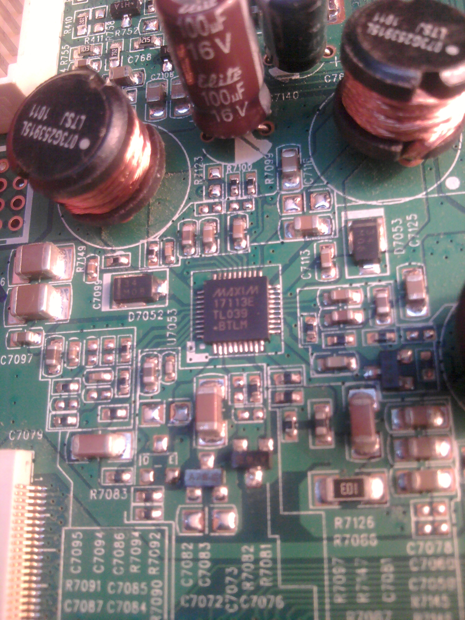

                      The T-con controller IC is probably the large multi pin chip near the ribbon cables.
                      The processor under the heatsink is the main video processor/scaler.
                      See image - please give me the part #s of the two highlighted chips.

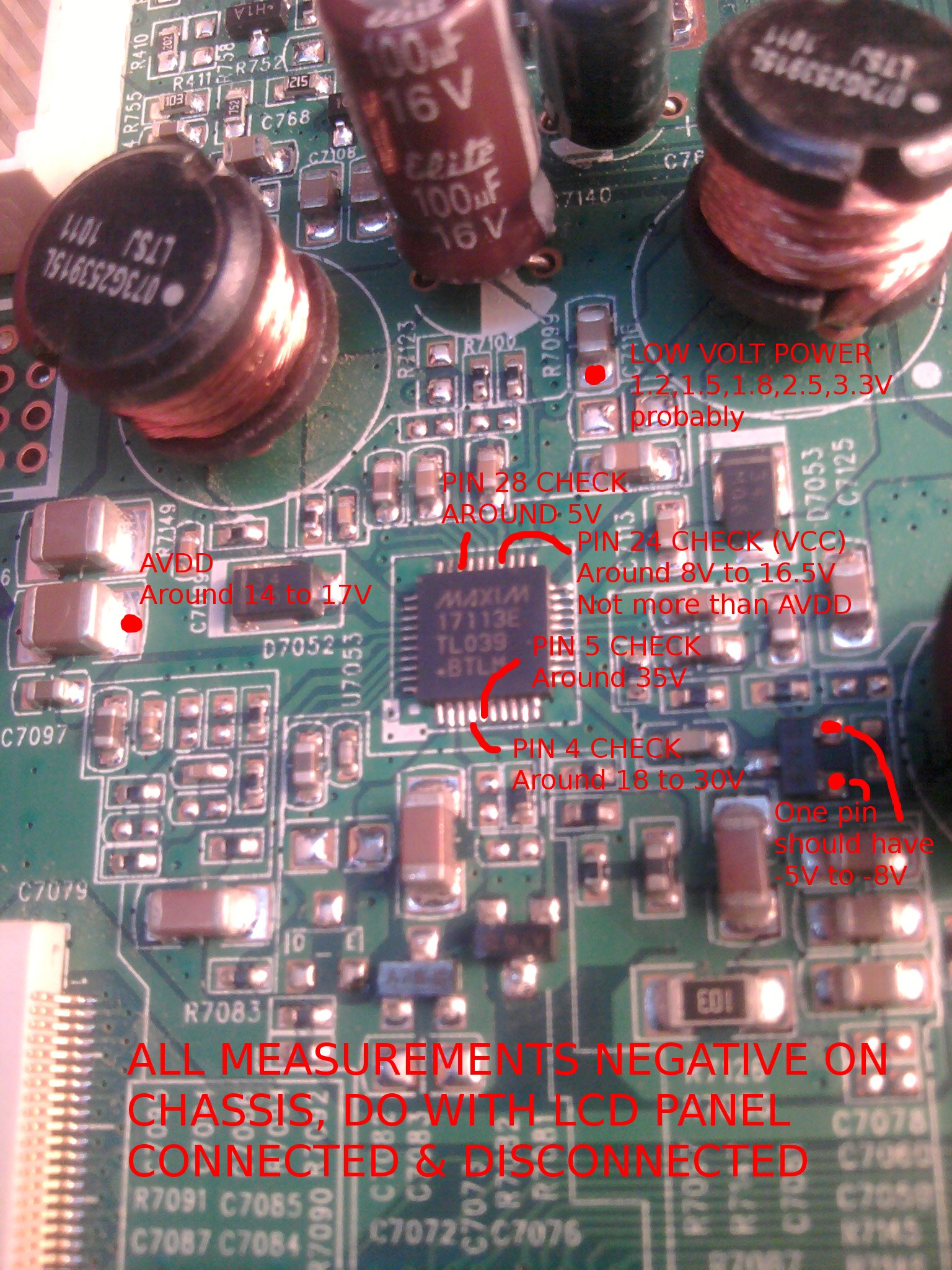

                          here are pictures of those 2 chips
                          sorry for being late
                          bump
                            OK first IC is custom LG Display T-CON controller.
                            Second IC is the voltage generator. Let's look at that first, because a datasheet is available.
                            https://cdn.badcaps-static.com/pdfs/...f8b27c5dc1.pdf
                            See picture for checks.
                            Be VERY careful not to let the probe slip... if in doubt solder a wire to the appropriate pin and measure off that.
