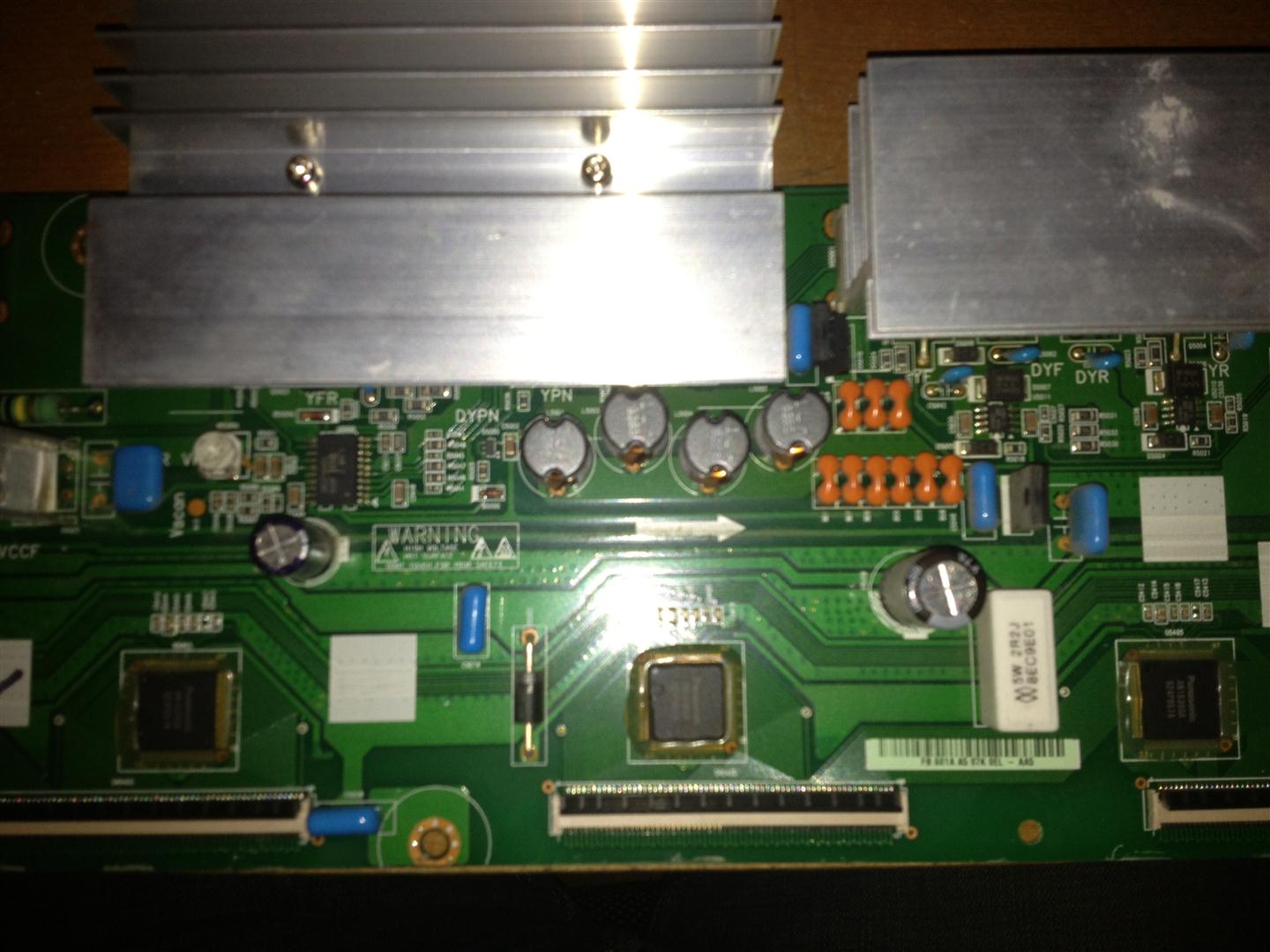

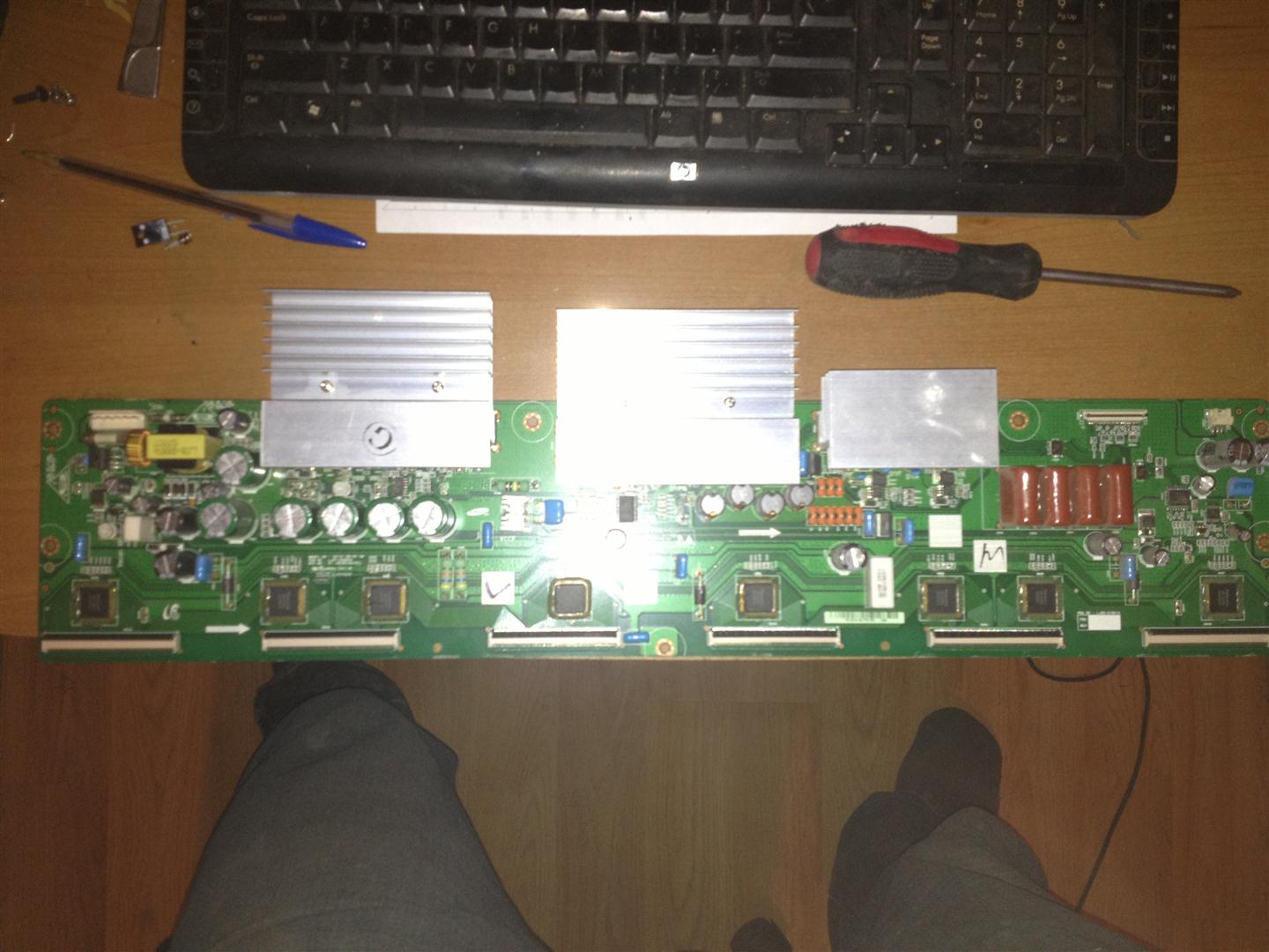

    Hello again....
    Waiting for parts for my other projects,so figured I would start on this one.
    When turning on it just clicks and you can hear the power supply "grunt" and click till it gives up completely..
    Disconnected the Y-board and TV turns on normally(no pic of course).
    Y-board is a BN96-09738A. I measured the pins from plug CN5002 and there is a full short between pin:gnd and pins:Vs.
    A search explains me that it's very common for these boards to fail,yet I can not find a schematic for it,even looked in TOM66 list.
    Does anybody have a schematic for this board? Or even a "AH,ya I fixed a board like that,it was so and so"?

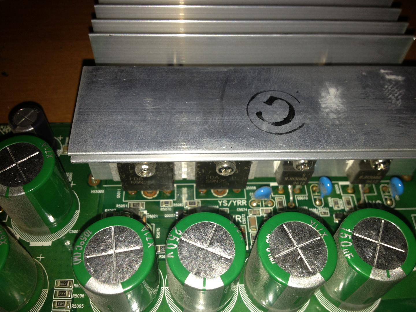

          Awesome,I was probing the fets on the first heat sink(see pic) as tracing the board revealed those are directly connected between ground and Vs(besides a bunch of caps). They both test shorted on all pins while in place. Picking up some more solder sucking wire as I ran out to test them out of circuit.
          Tom66,how did you find that thread? I searched this forum for a long time,didn't find anything (wanted to prevent to start a new thread on a already solved problem)...

              So,got the fets FDA59N25 out and sure enough one was shorted.
              I decided to replace both of them,just to be sure.

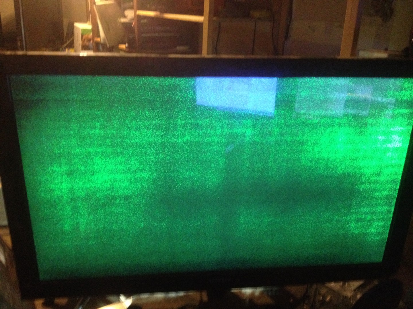

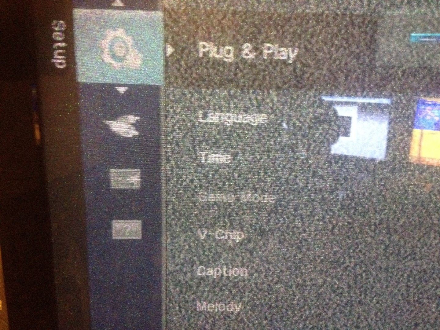

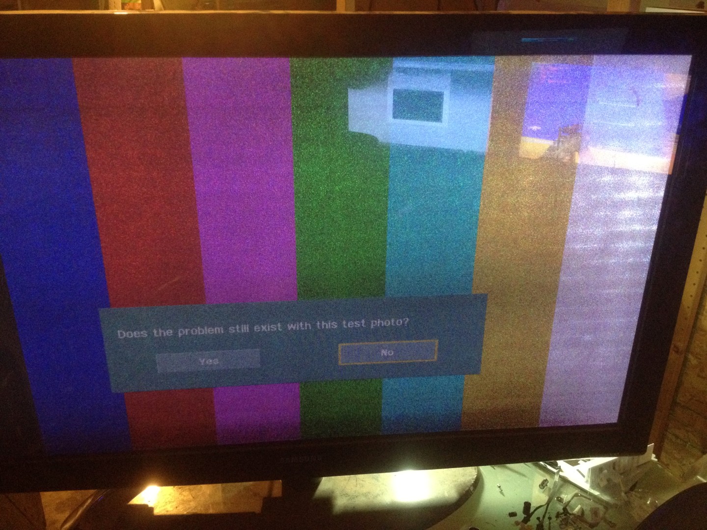

              Now the TV does turn on and I can get the menu up etc BUT the picture looks like this(see pic)....
              Does this look Y-board related to you guy's?
              Proud owner of dozens of broken TV's and many,many,many boards.
              Our website and passion:http://hollenhundshepherds.com/
                Re: Samsung PN50B430P2D
                Try the test pattern mode on control board
                https://www.badcaps.net/forum/showpo...61&postcount=2
                It looks like either the Yfr pulse is stunted or the X-main is bad too. I think it's more likely to be a Yfr pulse issue than anything else because that part could have been damaged when one of those FETs failed.

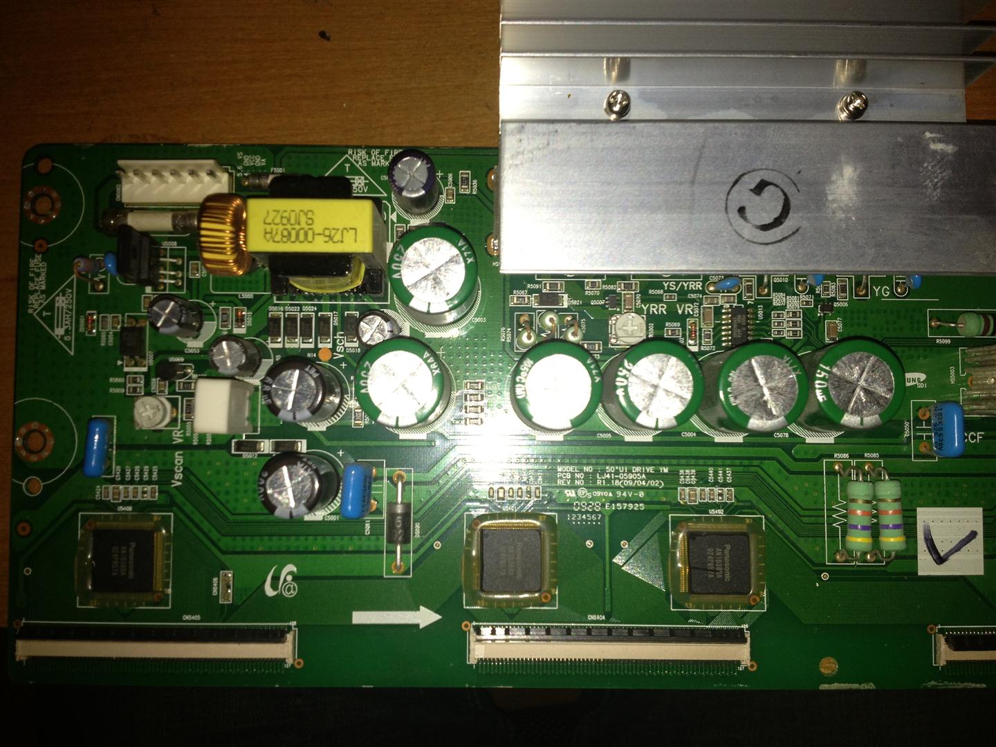

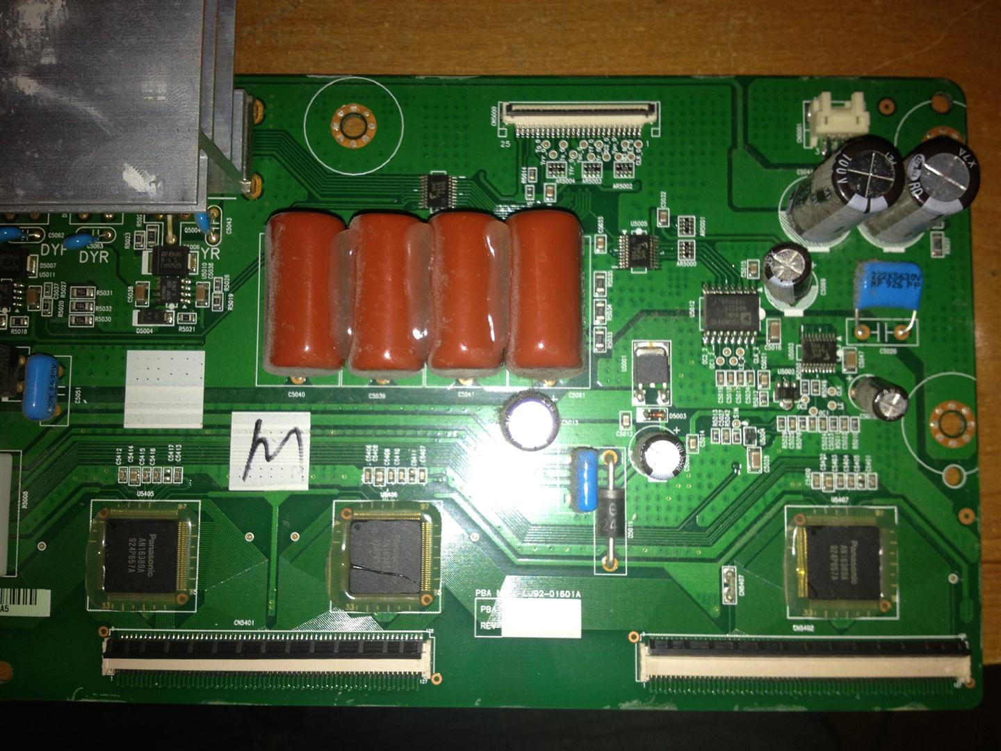

                    so,found 2 more transitors that are shorted out....
                    They are fun ones:RJH3044 9612.
                    On the hunt for those through "my parts guy" as they seem to be a stand alone kinda transistor and can't be substituted for something of the shelve,ugh...
                    Also double checking the 2 fets I replaced,at first glance it looked like they where soldered only on the bottom side of the board,but now it looks to me,that some pins are soldered through the board to the component side,even though it barely showed solder on the top side...schematic of the board would have been super handy now as the replacing of the fets turned a bit into a butcher job(had trouble getting them off the board)..

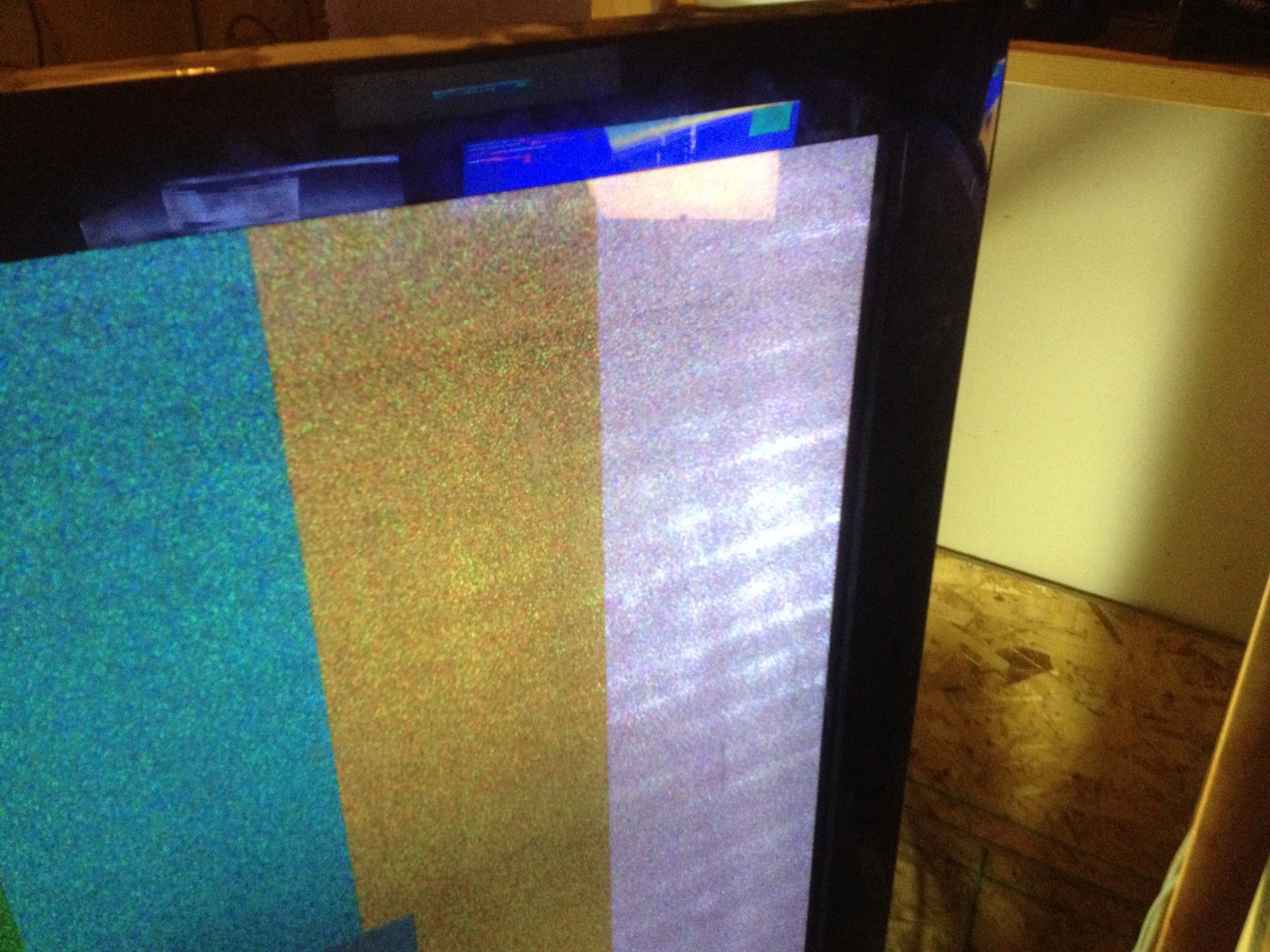

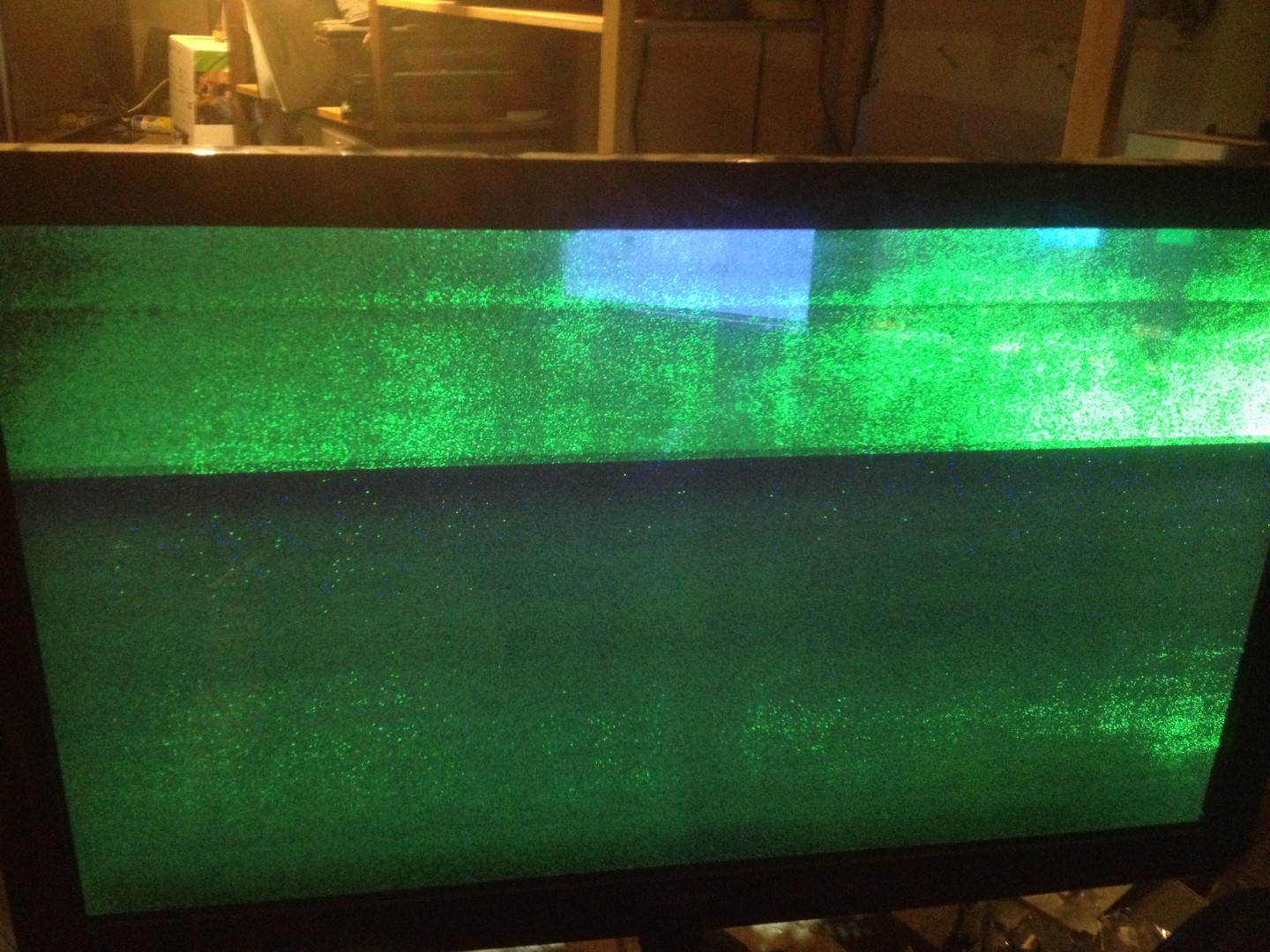

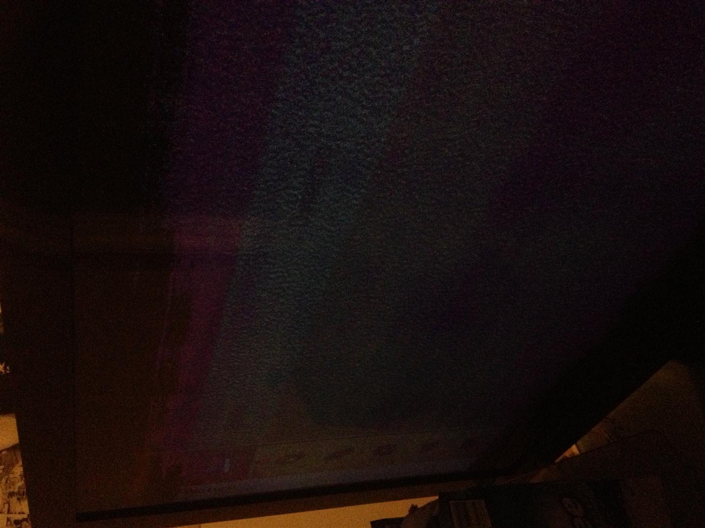

                      found this tv back under the workbench,figured I would start a 2nd attempt to repair this one.
                      Took some more pictures hoping you guys have some input.
                      Last two pics are while in test pattern,the light spots do seem to move when a scrolling pattern is on.
                        I have the same issue with the same model #. Just wanted to post my results. When I got it, it would not stay on. I found a shorted x-main board which I repaired with a Shopjimmy kit. The tv then turned on, but had the image like you posted. Looks like maldischarge. So frustrated, I started freeze spray on different parts of boards. I hit the main chip on the logic/digital board and picture was perfect. Lasted a couple minutes and then returned to original display. I bought a new digital board all proud of myself that I found the problem. Didn't fix it. Identical to the original. I don't return boards for a refund cause I think its the cost of learning. I checked for cold solder joints on the y and x boards and nothing. So I ordered an X-main thinking that was the original problem, so waiting for the board and will report when installed. You guys are way over my head when Tom66 talked about Yfr pulse or something and of course I don't have a scope or if I did, probably would not know how to use it.!!

                                  Nope,while playing with it I could see pretty bad burn in of the screen and decided to pull the plug and part it out.
