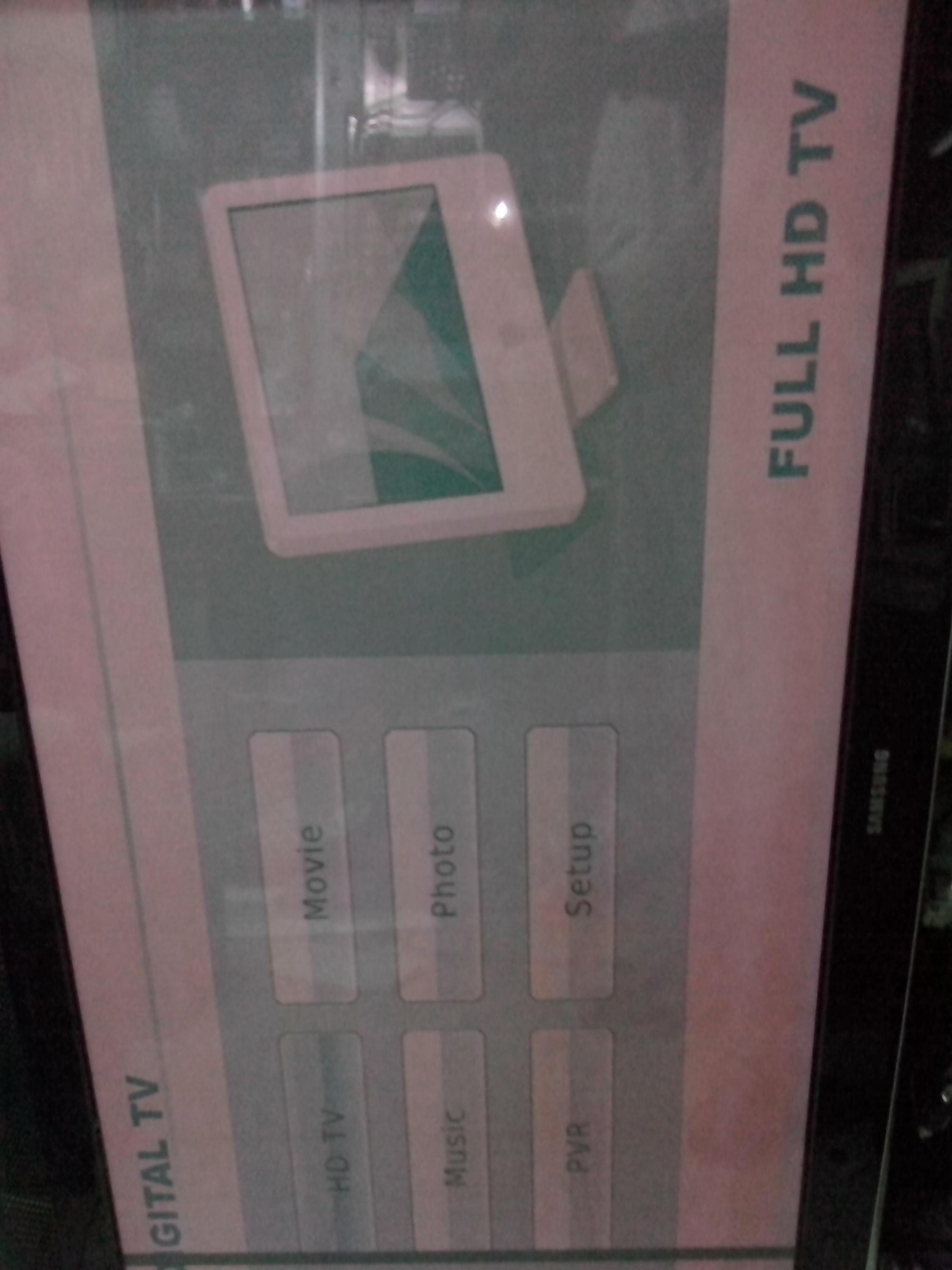

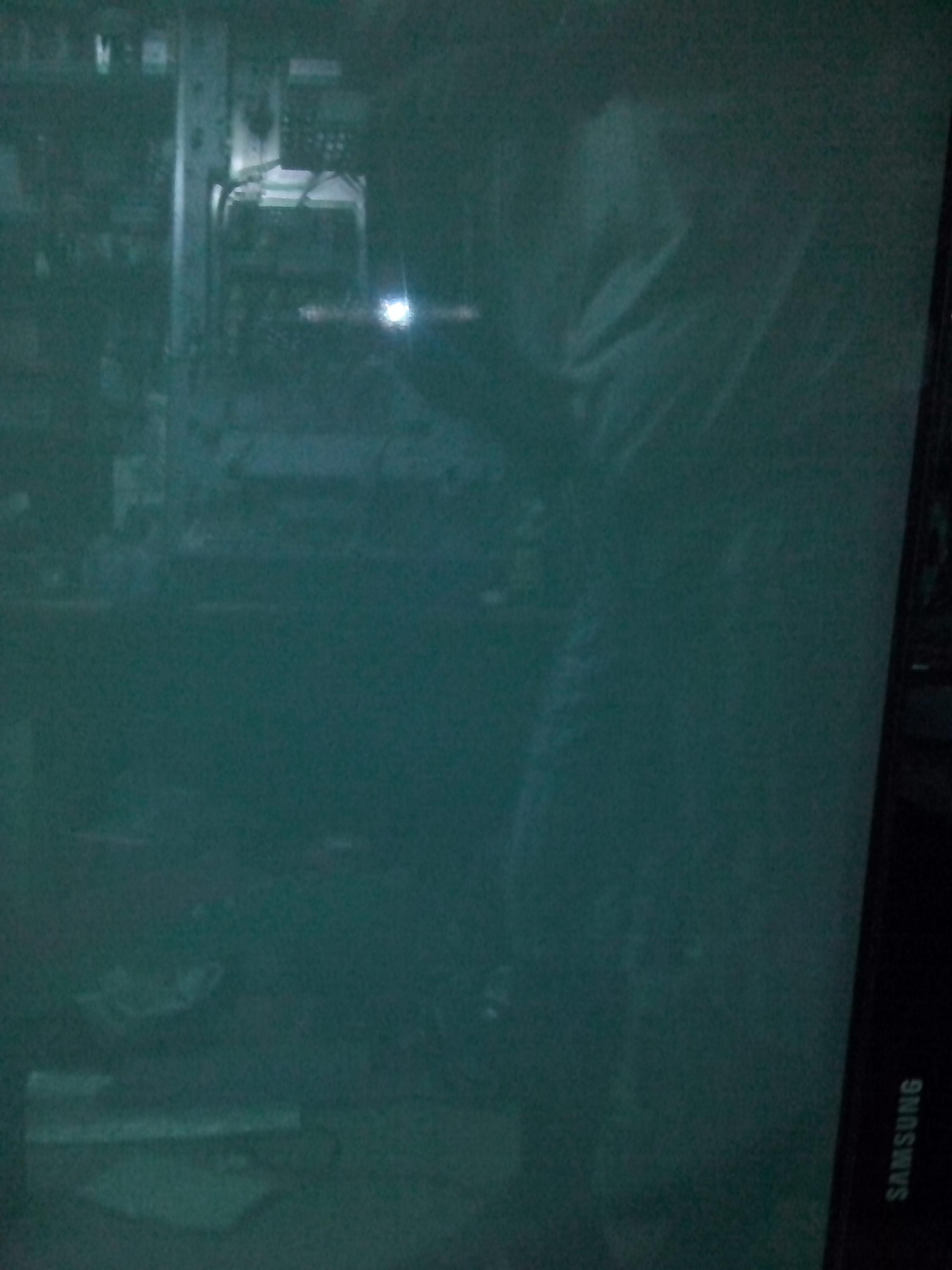

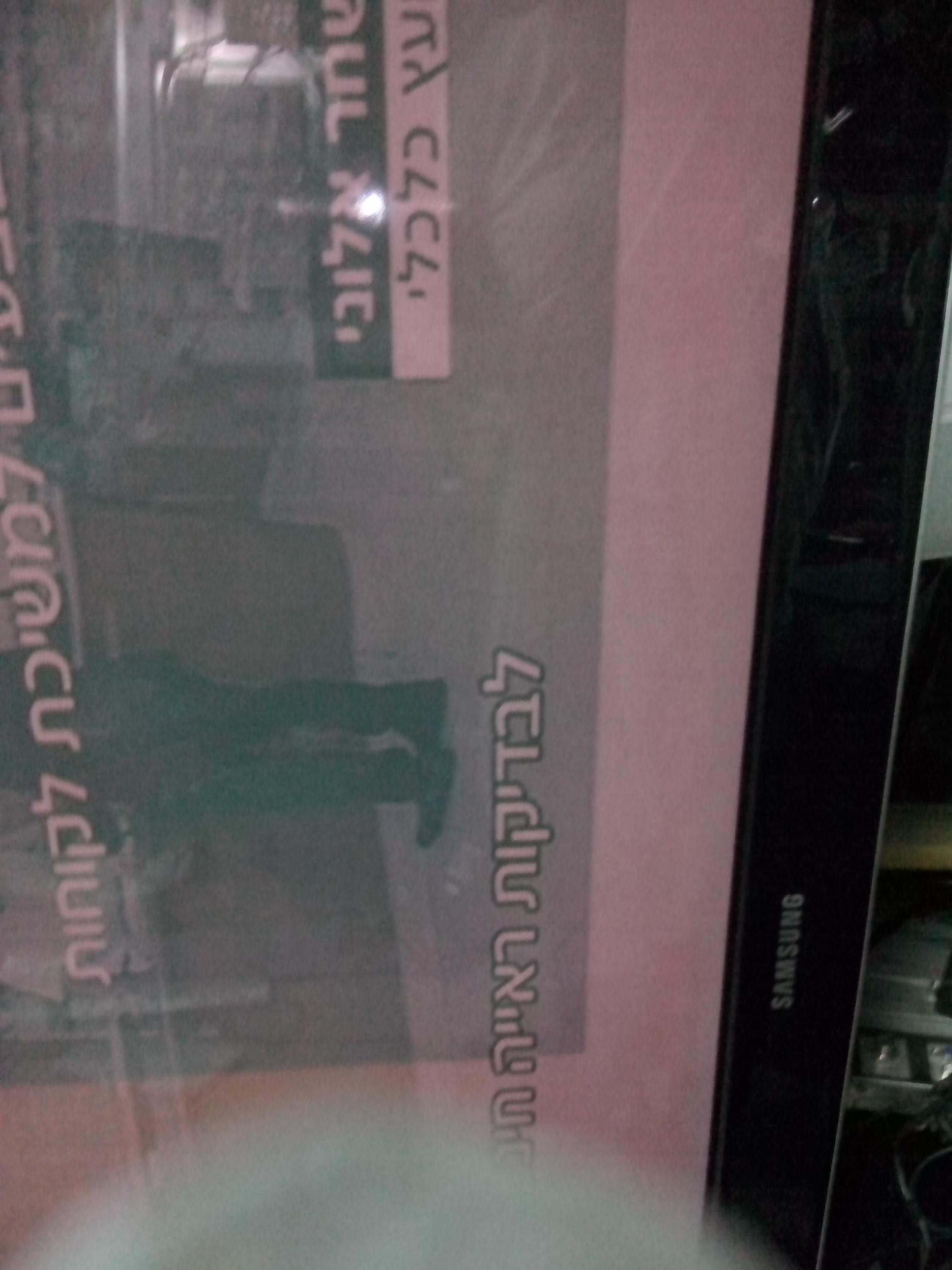

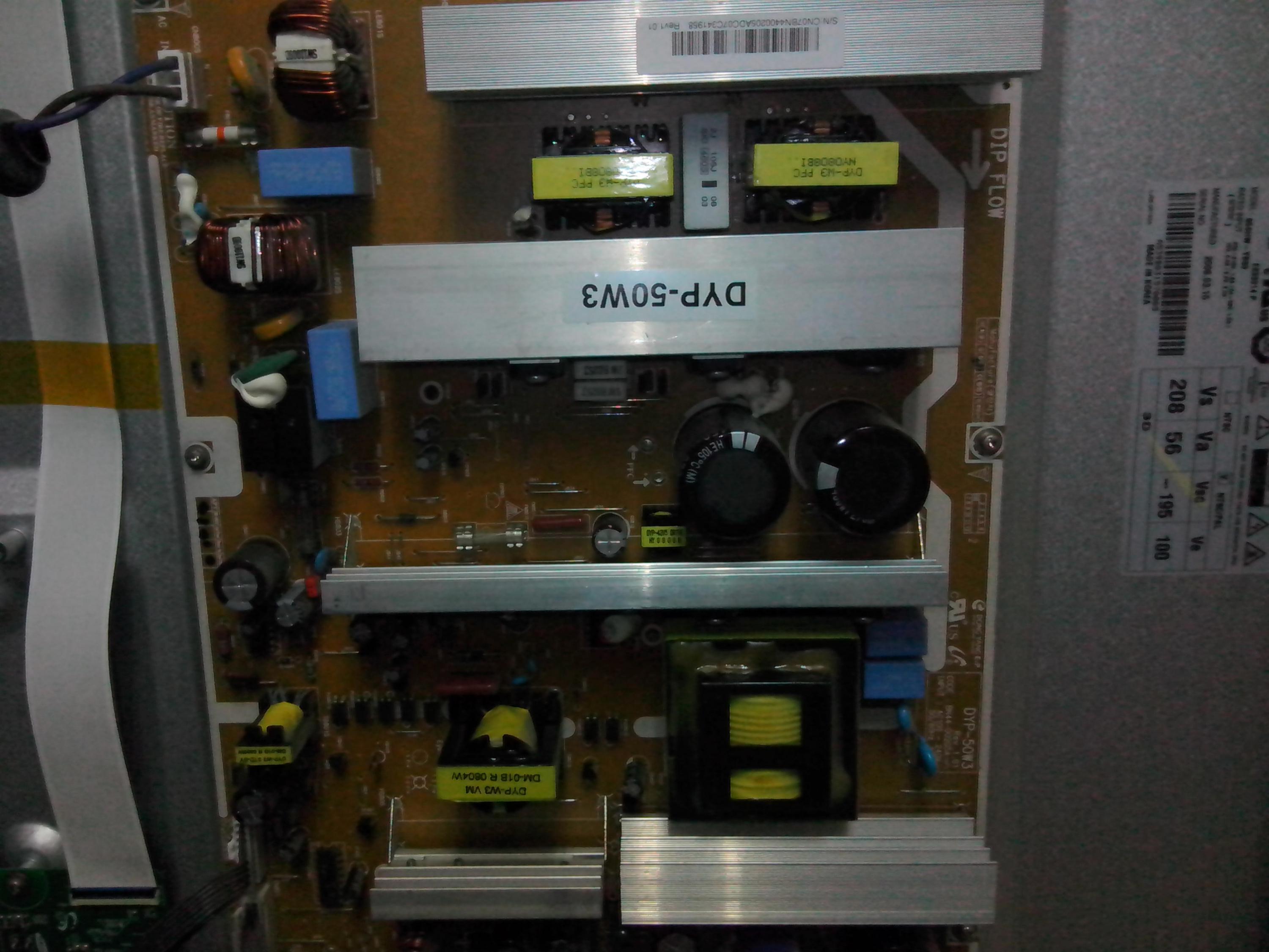

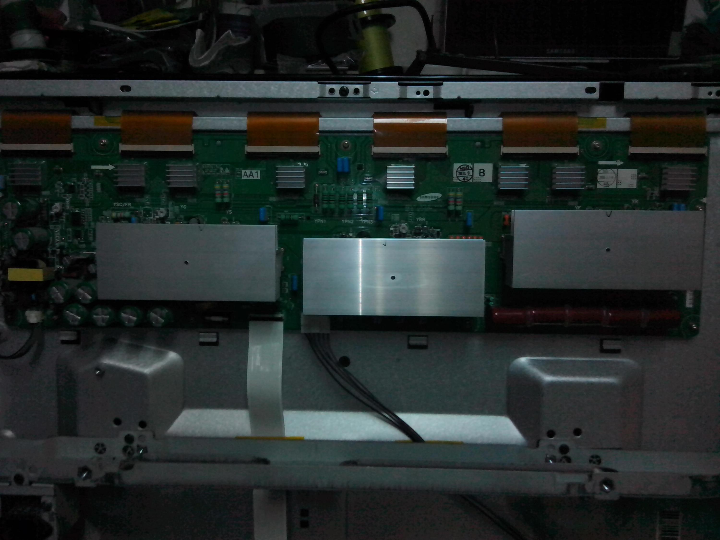

    samsung 50'' with very low contast and bad picture,test output of power s.-it's look o.k to me.the VS&VA are good Vsc= -195v at y sus. Ve= 100v at z sus
    pls ,any idea or where to start?

    Can you supply a picture of the problem? It is most likely an X-main fault.

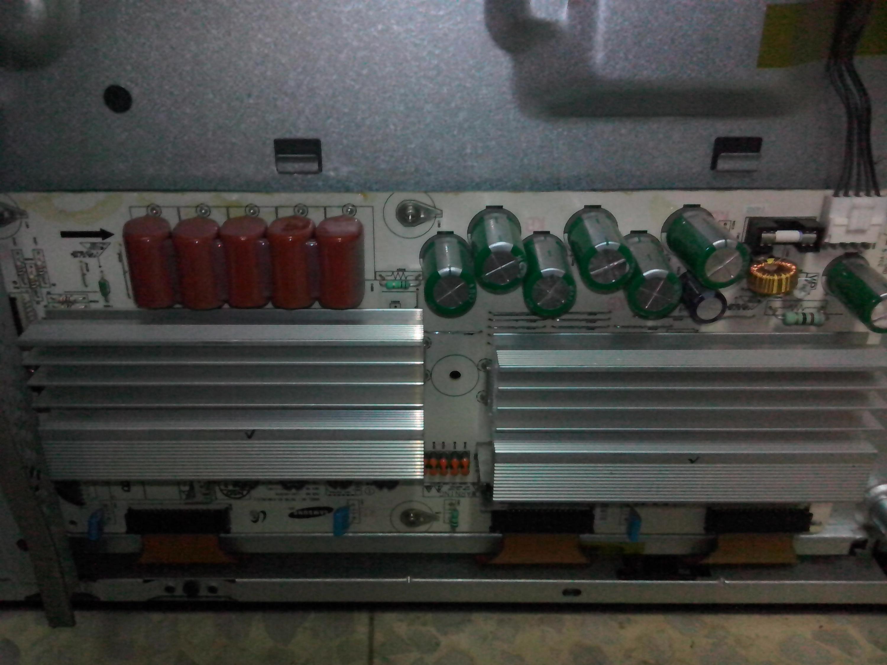

        Definitely an X-main problem. The X-main board is this one
        https://www.badcaps.net/forum/attach...8&d=1380561602
        You can try testing the voltage across those five red capacitors - top left of the photo, five in a row. Voltage across any one (they are all in parallel, you only need to test one.) Should be in range of 50 to 150V. This is the energy recovery voltage. If that voltage is missing or too high, check fuse on X-main.

          You were right this is indeed z board.
          it was missing 15v from the p.s
          thank you very much
