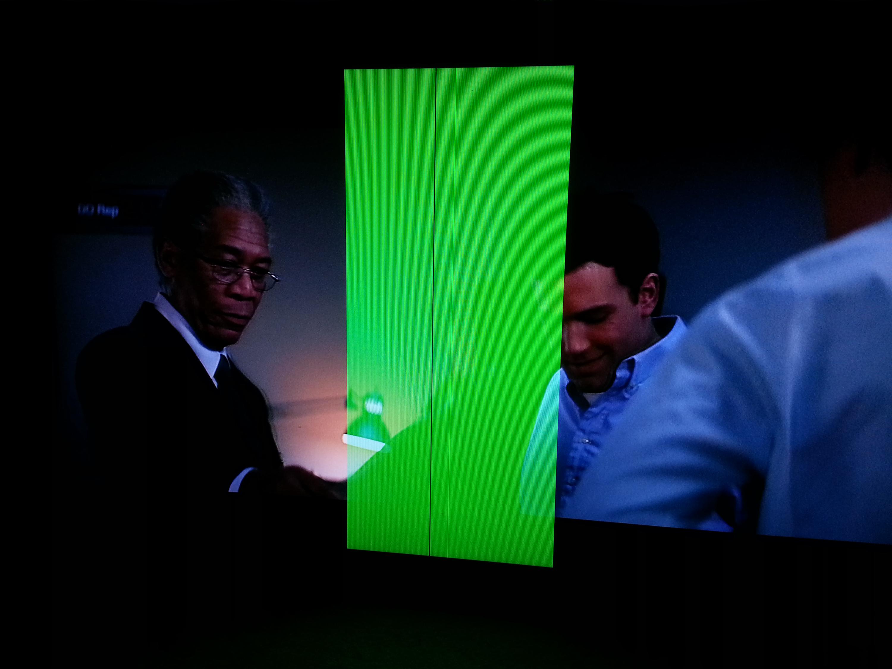

Samsung LN52a550p3f green vertical bars
  • DPark
    • May 2013
    • 26
    Hi, I was wondering if someone could tell me if this is a bad lcd panel or some other board (t-con?).
    I also have another similar 52" Samsung that has a similar issue. However, on the other one, the bars are multicolored, take up the right third of the screen and are not transparent. Any thoughts? Thanks.
    Dan
  • freakaftr8
    • Oct 2012
    • 3743
    Re: Samsung LN52a550p3f green vertical bars
    this thing that worries me is a black stripe between the green bar. That usually represent a defective tab bond or defective Ic on the panel.
