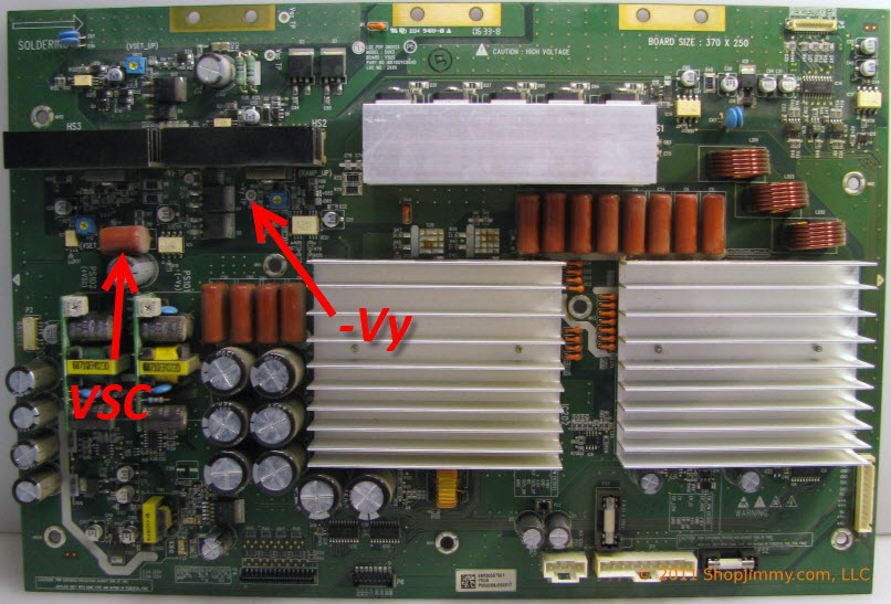

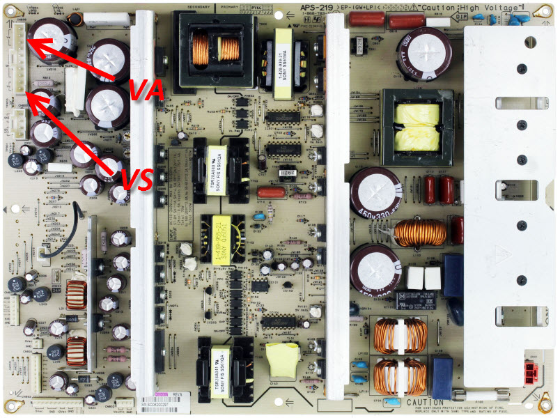

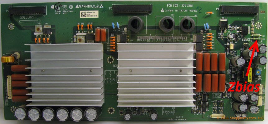

            A common failure in these TVs when they exhibit picture issues is the Y-Sustain or the Z-Sustain. However, the power supply (PSU) is also known to fail, and it sounds like that could be your issue here. Do you have a digital multimeter? If so, monitor these voltages when the picture goes blank:
            PSU: VS and VA voltages
            Y-Sus: VSC (I can't see on board in the pic, but it's most likely the capacitor I've marked) and -Vy (test point is labeled -Vy TP)
            Z-Sus: Zbias (aka Vzb)
            Where your voltage test points are a cap or resistor (example: VSC and Zbias), place your negative probe on one lead of the cap or resistor and place your positive probe on the other lead.

              Re: HP Plasma CPTOH-0603- Picture goes blank after a few minutes
              Here are my findings:
              VSworking: 197.7 VSblank: 87
              VAworking: 60.9 VAblank: 60.8
              VSCworking: 199 VSCblank: 199
              -VYworking: 25 -VYblank: 12.6
              VZBworking: 95 VZBblank: 78
              So once VS stops giving out 197V, the picture disappears on the TV.
                The -Vy doesn't appear to have been measured correctly - it's extremely low and not shown as negative. I can't remember if this TV will you allow you to do it and continue to run, but you might want to try disconnecting the Y-Sus and Z-Sus from the PSU to see if the VS stays up.
                    It does seem like the VS tract on the PSU has a failing component. However, the thing that makes me hesitant to declare that your PSU is bad is that you're able to unplug it for 10 secs then plug it back in and have the picture return.
