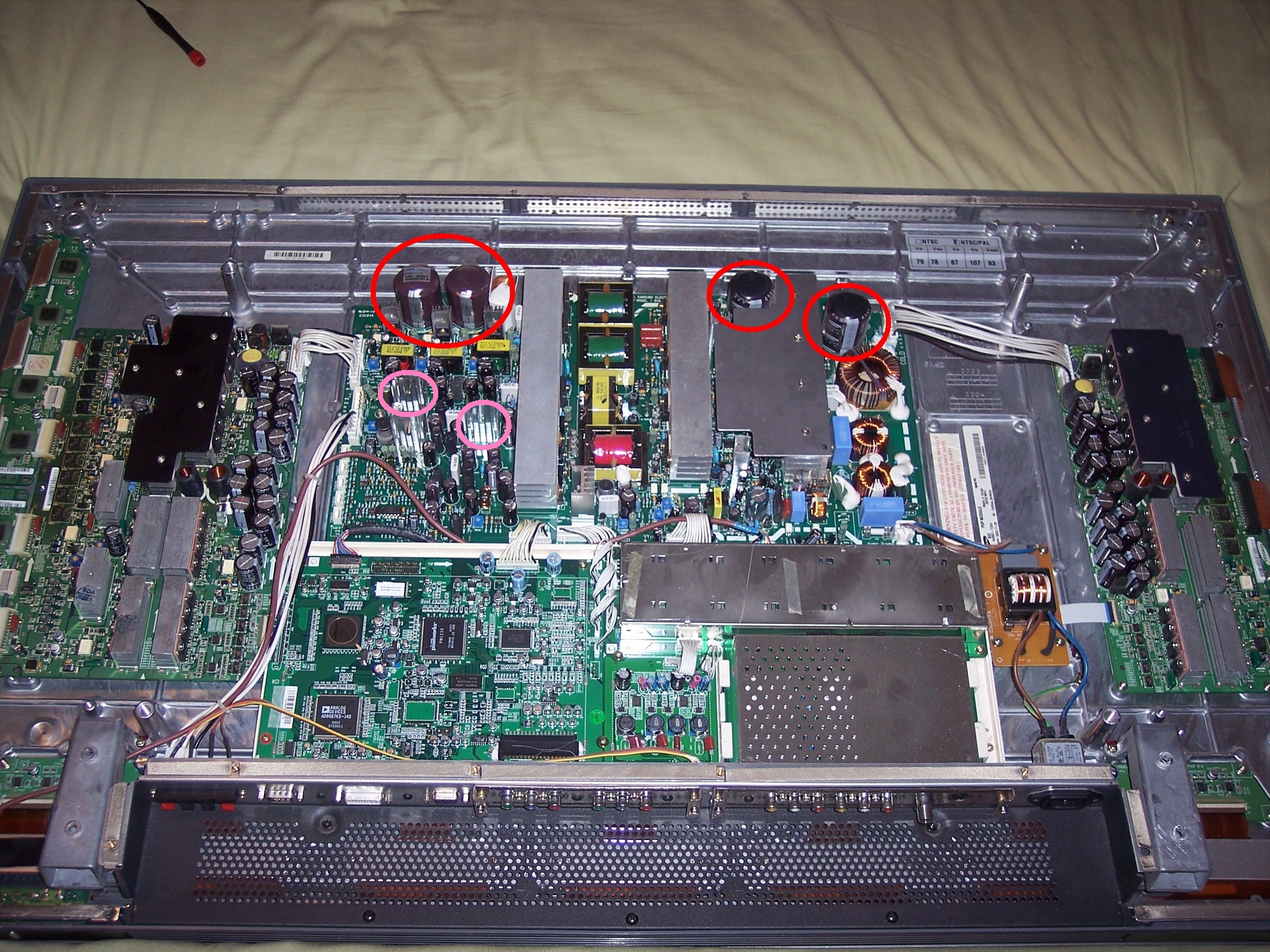

    Greetings!
    I was given this television and was told that the screen went dark, but that sound continued to play. I have plugged in a media player of mine via composite but can't get any sound out of it. Unfortunately because the screen is not working I am unable to know if I have the correct input selected. When the TV is off I have a solid red LED on the front, which changes to blue when I turn it on via either the front buttons or the remote.
    Thanks to some of the helpful posts here I was able to at least get started on this feller, but am hoping that someone might be able to help me along. Upon opening it I found four caps that were clearly popped (red circles in photo). The two brown ones at the top left were 200V/1200uF while the two black ones at the top right were 450V/330uF. After replacing them I was still getting no picture so I checked the voltages listed on the sticker found inside, with these results:
    va: 79V expected, 79.3V measured
    vsc: 78V expected, 78.7V measured
    vs: 87V expected, 17.8V measured
    ve: 107V expected, 106.3V measured
    vset: 83V expected, 0.0V measured
    I found Tom66's post about plasmas but got a little stuck since I am not actually sure if there is audio or not. My voltage readings seem to indicate to me that I have a messed up voltage regulator somewhere so I was reading retiredcaps' thread about testing voltage regulators which lead me to find a couple of KA7815's (marked pink in the photo). The board is marked as a Samsung B4K-50 (LJ44-00055A) Rev 2 - and I got these voltage readings from the KA7815's:

      First those caps are bot popped. The plastic cover on the caps bubble up with heat. Im sure the caps are fine.
      Unplyg the ysus. The board on the left.from the power supply. Do you get power now to vs and vset?

          Hey freakaftr8, thanks for the reply... I had a chance to look at it tonight and unfortunately unplugging the ysus/ybuffs didn't change anything. However, I decided to try with the xsus unplugged and I got
          vs: 87V expected, 72.6V measured
          ve: 107V expected, 107.8V measured
          vset: 83V expected, 78.9V measured
          Which may not be perfect but is a significant improvement. From what I have seen around here ysus seems noticeably more likely to fail and of course I have to run against the grain. :-)
