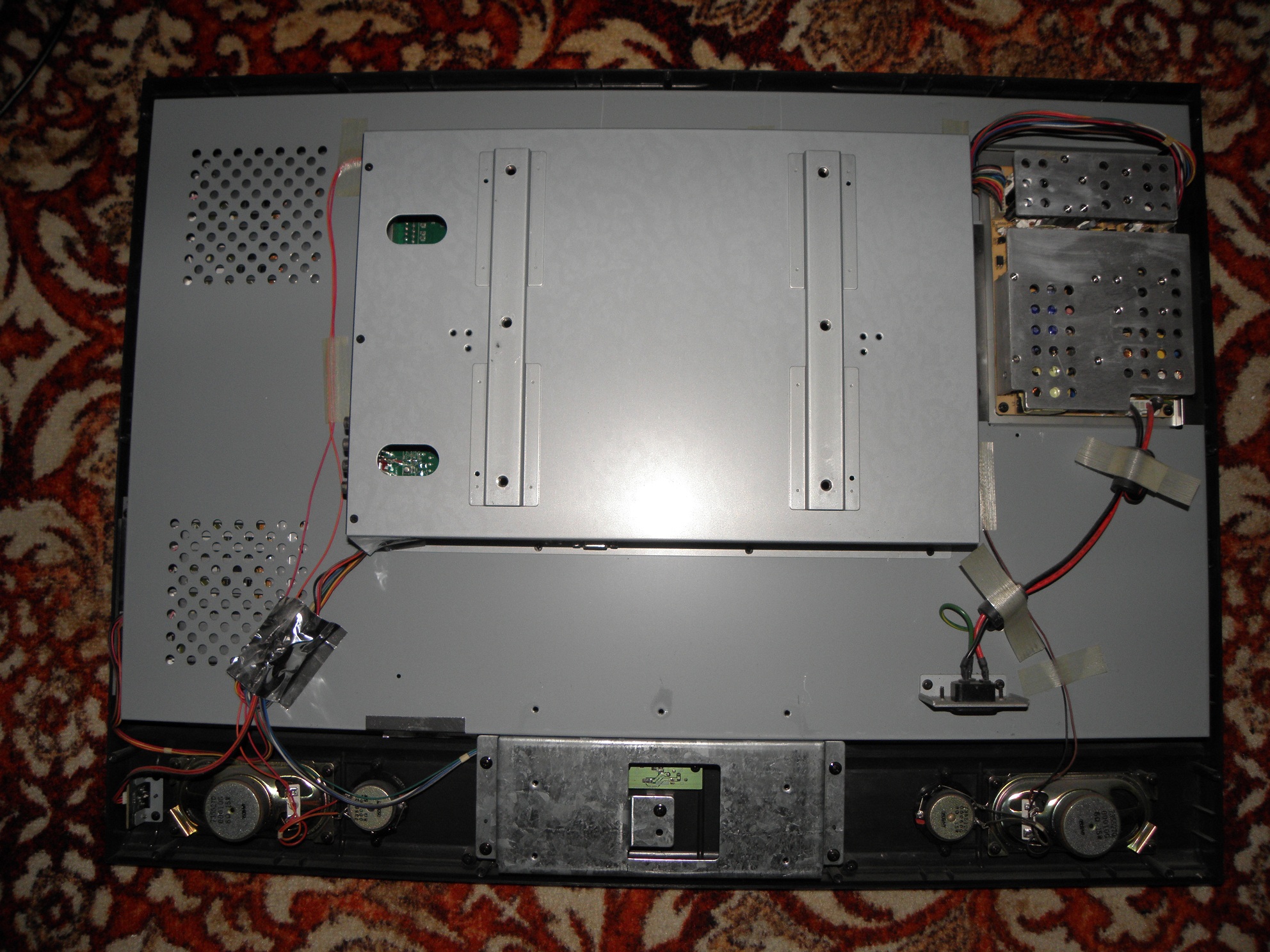

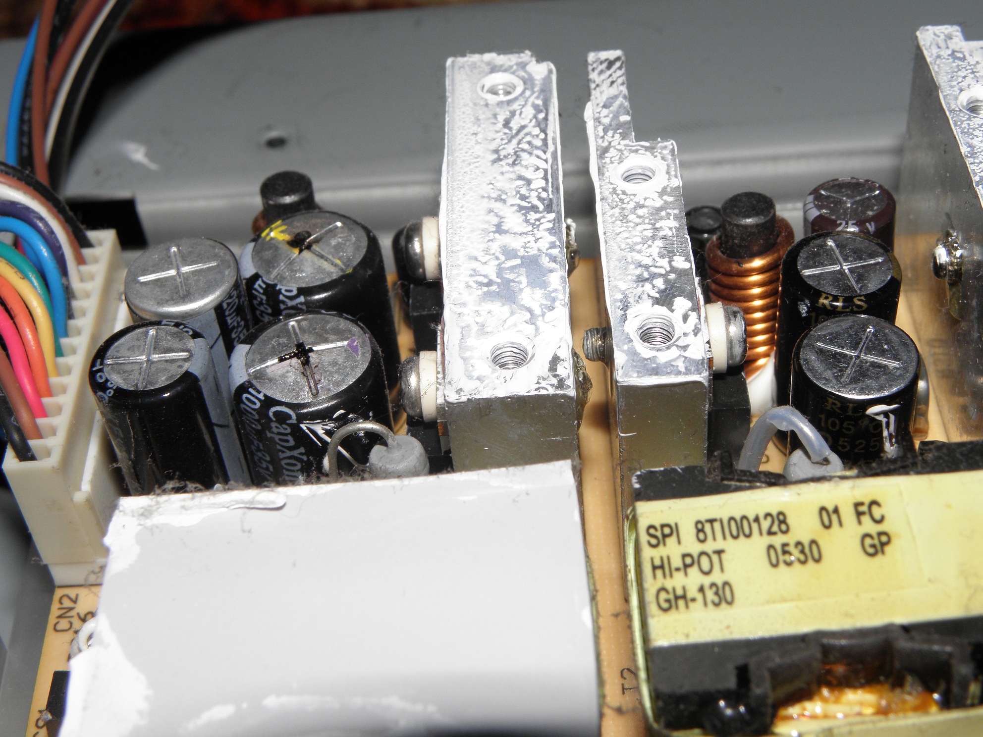

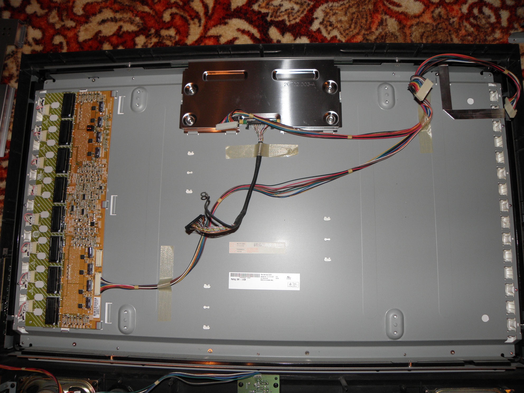

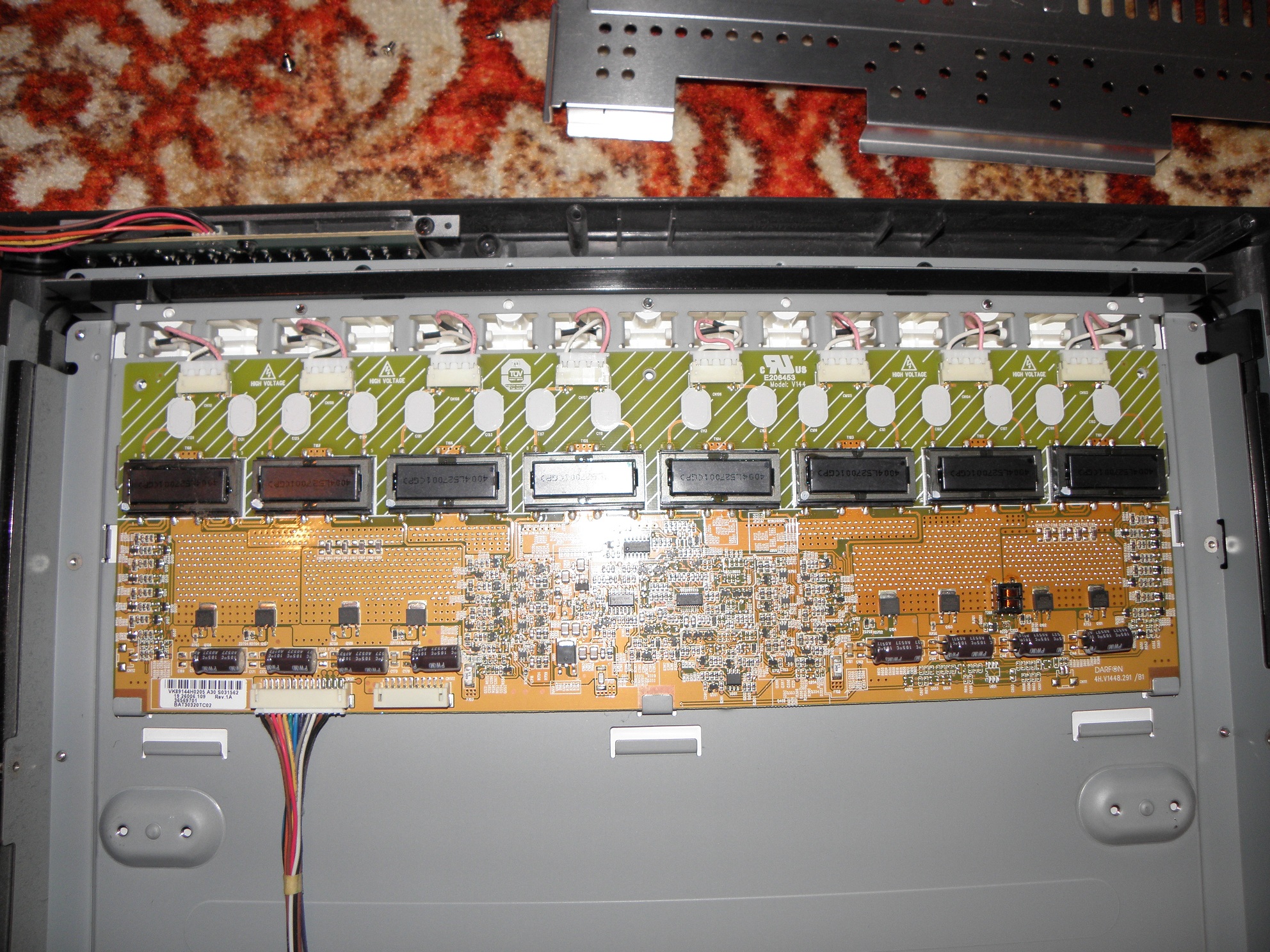

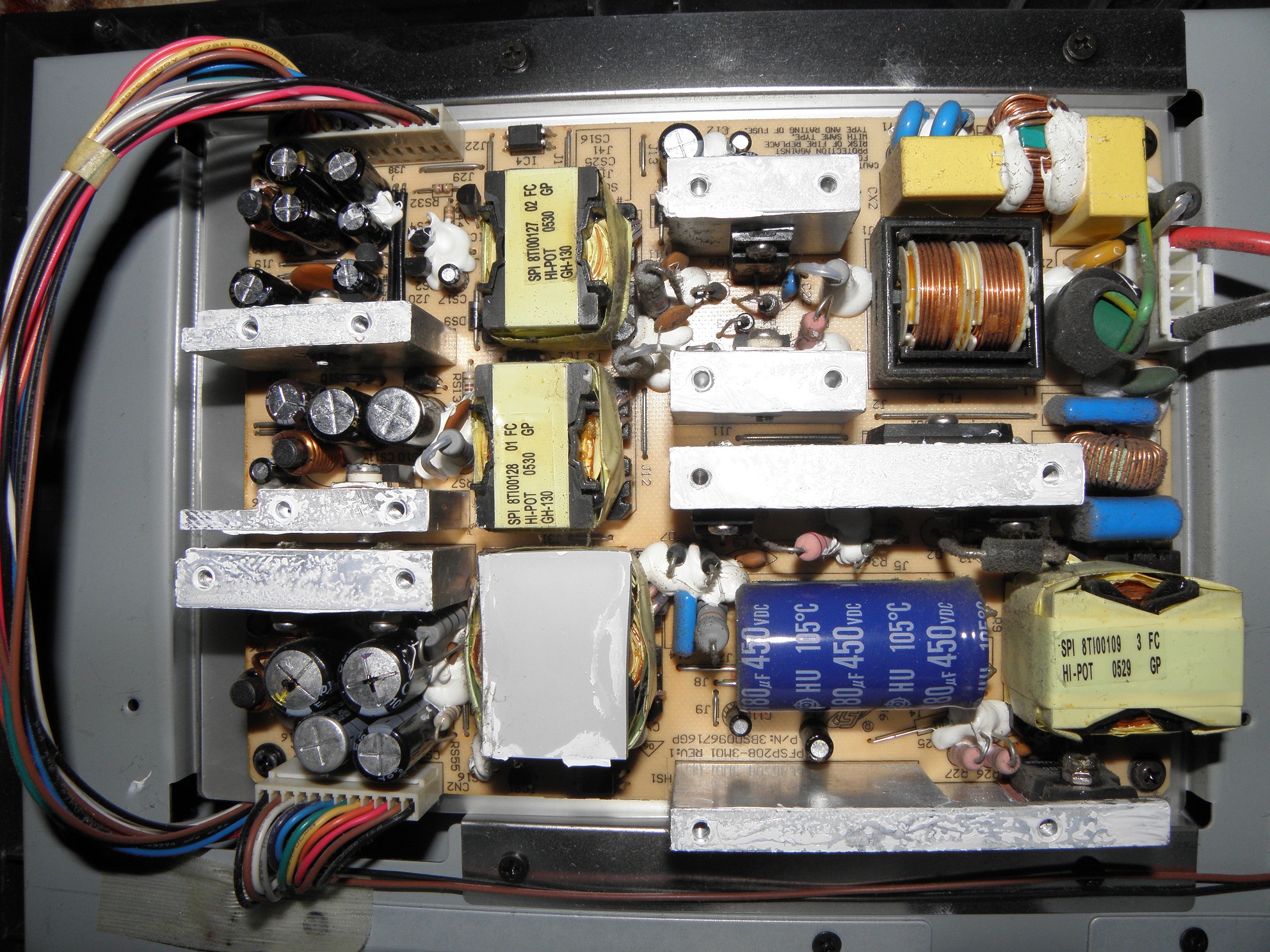

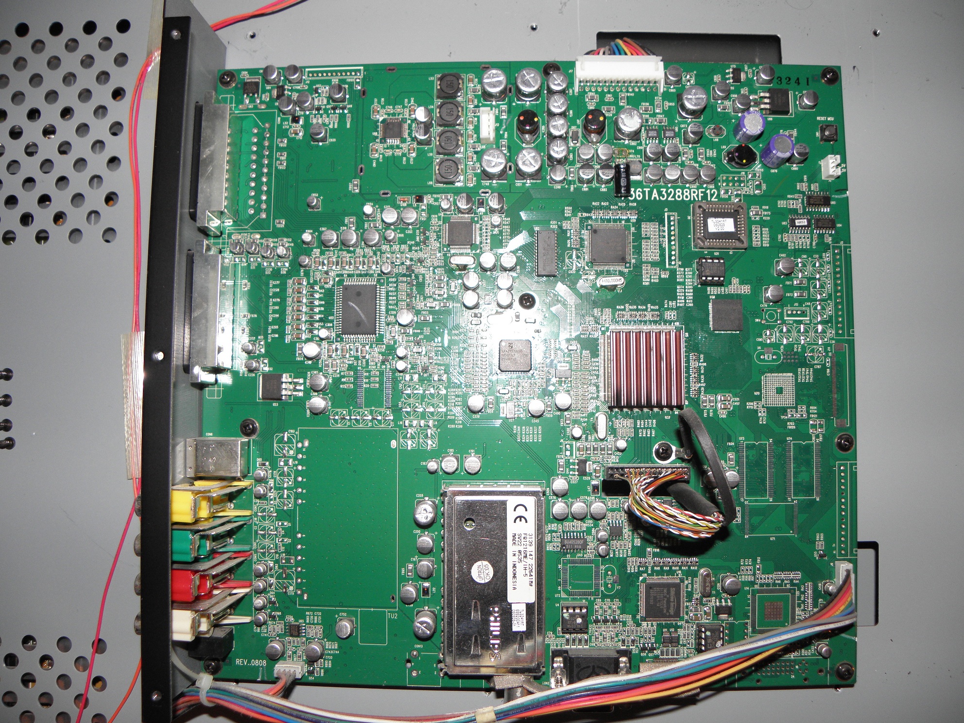

          Re: Viewsonic N3260W 32" LCD TV - Dark picture & flickering

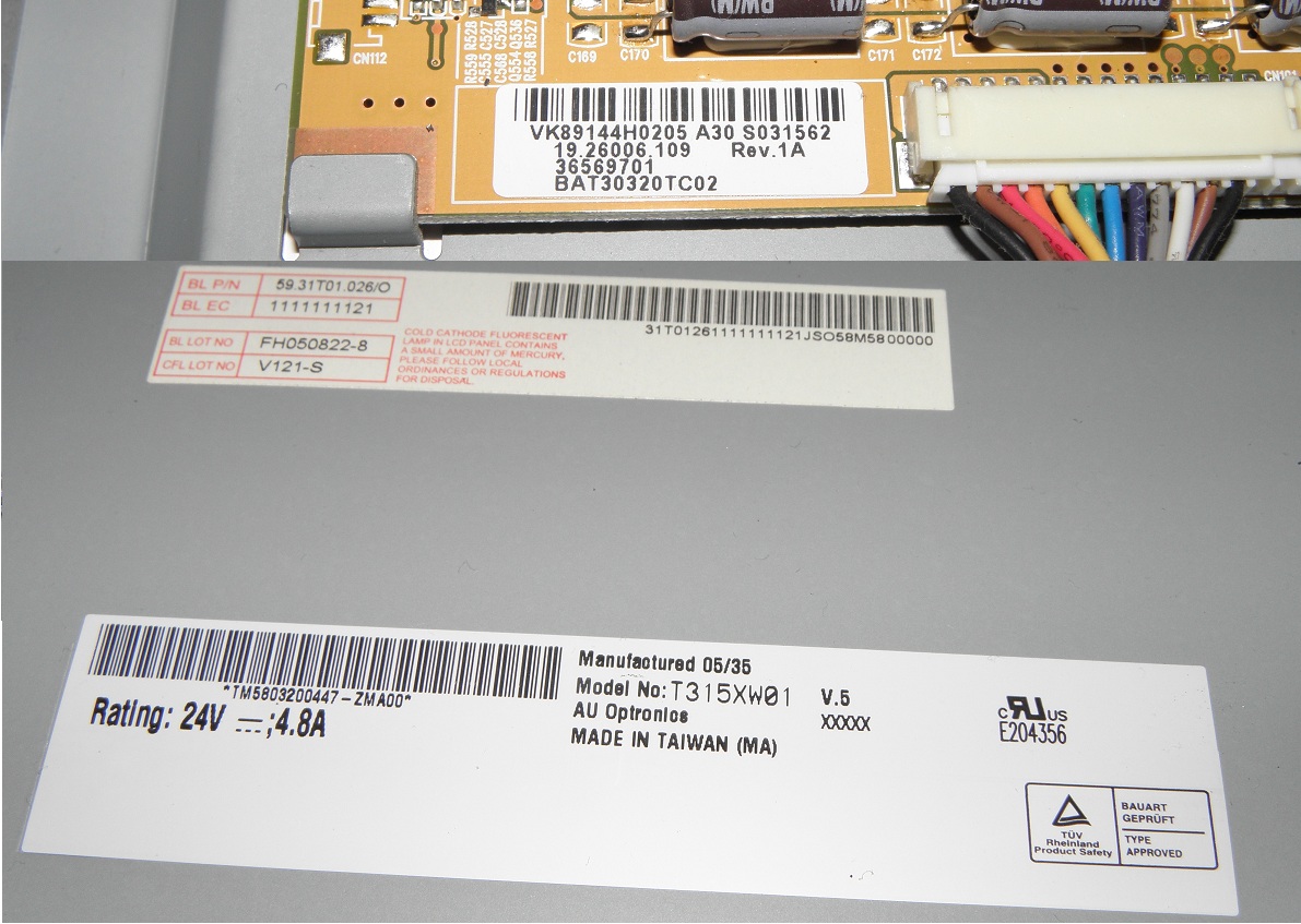

          Aha! Under the PSU heatspreaders were hiding some bulging and 'rising above the sleeve' caps!!!
          Pictures attached;
          1. Chassis
          2. PSU
          3. Cap closeup
          4. Logic board
          5. LCD chassis
          6. Inverter
          7. Inverter & Panel part numbers.
            Bingo. Bad caps. Replace ALL the secondary caps, in my opinion.
            While you are at it, test the voltage across that large, blue 450V capacitor. Expecting around 380 to 410V DC.
              Oh yeah. You have bulged caps, and caps that have seen a lot of heat. Like Tom66 said, replace all the secondary caps, even if they aren't bulged. (the big filter cap should be okay)
                Ok. When you say 'secondary caps' - do you mean all 7 big ones in the close up pic or ALL CAPS in the top part of the PSU?
                The big blue cap;
                On standby: 343.1v
                Powered on: 389.6v
                I'll update once caps are replaced.
                Thanks.
                  You live in a country with 240V mains?
                  The blue cap is fine.
                  Secondary caps are the ones to the left of the three yellow transformers, such as those two bulged ones. I would recommend replacing at least all of the CAPXON branded ones, as they are probably the worst capacitors ever made.
                    For a quick visual reference on where to start, see the attached pic.
                    Replace all the capacitors in the area I circled.
                    You may also want to replace the small capacitors just above the circle.

                      Sorry for the delay in responding - for some reason I had thought I posted an update but I was wrong
                      Thank you both for your replies and advice.
                      Yes I am in the UK and we did have 240v mains but at some point the UK Government agreed to harmonization at 230V although 240v sounds more impressive
                      I replaced all the capacitors to the left of the three transformers - the circled ones and ones above...and the tv seems absolutely fine now!!
