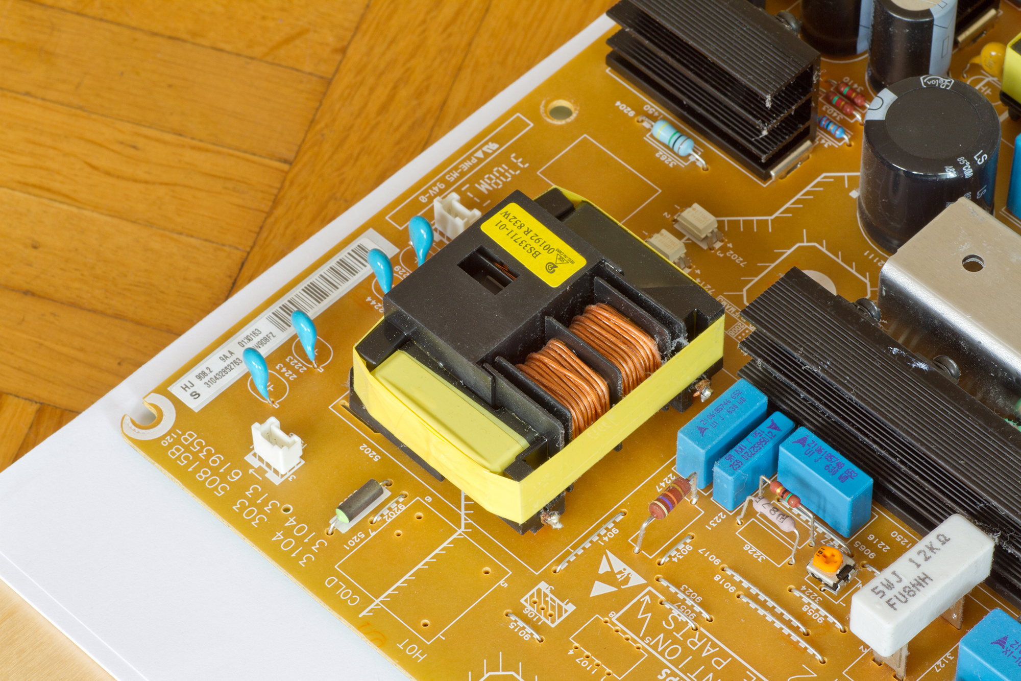

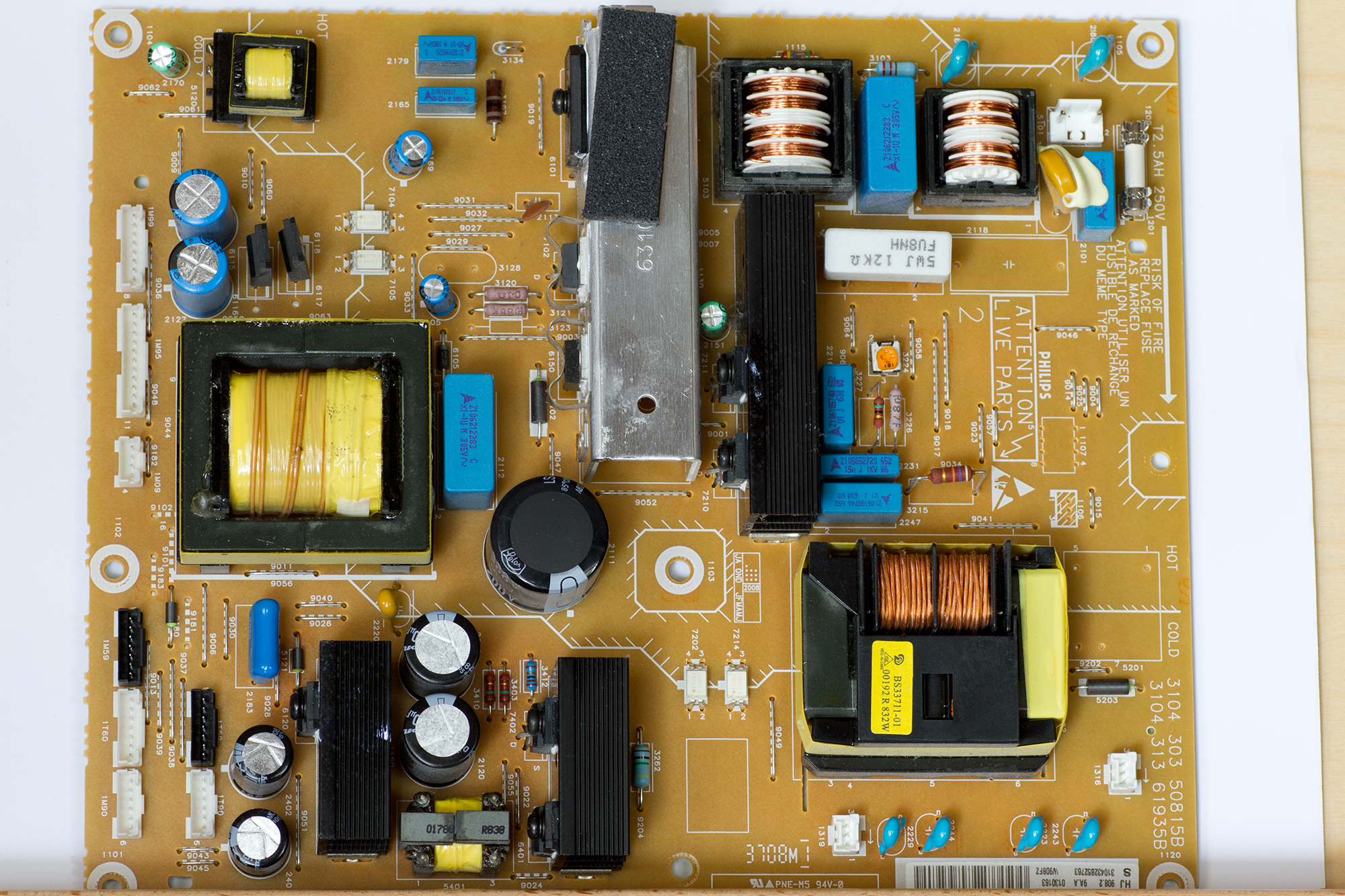

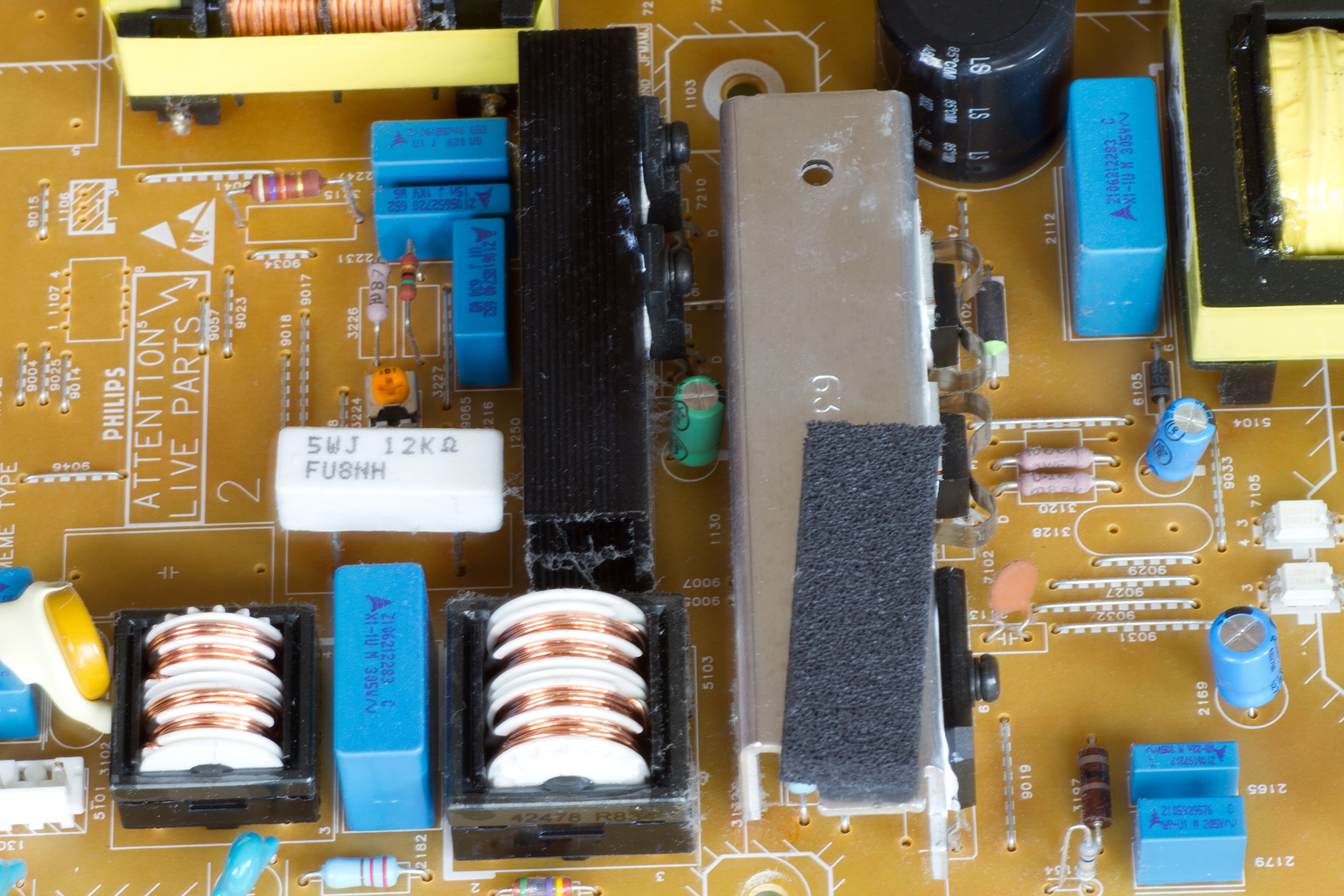

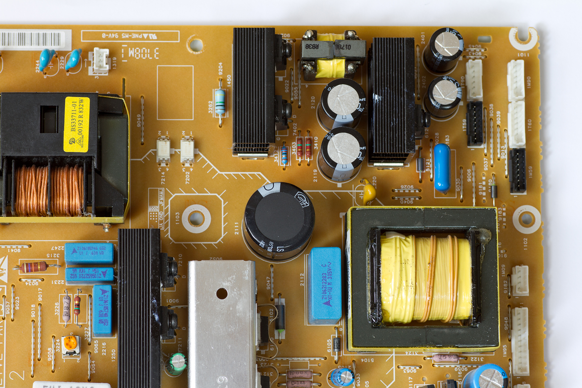

      Re: Philips 42PFL9603D won't turn on. Need specs for Lelon capacitors.
      Originally posted by capkid
      Please post pics of the back of the TV with the cover off. The ESR seems marginally high on a couple caps, but I'm not sure it's high enough to cause a failure with three blinks.

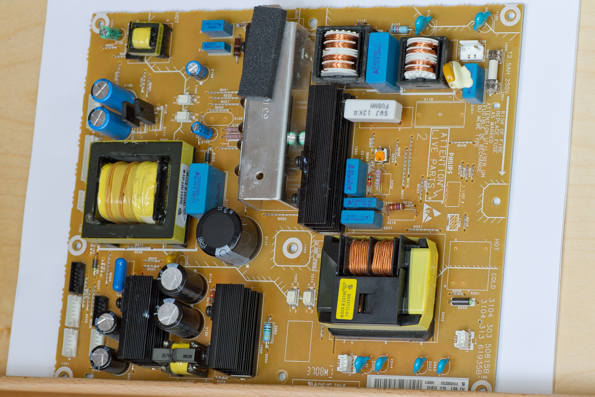

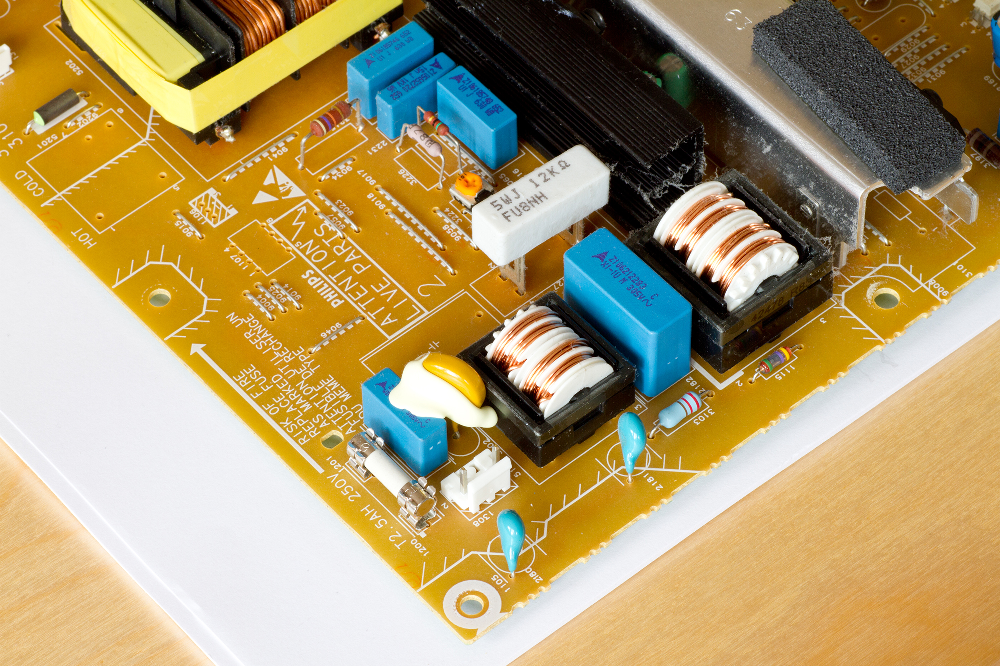

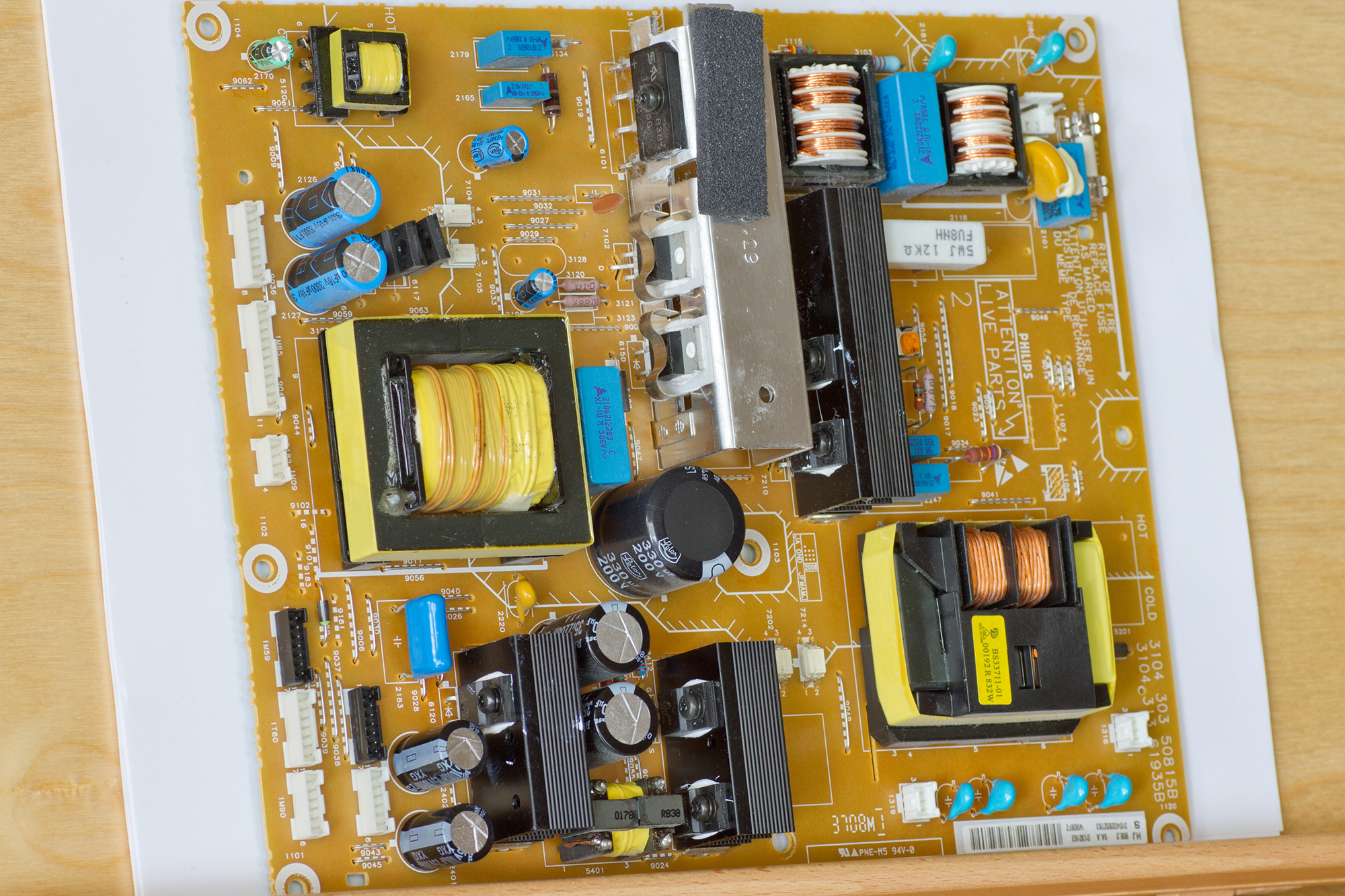

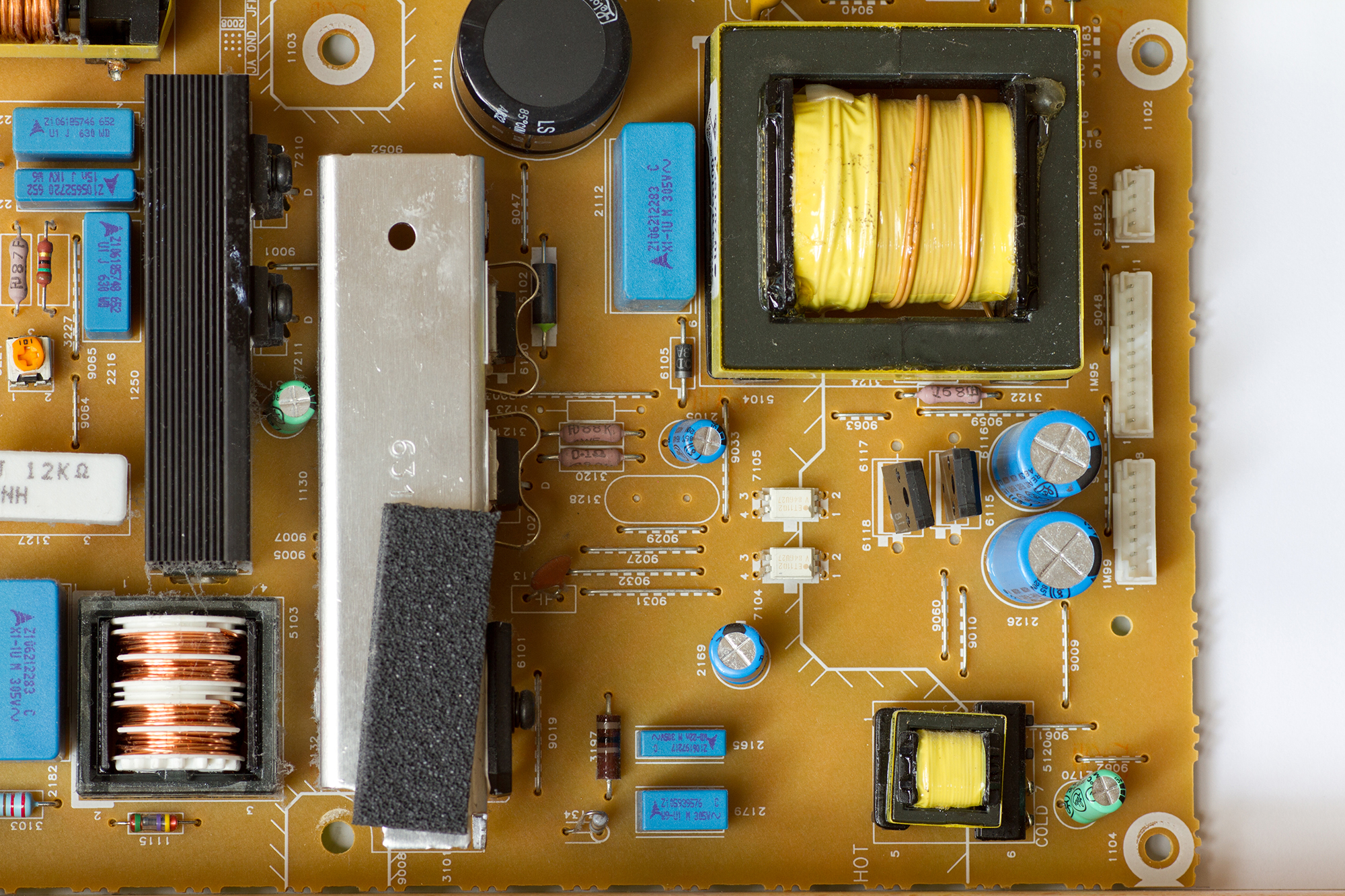

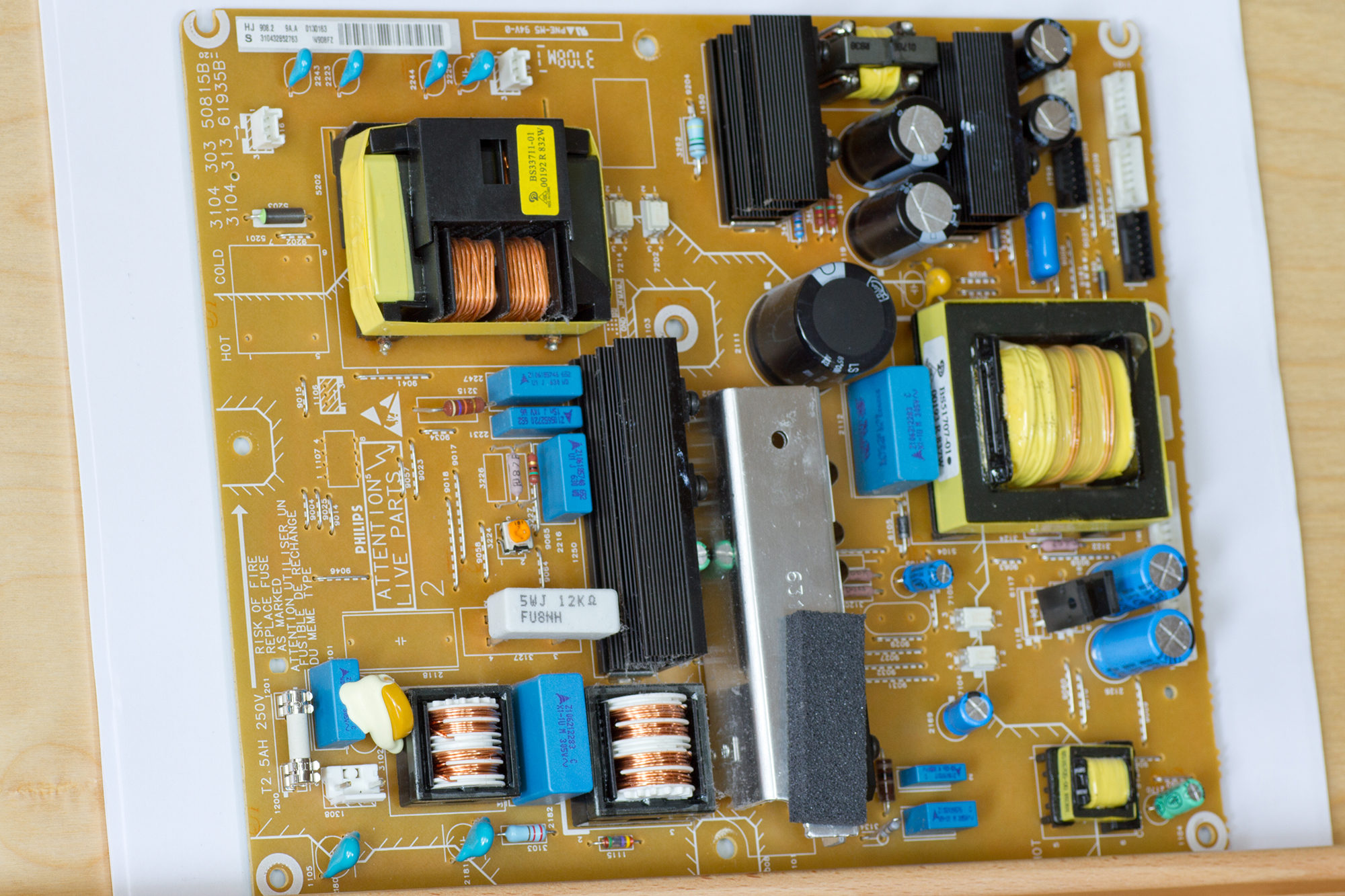

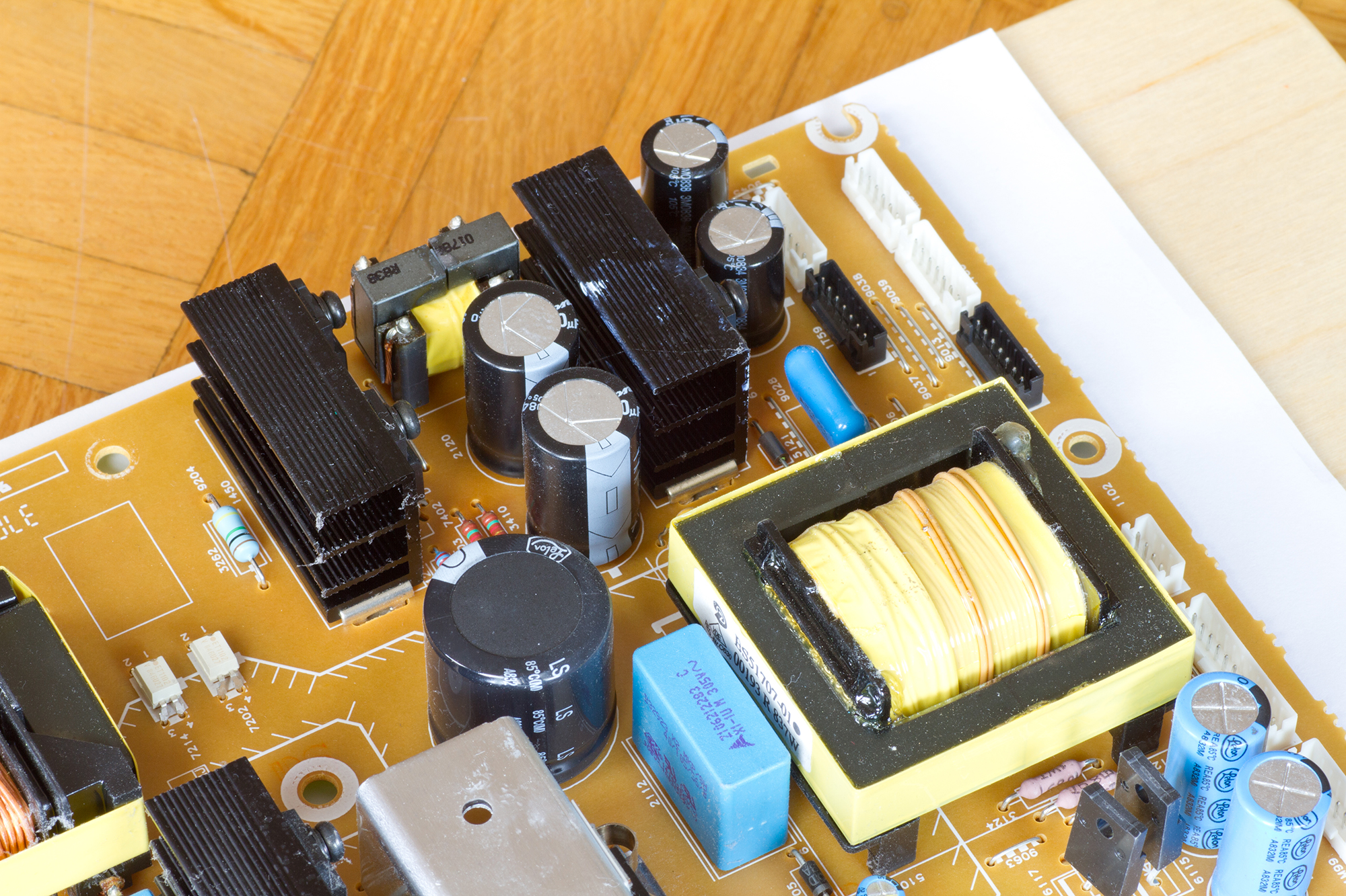

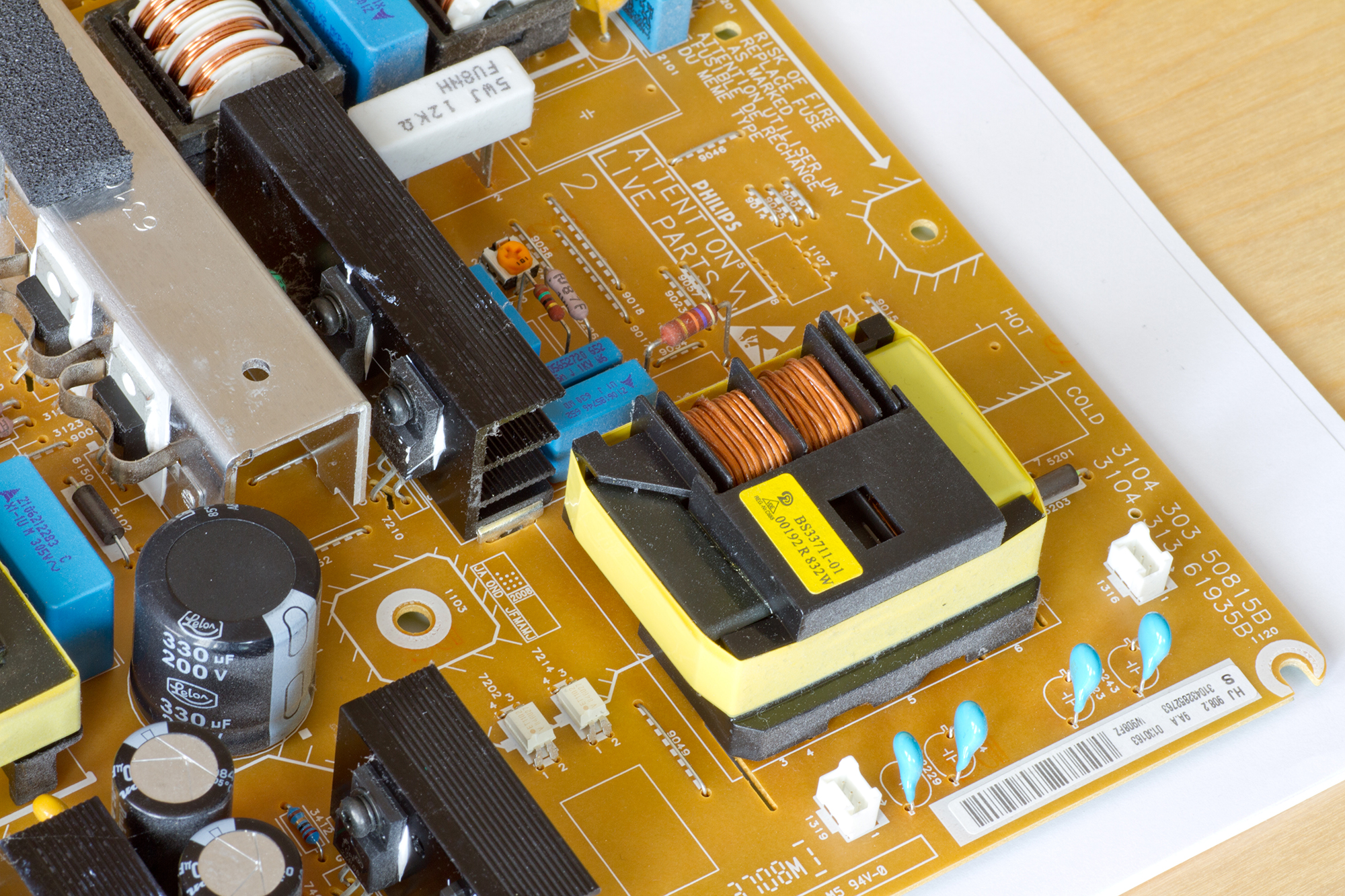

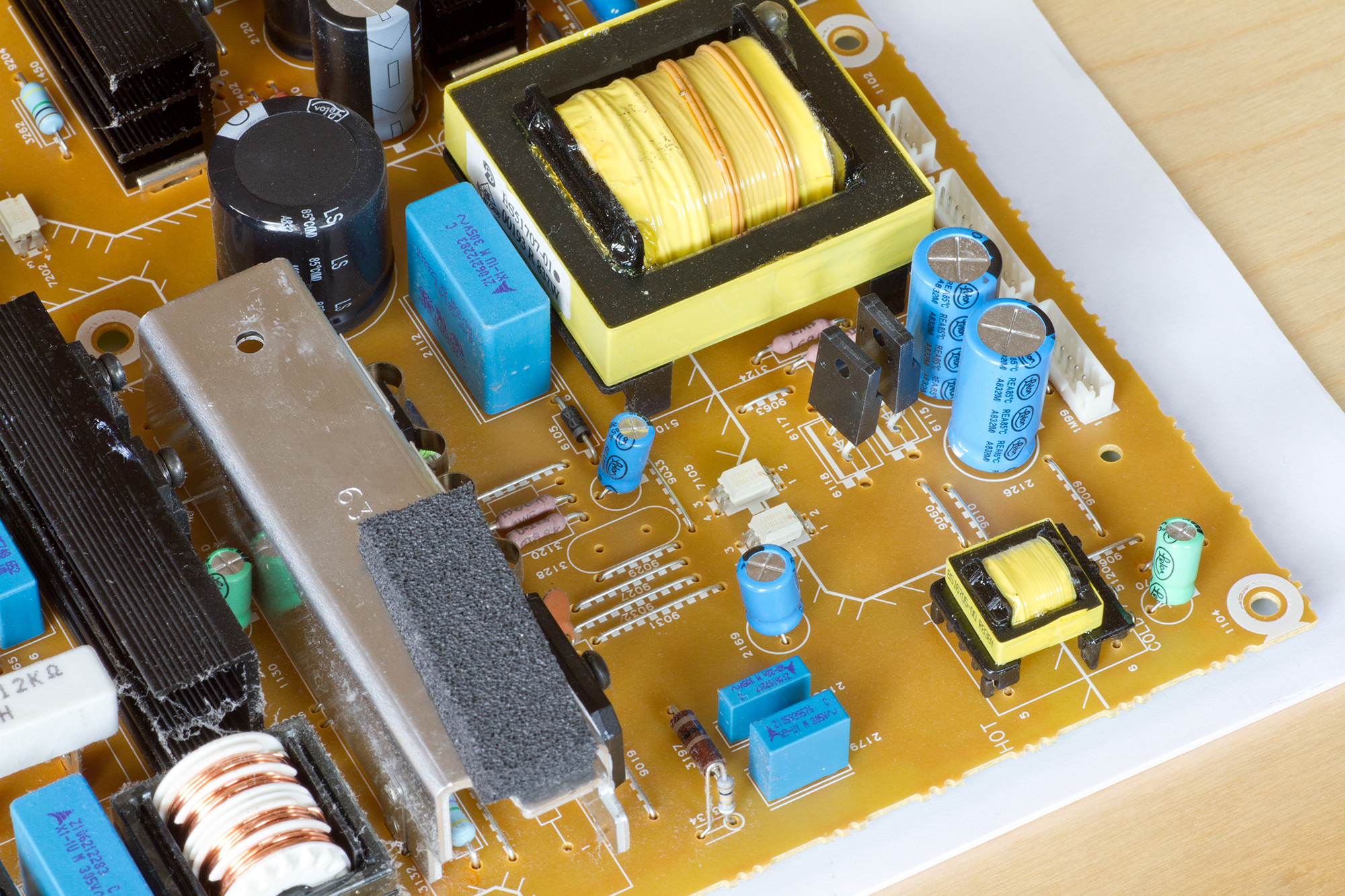

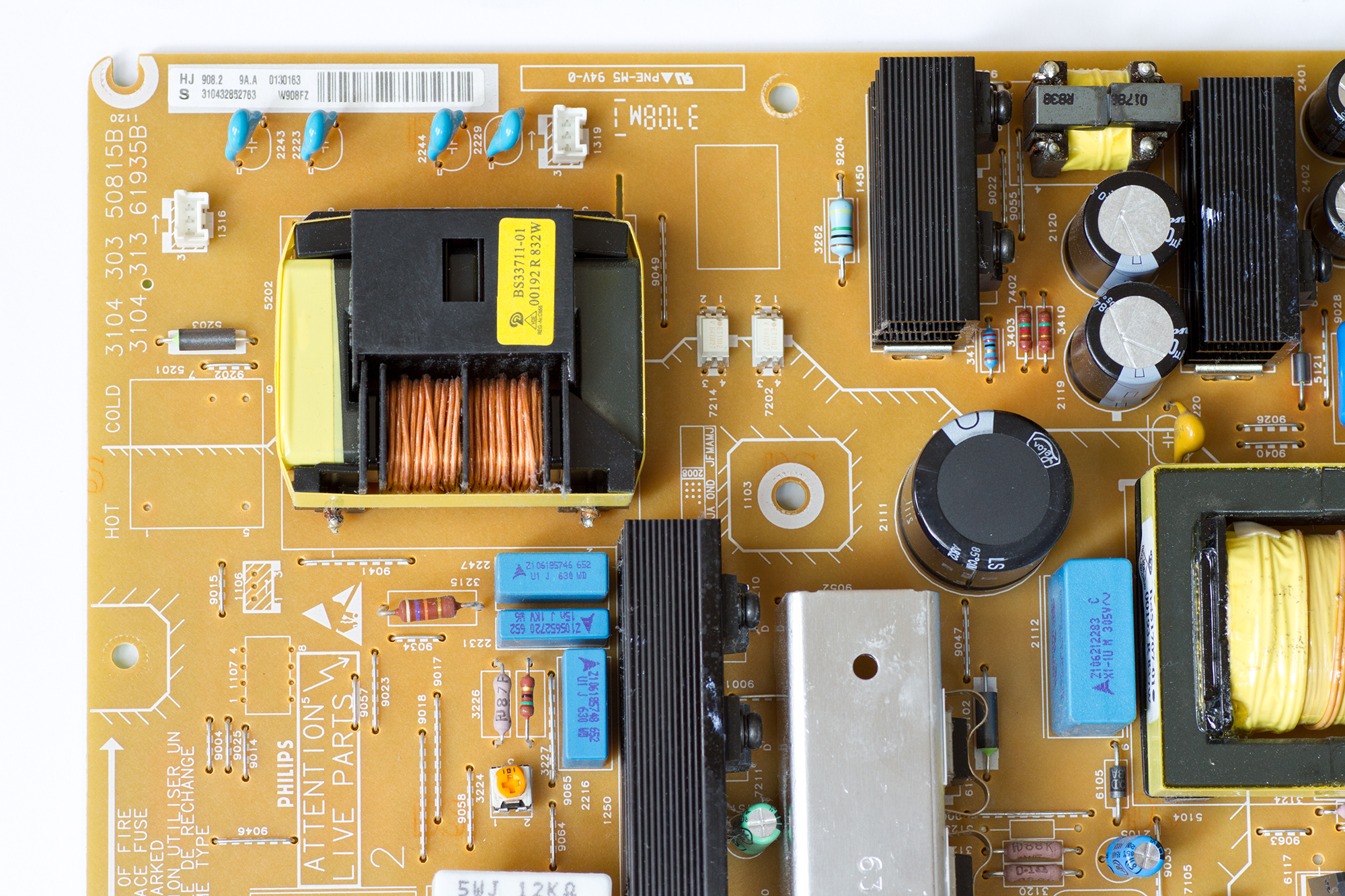

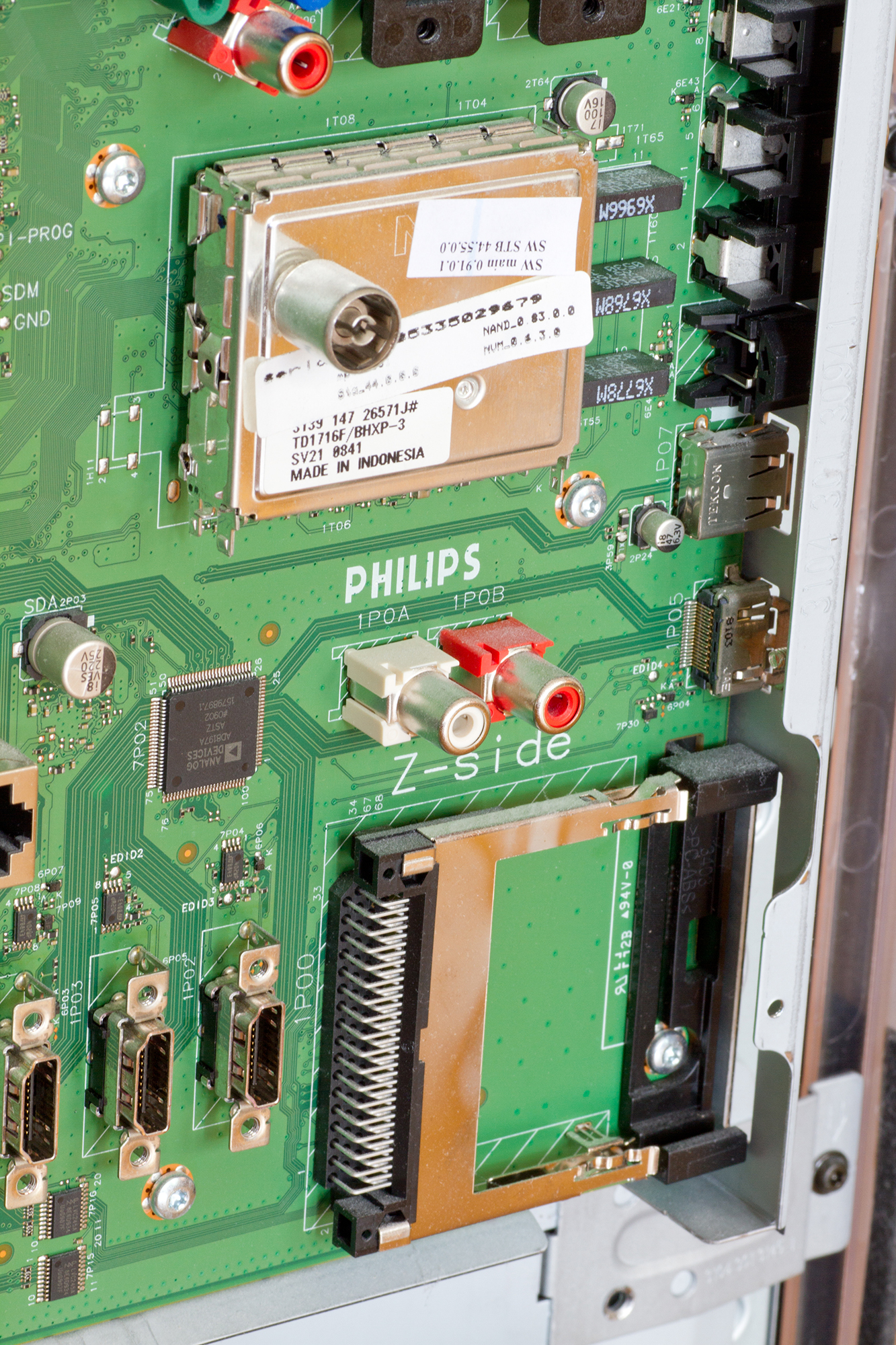

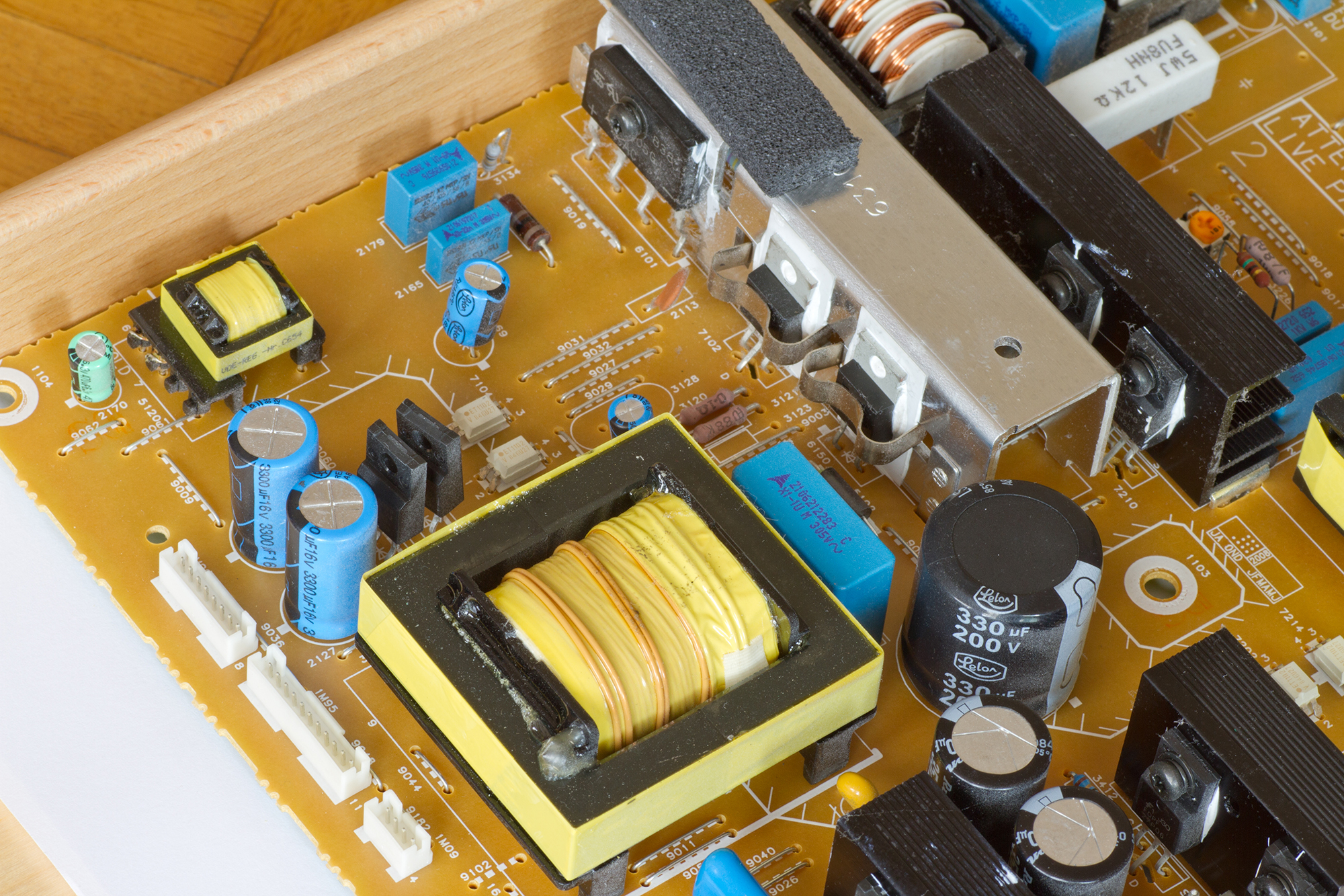

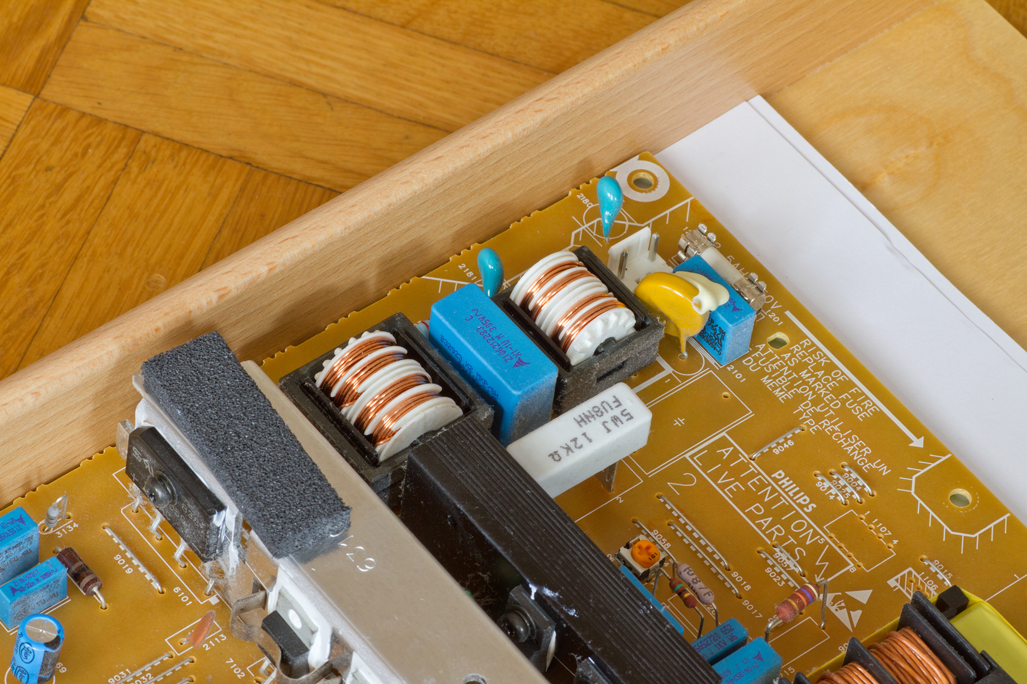

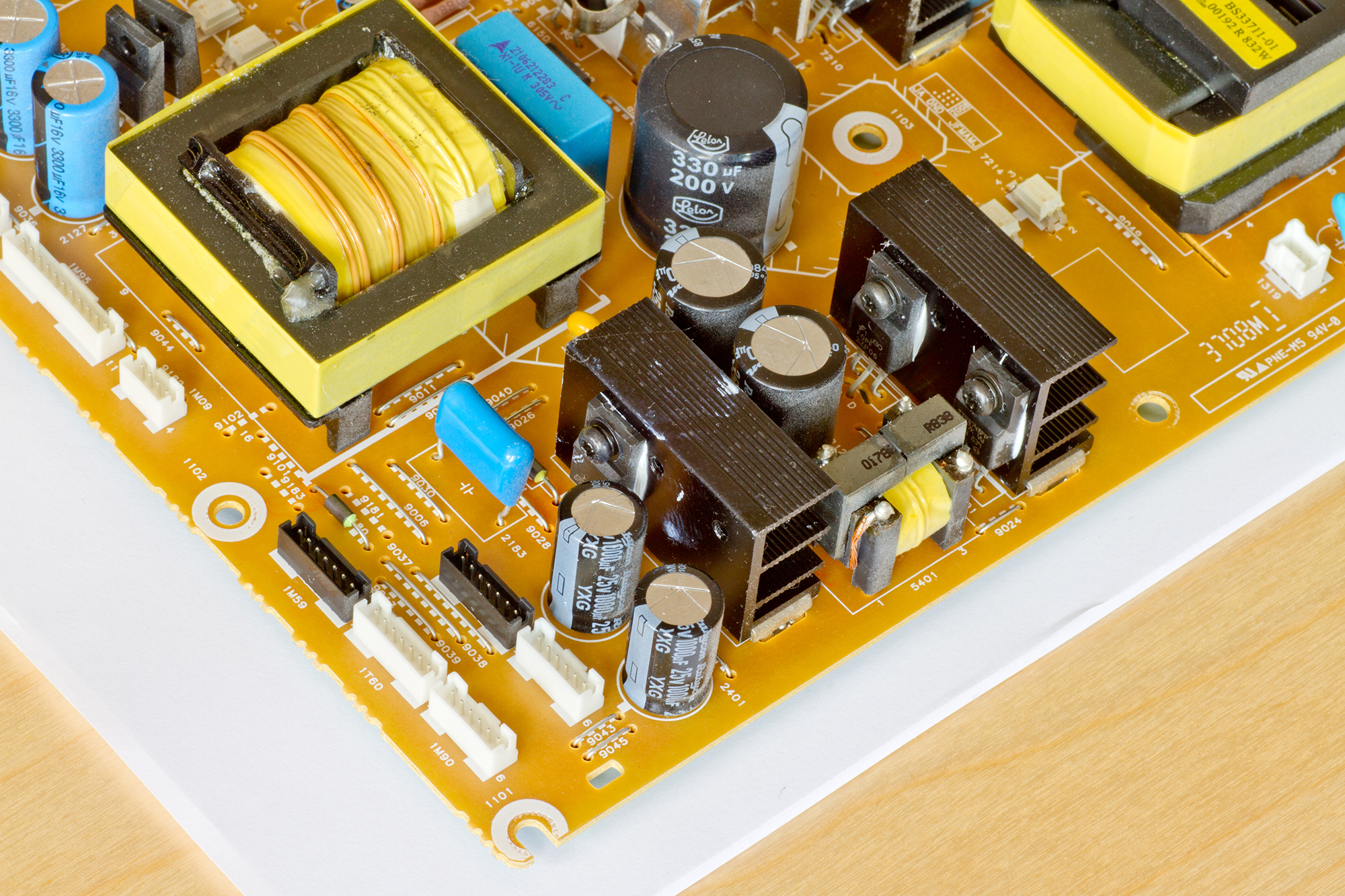

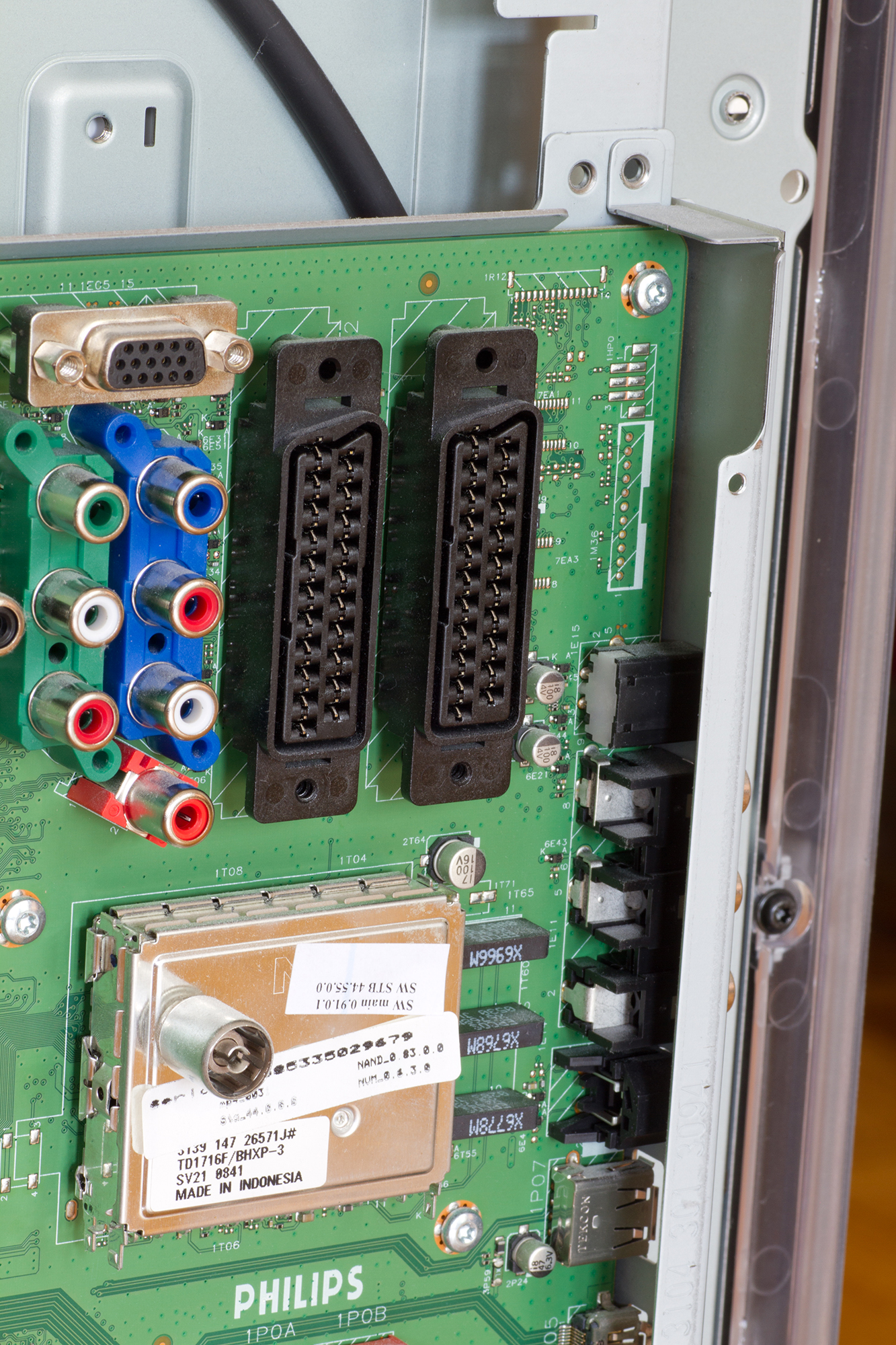

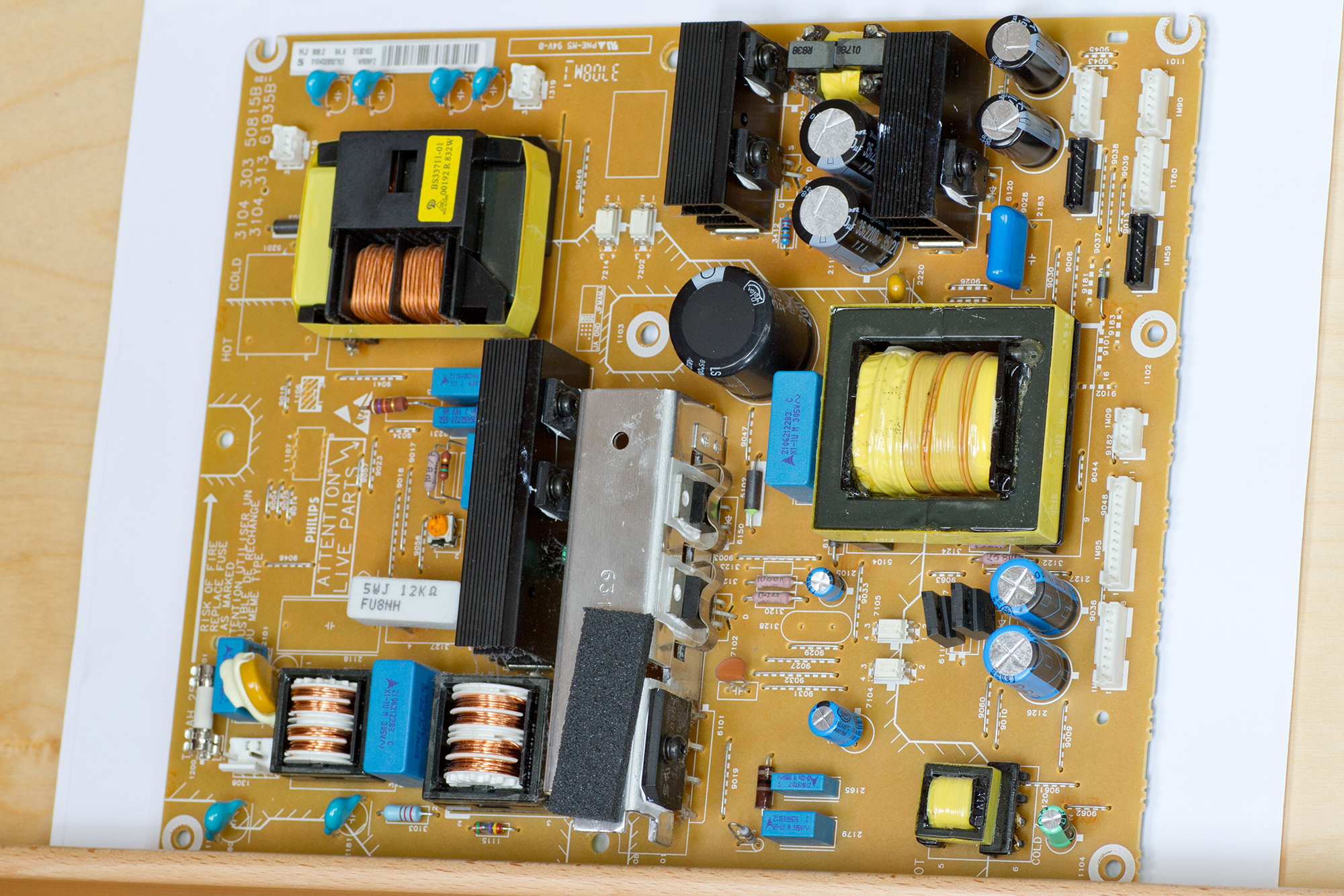

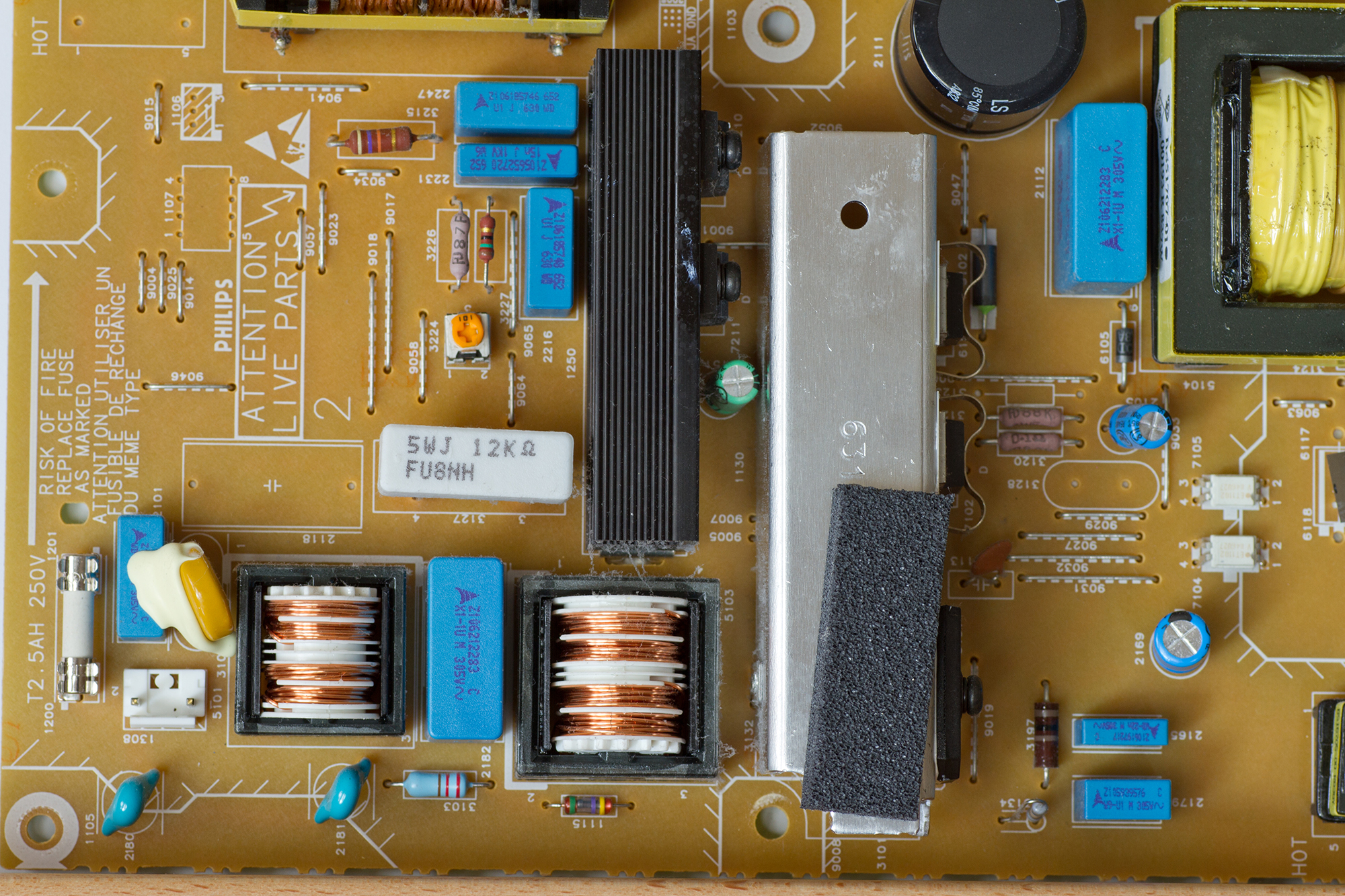

      Here are some pictures of the power supply board (removed from the tv) as well as some pictures of the signal processing board (still on the tv).
      The first image is a full view of the power supply board.
      Let me know if you need (more) closeups of anything.

        By the way: My power supply looks exactly the same as the one seen in an attachment to last year's thread on Philips 42PFL7403D (same tv size, brand, and year, but lower series):
        https://www.badcaps.net/forum/showthread.php?t=21879
        I read through the thread but did not come to any definite conclusions as to what to do with my own. They seem to be discussing a different problem.
        I would - as a start - just replace all the Taiwanese caps on my board, but the nearest electronics store is 50 miles away and charges something like $10 for shipping anything unless you buy for at least a certain amount, so I want to make sure I get my order right if and when I need to order something.

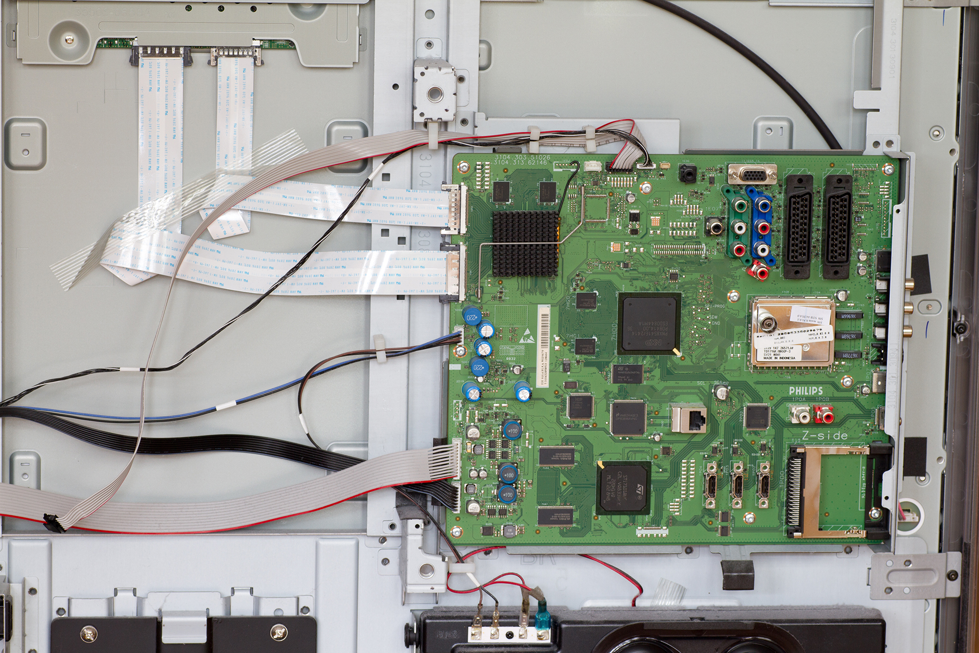

              Have you checked the output diodes for shorts? From the pics none of the outputs are labeled, can you show which pins are the 12v and a pic of the back of the power board as well could be helpful.
              Liberating magic smoke one part at a time

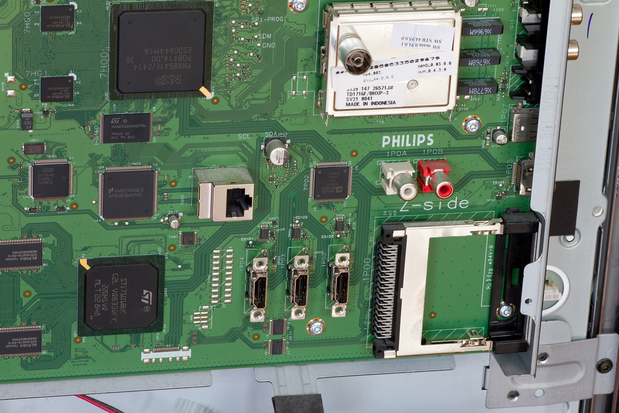

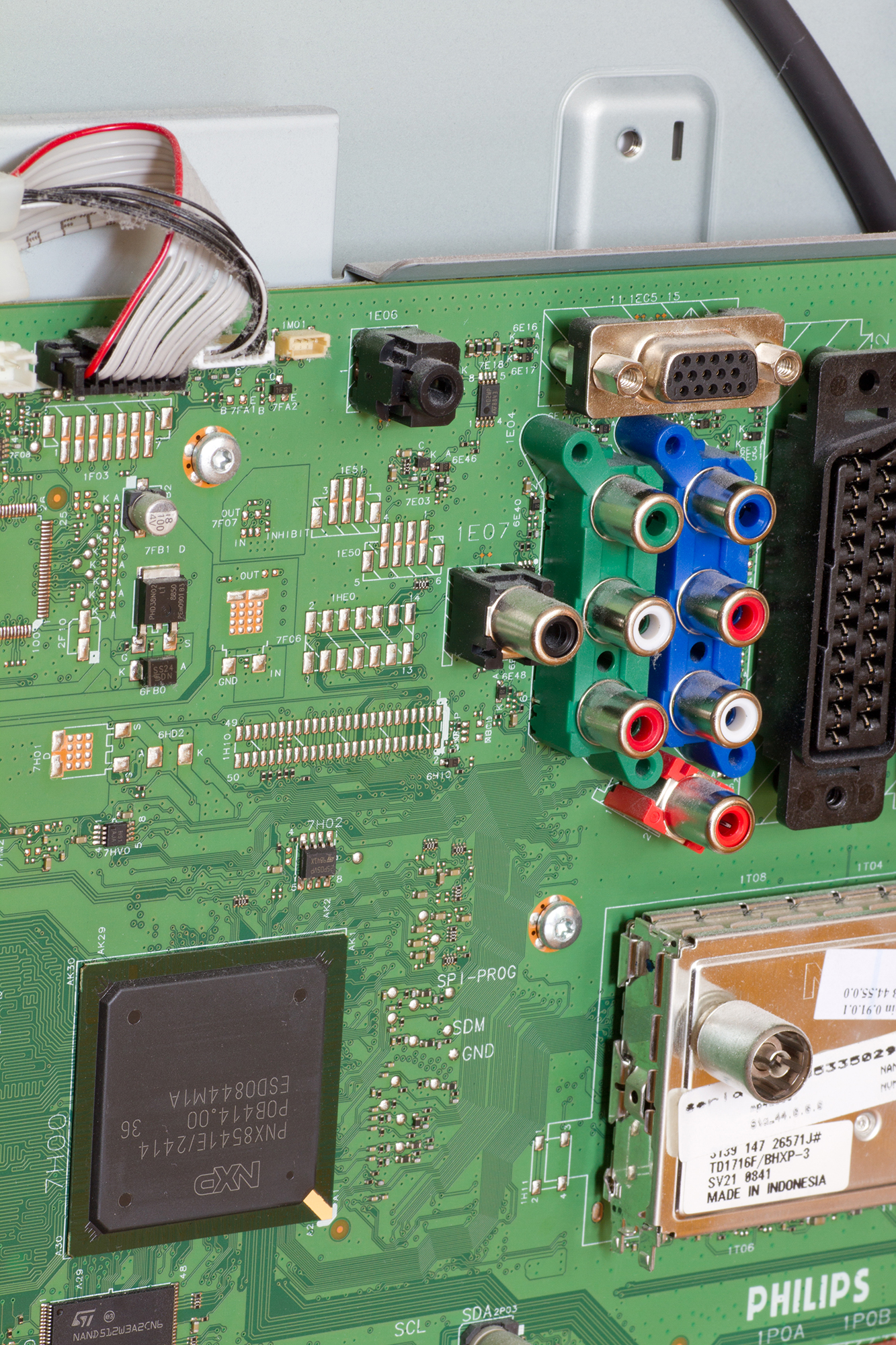

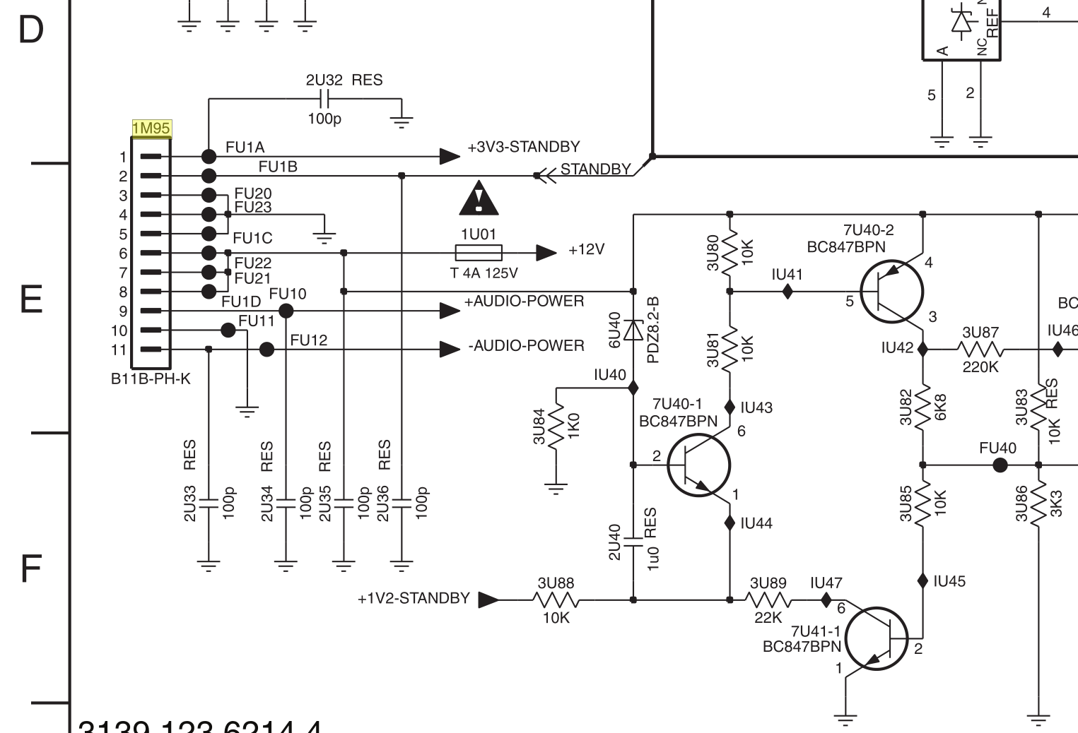

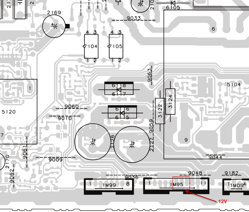

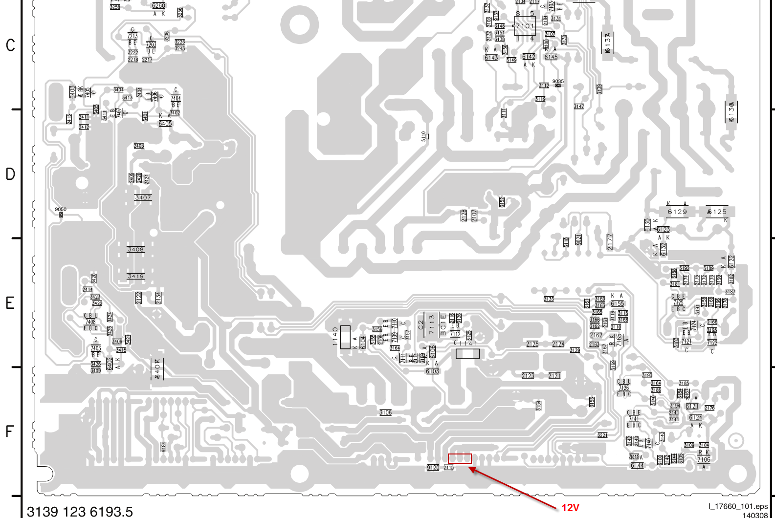

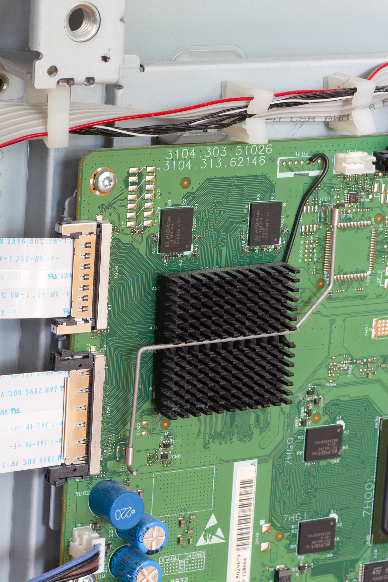

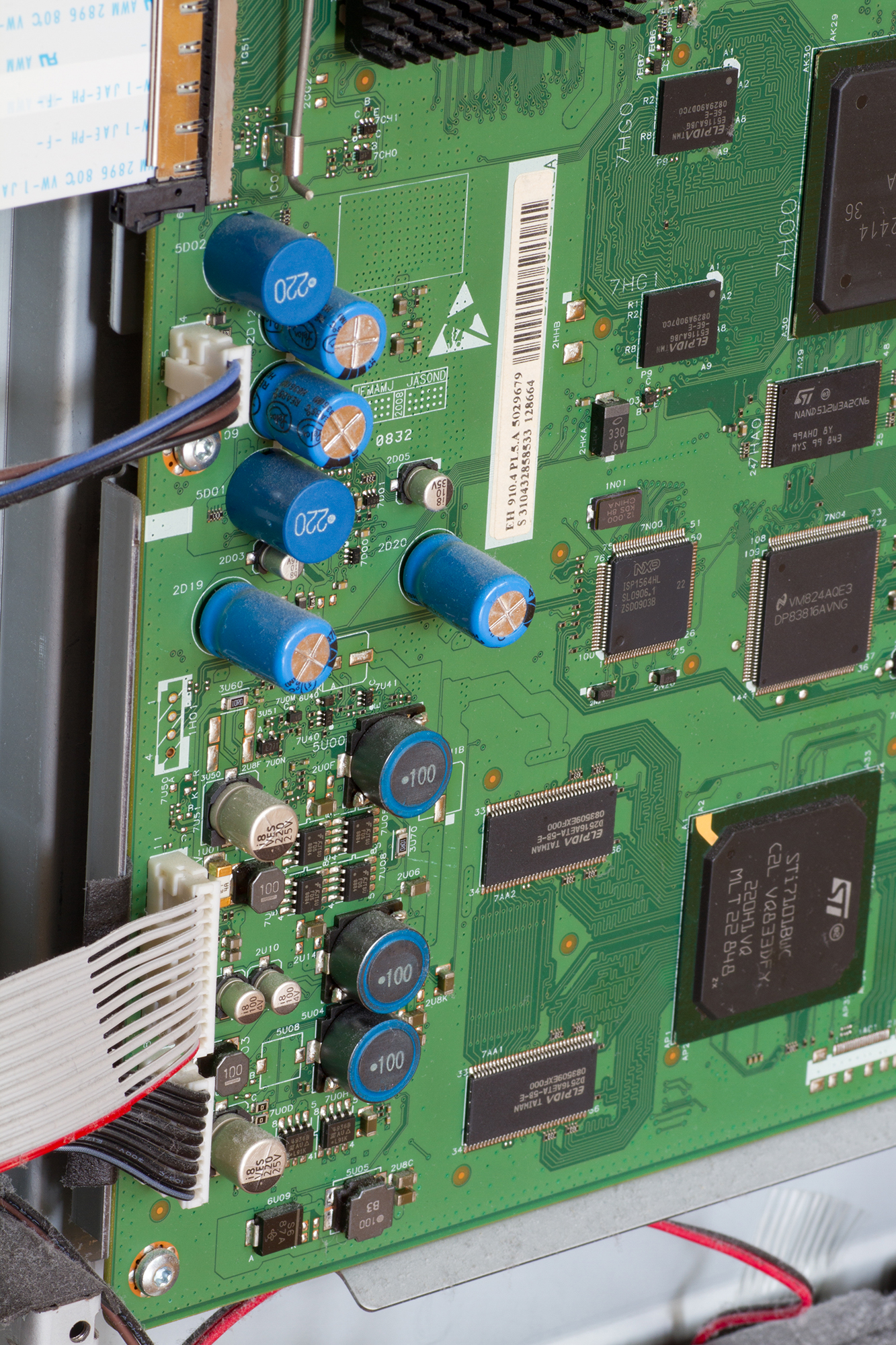

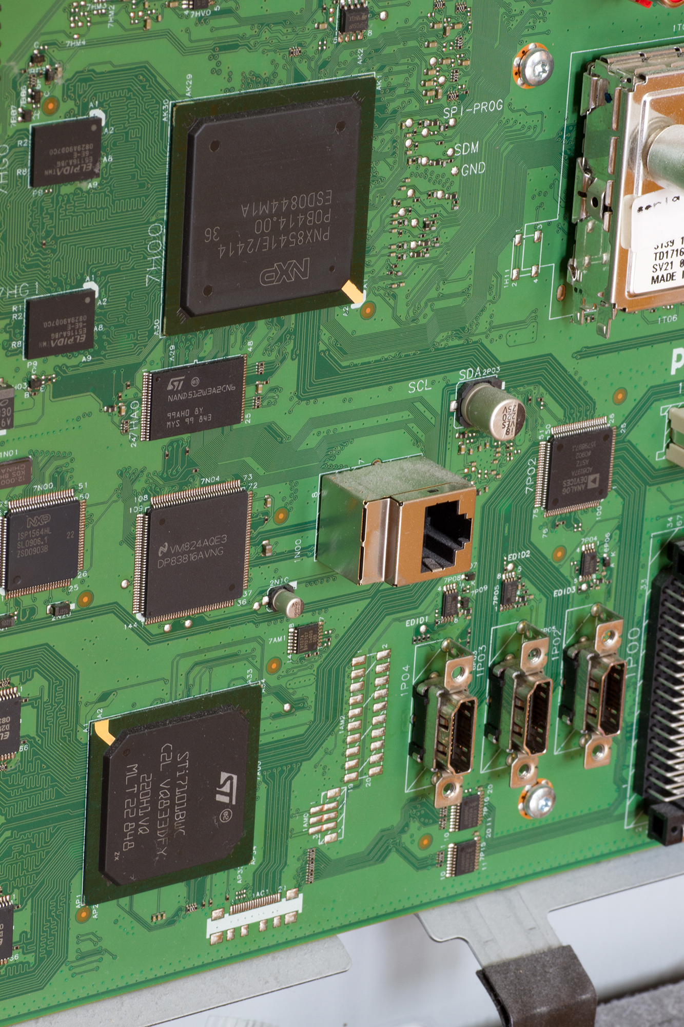

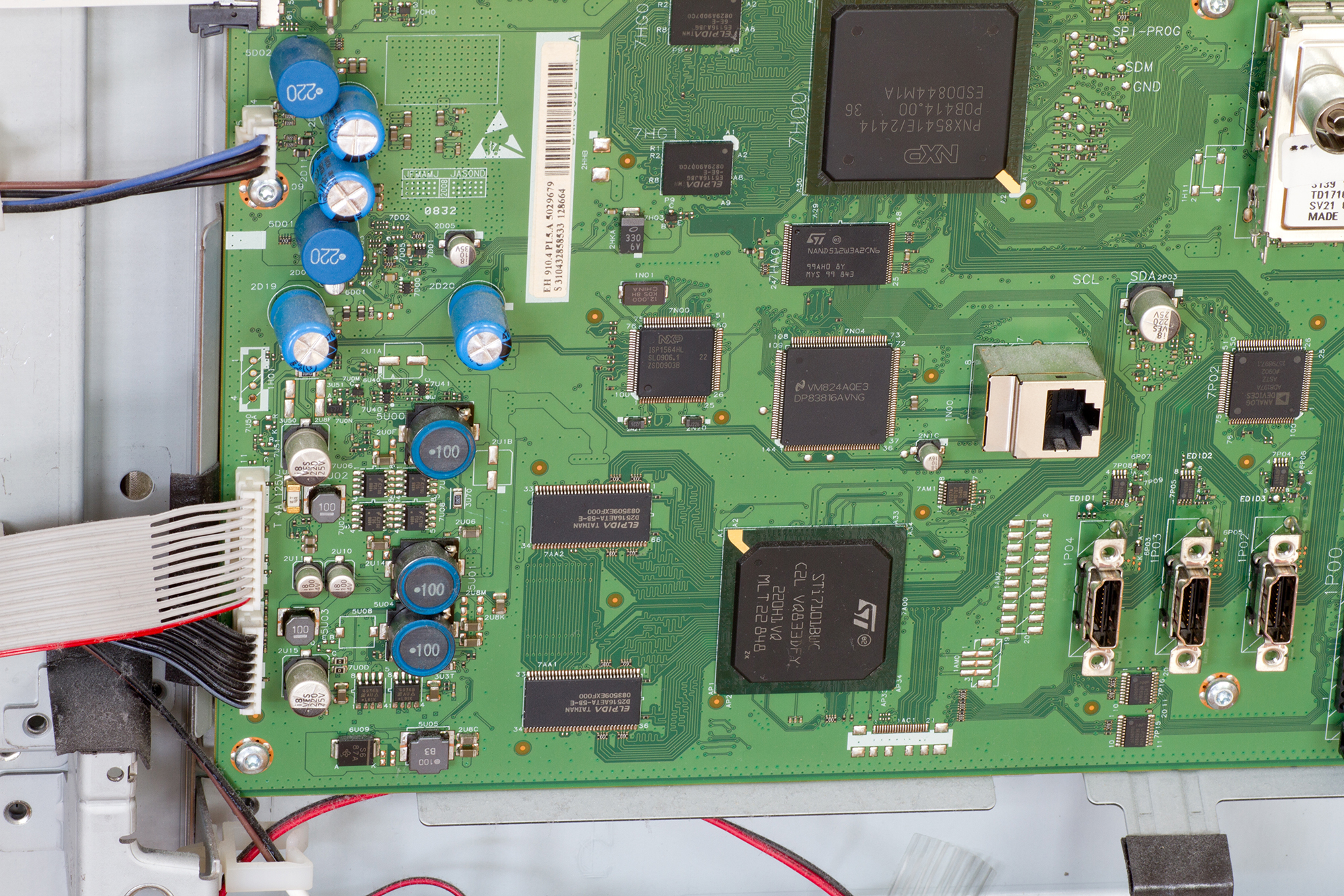

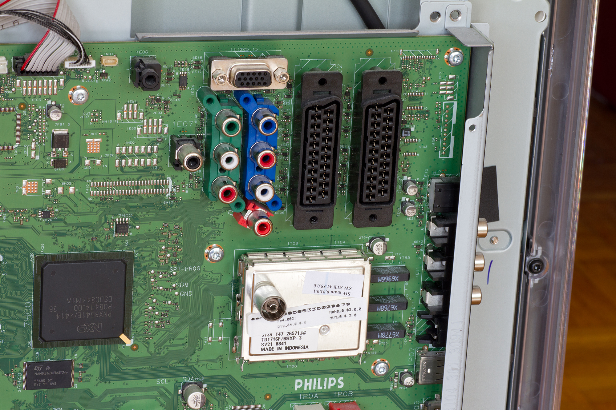

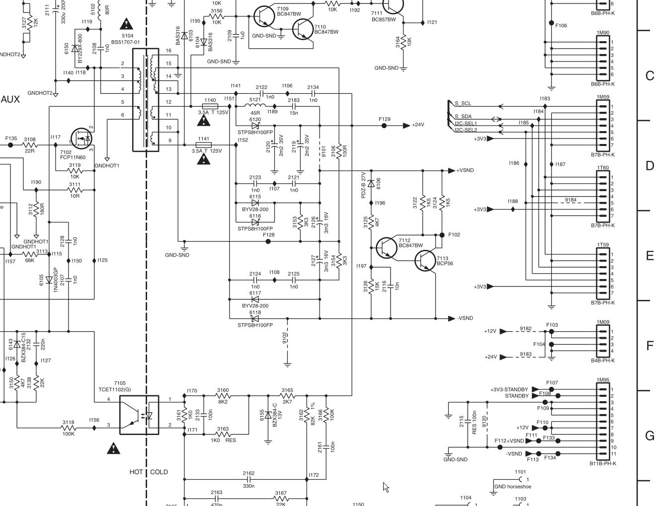

                I don't have the board out at the moment, but here are some crops of the front and the back of the board as well as part of the block diagram from the service manual.
                12V is provided on pins 6 to 8 on the 1M95 connector.
                Can you tell from those images if there are any components I should pay special interest?
                I will remove the board and take some pictures of the back sometime but won't have time to do it today.
                Please let me know if there is anything I can test before I remove the board again (i.e. whilst all the leads are still plugged in).
                I have tested the main fuse on the front and the two SMD fuses on the back and they are all OK.
                I have also tested at least some of the diodes but probably not all of them.
                The bridge rectifier should be fine (but then again, if it was not, then I suppose I would not get the 3.3V standby power).

                  Are you getting 24v? it looks like 12 and 24v are both derived from the same source. 3v3 is off another transformer. If no 24v either check resistor 3147 supposed to be 150K supplies vcc to pin 8 of driver ic, there should be at least a couple volts (3v3?) present to pin 8. If that is ok I would check the fet 7102 (carefully!! 160v present when energized)
                  • Globulus
                    • Sep 2013
                    • 20
                    • Denmark
                    If I probe the 9045 (ground) and 9048 (12V) jumpers with the power on, I am getting 12V (12.13V) if - and only if - the 1M95 cable is *not* attached. In this case the big transformer will give out an audible buzz all the time.
                    If I *do* attach the 1M95 cable, the big transformer will give out the same audible buzz but only for about a second, after which it turns into an almost inaudible buzz. At no time - not even during that first second - am I getting 12V on the 9048 jumper when the 1M95 cable is plugged in.
                    As for 1M90 (the 24V Ambilight connector), I am getting 24.something V if the 1M95 cable is unplugged. With the 1M95 cable plugged in, I am getting 2.4V.
                    Maybe I am not testing this right.
                    As for the 3147 resistor, it is located on the back and my problem with this is that I do not right now have a bunch of cables/wires that would allow me to test the board whilst removed from the back.

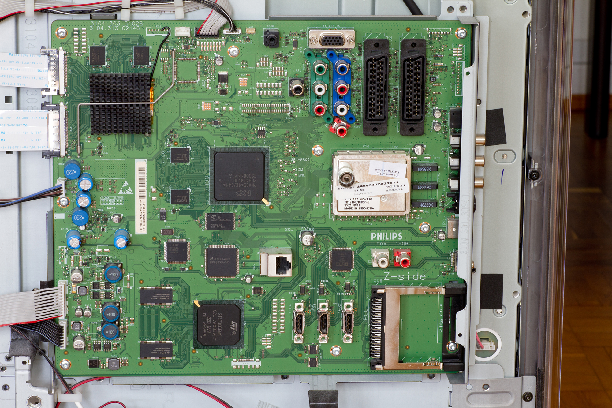

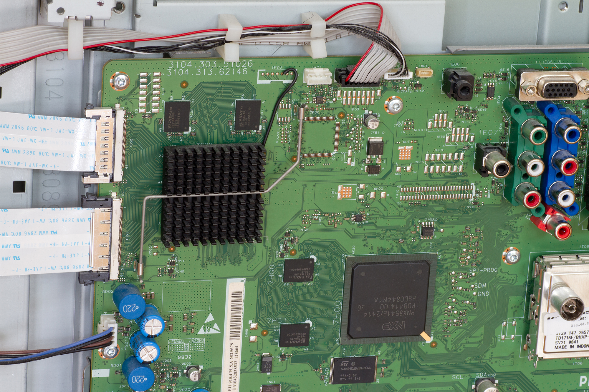

                        With the 1M95 cable detached from the PSU and SSB (i.e. both ends):
                        1M95 PSU side: 1.62 *K*Ohm between ground and 12V (6/7/8).
                        1M95 SSB side: 42 Ohm between ground and 12V (6/7/8).
                        Measurements taken with a $20 multimeter with a 200 Ohm - 20 M Ohm range. Not exactly a precision instrument but it will have to do.
                        I think I do have a 12V bulb somewhere but I do not think I have any cables for hooking it up. I really should get onto eBay and order a set of test leads + alligator clips.
                        • Caleb
                          Smokin IC's
                          • Feb 2013
                          • 645
                          42 ohm is really low, you need to start looking at the ssb. If it was me I would hook up a 12v 500 milliamp power supply (wall wart) tied to 12v and ground and freeze spray the board, then see what melts the fastest. Generally it will be your short. However most of that board is fine pitch stuff, if you can prove the fault into the ssb you might be better off getting a replacement. I would bet its probably one of those tiny fets 7u05, 7u08, possibly driver chip 7uoa, or maybe 7u02 or 7u06. I suppose it could also be a short on 2u14 or 2u0y capacitors but pretty unlikely -schematic is on page 96 of the manual.
