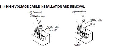

    Right now I'm working on getting the board that the convergence IC's are on out of the TV. I have everything disconnected except the wire leading from the flyback to what I guess is the tripler. I'm not sure if I can just pull it out, or if there's some trick I need to know.

    lift the rubber cap from the HV lead @ tripler then push down lead wire @ tripler and rotate 90 degrees

      Thank you RON CET. That did it!

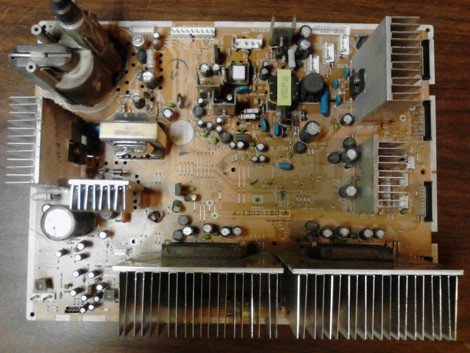

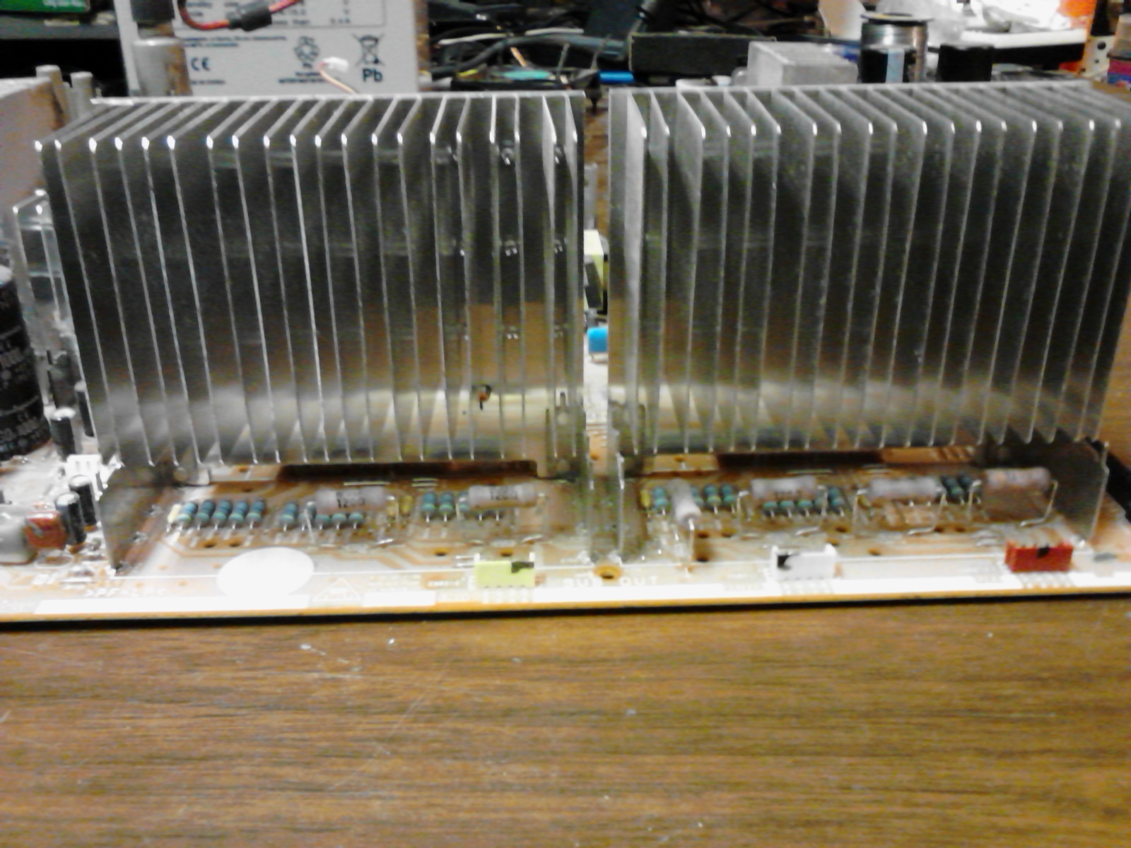

      Okay attached is a pic of the convergence board, and a shot of the area that I believe I need to focus on.
      The convergence IC's are STK392-560 IC's
      I see various ELNA branded capacitors near the IC's. Far as I know, ELNA caps are all right.
      There are 6 big resistors under the heatsink, 120 ohm, unsure of wattage rating.
      So I'm wondering where to start, and if it's possible to test the convergence IC's with my multimeter to see if only one is bad.
      Also wondering where the pico fuses are.

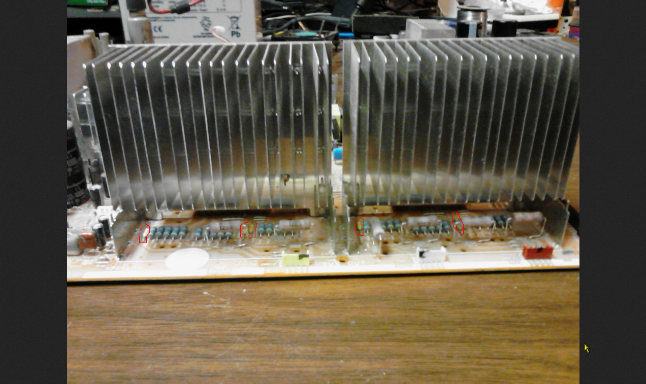

        most common would be replacement of both convergence ic's also check all those pico fuses,I think there the yellow(I attached your drawing and circled them) I think there's total of 4 also can't tell from the photo but those 120 ohm resistor look to be have been exposed to stress they look discolored,I also have the service manual if needed

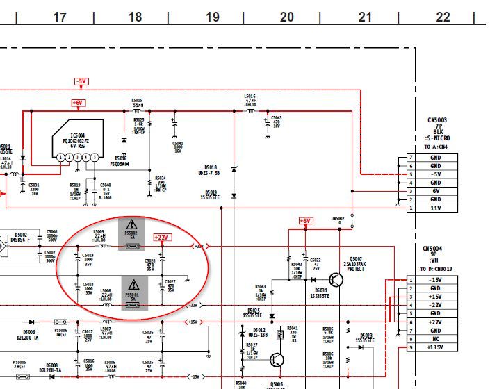

                      Those other 2 pica fuse your referencing to are on the "G" board see attached
                      If one or both of theses fuses are open naturally would suspect convergence IC's cause these fuses are connected to the +/- 22 volt rails to convergence ic.

                        Thank you. I found two orange pico fuses on the G board, and testing them in circuit, I got 0 ohms.
                        Not sure where to proceed from here.

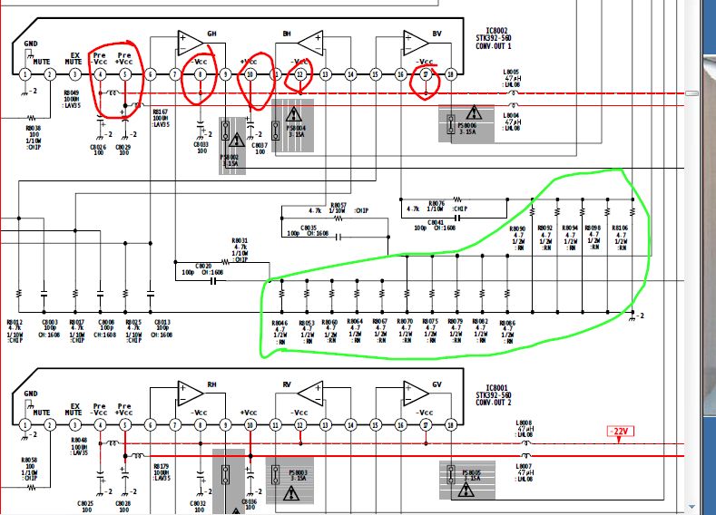

                          I would measure the +/- 22 volt supply to both convergence ic as i have circled in red and just make sure none of the 4.7 ohm resistor which are circled in green are not open from your yoke return to convergence ic if all that appears good i would then replace both convergence ic

                            The 4.7 ohm resistors, judging by what I can make out on that schematic are those all the blue ones that are under the convergence IC heatsinks?
                            • RON_CET
                              • Jun 2012
                              • 217
                              Re: Sony KP-57WS510 bad convergence
                              yes

                                All right. I'll desolder those and test them out of circuit. When I do that I'll reply with what I found.

                                  All right I've been thinking.
                                  Those resistors under the heatsink, they're all wired up in parallel in several banks. If one failed, that whole bank would fail. Testing in circuit across all the resistors basically nets me 0 ohms, so I surmise that the resistors are fine. I guess I'll know more if and when I can get those IC's, but it makes sense to me.
