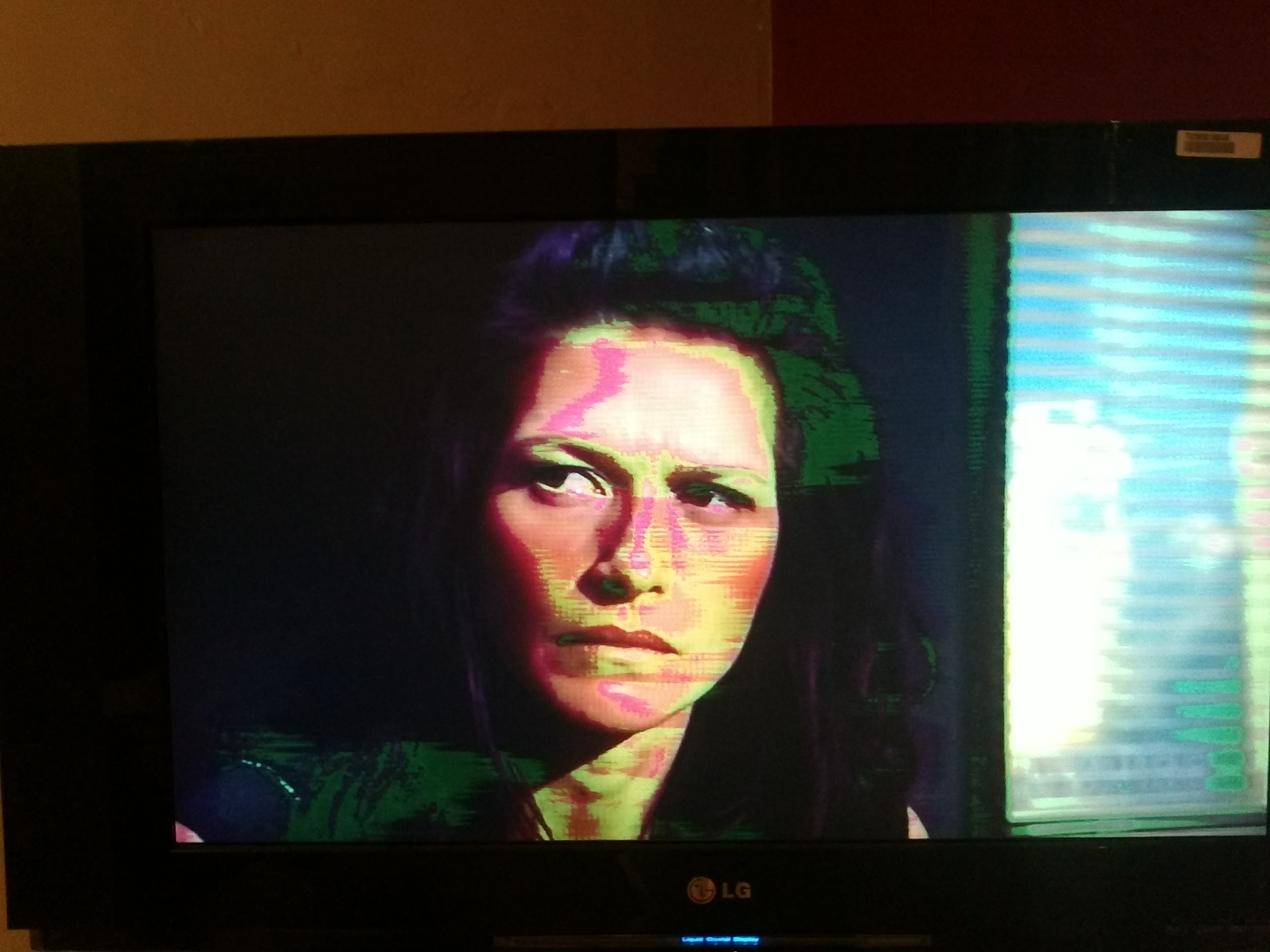

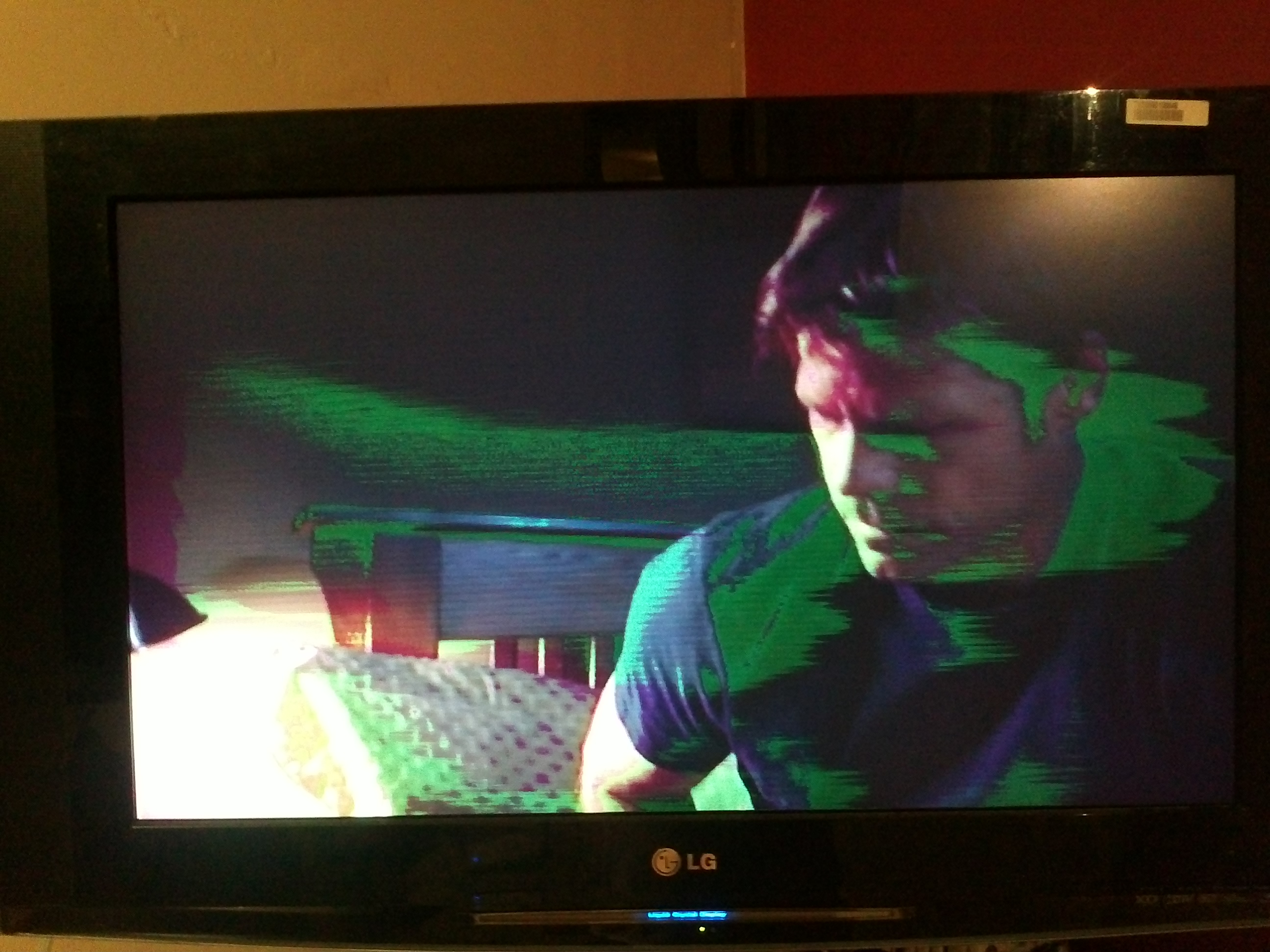

    Hi, I have an LG 32LX1D LCD TV with a convergence issue I think. The objects on picture look with green and magenta stripes on the right side.
    I don´t know which component is needed to be replaced to fix this issue.

    Re: LG 32LX1D LCD TV convergence issue
    Welcome, Cygnus23!
    Convergence issues are only related to CRT displays and some projectors.
    Do you have a good picture of the fault in question?

      Hi, thanks for answering. I attached 2 images of the screen.
        That is possibly a loose connector (LVDS connector between main board and t-con), or a bad main board or t-con board.
