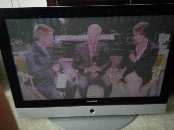

    Hey everyone,
    I'm thinking about picking up this TV for repair, but after dealing with this Panasonic that may have a bad panel, I'm just not sure. Here is a picture of the screen in action. Is this likely a bad panel, or a expensive/difficult fix? Thanks much!

    Looks kind of pinkish? not sure if its just the photo. But hard to say, I would guess X-main board.

        At first glance, I agree with Glitcher: Bad X-main. I'd check all the standard PSU and panel voltages to see how they look.
