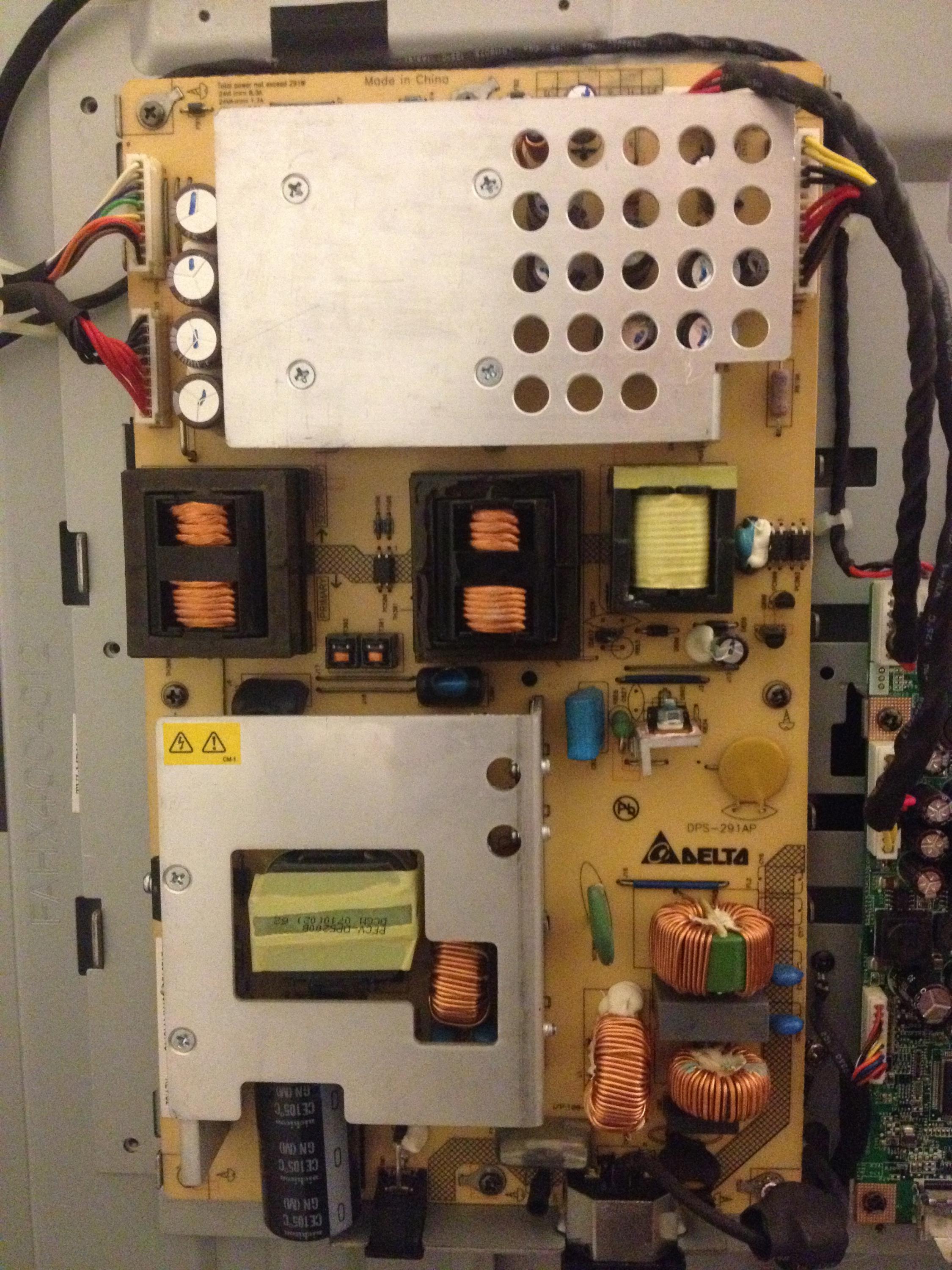

    The power board is a Delta dps-291ap, see this post.. https://www.badcaps.net/forum/showth...ighlight=delta
    Its a well built power supply with Nichicon caps throughout none look compomised. But the primary transformer buzzes pretty loud (is that normal?) The PFC is a 270uf 450V nichicon (I didn't check the series sorry) that looks slightly domed.

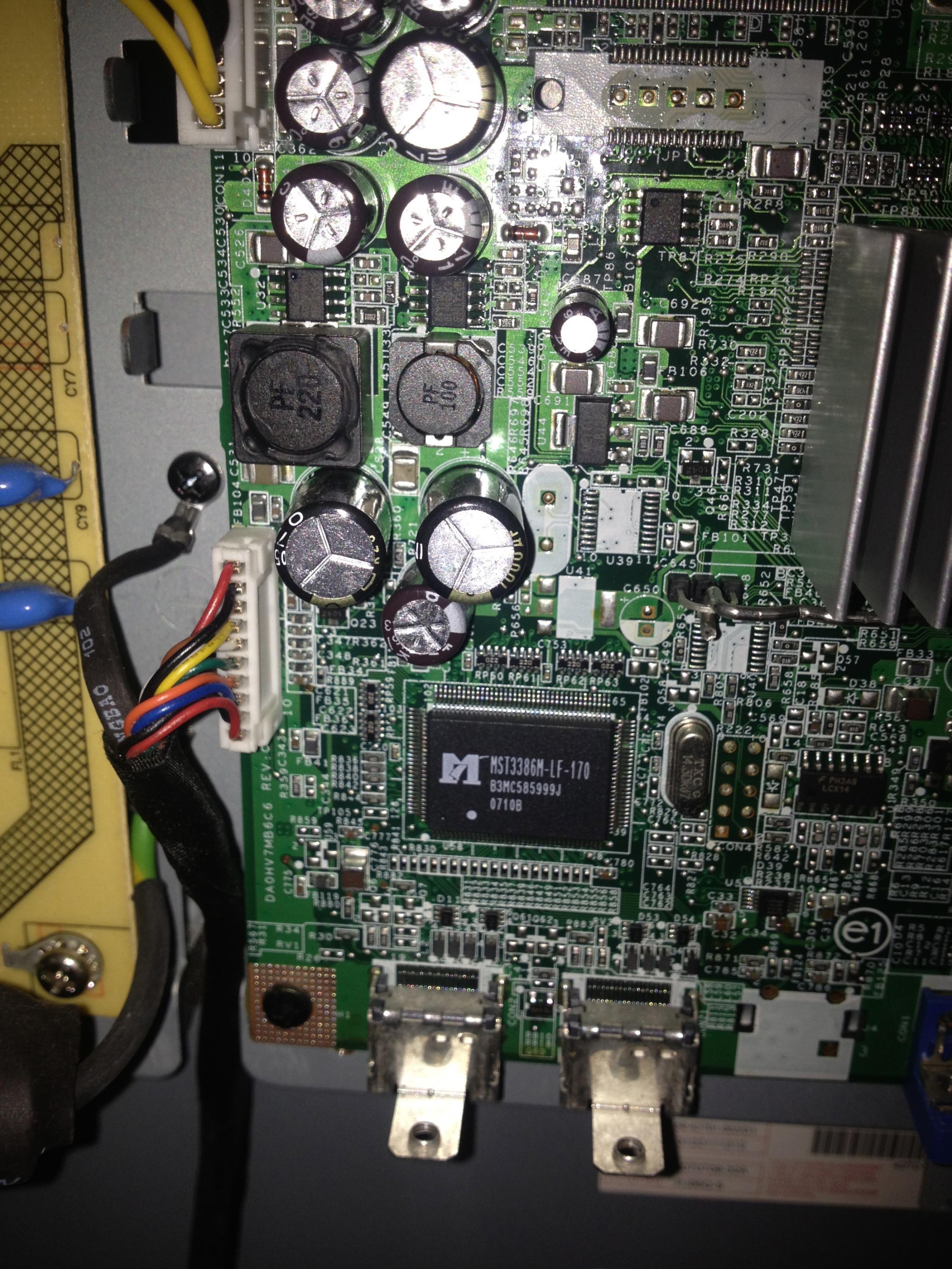

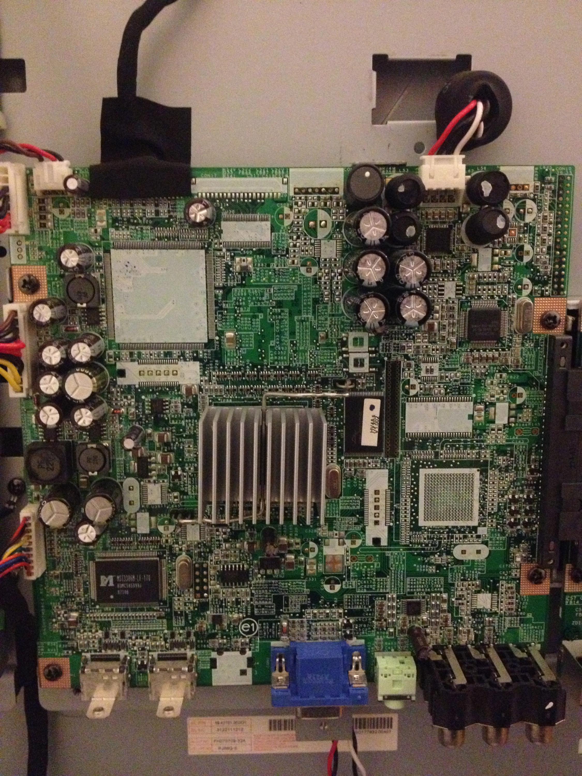

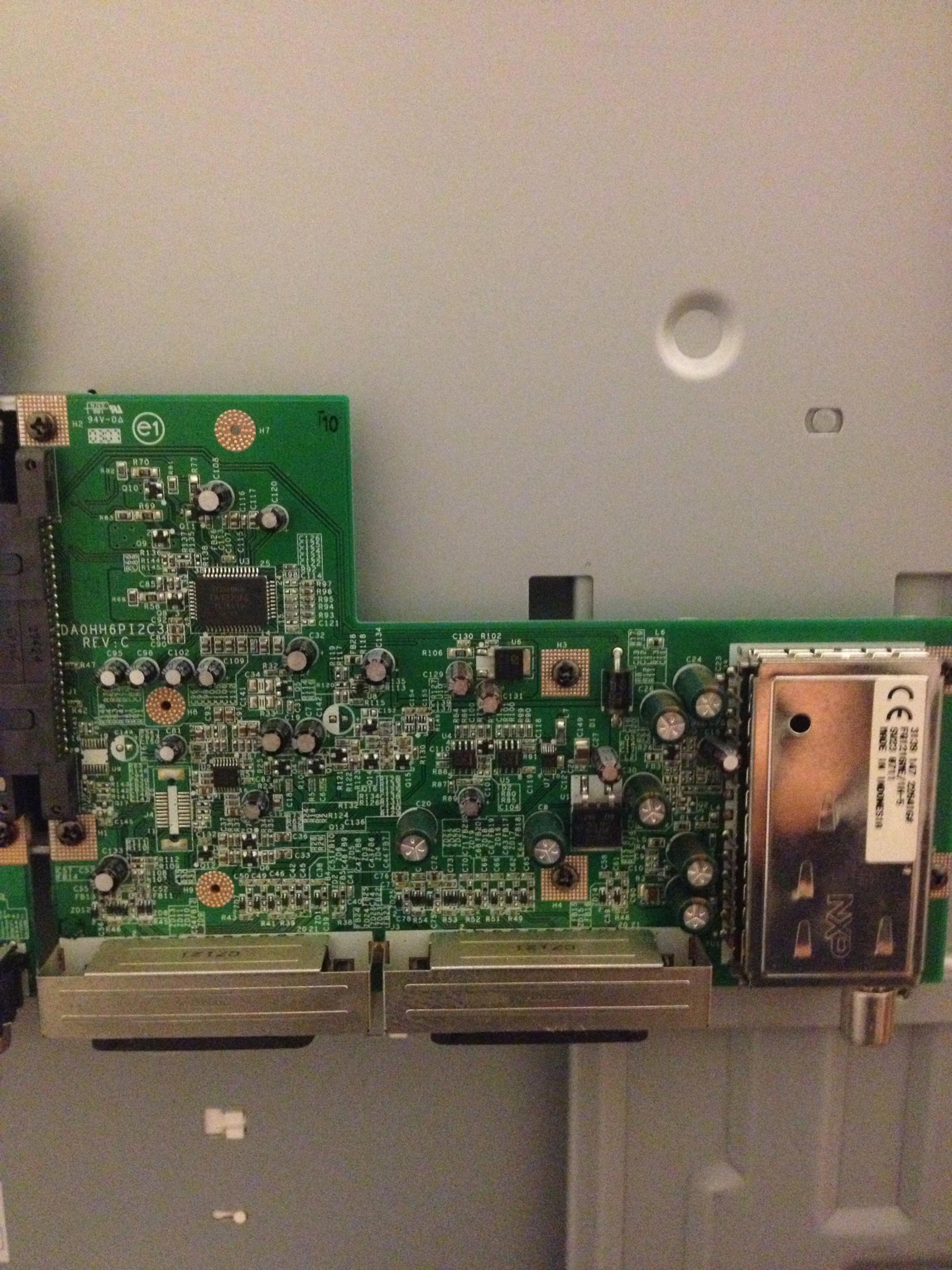

    The main & input boards are joined together by socket, and are scattered with Teapo caps (crap!!)

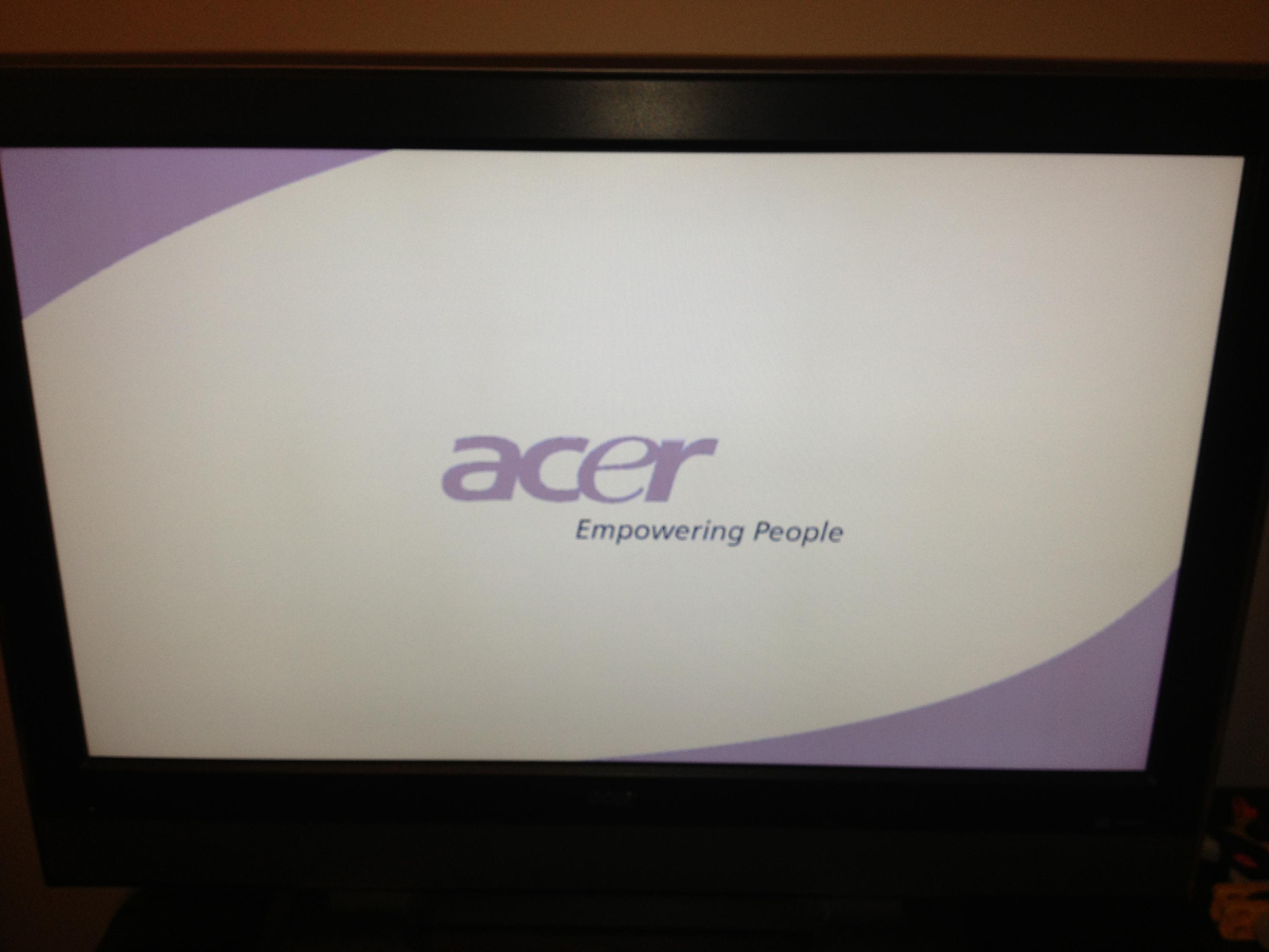

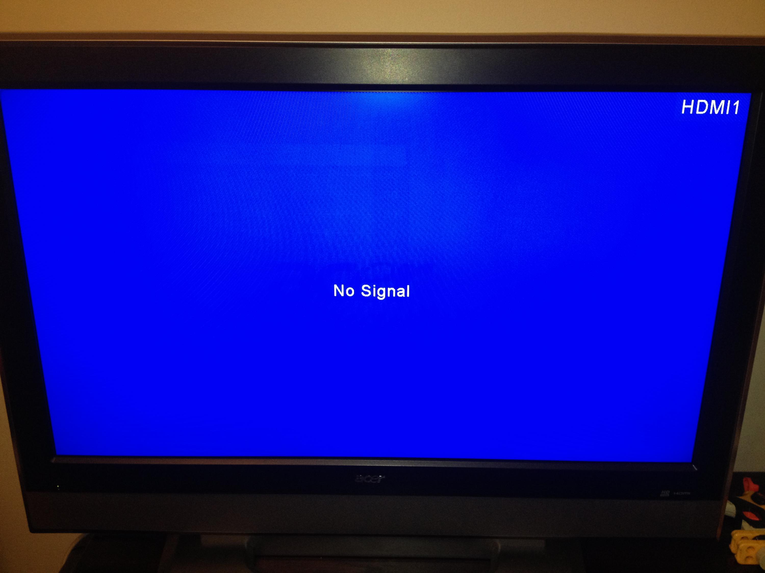

    When started up the Acer splash screen displays with grey instead of green colouring and goes brighter during that 5 seconds. The source blue screen with no inputs plugged in looks normal but if you bring up the menu it is totally washed out and barely readable. I have not tried any external sources yet but was told that it is like that in component also.

        So far I have tried reseating all cables. Will try hitting the main board with a hairdryer and/or freeze spray over the next few days to try and isolate the failing component.
        Have ordered all panasonic FC caps for the mainboard and am awaiting delivery of them.
        How do I test the main transformer that is buzzing? Should I re-flow its solder joints, as they look rather dodgy?

              I wish you had another main board to throw in there as I'm 90% sure your LCD panel is fine as is the rest of the TV, and that the issue lies on the main board.

                Ive been through the service manual, which has no schematics (attached). I'm about to recap the main board with quality pan fc's to see if that might help? Just in case it is an esr issue. Just a bugger of a board 55.M34V7.002 to locate in the right revision/configuration at a good price. This one has 2 x HDMI.
                Could a VR cause this kind of issue on a mainboard?

                  My power board also hums a bit - so prob nothing to worry about.
