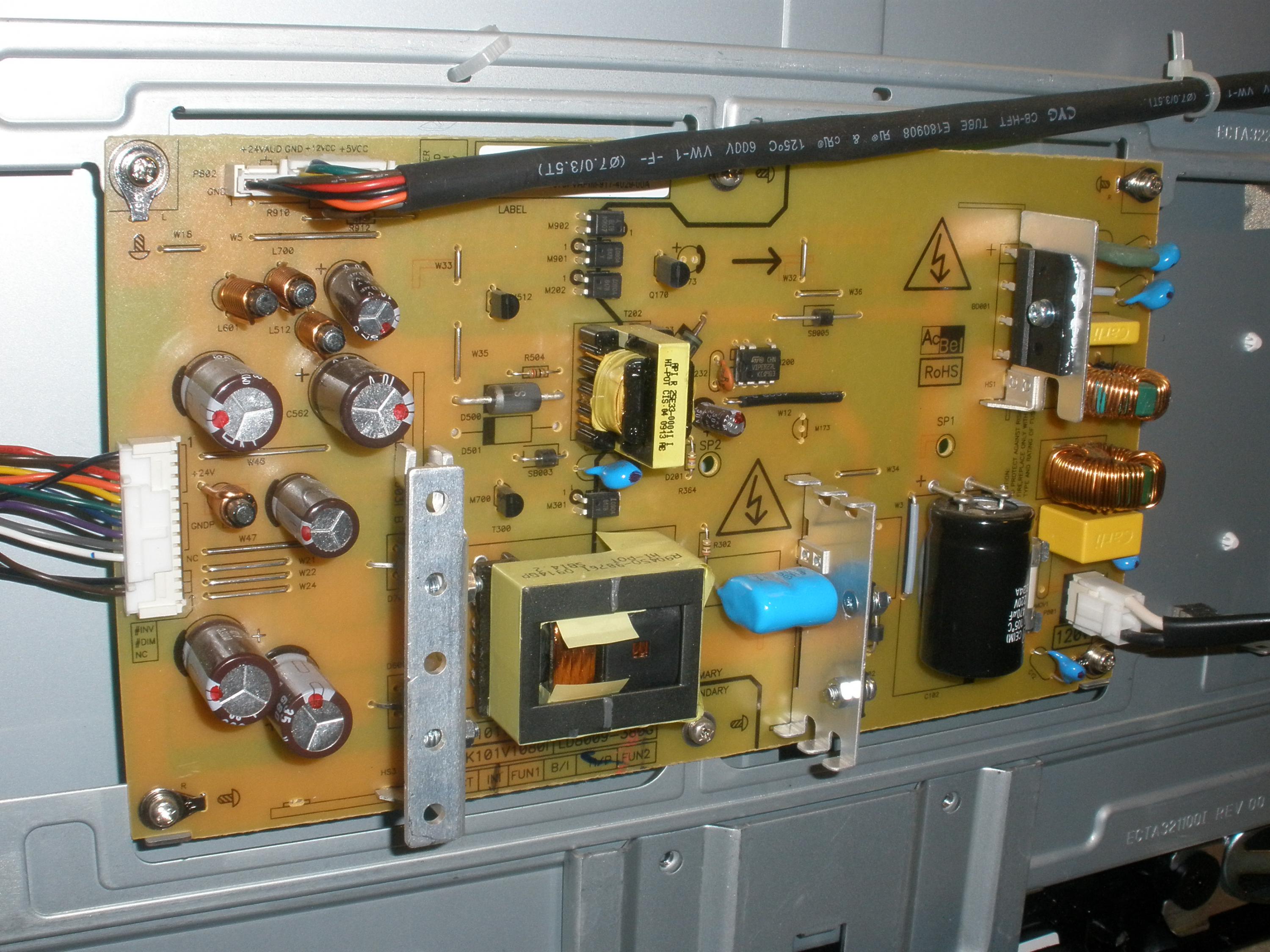

    Toshiba 32AV502R cycles on/off
    I have a 2009 32" Toshiba 32AV502R LCD TV that after a few minutes, starts to cycle on and off (sound and picture) every few seconds. The green led on the front flashes on, and it seems when the picture starts to appear, it shuts down for a few seconds, then the led comes on, pauses, the picture starts to show, and then it shuts down. I've done an inspection of the caps and nothing stands out.
    When it is cycling on/off, the power button on the tv and the remote will not work. I have to pull the plug to shut it off.
    When I have picture and sound, the 5vdc connections show 5vdc, but as the picture and sound disappear, it drops to around 1.5 vdc and then rises back to 5 when the picture and sound comes back, even if only briefly.
    When it all goes dead for a few minutes, the green power light slowly blinks on and off.
    I've attached a picture of the board.
    Any thoughts? Many thanks.
