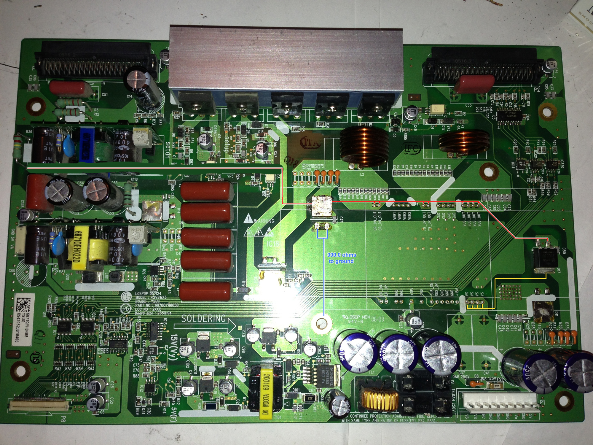

    I purchased a faulty LG 42PC1D in an effort to teach myself more about electronics.

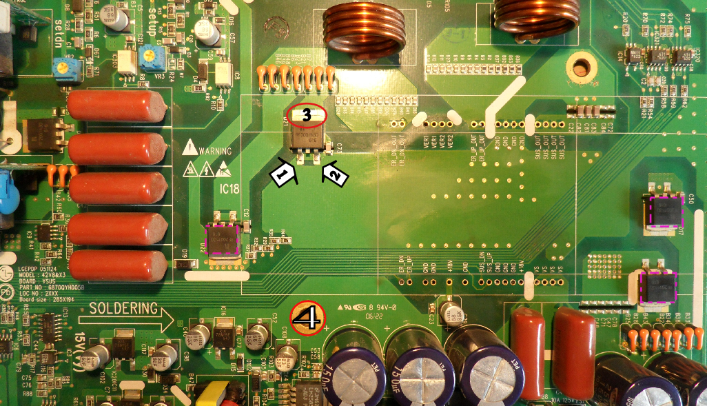

    The power supply had 9 bad caps which have been replaced and I also found a blown fuse on the YSUS. I have removed the IPM and have been trying to check some components as other threads have suggested the IPM might not be the only problem. In the picture attached there are 4x2001N3D Fast recovery Diodes that I have been checking. Am I checking these correctly?
    I check what I believe is a forward voltage drop between pins 3 and 2, and also between pins 3 and 1. On the 3 diodes marked with a pink square the readings are all virtually the same with a voltage drop of 0.326v, but when I test the diode with the pins I have marked (1,2 and 3) I get a voltage drop of 0.338v between pins 3 and 2 , and also 3 and 1. I would have assumed this reading was acceptable(if it was the only diode of this type on the board), but because I have 3 more of the same diode to compare to I have noticed a difference even though it is only 0.012v difference. I then checked continuity from pins 1 and 2 to GND(marked with a 4 in the attached pic) and found they both had continuity. I am assuming this is the probable cause of the blown fuse?
    Are my measurements and assumption correct? I'm curious as like I said early I would have measured the (suspect faulty) diode with a forward voltage drop of 0.338 and assumed it was ok and not checked anything else.
    Can anyone suggest an equivalent to replace this diode with?
    Any guidance is very much appreciated.

    You're most likely going to have to remove the diodes from the board to test them. I don't think you'll find issues with these diodes, though. The IPMs alone can cause the fuses to blow.

      Hi Nipz
      I just got done working on a board very similar to yours last week. (Also replaced 9 3300uf 10v capacitors on the power supply)
      Check positive lead on pin 1 negative lead on pin 3 (my reading was .392)
      Check positive lead on pin 2 negative lead on pin 3 (my reading was .392)
      Readings should be higher if taken off the board
      Check positive lead on pin 3 negative lead on pin 1 (should be OL)
      Diode D21 (the one you have numbered) pins 1 and 2 are connected to the ground plane. So you will have continuity.
      Can you post the numbers that are on the diodes? I was using diodes 20LC30
      Also check resistor R36 to ground, vs to ground, your fuse connectors to ground and check where you have continuity between your pins where the ipm was installed. Eg sus_out to vs should not have continuity
      I had a few funky things going on when testing since I had a bad D21 diode. I attached a picture where I had continuity after I removed the bad diode, before that I had continuity to ground at a lot of places I shouldn't.
      capkid helped me out as well
