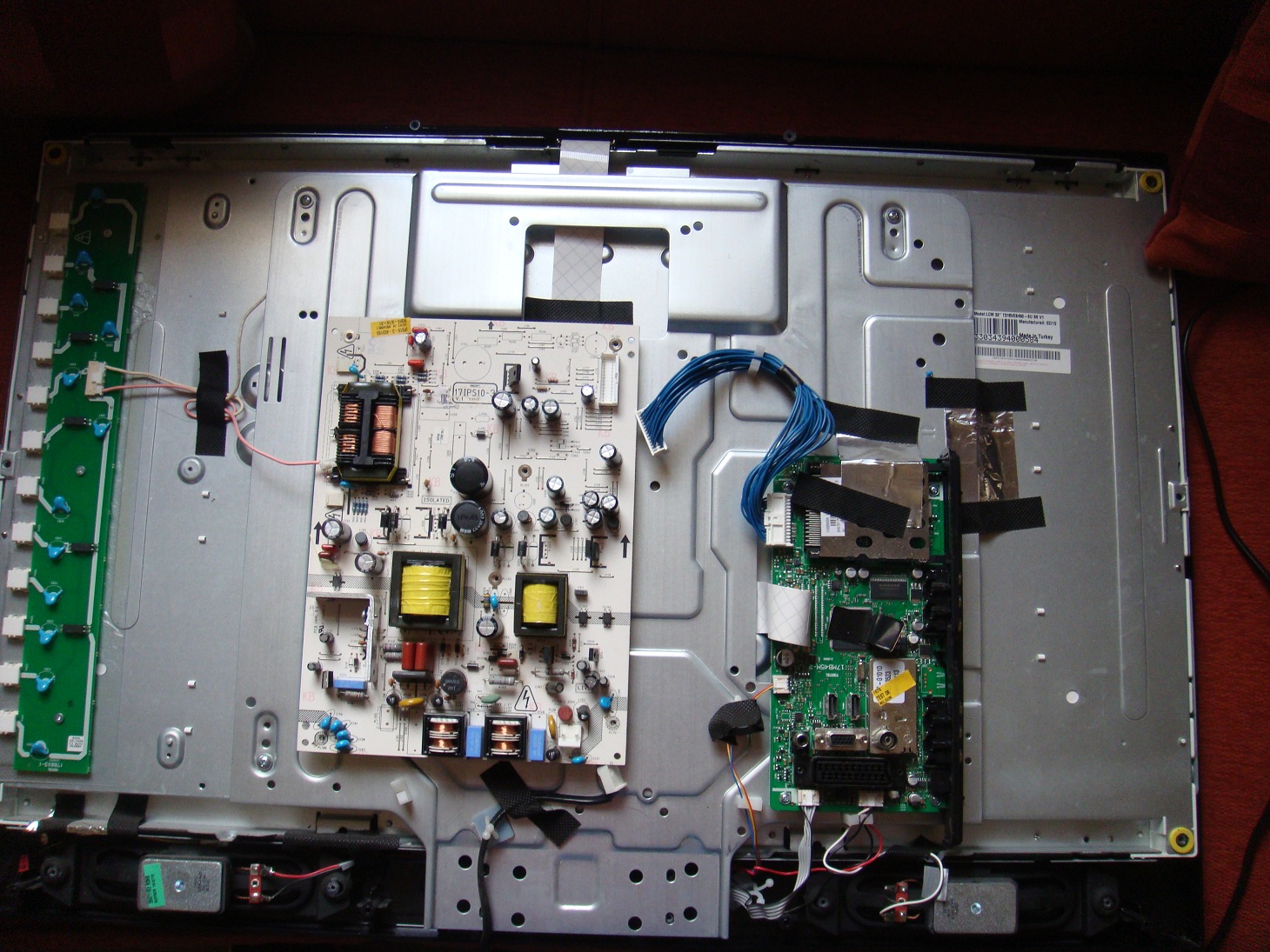

    Hello, I repaired it voudré lcd "OKI V32B PHTUVI" power card has 2 ps10-3 522989 tht6 Selkups 24/9 856/17 mb61-2 after having found four diodes fuse D116, D117, D152, D303 I I changed no sign of life, no LED Lighted except digital bibe, I noted the attention.
    3v = 2.75 approx.
    5v 12v yes yes 33 not help me to find fault thank you.

    Except digital "bibe", what is this?
    This is a VESTEL, the power indicator is often off when the set is powered on, and lit up in standby.

      hi "tom66",there is no standby no LED lights up, but when I finger the digital front there is a thank you sound bibe
        Re: lcd OKI V32B PHTUVI
        OK, this indicates the TV is probably powered up. Check the outputs of the power supply. Schematic for similar (not completely identical) version:

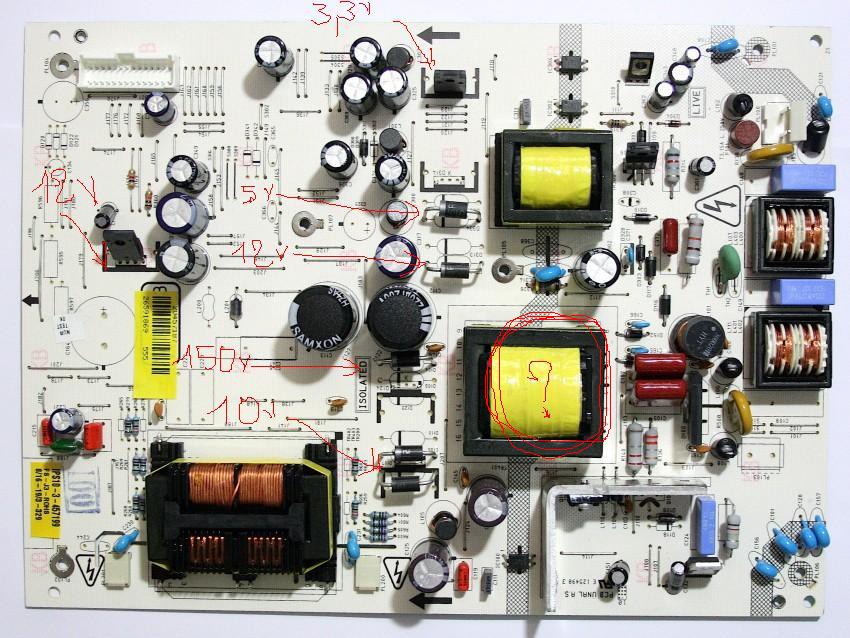

          hi "tom66", thank you for the diagram, I tested and I'll make you the answer.
          • soukehal
            • Dec 2012
            • 45
            • Algerie
            Here, I measured the voltage according to the diagram, I suspect the transformer TR100 and guilty
            D 104 150V
            D 105 10v ??? (24v!)
            D 106 10v ??? (24v!)
            D 312 12V
            D 334 5V
            D 813 3,3
            IC 307 12v
