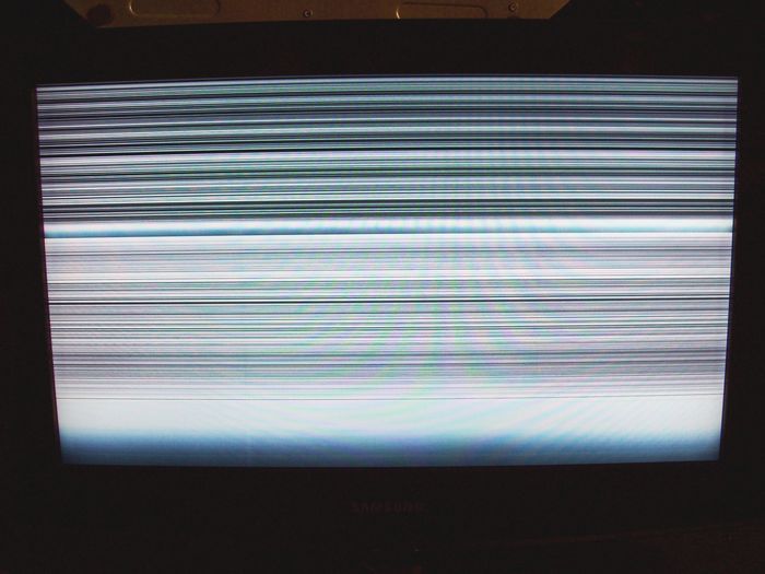

    Came into possession of a Samsung LN26A450C1D. Don't know much about the history except cosmetically the TV was well cared for. The first time I plugged it in and turned it on, there was the short Samsung power-on tune with the logo. Because I had no program source, there was no signal to replicate. I accessed the menu, but the print was jumping erratically and had a grayish ghost-like appearance. Turned it off. Turned it back on. This time the menu was inaccessible and there was just a dark gray screen, no functionality besides that. Turned it off. Turned it back on. Now there was horizontal streaking, no functionality besides that. Lastly I tried connecting an antenna to the TV, but that made no difference. I should also note that the on-set power button doesn't seem to work, so I am presently only able to use the remote control.
    I am attaching a picture of the horizontal streaking. Please advise me what you think the problem may be and where I should begin looking to repair it. Thank you!

    I've examined the boards and observed no bulging or leaking capacitors and saw nothing else that indicated a burn-out or other suspicious cause of failure. The caps on the PSU were replaced per the Samsung class-action. Unfortunately, the TV still responds as I described earlier with the horizontal streaking, except it now is more responsive when the power button is depressed.
    As before, when commands are delivered to the TV via the bezel or remote, the screen darkens as it receives the commands.
    Is the more likely suspect in this case the t-con board or the main board? I could repair or replace either, but would like to know the more likely of the two to save some $ and time

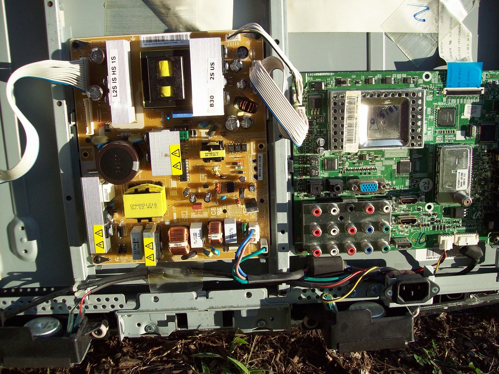

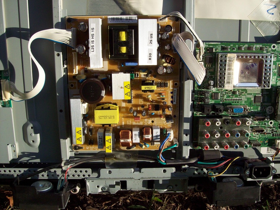

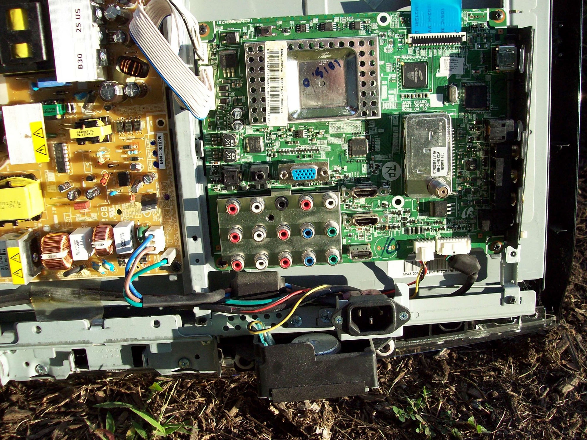

          I'm including some photos of the boards. Had to wait until today, as this has been the sunniest day in a while
          What diagnostic and/or repair steps would you suggest I take next?
            Re: Samsung LN26A450C1D Powers On And Off... And That's Pretty Much It
            Check all voltage regulators.
            https://www.badcaps.net/forum/showthread.php?t=22231
            Check all power supply rails are stable.
            Try feeding unit test patterns such as vertical bars to see how the noise propagates across the display.

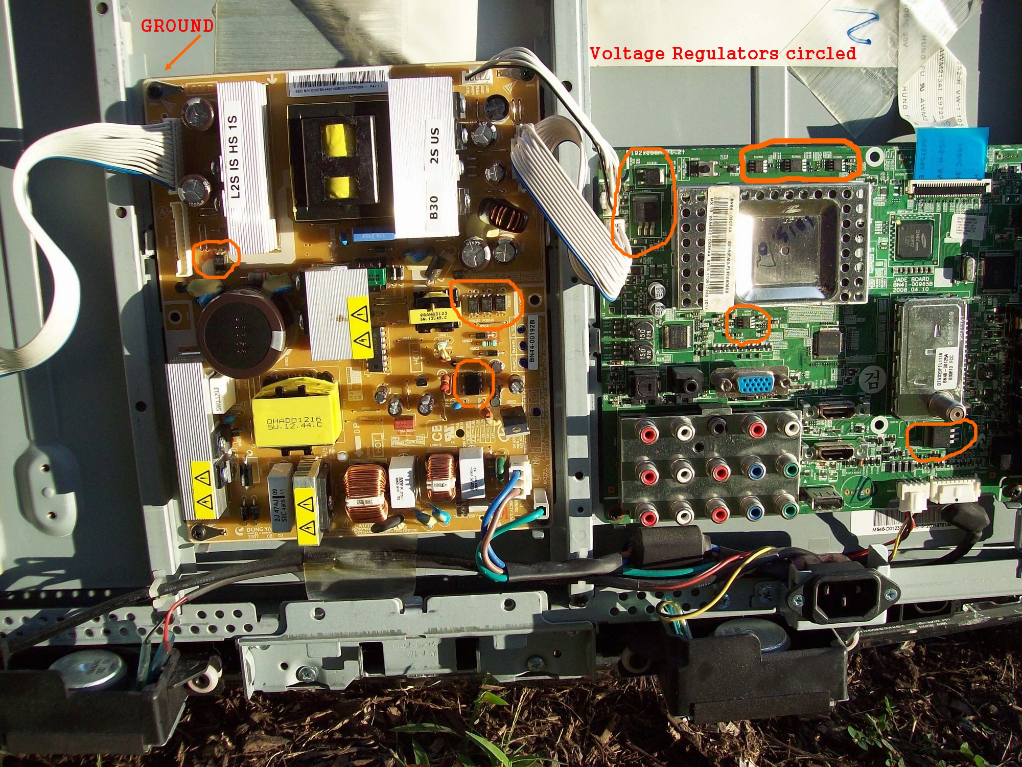

              I have my digital multimeter and am ready to test. Before I do though, please verify that I will be grounding in the correct area and that these are the voltage regulators I should test. I am attaching a picture depicting the target areas on the boards.
                Not quite... you've highlighted a few extra. See here:
                https://www.badcaps.net/forum/attach...3&d=1346045483
                Only test 3 pin + TAB. Do not test 5 pin + TAB.
