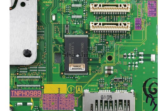

              I hope someone can help. My st50 had 8 blinks. First I replaced ss board, that didn't help, still 8 blinks. So I replaced A board next, blinks stopped, I get solid red light but no picture. Any ideas what's next? I saw on 7 blinks diagram that if no picture, replace su sd board. Is that what needs to be done or tv is no good no more?

                Exact model of TV and full view hi res photos of original A board and the new one so we can check if they are the same revision boards.
                Do you have a multimeter? Always a chance replacement SS board was dud. Where did you get that?

                  Exact model 55st50. When I replaced ss board in first place 8 blinks never stopped, so that's when I replaced A board. After I replaced A boarding was like, hmmm, what if replaced ss board was junk, so I went back to my original ss board. All same, no blinks now, just solid red light with no picture. Will make pictures tomorrow. Both of the replaced boards I got from eBay, different sellers, both claimed boards came from working tv
                    the fact you now have a TV which sounds like it is not even trying to turn on or error blinks makes me think it's the wrong A board or may have another issue.
                    hard to say, really need to fault find it more, a multimeter may help.
                    A board needs to be marked as the picturem rev UB
                    the pink highlights shows ho to work it out. from shopjimmy site
