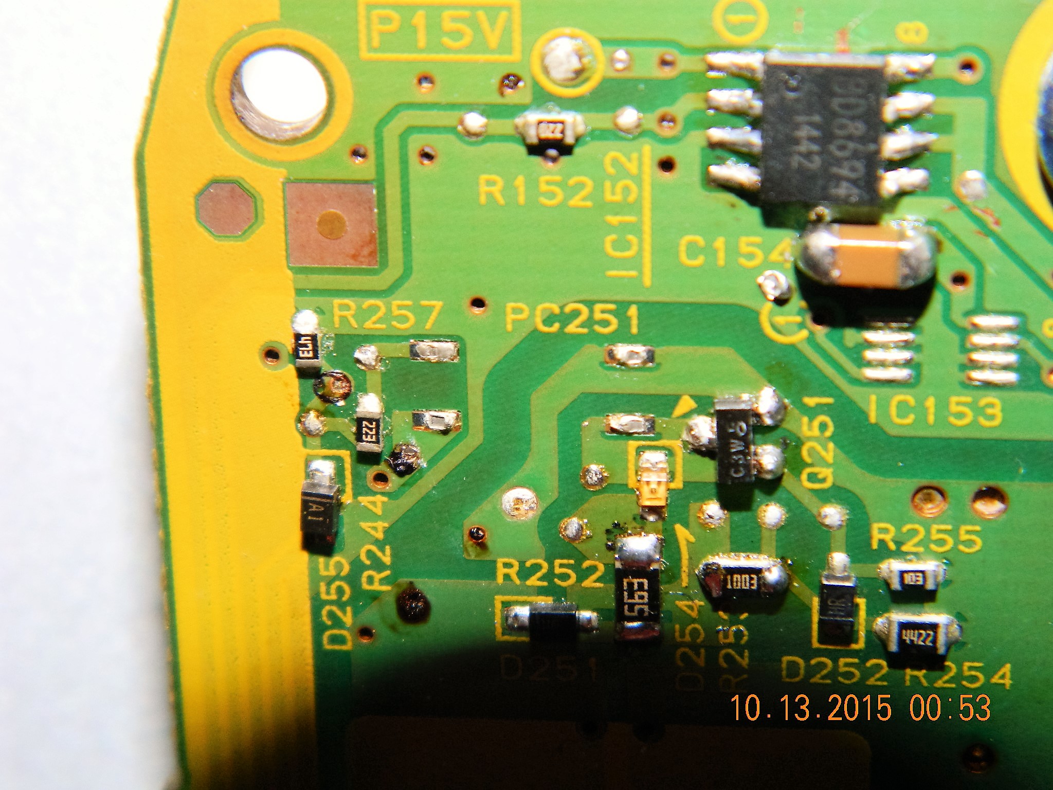

      Hello all
      I have a TC-50pu54 with the 8 blink problem.
      Replaced the transistor, diode, resistor and IC as per the shopjimmy repair kit
      No change. Sucks, thought I had a cheap tv to use. The resistor WAS blown, but everything else seemed ok. I do hear a faint buzz right before the power supply click off, its coming from the SS board. I can get a new SS board for $100.... might just try it

            Re: Panasonic TC-50PU54 8 blinks picture flashes then dead
            Originally posted by resinis View Post
            Hello all
            EDIT- hey, I do notice though, now after the 'fix', the panel does light up for a second before it clicks out again. I also did the TP101 test and it there is no short, the the A board should be OK. I think I just need to replace my SS board entirely...

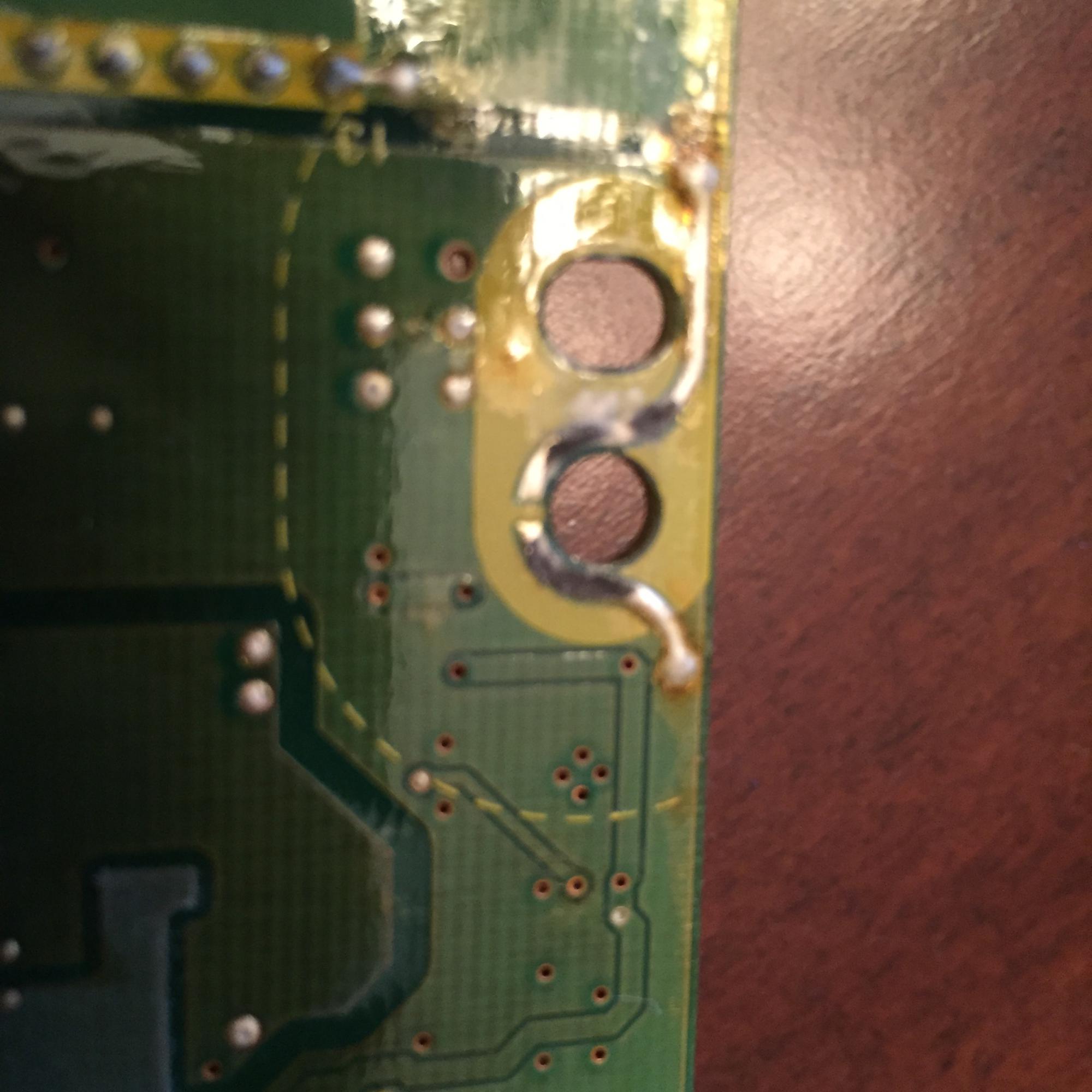

                  Sorry to intrude on an existing thread I'm not able to open a new thread for some reason. I have the tc-50pu50 with 8 blinks also and replaced the parts on the ss board to correct this and noticed that component PC251 broke off the board and is nowhere to be found, does anyone know what this component is? It is on the TNPA5623 ss board.
                    optocoupler, PS2701A-1-F3-A. Pretty common on the panasonic boards if you happen to have any old SS or SC boards that are scrap.
                    Broken off implies the pads are torn off too. could make it had to fix
                      Thankyou! the pads are still intact but you can see where the legs were soldered to the pads.
                        clean break, that's handy then. does look like someone has been soldering in there. Did you replace the Driver IC? Someone found after their new parts were installed it shorted agian needing the driver IC replaced to finish the job.
                          Yes, I replaced the driver, transistor, diode and resistor that comes as a kit but did not notice that the optocoupler was broken off. Thanks again.

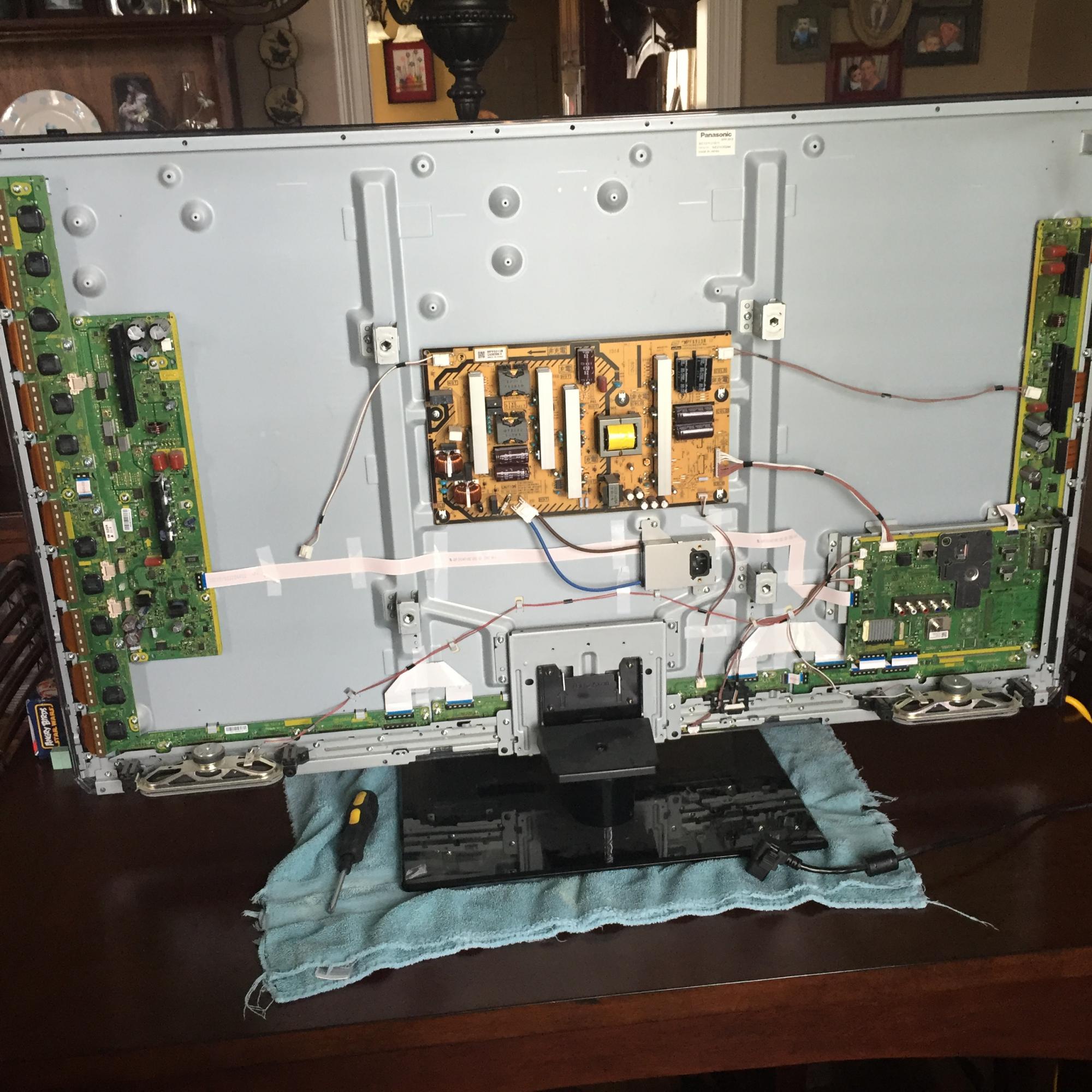

                                      OK I've pulled the SS board off and found that the top screw had scorch marks on it. Is it safe to assume that this board had grounding issues and is fried? I'm going to see the board off for repair, what screws should I get to prevent this from happening again?
                                        Took a couple pictures.
                                          looks just like all the others we often read about. Pretty much any panasonic Plasma 2011-2012 had issues with these bolts working loose on both sustain boards,
                                          The seller gives suggestions on what you need to do after you get the repaired board back to complete the job properly,
                                          Two options is to reuse those blts and put some loctite or threadlock on the threads or use the correct bolts which were in every Tv before 2011.
                                          http://www.shopjimmy.com/panasonic-x...-screw-kit.htm
                                          I would go with the new ones simply because if the solder lands compress at least the spring washer will expand but clean up all the scorch marks and check out the SC board too.
