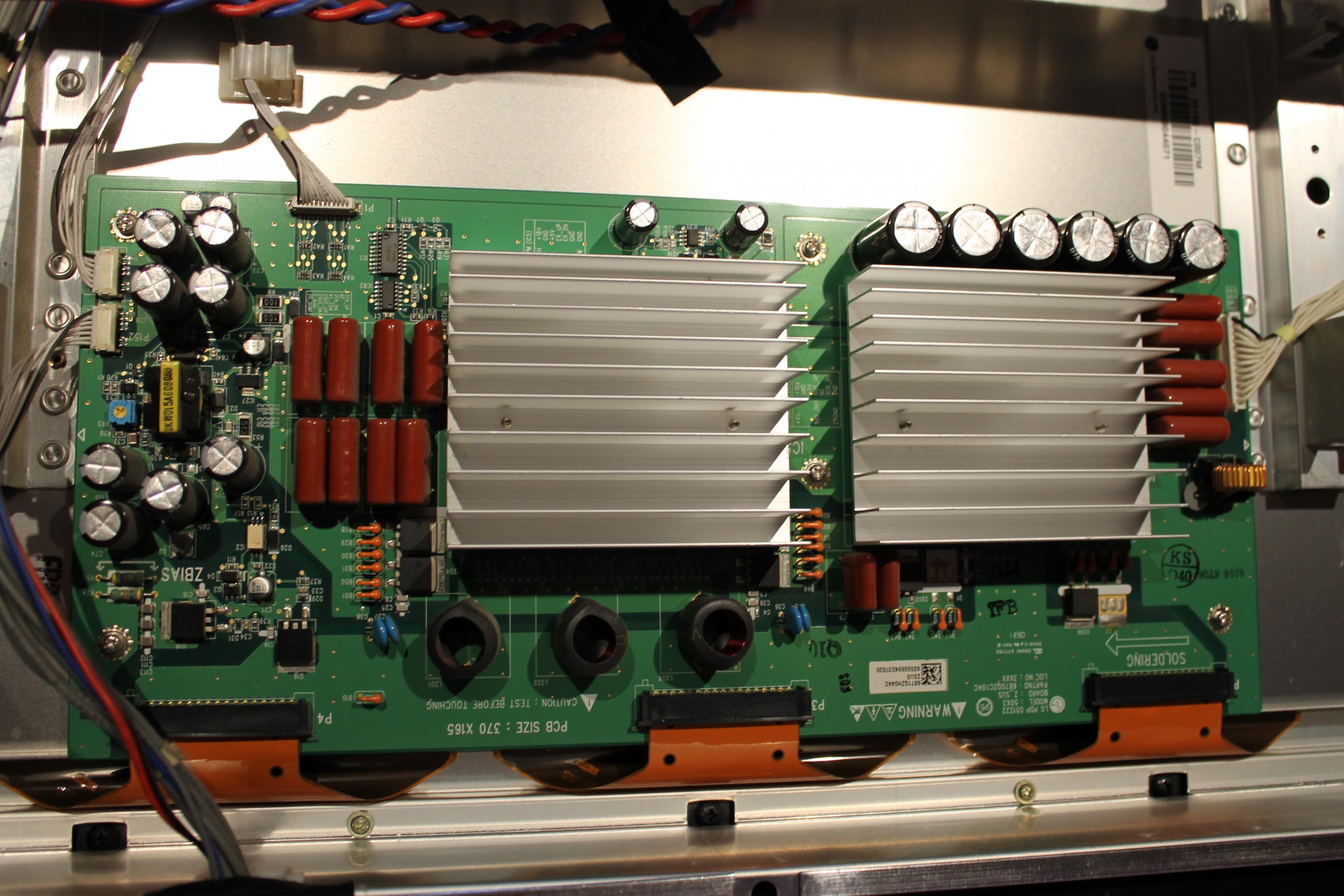

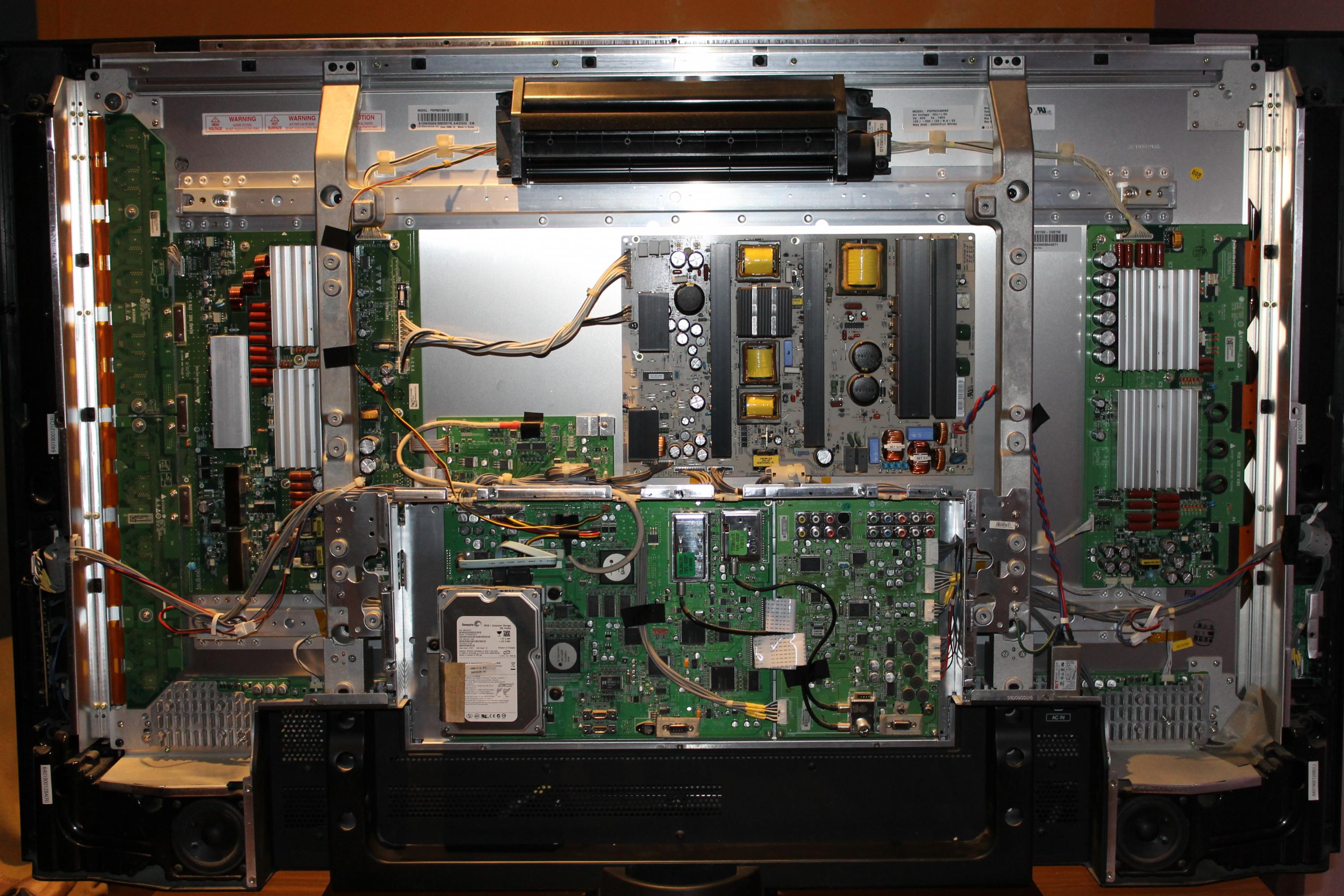

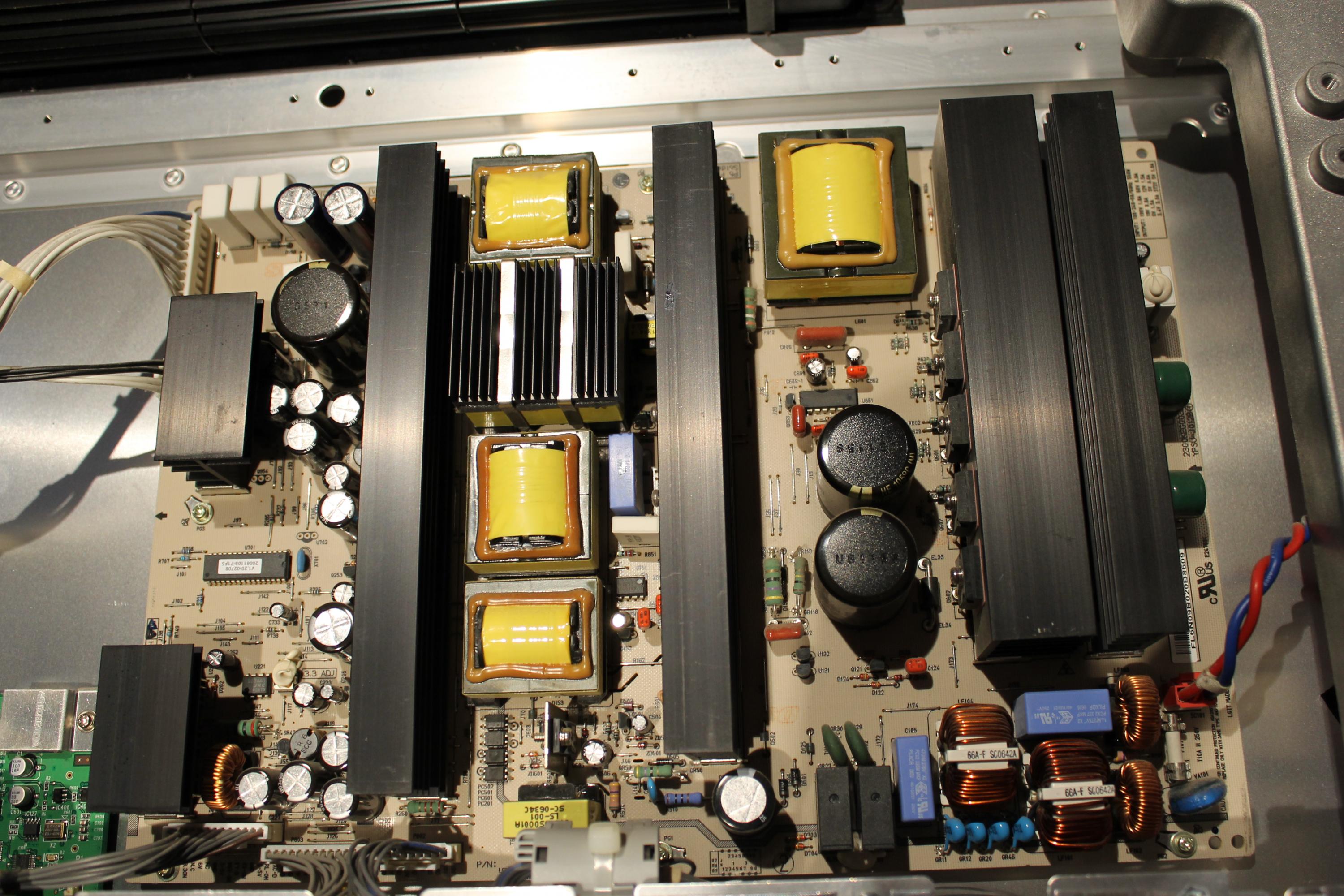

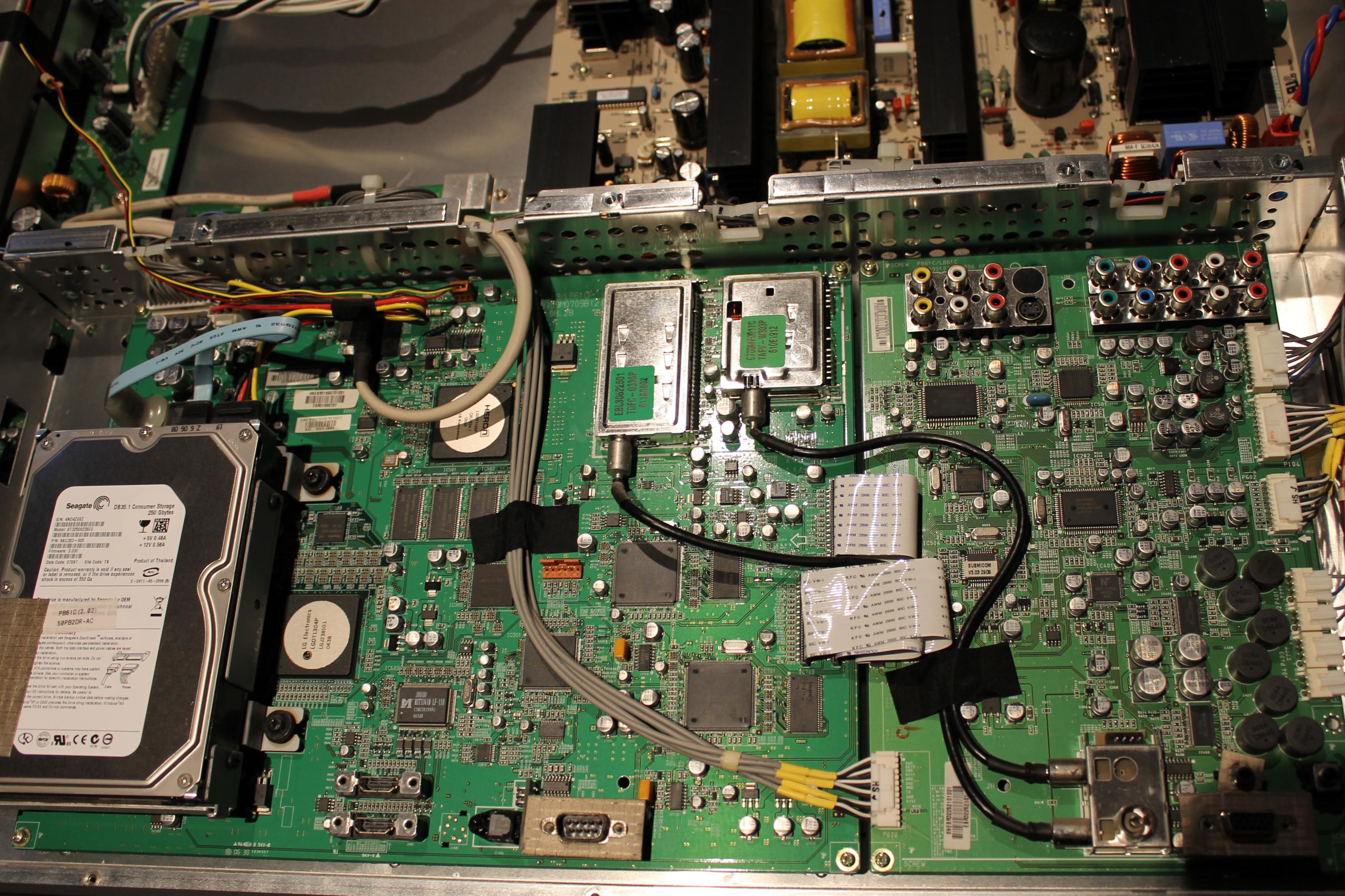

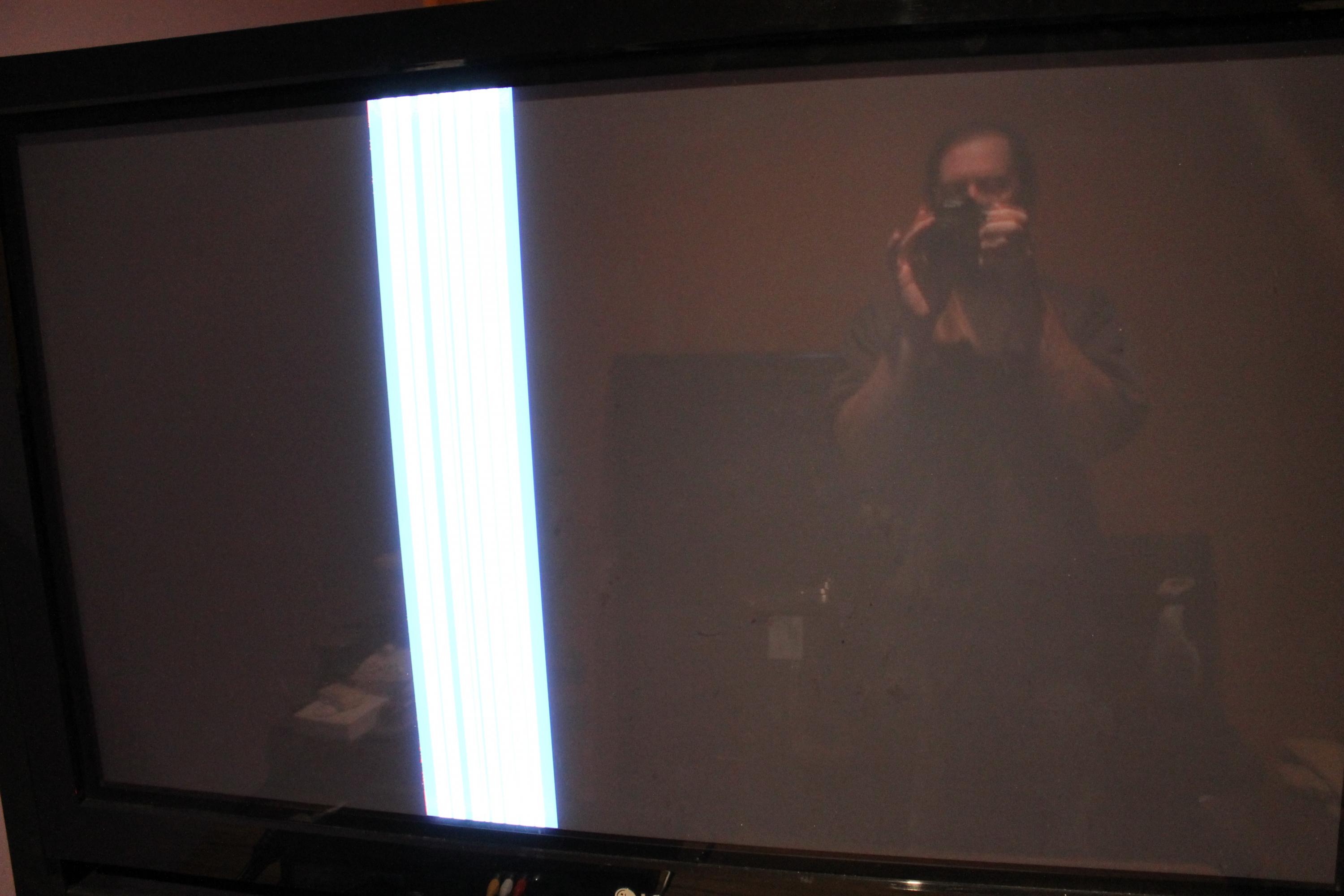

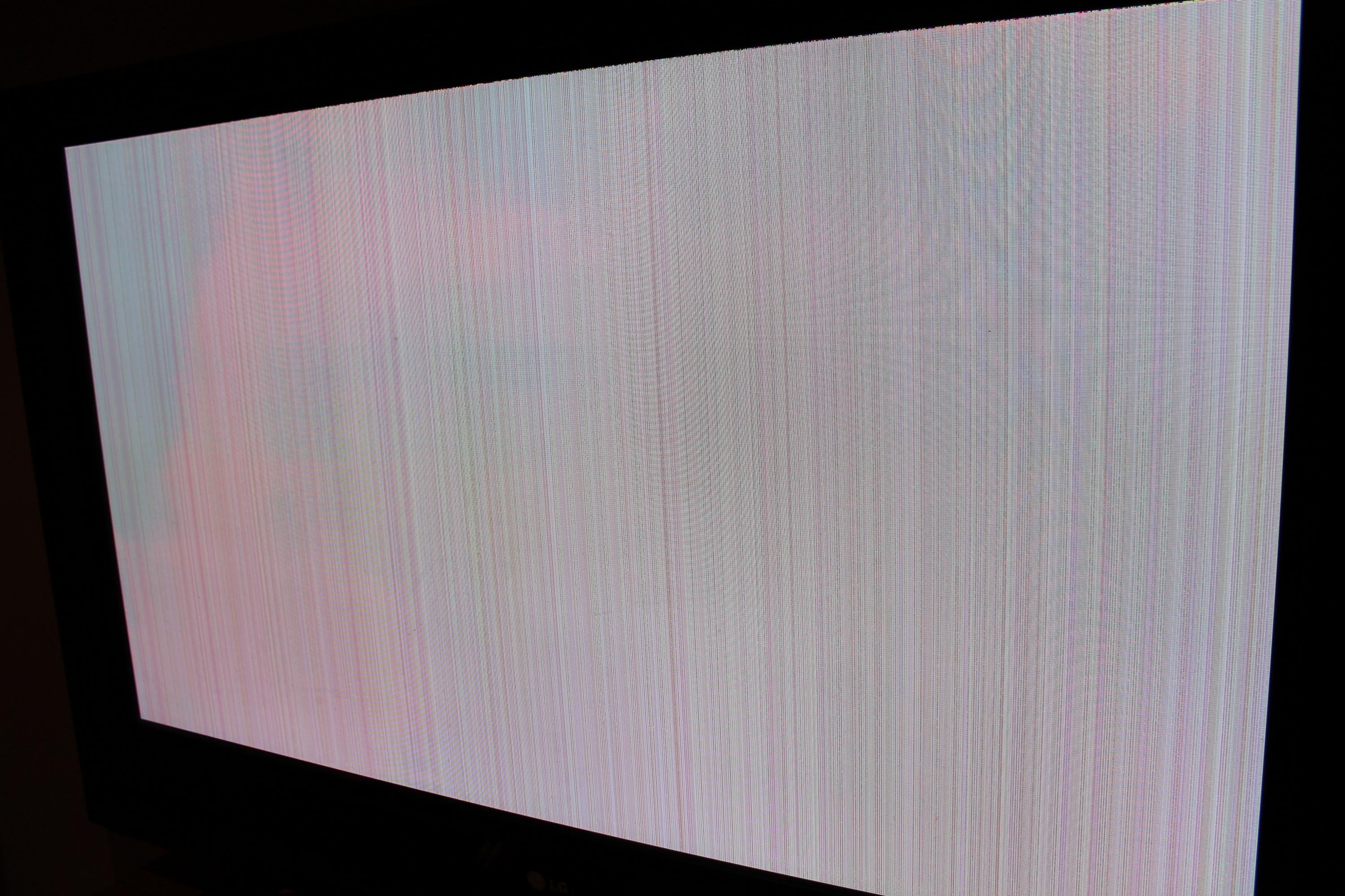

    so im finally going to try and learn how to understand these plasmas! be nice!

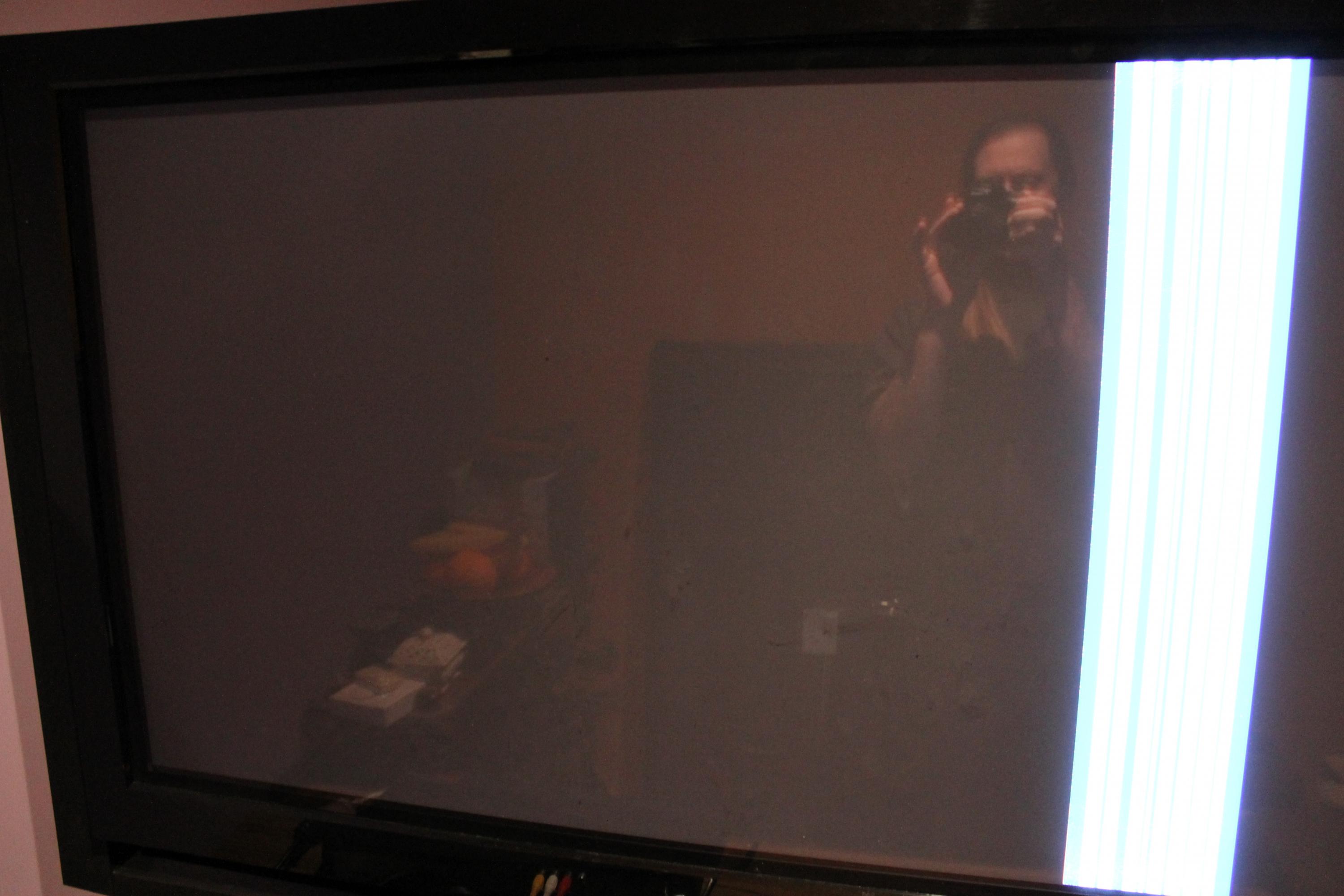

    this unit currently has vertical stripes running up and down the screen and moves slowly across the screen. since i dont know what is displayed, i cant tell which input i am on. still havnt got any sound from the speakers!
    the last pic, i managed to bring up something through the menu button.
    channel and volume selection slightly changes, distorts my funky lines!
    panel states
    va 60 i get 59.1 at p 805
    vs 192 191.9
    any help would be great!

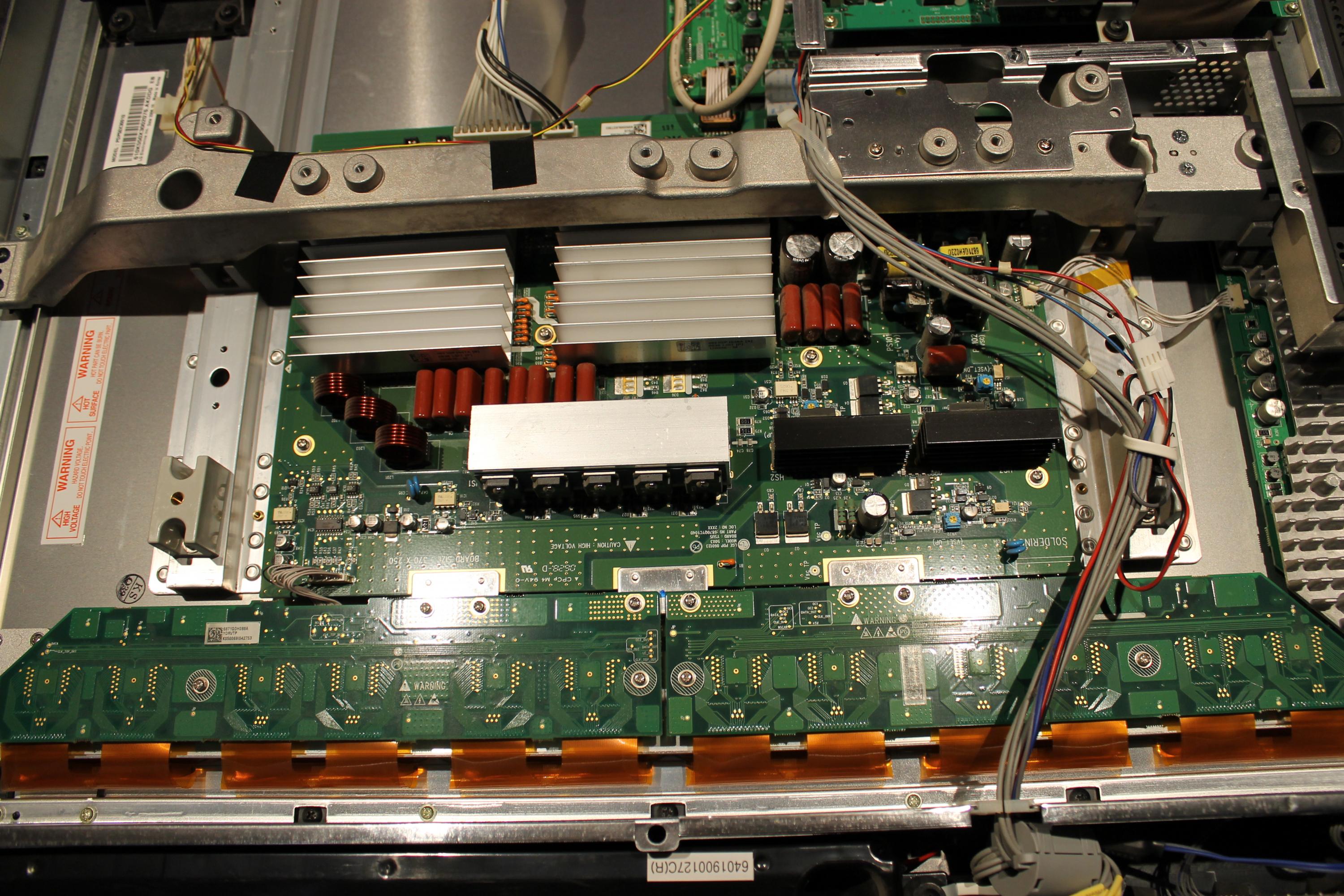

    You'd be looking at the buffer board on this one. A common failure is some FETs on the board -- surface mount devices. Often only the upper or lower fails. You can try running the set with one or the other disconnected.

      thanks tom, ill pull them one at a time to see if i can isolate which board and then test the other to see if is repairable.

        Like Tom said, most likely shorted buffer board. I've had that with and old 42V6. When it moves across the screen it's probably in TV mode and the small no signal that bobs around the screen would be what it's trying to display.
        That's what I worked out with that one and completely disconnecting the lower buffer from the Ysus and the interconnecting cable between the upper and lower gave me a perfect top half with that set.

          i pulled out the lower buffer board and now have a great looking top half.
          the fets have tested bad, i'll pull them out of circuit tomorrow and check the smd's!
          there is no visual defects with the buffer chips but ill check them over too!

              i received my mosfets today (fqb46n15) and swapped out the bad one.
              all up and running, on test now.
              thanks guys.
