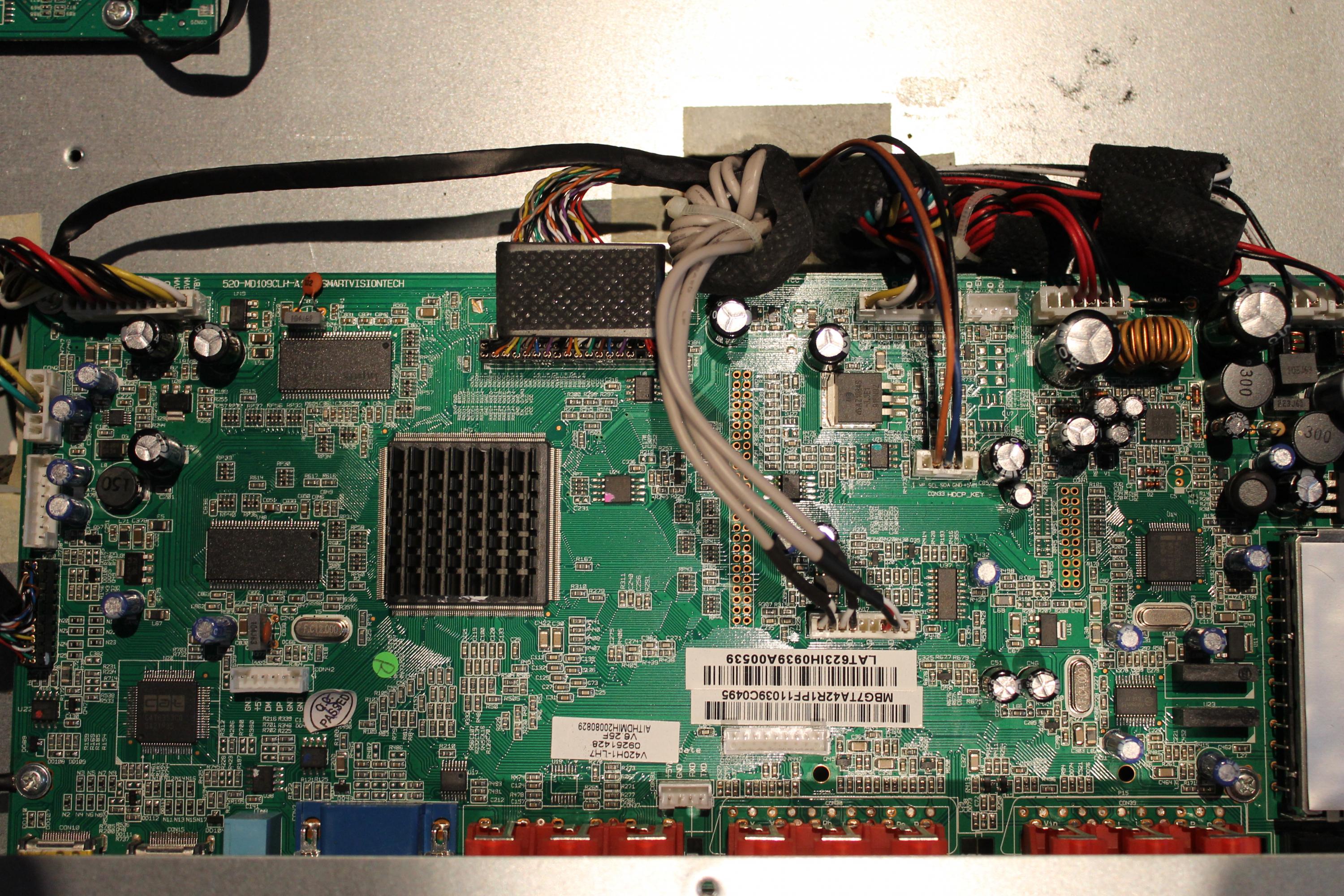

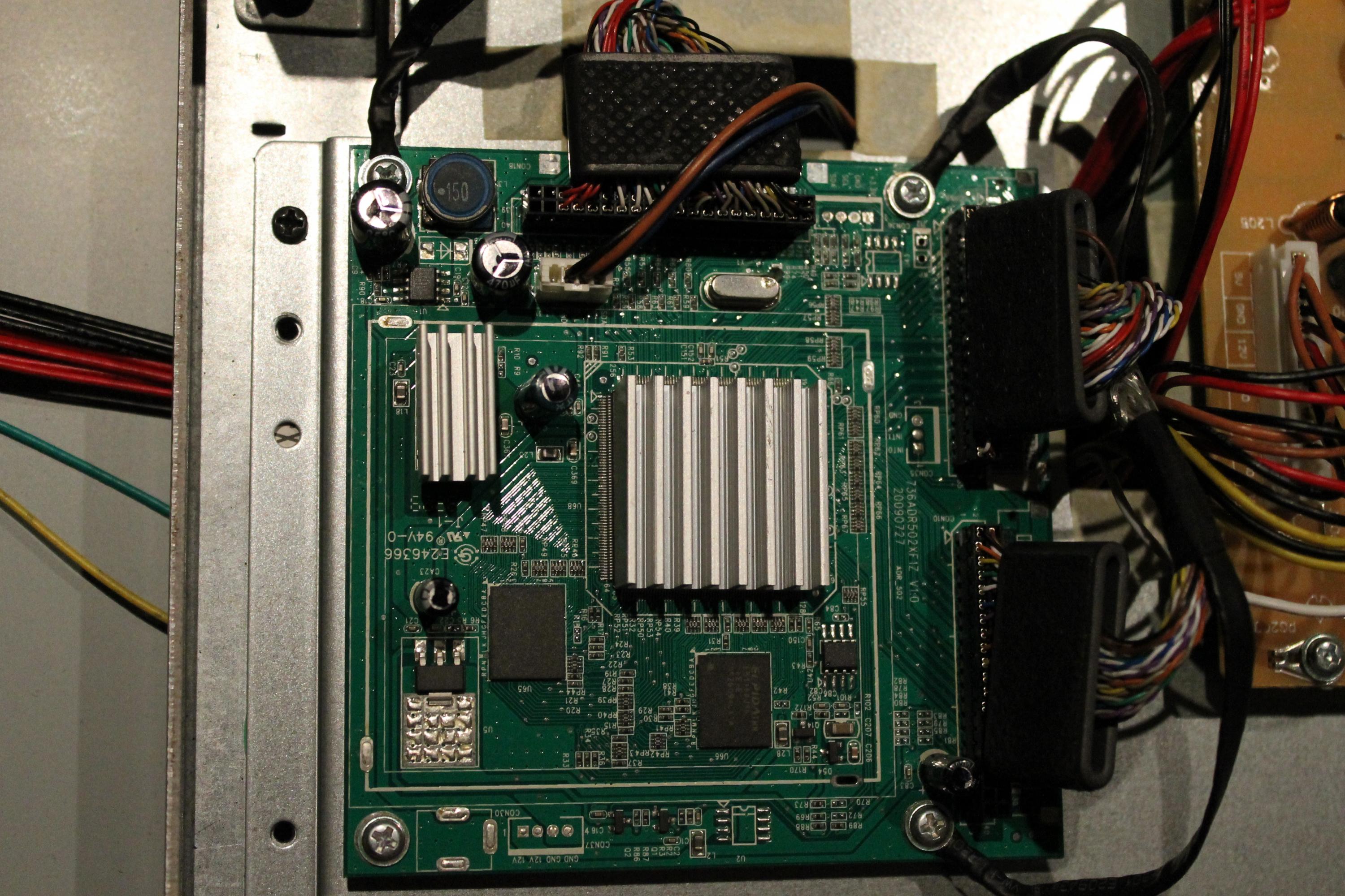

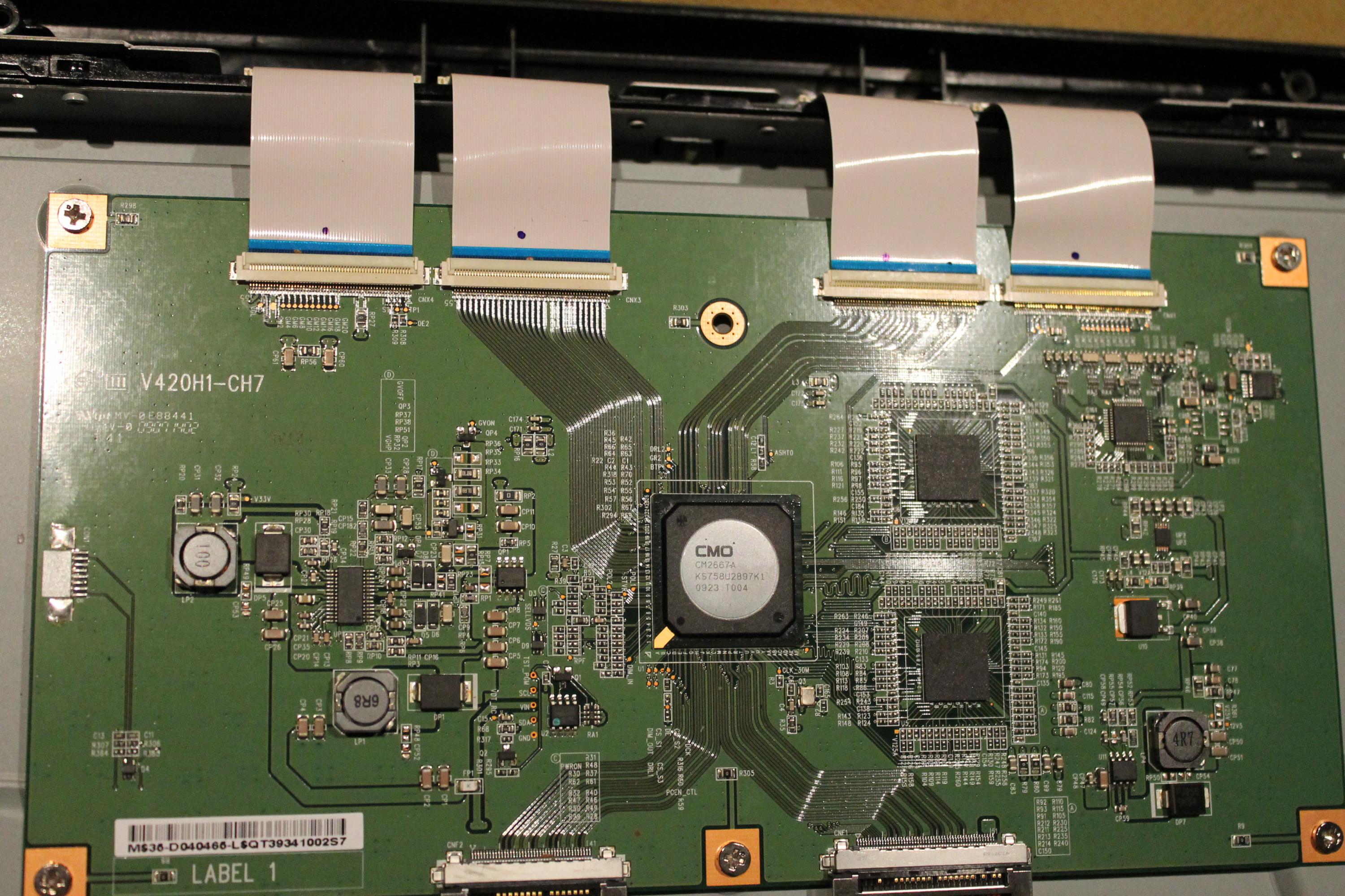

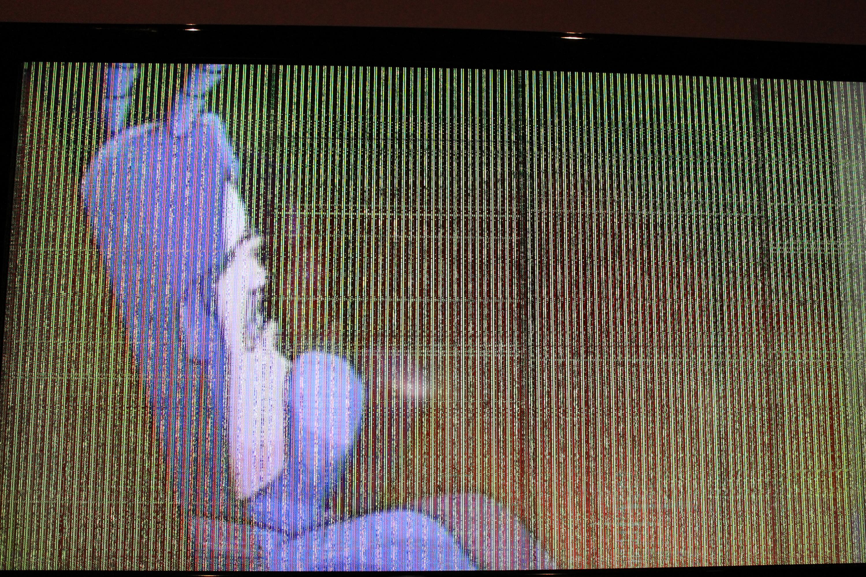

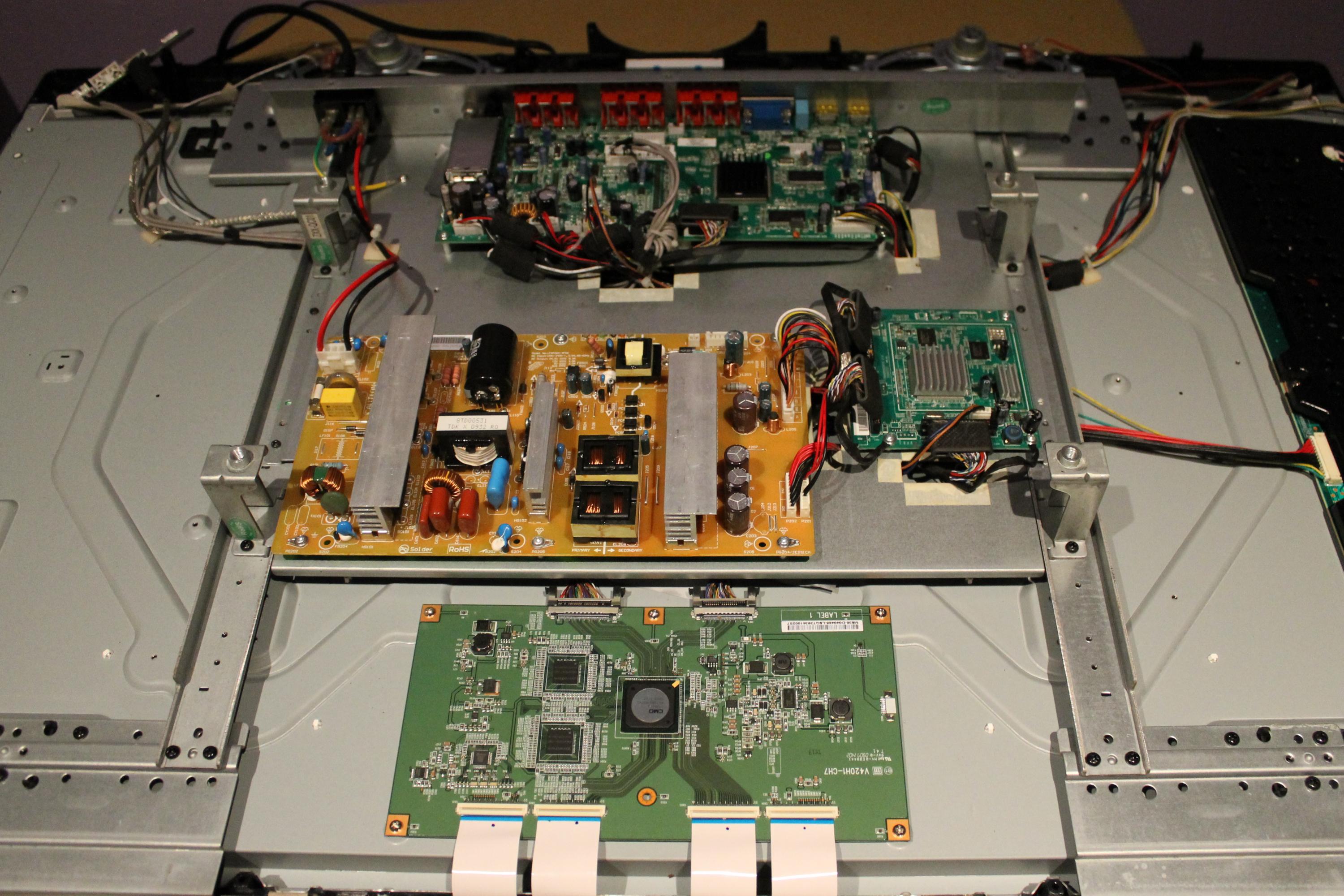

    hey guys, im trying to sort out this lcd with video issue.
    when cold, it will have perfect picture for a few minutes, or with signal it will fail within about 20 seconds.
    the picture fault is also over the menu as well.
    i have reseated all lvds and ribbon cables and checked tab bonds with no luck.
    i have also heated and cooled the main and t-con to try to find the fault, with no luck.
    i havn't found any voltages that are out of tolerance or unsteady.

    Have you checked the on-board voltages too? Like, the voltages regulated by the voltage regulators on the main board.
    Muh-soggy-knee
    • attainteddragon
      • Apr 2013
      • 764
      • australia
      Re: jvc lt-42dg1 lcd
      main voltage regulators.
      u11 eh13a
      0.0
      1.794
      3.283
      u13 l7805cv
      -0.4 mv
      3.279
      5.02
      u16 eh16a
      0.0
      3.283
      5.02
      u18 eh16a
      7.83
      0.0
      4.97
      u36 az1084s
      -o.1 mv
      3.288
      5.00
      u28 eh1.1a
      1.372
      2.616
      5.02
      u39 eh16a
      -0.3 mv
      3.284
      5.02
      u18 is a different package type that sits above the aerial port, but seems way out of place from what i can tell.
