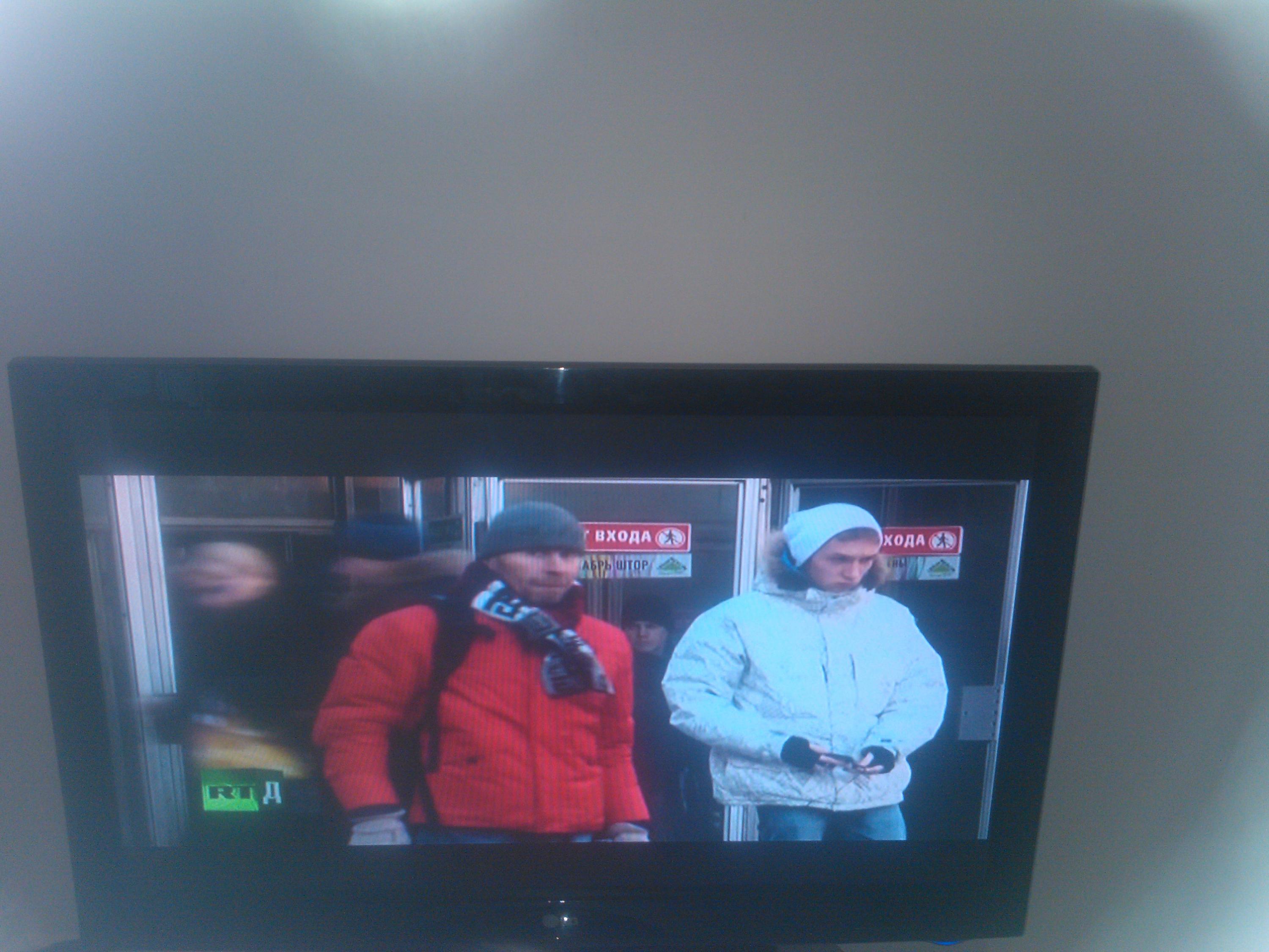

        Hi pal, thats what I thought do I opened the Y Sus buffer board connectors last night and removed the ribbons and reseated making sure they were straight all ok. I did push some of the Ysus connectors on the Y sus board now i have 1 black line 3 inched wide at the bottom as well as top. Its a £20 second hand board of Ebay same Rev number and part number. I`ll take a pic and upload it. Its perfectly watchable lol but id like to fix it its a good telly. Got some great black contrast now since i adjusted it So would hope to make perfect.

            Heres a pic of the screen with top n bottom horizontal black lines
              Re: Update Regarding LG Plasma 42pq3000
              OK, select a black source on the screen. In a dark room, do the faulty bars light up slightly with the rest of the panel, or are they pitch black?

                  It was a commercial break luckily, Lights off and the black bars are very black and rest of screen is lighter with a faint ghosting of the previous image which to be honest the tv always did that. So yes to confirm bars jet black more than watchable part of the screen
                    Good, that narrows the problem down. Will need to get the cover off when you're free so the problem can be looked at. LG plasmas do tend to have minor image retention, but it's rarely a problem.

                              It is likely the buffer chip near the appropriate connector or connection on that part of the panel. Rarely the panel itself.

                                Hi Tom, well got a week out of it now its well n truly gone tits. Now there is sound but screen has vertical yellow,pink spatters and no picture. Any clue as to the issue? Could the buffer board for the YSus gone south? Ive not even had the back off yet but I know one thing I didnt get round to setting the Voltages before it actually went tits. I am looking at fixing it again with second hand stuff and once ive got it nailed I can buy new LG parts to ensure a long life. Im thinking if I get it working of wiring a fan up to a thermal switch running off a 12 volt relay to keep it all cool as It gets quite warm . Is it worth trying to adjust the voltages to see if imakes a difference? Im thinking that there is an issue with that buffer board as I got the original lower horizontal black line with by fiddling with the ysus connectors. Remember its a second hand board, it does however have identical numbers and rev numbers etc. Regards, Ben
                                  Can you post a picture? Definitely sounds like the buffer board has died a death completely.
