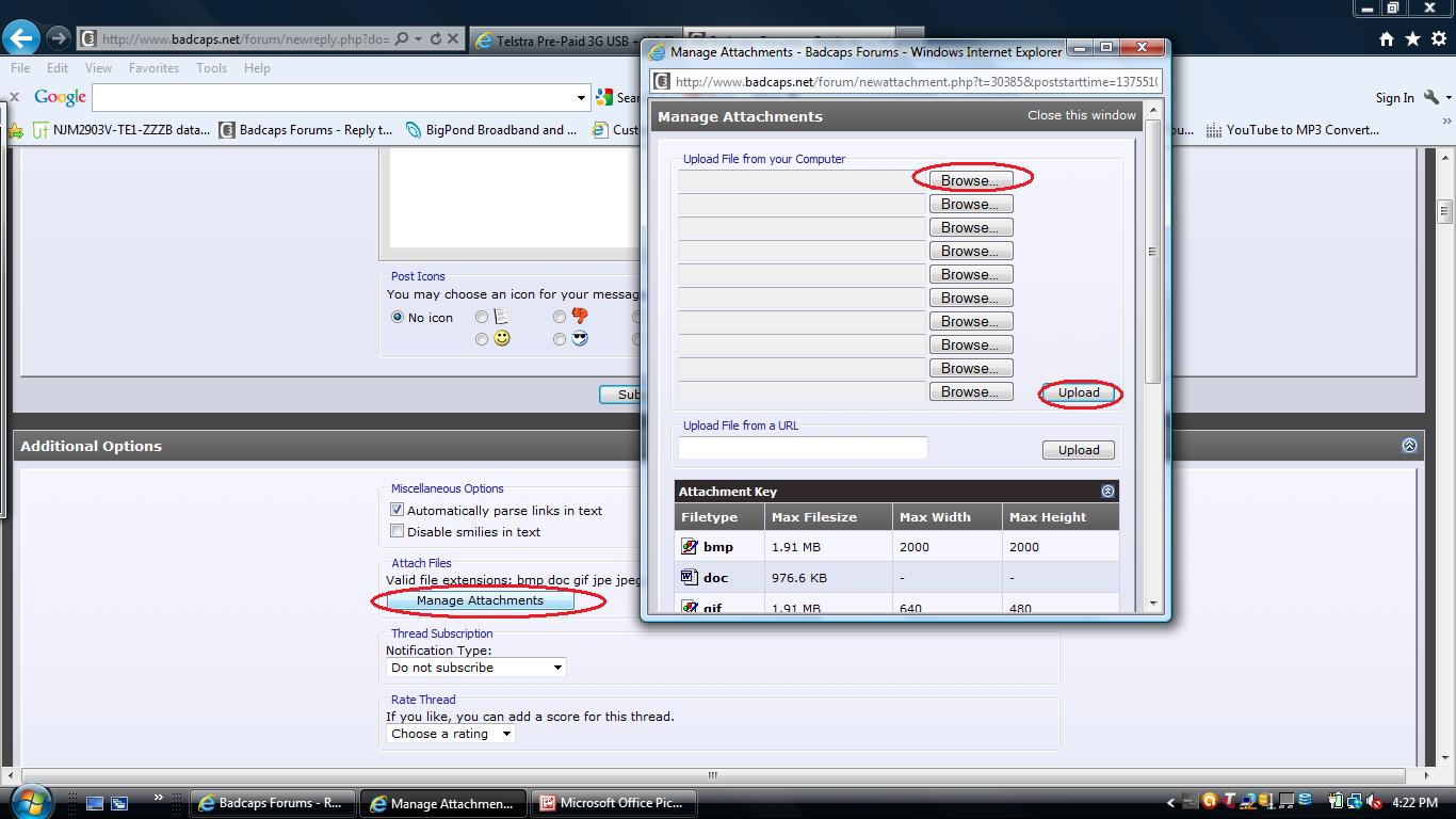

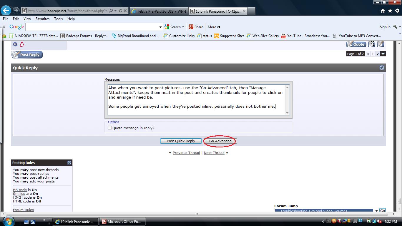

    Also when you want to post pictures, use the "Go Advanced" tab, then "Manage Attachments". keeps them neat in the post and creates thumbnails for people to click on and enlarge if need be.
    Some people get annoyed when they're posted inline, personally does not bother me.
