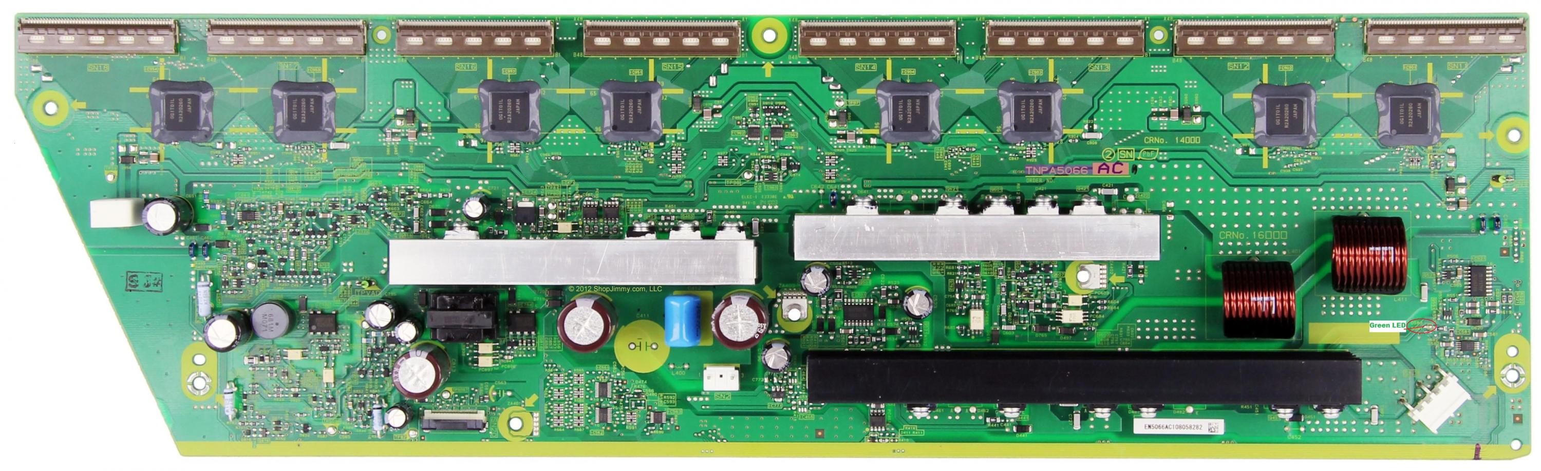

    I have the dreaded 10 blinks coming from my plasma tv. Read the technical manual that they have posted online and came to conclusion that it could be a bad "A" board. Cause I measure the voltage at connector P7 pin 1 and get 4.97v and pin 5 3.1v, but nothing from pin 7. (looking at power up operation for this information)
    From the looks of it. I need 3.2 volts to turn on the power cpu. So it could turn on the relay. Since I don't hear it. Also to supply 14.6v to the IC (5606,5608,5610) that are not receiving anything.
    I think this might be the reason why im getting 10 blinks.
    Also getting nothing at connector P2 and P11 just more info.

    Something else to try. disconnect power cables P2, P11, P35, and white ribbons A31,A32,A21.
    Turn it on and see if it turns on with no Blink codes. If it does the the A should be ok and you can also measure the PSU outputs.
    Manual mentions A,SN,SS and P boards as possible SOS 10. I know this model blows SS boards.
    Don't reconnect those power cables straight away, check for residual voltage as you they will arc and you may spike the boards or panel from residual current.

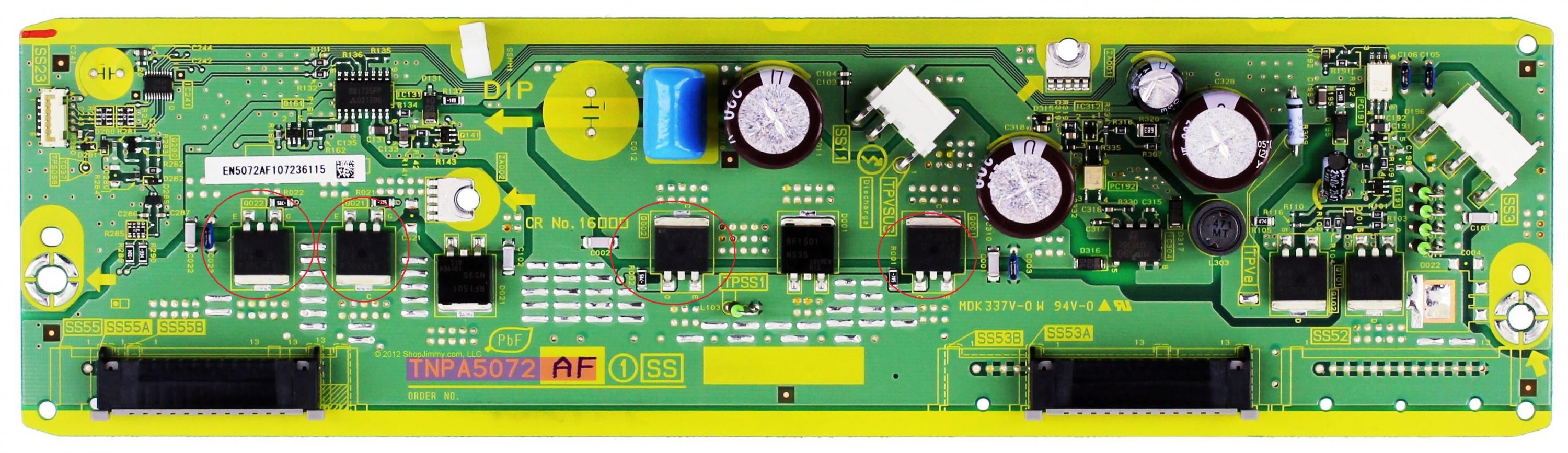

        Good question, connect everything up but leave SS3 and SS11 at the SS disconnected.
        Turn on and see if 10 blink

          Alternatively you could check resistance across the 2 pins at SS11 and SN2. disconnect the leads and obviously with it off. looking for shorts
          If they're not shorted you'll have to check the P5V and P15V lines at the SN (SN20)and P5V at SS (SS23) and see if they are short.

                set the multimeter to resistance in Mohms range and measure across the pins on the SS and SN at those connection points SS11 and SN2.
                I'm a little surprised you got no SOS but not getting SOS10 suggests the SS could be the problem. Was the little green LED at the top of the SN board brightly lit which confirms the SN is running?

                          So starting the TV like we did with the SS isolated and having no 10 blink suggests SS which is why we should either look at that board first for shorted Vsus or the SN.
                          It's safer to check for shorts rather than powering up the TV with a known fault. We know the PSU and A should be ok.
                          That leaves us with the SN, SS or maybe C1,C2 boards but I'd leave the C boards alone at this stage.

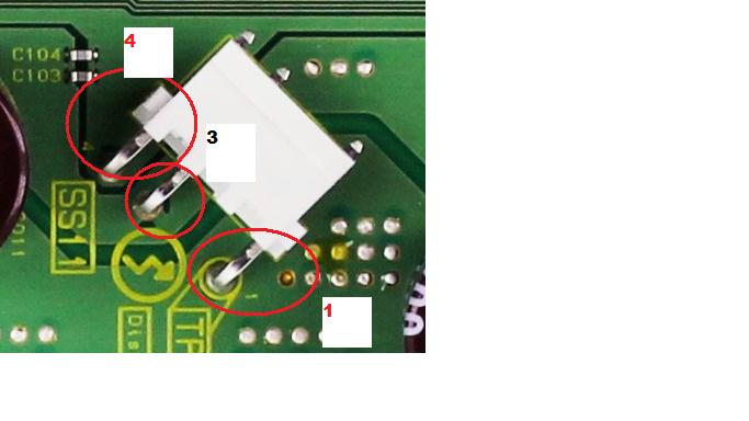

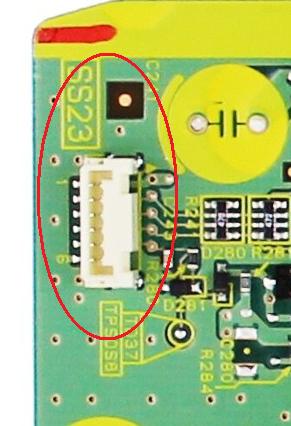

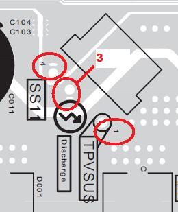

                            Also I forgot, but at connector SS11, there's P15V, So measure Vsus pin1-gnd resistance, P15V pin4 -gnd , pin3 is gnd, there's no pin2.
                            At connector SS23 resistance, pin1 P5V - gnd, pin6 is gnd.

                                  Re: 10 blink Panasonic TC-42px24
                                  SS11
                                  Vsus pin1-gnd= 000.2ohm
                                  P15V pin4 -gnd= 3.00 M ohms give or take
                                  SS23
                                  pin1 P5V - gnd= 3.00 M ohms give or take
                                  The tv wasn't plugged in either

                                    Well definitely bad SS with shorted Vsus line. You'll probably find all of these transistors shorted Q021,022,Q001,002 - RJP30E4
                                    Would also pay to check the SN too, but if you say it powered up with the SN connected both at SN2 and the ribbon SN20 connected, and the TV was on and the onboard green LED remained brightly lit, that tells me no short on the Vsus, P5V,P15V and no SOS triggers being sent back to the A board.
                                    Is that what happened?
                                    Going by this fault finding post #28, it says TV would not turn on with just the SN connected?
