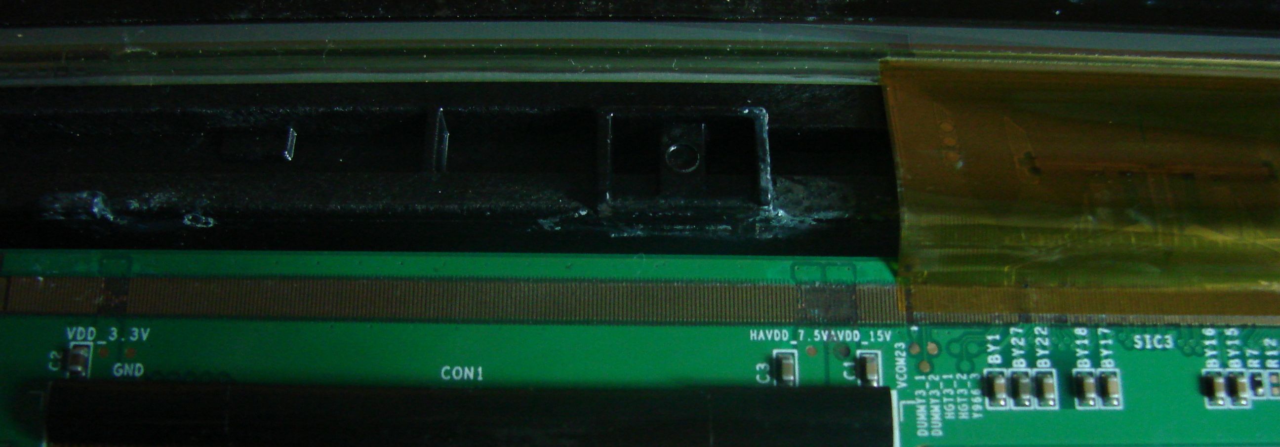

    I just acquired this Sony TV and I'm in the process of troubleshooting the issue with it. I checked to see if any of the caps were bulging but they seem to be fine. I already found a site that lists the Blink codes but I am unsure if this is the correct list for my TV.
    here is the link:
    http://www.agoraquest.com/viewtopic....70&topic=31721
    I have already replaced the T-Con board in an attempt to fix the issue but the TV still shows the same symptoms. when you power on the TV it stays on for about 5 seconds then goes into standby mode. On the initial power up the back-light does not "power on" it looks like the screen is not getting any power. any help would be greatly appreciated

    Here's service manual for your Model Page 9 has your error codes
    I had a KDL-40EX400 Sony which had the same issue removing the LVDS cable and cleaning both ends of LVDS cable as well the connector on the main board corrected my issues,also have seen some bad LVDS cables during boot time sony does send handshaking signals from main to the T-con
    and if these are not present back @ the main board set will throw the 5 blink code

      Sony KDL-55EX710.
      Error code 5.
      At the opening, damage to the panel was detected.
