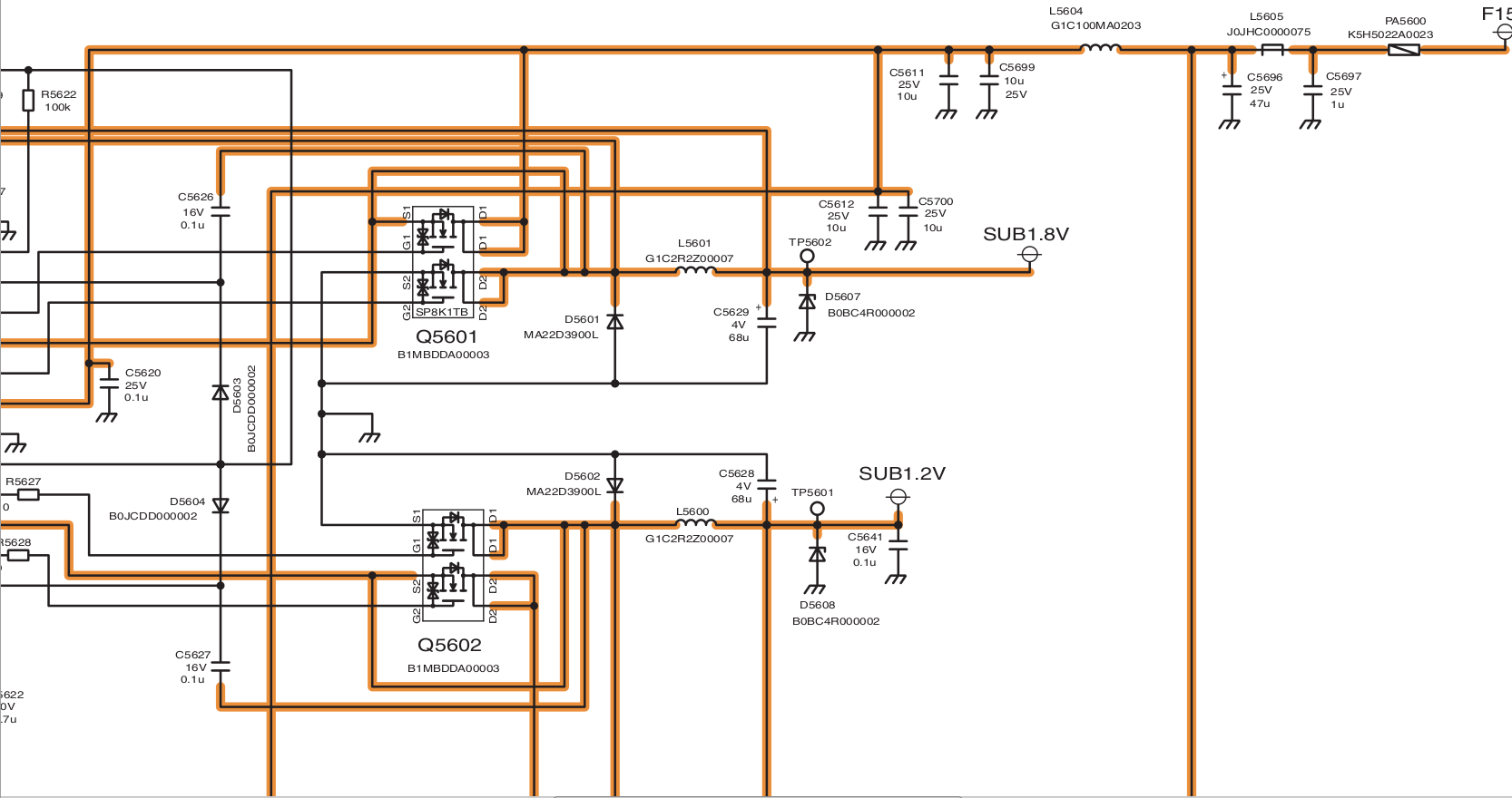

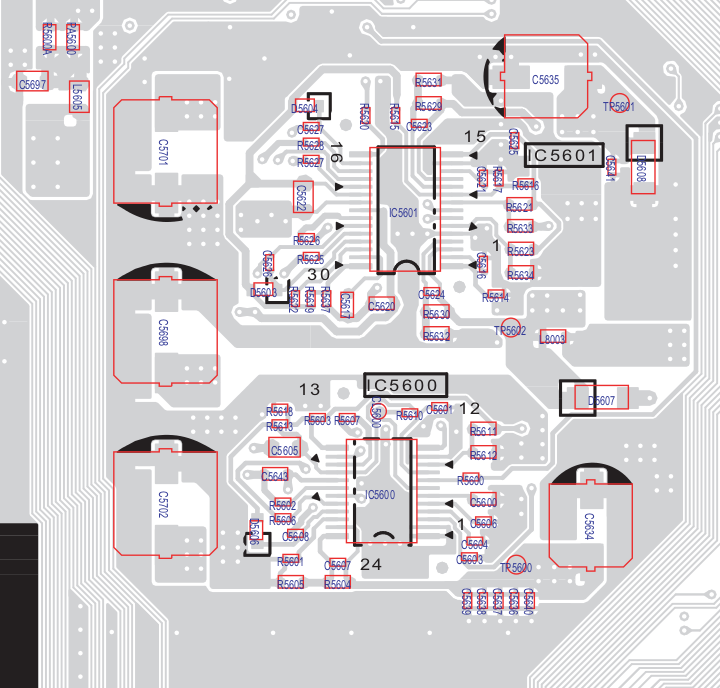

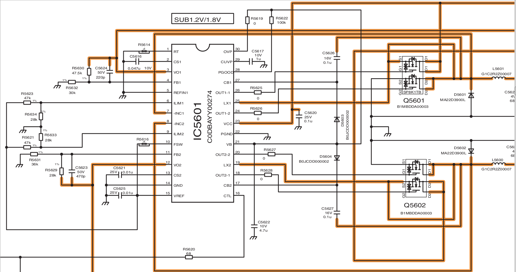

          The fuse PA5600 on A board ( TNHPH0712 ) that is on 15V supply line for IC5600 and IC5601 is blown.
          IC5600 is for 3.3V and IC5601 for 1.2V and 1.8V lines.
          15V supply line (after the fuse) is shorted.
          3.3V - gnd measures around 510 ohms just like 1.2V-gnd; 1.8V-gnd is around 330 ohms - i believe that is ok- they aren't shorted?
          Q5607 measures open (0ne side only) but i really can't see how would that affect 15v line to get shorted to gnd, am i right?
          Any suggestion what to check, measured all diodes in that circuit but they seam ok
          thx
          • Hombre
            • Jul 2013
            • 231
            • Croatia
            Re: Panasonic TH-42PY85PA 10 blinks
            Ok guys, TV is on and running
            Small ceramic capacitor C5612 was shorted and that burned fuse PA5600 on 15V line.
            Repair cost under $2

              Glad to hear it's fixed! One good way to trace a short out is to apply 15V using a lab supply, current limited to around 1 amp. Then freeze spray parts of the board. The shorted component will get hot, melting the freeze spray, allowing you to easily locate it.
